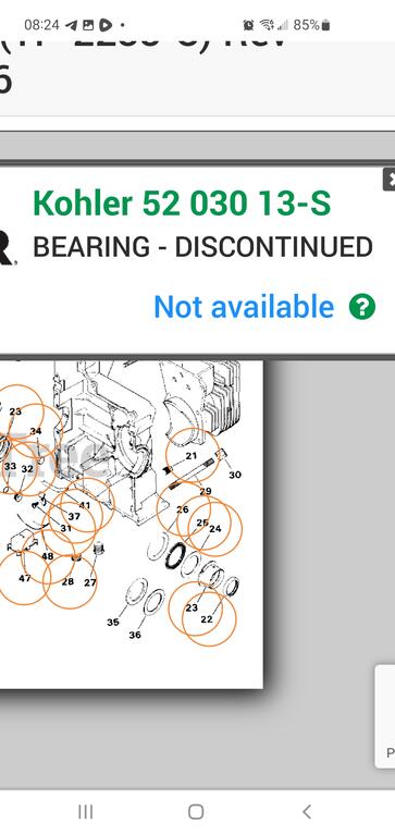

Thor27 891 #1 Posted June 18, 2024 (edited) Looking for a thrust bearing for a Kohler twin 52 030 13-S, these are NLA from Kohler, anyone know of cross reference to another source? thank you, Thor Edited June 18, 2024 by Thor27 Share this post Link to post Share on other sites

Thor27 891 #3 Posted June 18, 2024 Thank you, but it's the torrington bearing next to that I seek. Share this post Link to post Share on other sites
squonk 47,419 #4 Posted June 18, 2024 Do you have the bearing no.? The number you gave is what I found. What engine are you working on? Share this post Link to post Share on other sites

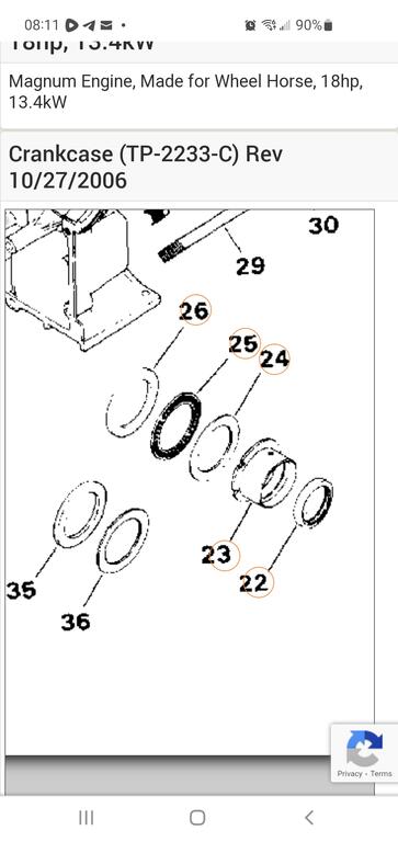

Thor27 891 #5 Posted June 18, 2024 (edited) Thank you, it's for a M18 spec 24510 from a 418. I only have the Kohler number, 52 030 13-S, I haven't found a cross to any other bearing yet. It is #25 in the ipl for crankcase. Edited June 18, 2024 by Thor27 Add picture Share this post Link to post Share on other sites

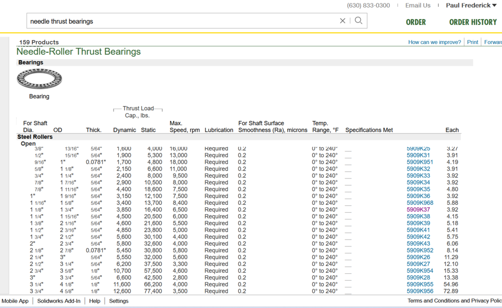

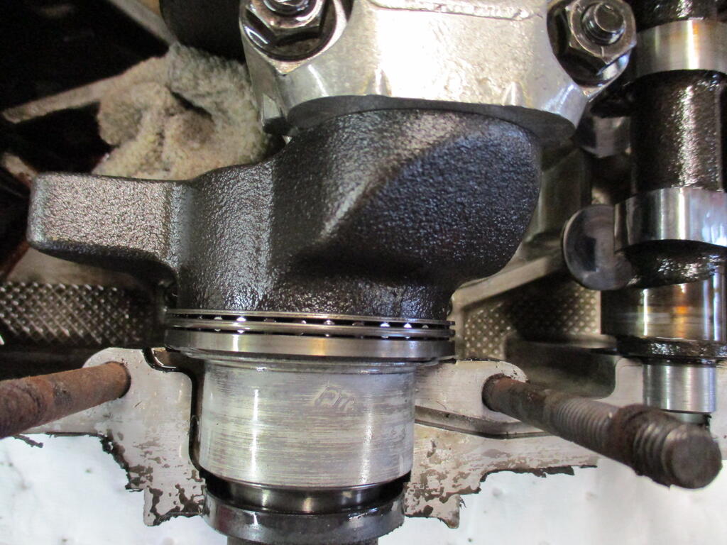

pfrederi 20,874 #7 Posted June 18, 2024 (edited) I didn't see any numbers while I had my M18 apart. it is a needle roller thrust bearing. I would measure the ID and OD and get it from McMaster You need to get two washers also Looking at the picture of mine the inner washer is probably standard from Mc master but not the outer brass looking one. Edited June 18, 2024 by pfrederi 1 1 Share this post Link to post Share on other sites

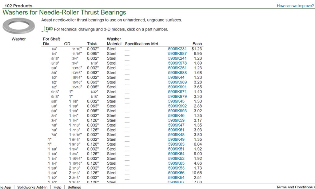

Thor27 891 #8 Posted November 10, 2025 So just to follow up. I used the mcmaster Carr bearings and washers, the 45 mm #5909K19 and thick/thin #5909K92/4909K79 washers were identical to the 418 set I had. My friend turned a few non wheel horse m20 crankshafts with 1-1/8 pto ends to accept them. 1 Share this post Link to post Share on other sites
