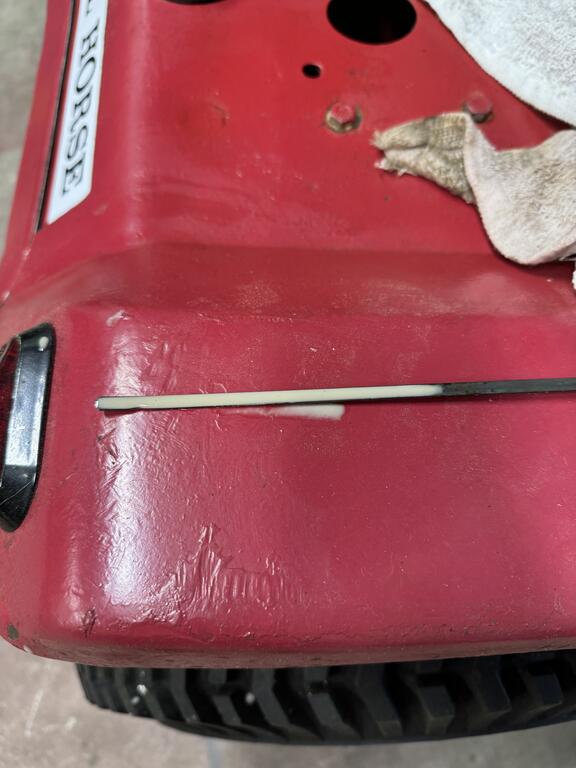

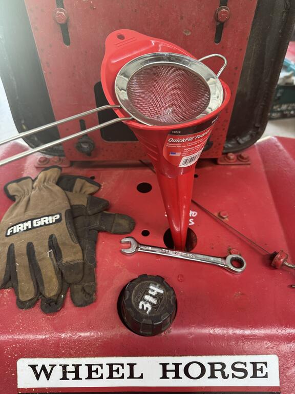

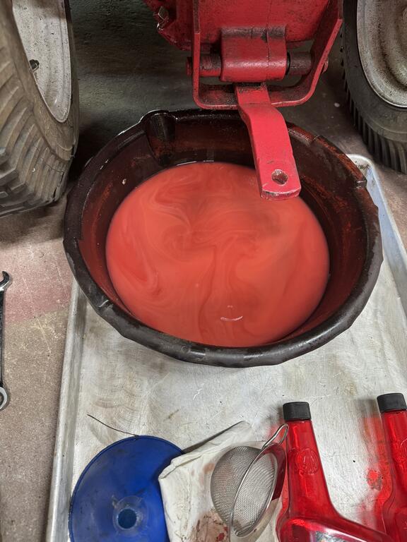

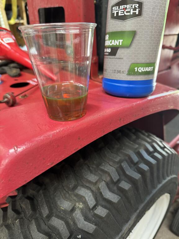

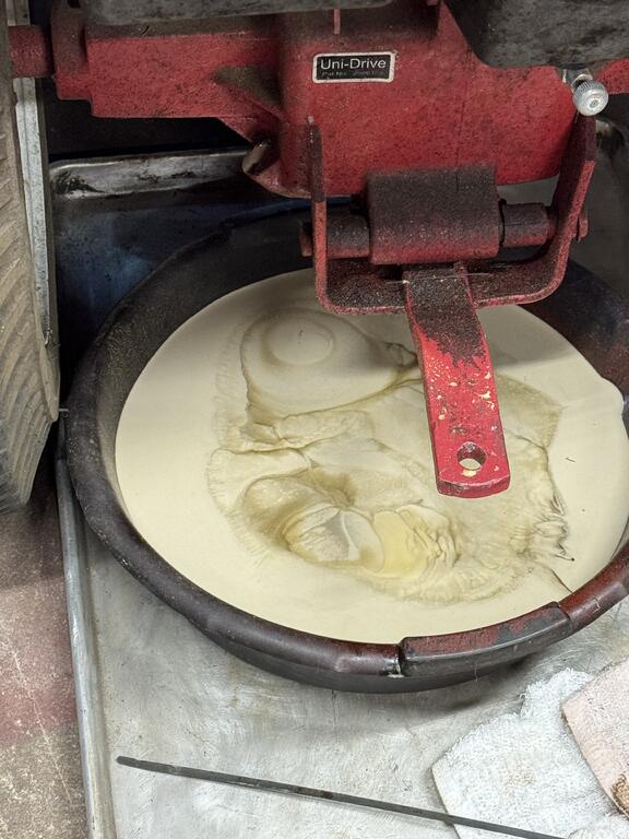

PWL216 1,294 #1 Posted June 16, 2024 (edited) I picked up a C-85 and noticed the gear shift was sluggish when moving through the gears. I checked the transmission dipstick and saw it was overfull, was an awful brown color and stunk! Damn, water in the tranny. No shifter boot cover - the likely culprit. I drained the tranny of a gallon of fluid vs the two quarts it’s supposed to have. I assumed there was still contaminated gear oil in the case, so I decided to try and flush it…with MMO. Was this a good choice? I had it, so I figured why not give it a shot. I did three flushes, using two bottles of MMO. After the last pass there wasn’t much of the contaminated oil showing, so I stopped flushing and added new transmission gear oil. The process seems to have worked as the sluggishness is gone. It shifts really well. I’ll be taking it for a ride later to test it. How do you do a transmission flush? Edited June 16, 2024 by PWL216 Share this post Link to post Share on other sites

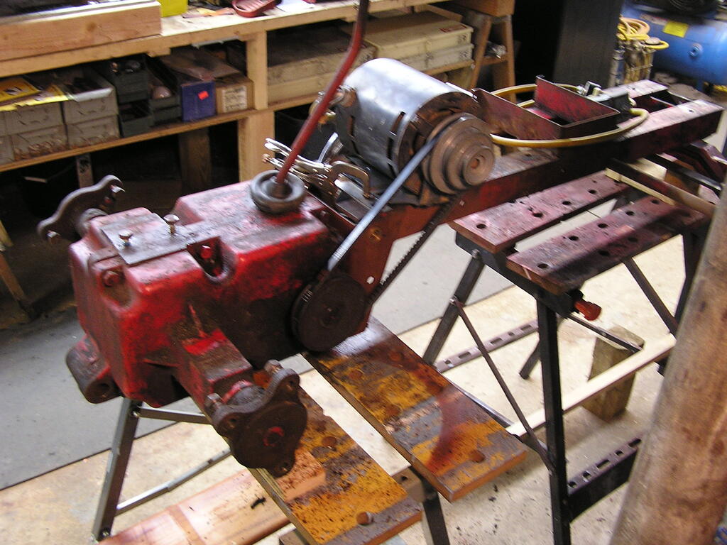

ri702bill 13,163 #5 Posted June 16, 2024 (edited) My in-the-cellar setup... Reverse rotation E-lectric motor. Work it thru all the gears - flush with diesel & drain twice..... Edited June 16, 2024 by ri702bill 5 5 Share this post Link to post Share on other sites
peter lena 10,082 #6 Posted June 17, 2024 @PWL216 , initial viewing , drainage , driving around with a cleaning / flushing agent . initial front end lift , to enhance drainage , like diesel fuel / hi mileage ATF fluid , and road time on cleaning out the crud . regularly check my , differentials , their are no surprises , always clean / clear / full. also put miles and every gear option into use . local CUL DE SAC , is like a prefect mechanical gear run . new shift boot , greased INSIDE the boot, so it effortlessly slides over the irregularities of trans case , wide TYE WRAP on top of shifter boot ,holds prefect setting , for long life . been using lucas climbing gear oil , also get after any related linkage / lever movement areas , make the rust run out . also do a regular once over , after every usage , top up fuel , 1 OZ of STA BIL fuel storage , check trans fluid , find having a regular check over , has given me solid status as to solid operation . that check over is similar , yet different , in cold weather , basically adding , plug in battery tender / heat bulb reflector under engine . @ri702bill totally agree with your trial / test set up . making a change , usually helps things out , pete 1 1 Share this post Link to post Share on other sites
