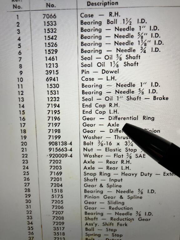

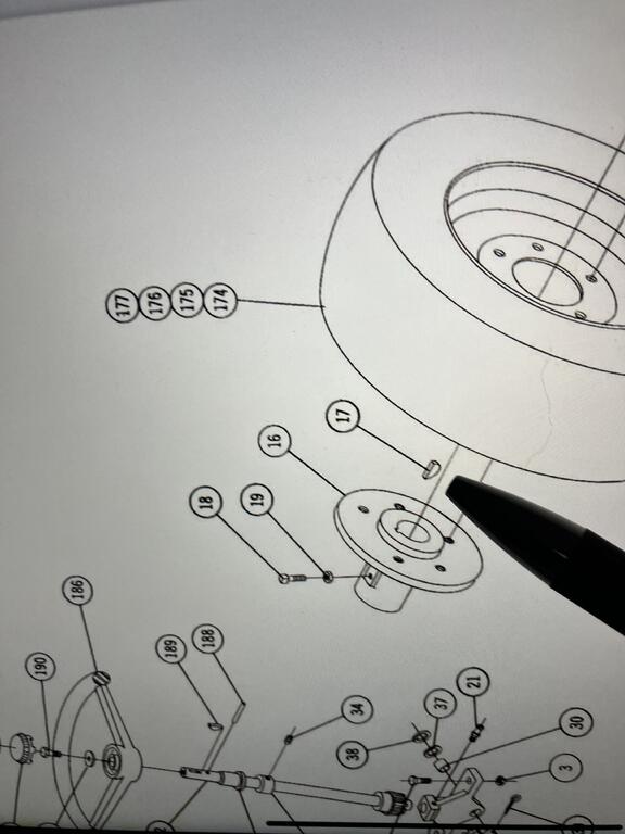

Retired Wrencher 6,994 #1 Posted June 16, 2024 (edited) Looking for woodruff keys. p/n #7197? Manual does not list it as woodruff key. Any ideas? This goes on a 1067.Thanks in advance. Edited June 16, 2024 by Retired Wrencher Share this post Link to post Share on other sites

Racinbob 13,210 #3 Posted June 16, 2024 My parts list in the service manual shows a p/n 7197 as an axle gear. In any case all the woodruff keys are hardware store stuff. 3 Share this post Link to post Share on other sites
WHX?? 58,290 #4 Posted June 16, 2024 #15 woodruff. Hillman drawers at hardware store. Share this post Link to post Share on other sites
squonk 48,207 #5 Posted June 16, 2024 (edited) Hillman drawers are known as "Half Empty" drawers around here! https://www.mcmaster.com/products/keys/woodruff-key-number~15/key-type~woodruff/ Edited June 16, 2024 by squonk 1 Share this post Link to post Share on other sites
Retired Wrencher 6,994 #6 Posted June 17, 2024 Thanks every one good info. Now that I have a direction to go. I could not find anything buy the part number. But with a #15 that will help. Share this post Link to post Share on other sites
