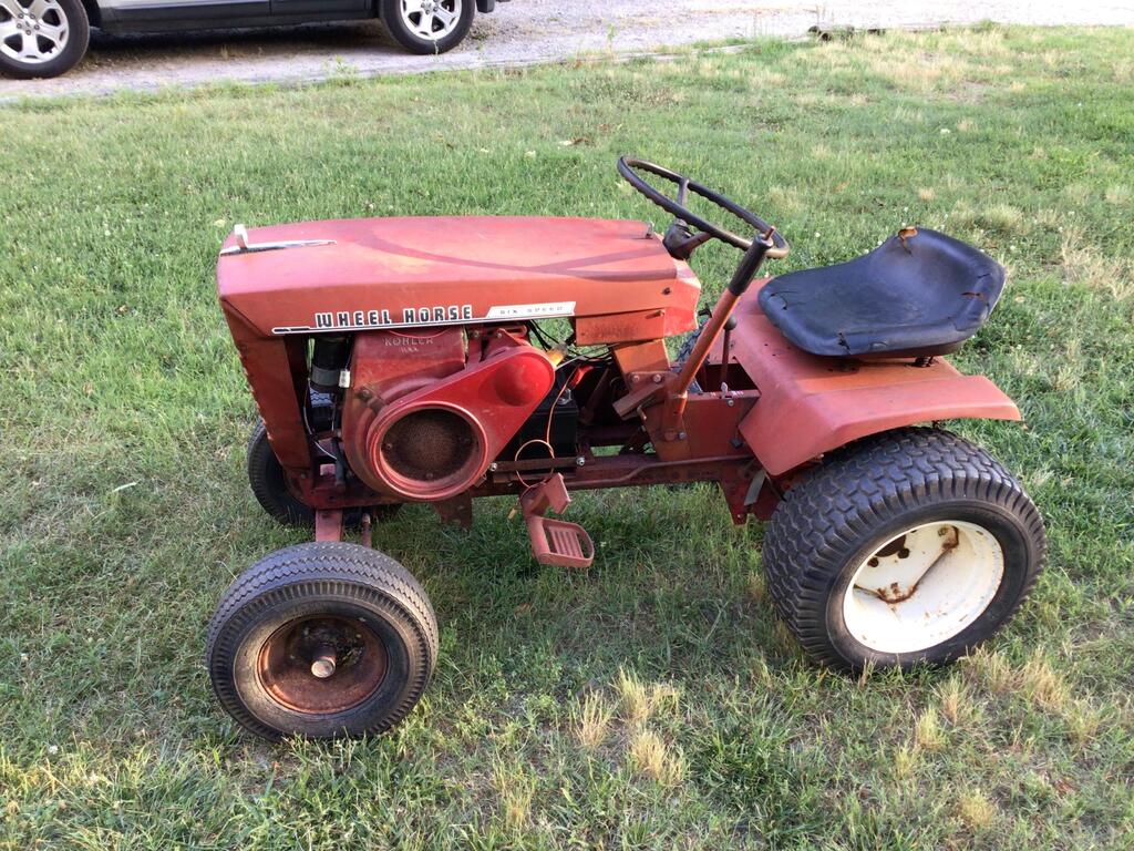

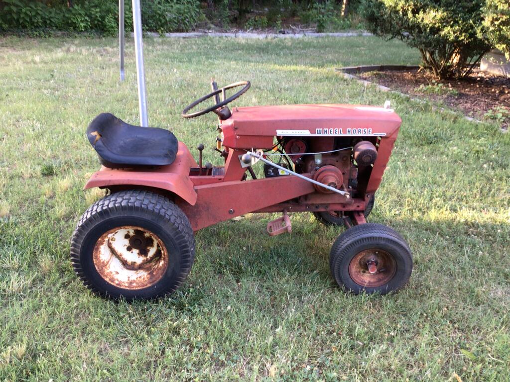

Rattlecan 68 #12 Posted June 15, 2024 It’s official in my book, Don is a genius. I feel really stupid. Have had many carbs apart and never seen that. I should have asked here about 2 days ago with what it was doing I was soooooo agitated, would not have said as many bad words. I was about to push it in the woods. It started right up and ran pretty good, good enough that I rode it around the yard for about 10 minutes to slosh the diesel around in transmission. Shifted and moved in all gears hi and lo Thanks again guys. Not done yet but a lot closer. IT RUNS and MOVES. 2 3 2 Share this post Link to post Share on other sites
