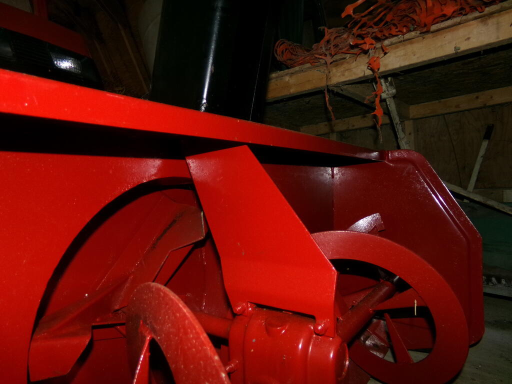

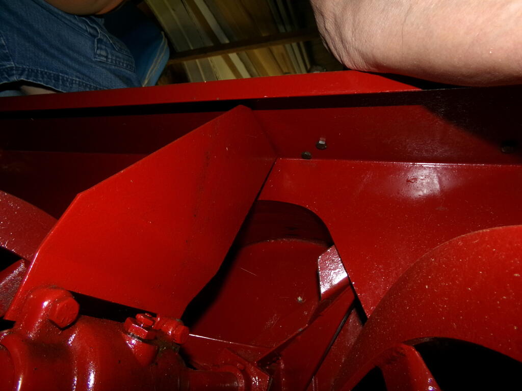

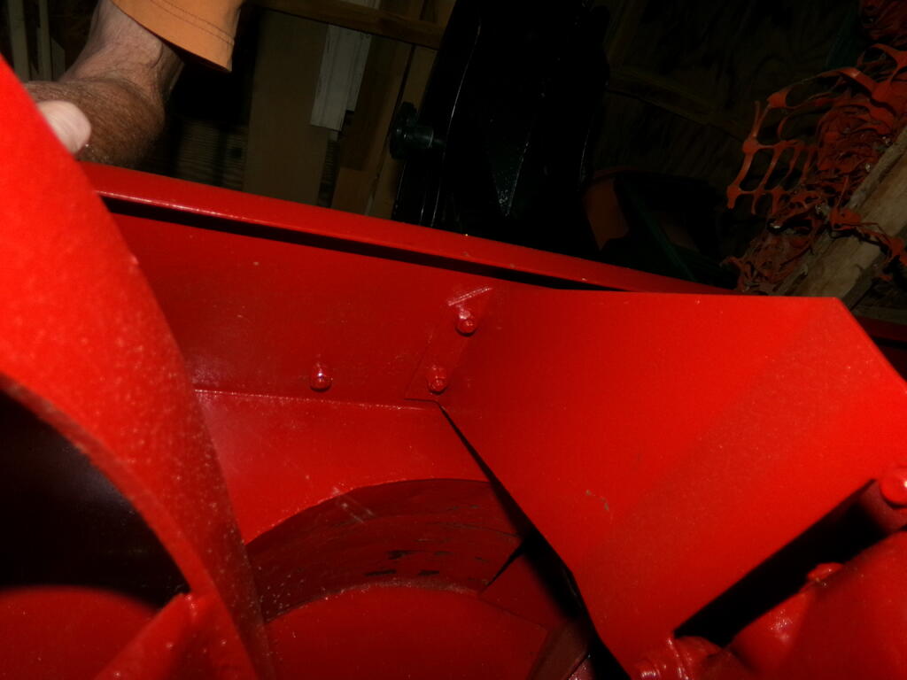

ebinmaine 80,755 #26 Posted June 18, 2024 On 6/15/2024 at 8:04 AM, WHX?? said: May want to consider the auger support. Jim - how do you make up one of these auger supports? Is that just flat stock? Does anybody have any closer pictures or drawings? 2 Share this post Link to post Share on other sites

WHX?? 58,163 #28 Posted June 18, 2024 1 hour ago, ebinmaine said: Jim - how do you make up one of these auger supports? Is that just flat stock? Does anybody have any closer pictures or drawings? Yes flat and a piece of angle. Notched a plate to bolt to the gearbox. Rest is bolted on. I'll get some better pics. 2 1 Share this post Link to post Share on other sites
Ed Kennell 47,385 #29 Posted June 18, 2024 4 hours ago, ebinmaine said: Does anybody have any closer pictures Here's a couple of mine. Not a WH, but the same idea. This is a gear box support, but also a splitter thet is bent so it is exactly in the center of the housing and auger. 1 2 Share this post Link to post Share on other sites
