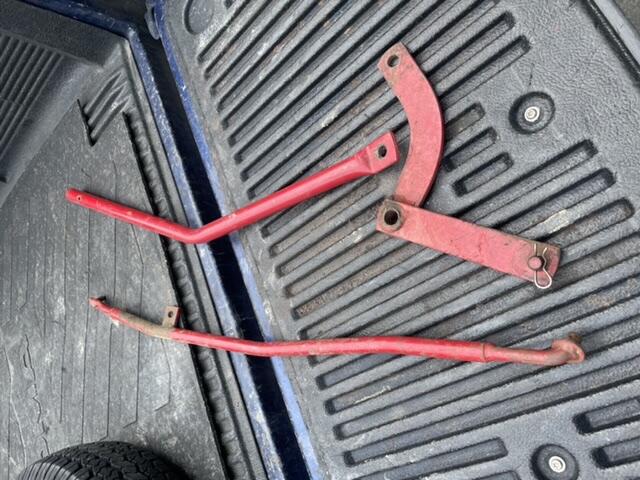

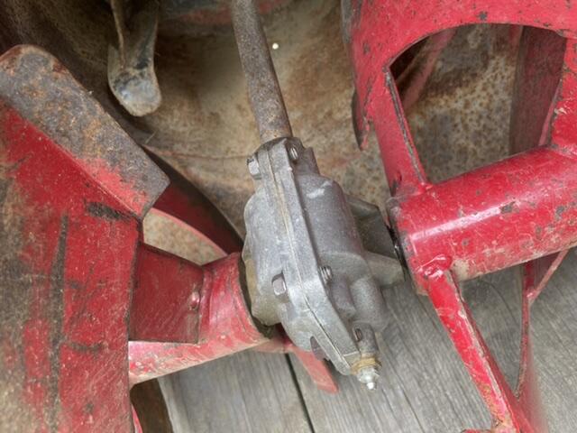

AHS 1,703 #1 Posted June 15, 2024 I got a. 2 stage snowblower…in June!! For cheap money!! Im in search of a user guide / manual for it. It’s in good shape for a. 2 stage, in ME!! It’s got a little wear in the shute, but that can be painted. Im excited to use it on the C175 or the well used 520! The gear box is newer, with a grease fitting! Ok, i have surmised, that they use 5/16” x 3” long grade 2 or 5 for shear pins? It’s came with a 520 extension bar. Do I have all the parts? I believe so! They are a lot different to hook up than one with a single stage! 2 2 Share this post Link to post Share on other sites

lynnmor 9,081 #6 Posted June 15, 2024 1 hour ago, AHS said: I got a. 2 stage snowblower…in June!! For cheap money!! Im in search of a user guide / manual for it. It’s in good shape for a. 2 stage, in ME!! It’s got a little wear in the shute, but that can be painted. Im excited to use it on the C175 or the well used 520! The gear box is newer, with a grease fitting! Ok, i have surmised, that they use 5/16” x 3” long grade 2 or 5 for shear pins? It’s came with a 520 extension bar. Do I have all the parts? I believe so! They are a lot different to hook up than one with a single stage! They never made one with a grease fitting, that was added by the previous owner. It is to have a pipe plug and you remove it to add 90 weight gear oil. 3 1 Share this post Link to post Share on other sites

ri702bill 13,396 #10 Posted June 15, 2024 Nice!! Do a bit of research to see if the auger pins are supposed to be bolts, Ariens shear bolts have 2 undercuts on them to define the shear points - regular bolts do not. 4 Share this post Link to post Share on other sites

AHS 1,703 #20 Posted June 16, 2024 Ok, so on to the second gear box. This one has a leak from the pulley. The spot in the front (lower left) is where your supposed to to put 80W90? Why cant i just put a grease fitting on there? Keep it full on grease! 1 Share this post Link to post Share on other sites
AHS 1,703 #21 Posted June 16, 2024 10 hours ago, mrc said: the 2 stagers are great. i think you might find that once installed it becomes a dedicated snow machine. Ya, i have a single stage on my C175. Can’t wait to put the 2 stage on! I, also love to hear them Kohlers bark underneath a load!! 3 Share this post Link to post Share on other sites
ebinmaine 81,282 #22 Posted June 16, 2024 7 minutes ago, AHS said: Why cant i just put a grease fitting on there? If it's spec'd for 80W90 there's a particular reason the original manufacturer set that. Grease is very likely not fluid enough to move over all the metal parts and won't properly lubricate. 1 Share this post Link to post Share on other sites
AHS 1,703 #23 Posted June 16, 2024 11 minutes ago, ebinmaine said: If it's spec'd for 80W90 there's a particular reason the original manufacturer set that. Grease is very likely not fluid enough to move over all the metal parts and won't properly lubricate. But, oil leaks out of it; and you cant get them gearboxes anymore? Correct? 2 Share this post Link to post Share on other sites
ebinmaine 81,282 #24 Posted June 16, 2024 1 minute ago, AHS said: But, oil leaks out of it; and you cant get them gearboxes anymore? Correct? The seals are replaceable. If the oil leaks and the grease doesn't... that's because grease isn't moving. Non moving grease is also not lubricating all the parts. 1 Share this post Link to post Share on other sites
