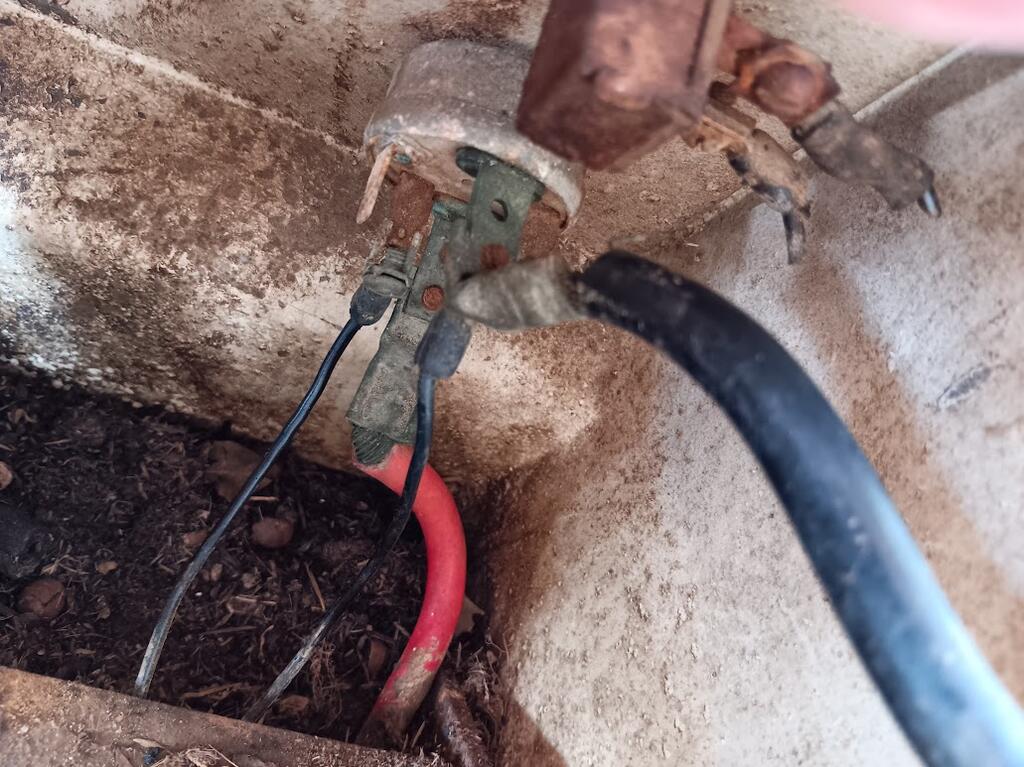

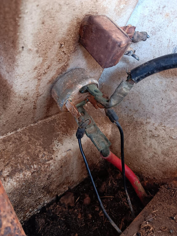

Skwerl58 843 #1 Posted June 13, 2024 I have started working with my 10 year old grandson on a 70-71 Sears Custom 10XL with the Tecumseh HH100. I got the tractor in the mid 80's and used it until I gave it to my son about 18 years ago to cut his grass. About 10 years ago my son parked it and left it in the weather so it has went down. The year before he parked it he replaced the igniton system behind the flywheel and it was around $150 then. The ignition switch needs replaced and it is the one with two large lugs for the cables to attach to. Does anyone know what the replacement switch part number is. Then I will go from there after we get it turning over. Pictures are attached. Share this post Link to post Share on other sites
squonk 48,429 #2 Posted June 13, 2024 This switch should work. Cole Hersee 95521B https://www.digikey.com/en/products/detail/cole-hersee/95521-B/6347770?utm_adgroup=&utm_source=google&utm_medium=cpc&utm_campaign=PMax Shopping_Product_Low ROAS Categories&utm_term=&utm_content=&utm_id=go_cmp-20243063506_adg-_ad-__dev-c_ext-_prd-6347770_sig-Cj0KCQjwsaqzBhDdARIsAK2gqnc33jo5mrpHM3KZMLH70vZBfDb3aDQNJLhX4EYblxWAKD6yTQgurz4aAsfUEALw_wcB&gad_source=1&gclid=Cj0KCQjwsaqzBhDdARIsAK2gqnc33jo5mrpHM3KZMLH70vZBfDb3aDQNJLhX4EYblxWAKD6yTQgurz4aAsfUEALw_wcB 2 Share this post Link to post Share on other sites
