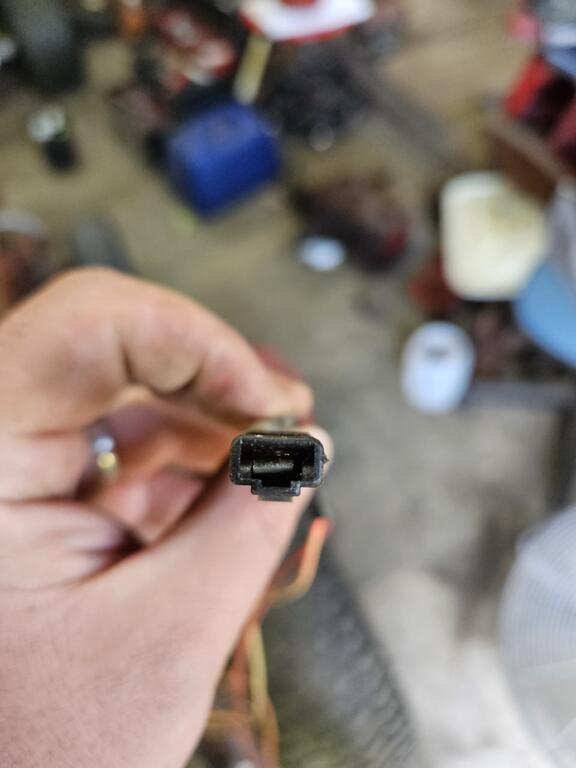

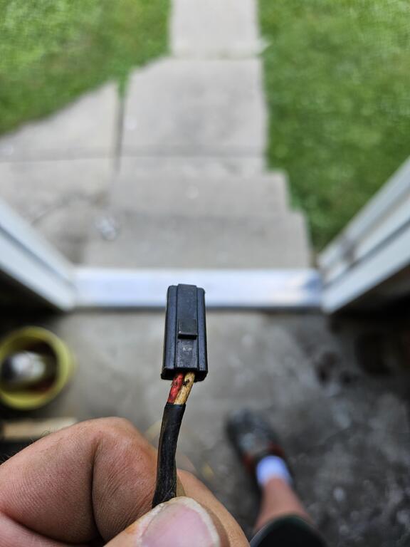

Mike'sHorseBarn 3,681 #1 Posted June 13, 2024 What are these types of connectors are these called and what tools do I need to make them/put them together? I'm making a whole new harness for my C-161 and I want to keep it pretty stock looking. Thanks! Share this post Link to post Share on other sites
Achto 32,765 #2 Posted June 13, 2024 28 minutes ago, Mike'sHorseBarn said: What are these types of connectors The terminal inside of that connector is called a female Packard terminal. https://www.amazon.com/Packard-Female-16-14-Terminals-2965867/dp/B00A8X35QU/ref=asc_df_B00A8X35QU/?tag=hyprod-20&linkCode=df0&hvadid=693270340479&hvpos=&hvnetw=g&hvrand=1222551592029563128&hvpone=&hvptwo=&hvqmt=&hvdev=c&hvdvcmdl=&hvlocint=&hvlocphy=9019452&hvtargid=pla-570008885201&psc=1&mcid=fb90625094823ba7824c421179235c30&gad_source=1 2 1 Share this post Link to post Share on other sites

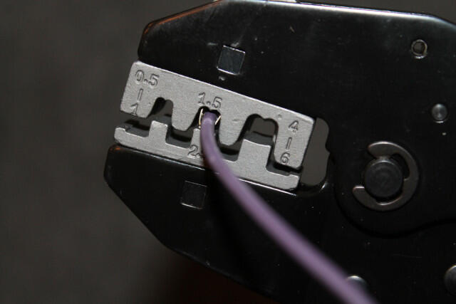

lynnmor 9,042 #14 Posted June 14, 2024 1 hour ago, squonk said: Packard connectors take a different crimper then those Channellocks. You need the little woobie doobie flutes in the die. Here is a better photo of the woobie doobies that crimp connectors with wire and insulation barrels. 3 Share this post Link to post Share on other sites
Marv 996 #15 Posted June 15, 2024 1 hour ago, lynnmor said: Here is a better photo of the woobie doobies that crimp connectors with wire and insulation barrels. I have one very much like that. I will check it for name and post it Marv 1 Share this post Link to post Share on other sites
Handy Don 17,482 #16 Posted June 15, 2024 1 hour ago, lynnmor said: Here is a better photo of the woobie doobies that crimp connectors with wire and insulation barrels. It's amazing to me the seemingly simple cleverness that that crimper uses to arch over and embed the two sides of the connector. Share this post Link to post Share on other sites

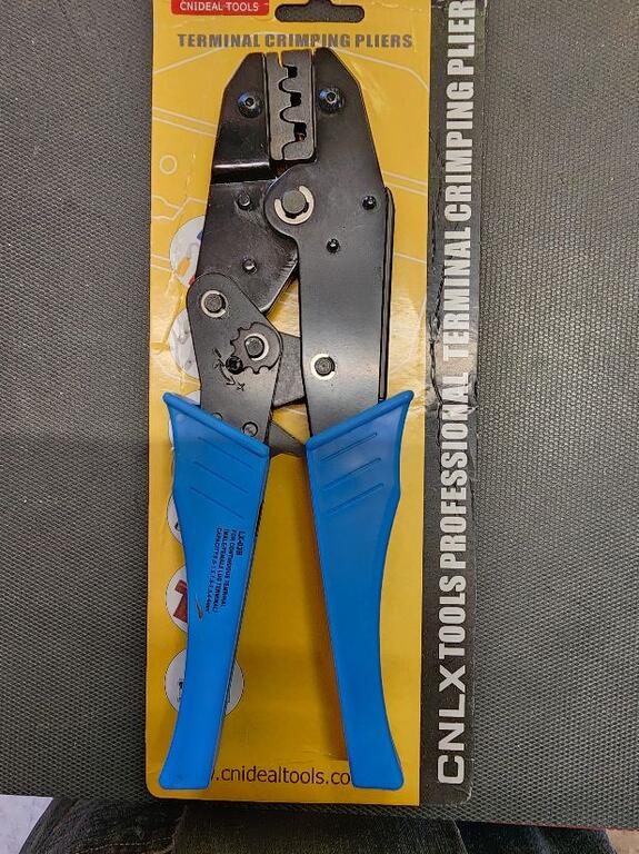

Mike'sHorseBarn 3,681 #18 Posted June 15, 2024 I have a wirefy crimper, I'll have to check and see if they have the right dies. Share this post Link to post Share on other sites
Marv 996 #19 Posted June 18, 2024 A little late with the picture. Was having Email problems. This was recommended by Save Old Iron. Miss him. Marv 1 Share this post Link to post Share on other sites
