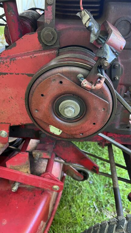

Tooonz 4 #1 Posted June 11, 2024 Good morning, I recently picked up a 1971 charger 12 Automatic, with electric PTO. I’m just trying to get acquainted to this tractor. It’s been sitting for years. When I engage the PTO it’s quiet , but when I let the engine run and PTO idle it makes a noise similar to a dry bearing or a bad bearing, metal on metal . No horrible but It’s there. so is this normal? Does it have a bearing? ant help would be greatly appreciated Share this post Link to post Share on other sites

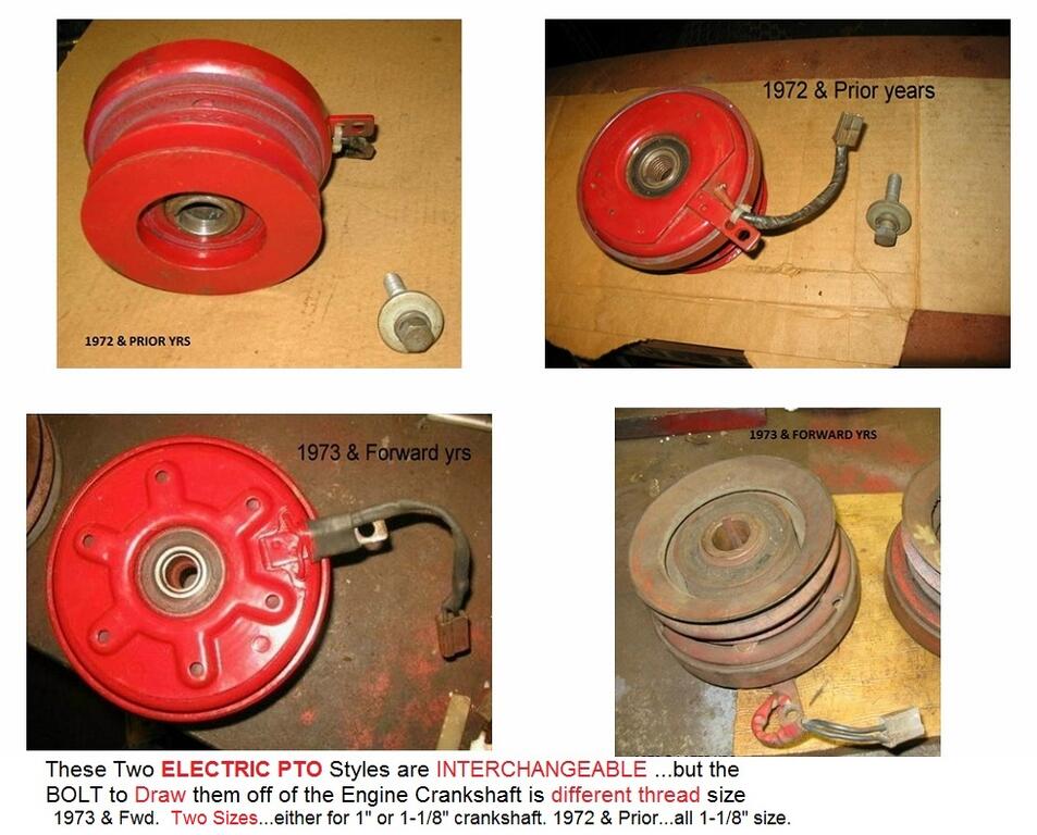

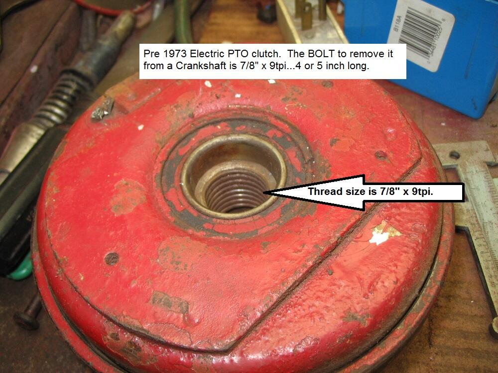

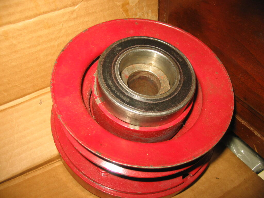

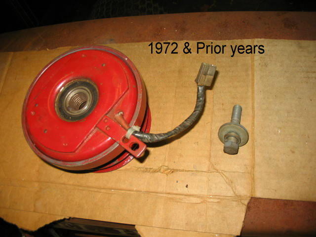

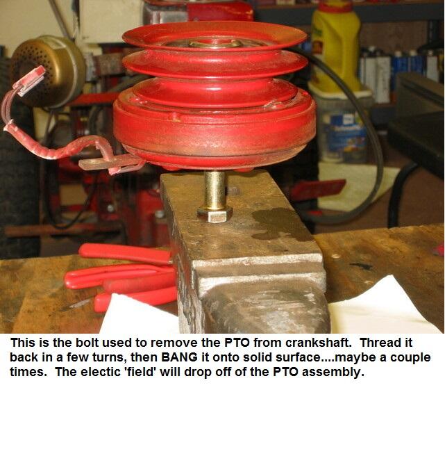

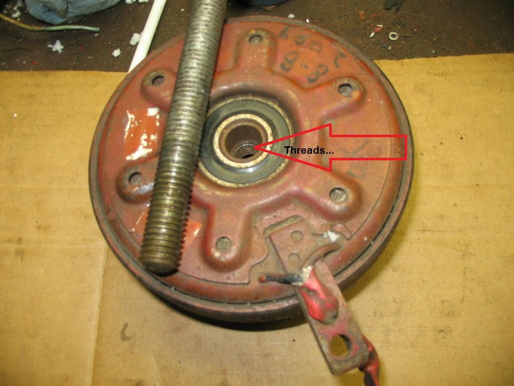

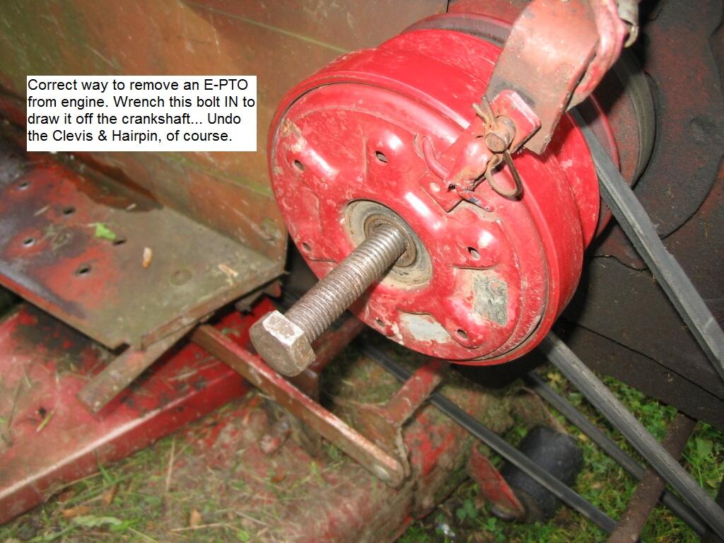

pfrederi 21,166 #4 Posted June 11, 2024 (edited) Two bearings. Your PTO looks to be an older unit. Do not use any kind of puller to get it off. You remove the center bolt an you will see some large threads inside the PTO. (Depending on the year maybe 5/8NC 7/8NC or even1"NC. You get a bolt with the correct thread and screw it in i will push the PTO out off the crankshaft. Inner bearing was changed over the years so look for the number on the bearing Check out this thread Edited June 11, 2024 by pfrederi 1 Share this post Link to post Share on other sites

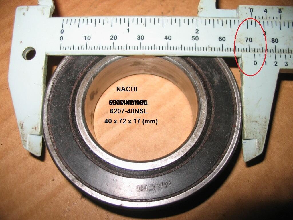

daveoman1966 3,884 #5 Posted June 11, 2024 Yours is the older (pre 73) E-PTO clutch. As pfrederi said, DO NOT use any sort of puller to remove it from the crankshaft. NOTE---If your bearings are bad, i MAY have good replacements...will have to 'measure up' to confirm. 1 2 Share this post Link to post Share on other sites
