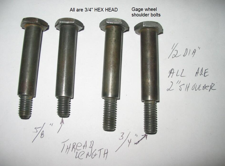

daveoman1966 3,885 #2 Posted June 10, 2024 The wheel 'wobble' you describe is as much a fault of the 6" wheel (hub) as the SHOULDER BOLT wear. These are from a 48" deck and ought to serve you well... Not new, but real close to that. 3/4" HEX head--- 1/2" dia shoulder---2" shoulder length---5/8" or 3/4" thread length. Put $15 (as 'money to FRIENDS') into my Paypal account for either set...$20 will get you all 4 of them. The ONLY difference is the thread length. My paypal account is: daveoman@windstream.net. Share this post Link to post Share on other sites

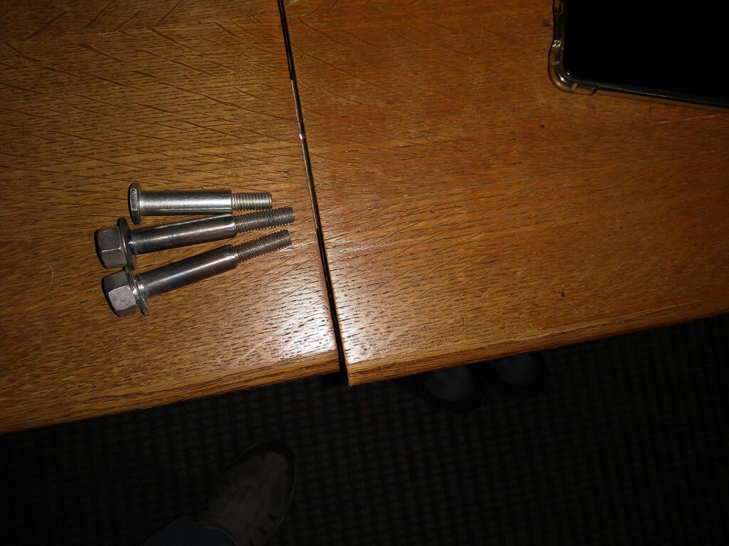

squonk 48,429 #11 Posted June 10, 2024 I had issues with the wheels squeaking on my Recycler deck. Grease them and the squeak would come back. finally I figured out the whole bolt was spinning in the hole on the height bar. If I tightened the bolt to stop it from spinning the wheel would be too tight. So I had some custom shoulder bolts made up. The shoulder is long enough that I can put needle bearing washers on the deck side and the bolt head side and tighten the bolt fully and the wheel will spin easily. 2 Share this post Link to post Share on other sites
Bill D 3,213 #12 Posted June 12, 2024 On 6/10/2024 at 3:55 PM, squonk said: I had issues with the wheels squeaking on my Recycler deck. Grease them and the squeak would come back. finally I figured out the whole bolt was spinning in the hole on the height bar. If I tightened the bolt to stop it from spinning the wheel would be too tight. So I had some custom shoulder bolts made up. The shoulder is long enough that I can put needle bearing washers on the deck side and the bolt head side and tighten the bolt fully and the wheel will spin easily. I made my own shoulder bolts using 1/2" OD, 3/8" ID tubing from Home Depot some 3/8" bolts and 5/16" flat washers which fit tight on the bolts. Works great. 1 Share this post Link to post Share on other sites
