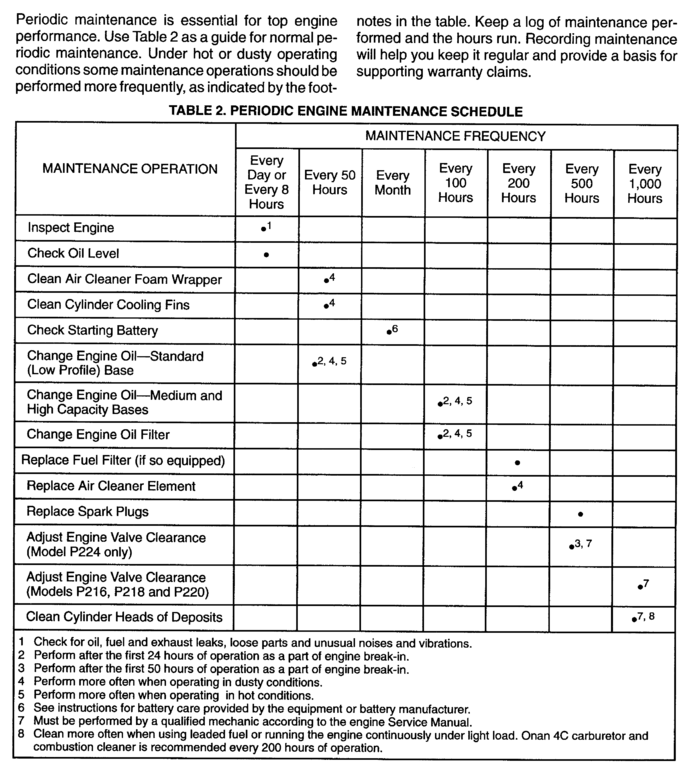

artfull dodger 441 #20 Posted June 25, 2024 More Onan things to maintain. one, if the rubber grommet to seal the cylinder tin to the oil filter body is missing, replace it ASAP! Very important to keeping that rear cylinder cool. Next up, Onans have adjustable valve lash and this must be checked and adjusted every 250 hours of operation. Failure to do so can result in valves not fully closing causing cylinder imbalance between the two and overheating the hardened valve seat. Cylinder imbalance can cause a rod to throw, and overheating the valve seat can cause it to pop out of the alum block. This is especially common on the 20hp Onan more than the 16 and 18 hp version due to a larger bore leaving less block to act as a heat sink. You can download the Onan engine service manuals online to see the procedure to set the valve lash. When you change the oil, shine a flashlight in there and look for oily buildup under the flywheel and the cylinder fins from leaking crankshaft seal ect. You want the fins dry and clean. Only work the engine at full rpm, 3600 +or- 50rpm under load, ie mower deck engaged. Onans are a beast but are more particular in their upkeep and during overhaul compared to a Briggs or Kohler of the same vintage. They come from the generator world, they move a lot more air when compared to other brands as many times they are mounted under an RV ect. They are like a sports car, where a Kohler is the Chevy truck you just cant kill. That said, I love my Onans, have 2 of them and nothing beats the throaty roar of a finely tuned Onan at full throttle! 1 Share this post Link to post Share on other sites
lynnmor 8,914 #21 Posted June 25, 2024 6 hours ago, artfull dodger said: More Onan things to maintain. one, if the rubber grommet to seal the cylinder tin to the oil filter body is missing, replace it ASAP! Very important to keeping that rear cylinder cool. Next up, Onans have adjustable valve lash and this must be checked and adjusted every 250 hours of operation. Failure to do so can result in valves not fully closing causing cylinder imbalance between the two and overheating the hardened valve seat. Cylinder imbalance can cause a rod to throw, and overheating the valve seat can cause it to pop out of the alum block. This is especially common on the 20hp Onan more than the 16 and 18 hp version due to a larger bore leaving less block to act as a heat sink. You can download the Onan engine service manuals online to see the procedure to set the valve lash. When you change the oil, shine a flashlight in there and look for oily buildup under the flywheel and the cylinder fins from leaking crankshaft seal ect. You want the fins dry and clean. Only work the engine at full rpm, 3600 +or- 50rpm under load, ie mower deck engaged. Onans are a beast but are more particular in their upkeep and during overhaul compared to a Briggs or Kohler of the same vintage. They come from the generator world, they move a lot more air when compared to other brands as many times they are mounted under an RV ect. They are like a sports car, where a Kohler is the Chevy truck you just cant kill. That said, I love my Onans, have 2 of them and nothing beats the throaty roar of a finely tuned Onan at full throttle! The 16, 18 & 20 horsepower engines all have a 3.250" bore. The maintenance schedule for valve adjustment is 1,000 hours, but I think that should be reduced a bit because of the varied use in a tractor. 1 Share this post Link to post Share on other sites

artfull dodger 441 #23 Posted June 25, 2024 The preferred rule of thumb and taught at the Onan engine school years ago when B and P series engines were nearly new was every 250 hours, adjust the valves and decarbon the heads and piston tops. Only the RV gensets on propane got a different decarbon vs normal gas. Every Onan I have owned or worked on and opened up at 500ish hours had valves way out of adjustment, usually tight to the point that one or both were being held slightly open all the time. One should hear a little valve train clatter at low rpms when its set to the book spec. 1 Share this post Link to post Share on other sites
