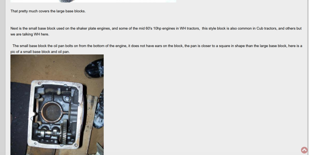

pfrederi 21,046 #4 Posted June 3, 2024 35 minutes ago, Achto said: I found that most engines that are on a shaker plate are wide base. The ones bolted directly to the frame are narrow base. No it is the other way around see pinned post on blocks 2 Share this post Link to post Share on other sites

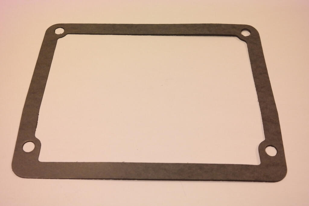

Achto 32,347 #5 Posted June 3, 2024 (edited) 24 minutes ago, pfrederi said: That picture shows a wide base block. That post seems backwards, or my terminology is backwards. Pan gasket for a K341 wide base. Found w/ most shaker plates. K341 narrow base pan gasket. Found on most frame mount engines. Edited June 3, 2024 by Achto Share this post Link to post Share on other sites

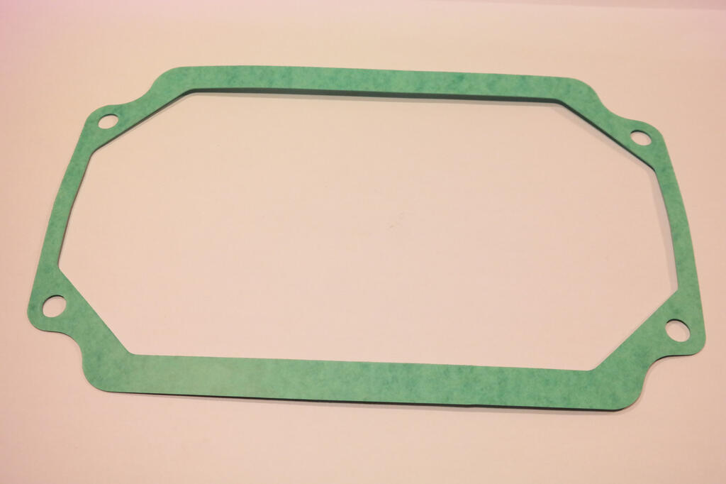

Fordiesel69 272 #6 Posted June 3, 2024 Seller often have wide vs narrow mixed up. Just order the $16 kit with all the stuff and you will have spare gaskets. BTW you have the green one shown above on your C-160. 2 1 Share this post Link to post Share on other sites
