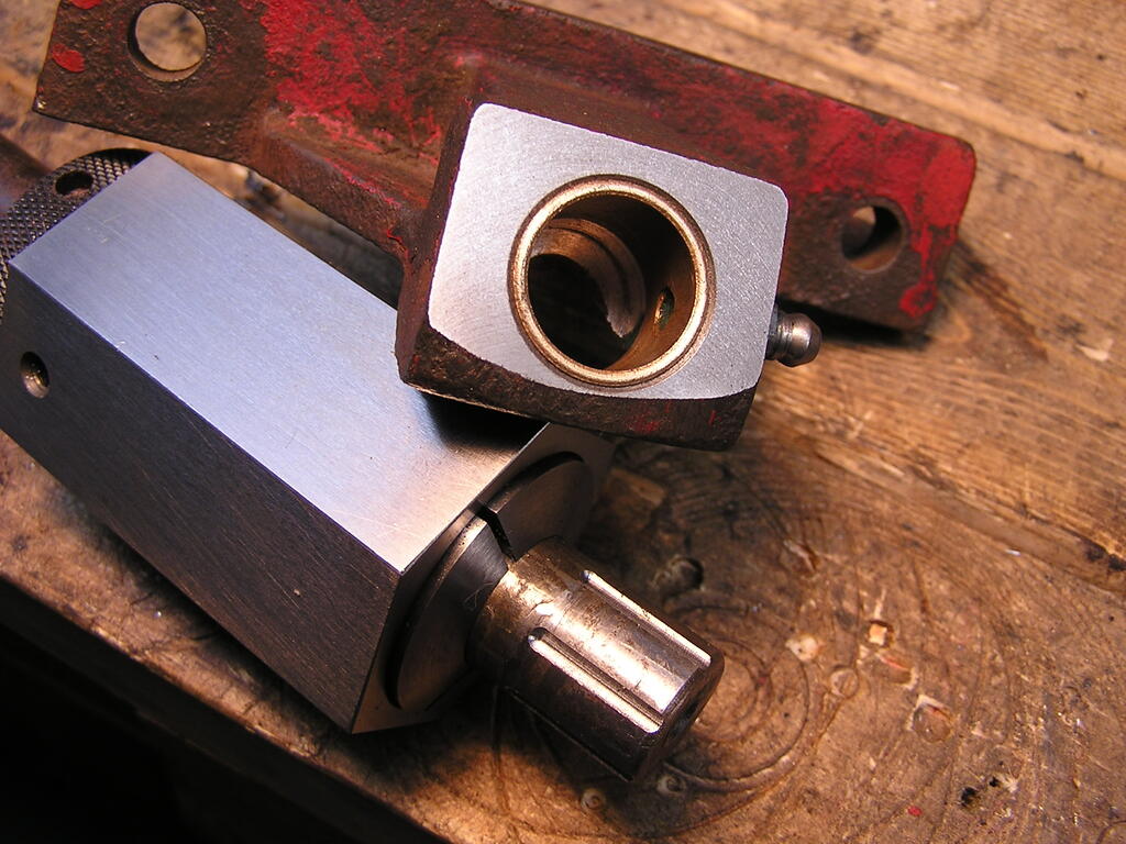

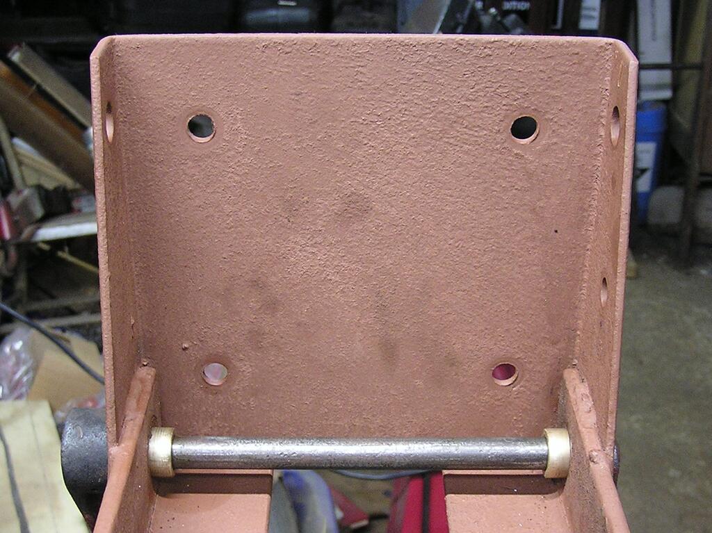

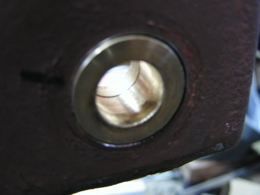

ri702bill 13,163 #2 Posted June 3, 2024 Nice... A 6 speed swap is a bit easier than an 8 speed swap. @Handy Don did a 6 speed swap on his 854, I did an 8 speed swap on mine. Six speed has the same size input shaft & pulley as a 4 speed the 69" drive belt stays the same; the brake drum & band are the same - no need to fabricate linkage. An 8 speed changes all that. You need to holesaw an opening for the Hi-Lo lever in the sheetmetal.... Bushings - I did several on the last 502.Flanged bushings for the clutch shaft, added a bushing in the upper portion of the lower block, added a bushing to the lower shaft - I do have a machine shop on site here... I undercut a shallow slot into the frame bushings to hold grease... added grease grooves in the steering shaft. Front axle bushings - done those too... 3 1 Share this post Link to post Share on other sites

ri702bill 13,163 #9 Posted June 3, 2024 (edited) 24 minutes ago, horseman with no horse said: as far as busing the frame goes how would i get the old bushings out? You will discover that the frame has NO bushings for the clutch shaft... metal on metal, and NO good way to lubricate it... The much later lower steering block comes with a non standard paper thin bushing for the lower shaft. NOTE - DO check the condition of the "F" plate on the frame where the Unidrive bolts on - all too often cracked & damaged... Edited June 3, 2024 by ri702bill 1 Share this post Link to post Share on other sites

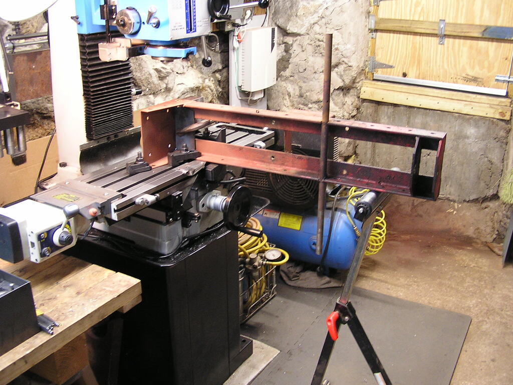

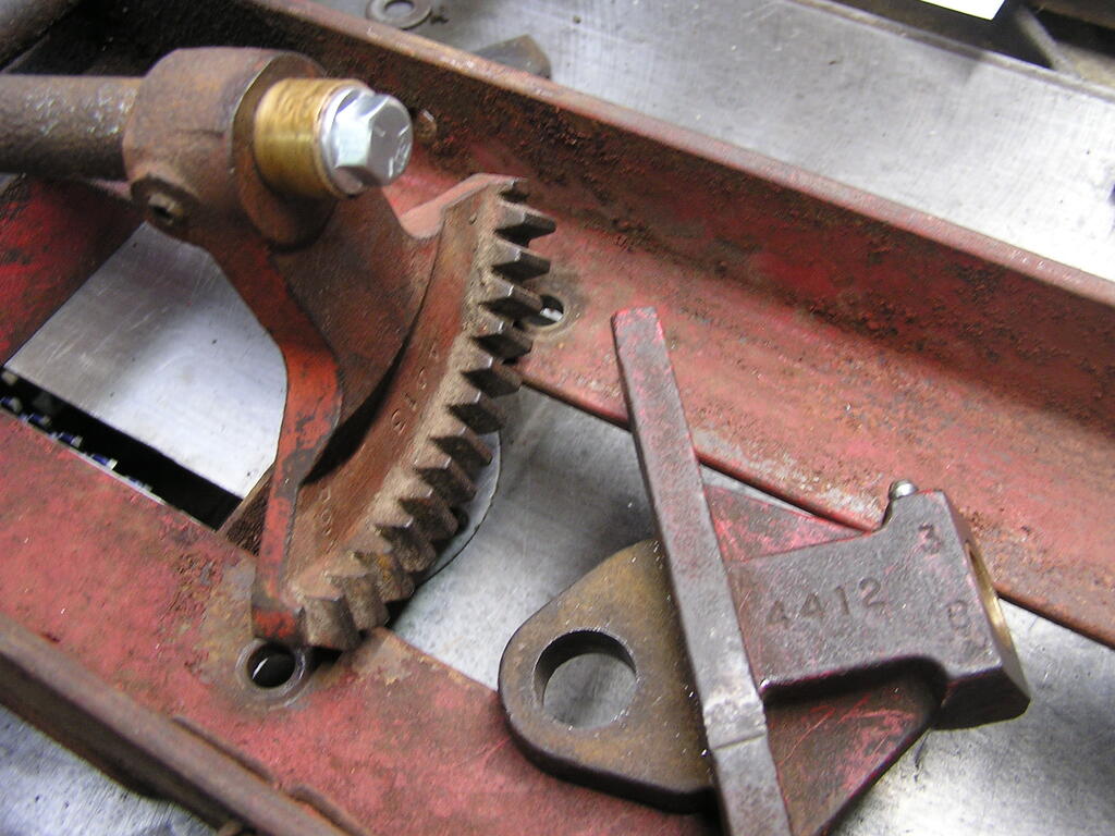

ri702bill 13,163 #11 Posted June 3, 2024 I did mine - inline - in a milling machine as pictured. There are folks that have opened up the frame holes with a tapered reamer. If your thru holes are all egg-shaped elongated, that may not be possible - good chance they would not end up truly inline...... 1 Share this post Link to post Share on other sites

horseman with no horse 68 #13 Posted June 3, 2024 15 minutes ago, ri702bill said: I did mine - inline - in a milling machine as pictured. There are folks that have opened up the frame holes with a tapered reamer. If your thru holes are all egg-shaped elongated, that may not be possible - good chance they would not end up truly inline...... im very unequipped to mill the frame sadly. what do you think my best option is? Share this post Link to post Share on other sites
ri702bill 13,163 #14 Posted June 3, 2024 Michigan should have a bunch of qualified Machine Shops to choose from. Other WH hobbyist in the area with the capability?? Won't be free, but asking is... Share this post Link to post Share on other sites

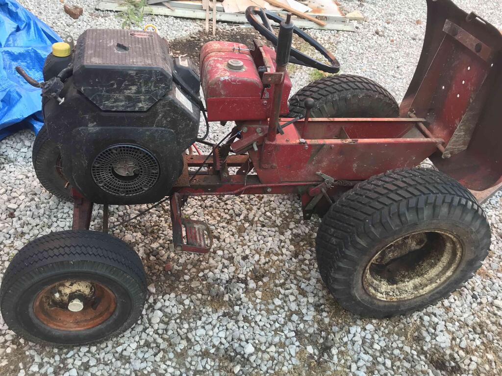

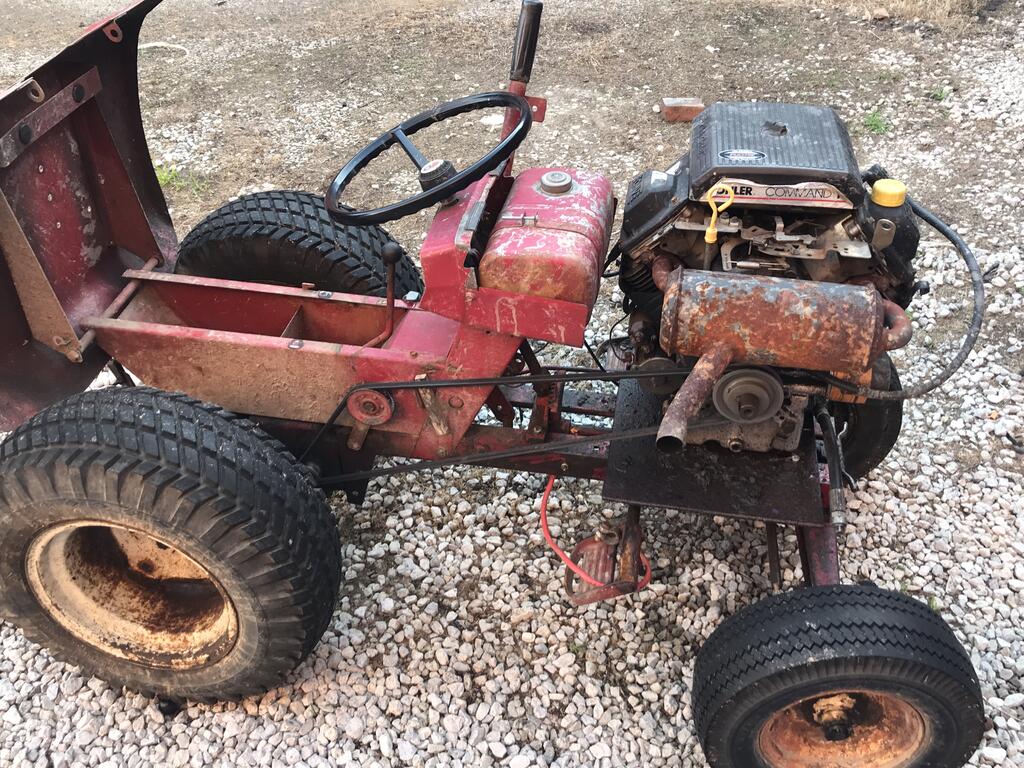

horseman with no horse 68 #15 Posted June 3, 2024 (edited) im gonna call up some shops tomorrow, for now heres some pictures and a video of the sad clutch on my speed horse that ive dubbed "ruby" Edited June 3, 2024 by horseman with no horse Share this post Link to post Share on other sites

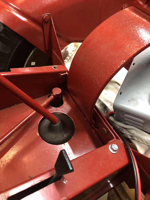

Handy Don 17,547 #17 Posted June 3, 2024 (edited) 4 hours ago, horseman with no horse said: so other than cutting the sheet metal on the frame to make space for the hi/lo shifter, the 6 speed would pretty much drop in? Yes. but be aware that the hi/lo lever attaches with a roll pin to which access is pretty tight and all but impossible once the fender support pan is in place. Plan ahead. (I had the hoodstand/tunnel off to do the hole cut and it was helpful to leave it loose until the transaxle was fully in place and the levers on.) 4 hours ago, horseman with no horse said: how would i check to see if its a 5060? I don’t think there is a way to identify the 5060 vs. the later version (5071) with the steel endplates without opening it up. Edited June 3, 2024 by Handy Don 1 Share this post Link to post Share on other sites

Handy Don 17,547 #24 Posted June 5, 2024 (edited) Here’s how the shifters fit in the 854. I wasn’t thinking about lever clearances at the dash/hoodstand end so I’ll get another picture today that includes that! (Don’t mind the charger, I figured I’d give the battery some juice while I was working on the seat since I haven’t had it out running for a spell.) Edited June 5, 2024 by Handy Don 1 Share this post Link to post Share on other sites
