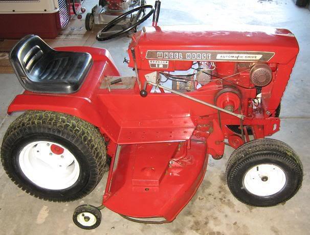

Tooonz 4 #1 Posted June 2, 2024 Hello I’m new to this group. I am looking to purchase another wheel horse. I had one about 17 years ago that was my father’s. It was a 1967 I think it was a model 600 or something like that basic tractor with an 8 horse Briggs. I loved that machine. Anyway fast forward I’m looking for another. I came across a charger 12 automatic. I know nothing about these transmissions. my uses use will be lawn mowing and using the plow to re grade some sections of my lawn. I used my father’s old tractor to do that and it was amazing with the plow. this machine has both the mowing deck and a plow. Exactly what I want but I am curious about the transmission. any help would be appreciated. Thanks in advance. Share this post Link to post Share on other sites

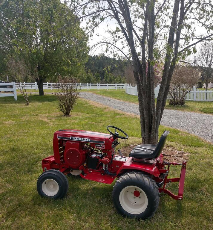

kpinnc 18,884 #2 Posted June 2, 2024 A hydro for mowing is a great option. No clutch to push and release for direction changes, and you have infinitely adjustable speed. So you can speed up in thin grass and slow down in heavy spots. The Chargers came with Sundstrand hydros. The three I've owned all had the earliest "hydrogear" version, as does my Bronco in the second pic below. So long as they were properly maintained (or possibly left alone), they are excellent. They came from the factory with ATF fluid, and later Wheel Horse released a bulletin allowing the use of 30W motor oil. Personally, I prefer ATF for it's wear and rust preventive qualities. The Chargers did not have hydraulic lift, though it can be added if the valve parts can be found. There should be a dipstick under the rear fender. You may need a wrench to loosen it. It should be clean, with no rust or garbage on it. If the fluid has a red tint, it's ATF. Motor oil will be brown. Either should be clear and clean. If the tractor runs, drive it around for a few minutes. It takes 5-10 minutes to warm up in summer weather. If you have a hill or good incline around, take it up and see if it maintains power throughout the climb. It might whine a little, but should power through to the point of spinning the wheels. It should also have limited slip, so it won't spin much like an 8-pinion. If it weakens climbing (after warming up) it's a worn out hydro. These can be rebuilt, but parts aren't easy to come by. Good luck! I hope it's a great find for you. I love my Bronco and the Charger that I gave my FIL (first pic). They are great machines. 4 Share this post Link to post Share on other sites

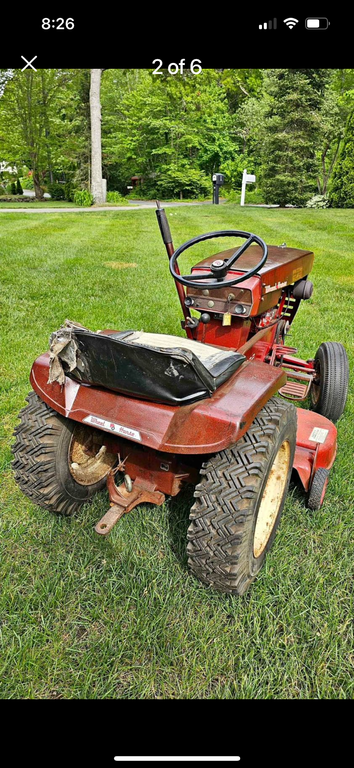

Tooonz 4 #4 Posted June 3, 2024 Thanks for the info , sounds like the hydro ( automatic) is great for mowing, how are they for pushing? Nothing crazy just pushing loam. If I remember my old one had 3 speeds and reverse. The pictures I posted below aren’t my tractor , but one that I just saw for sale, this resembles my father’s old tractor except the decals were different. However it was a barebones wheelhouse and that tractor was a beast. Same rear tires as this one below. We used to haul trees with that tractor. Would I be better off with a manual transmission for pushing dirt? 1 Share this post Link to post Share on other sites

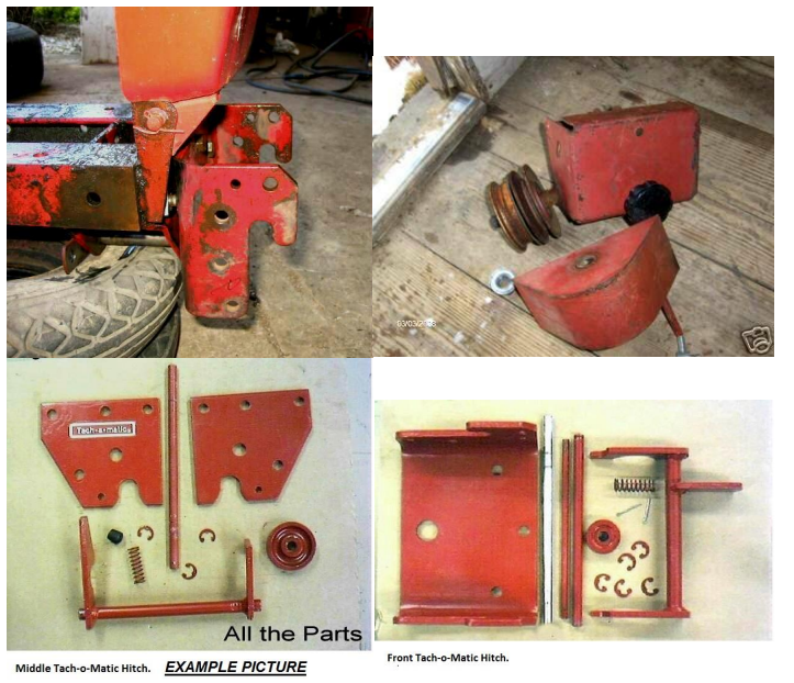

daveoman1966 3,884 #7 Posted June 3, 2024 (edited) The Charger 12 would be a good choice for anyone. The Sundstrand Hydrogear 90-2046 is more robust than the later Sundstrand Piston-to-Piston (90-1136 or 90-1140) that started in 1973. I think the Charger 12 also has the 10-pinion Limited Slip Differential. I like that b/c both wheels spin if in a 'stucky' situation instead of just one wheel (---or when pushing snow). Here is one (not mine) with a 48" deck. The only thing I'd do to the Charger 12 is to convert (upgrade) the deck pulley system from the old style side mule drive to the much better front mule drive. Here are the upgrade parts. PS---I have a FREE download of how to make this upgrade---takes an hour or so---NO WELDING. Edited June 3, 2024 by daveoman1966 1 Share this post Link to post Share on other sites

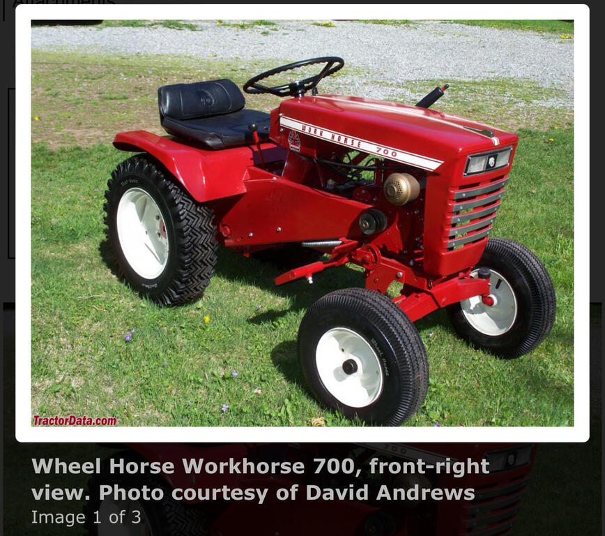

Tooonz 4 #10 Posted June 3, 2024 I finally figured out which tractor my father had. So this is all I know and have experience with. He had a workhorse 700. And if my memory is correct I believe it was a 67. No lights no chrome strips like this one lol. 1 Share this post Link to post Share on other sites

oliver2-44 11,694 #12 Posted June 3, 2024 As said the Charge is a great choice if it checks out. Just so your aware, the 700, 800 and A series tractors had a lighter duty transmission. They certainly could be used for light duty snow, dirt work. But not on a routine basis. Not the 3.4.6.8 speed "Unidrive" gear and hydro transmissions that was designed for snow & soil engaging work. 1 Share this post Link to post Share on other sites
Tooonz 4 #13 Posted June 3, 2024 Great info, we used that 700 to haul trees out of the woods when I was a kid, lol never had an issue with it . Looks like we were lucky. 1 Share this post Link to post Share on other sites

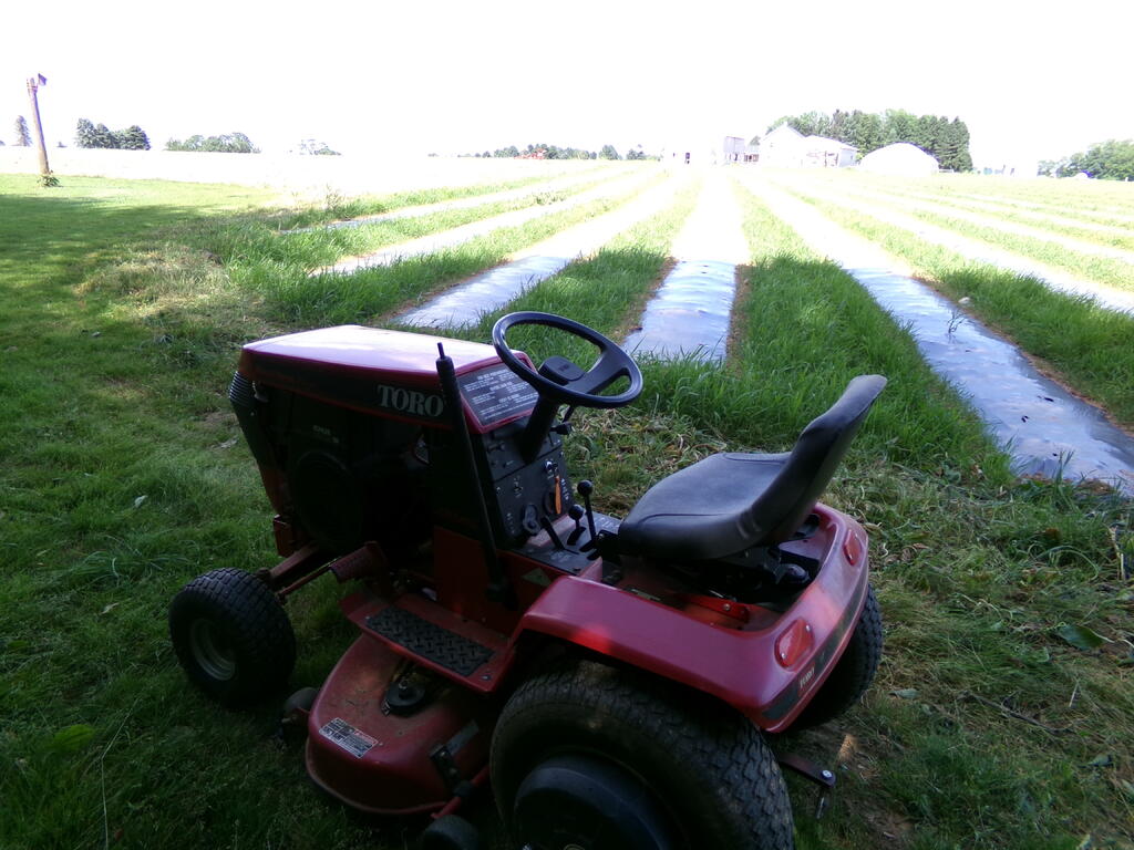

Ed Kennell 46,982 #14 Posted June 3, 2024 20 hours ago, kpinnc said: A hydro for mowing is a great option. I've used three foot controlled hydros for ten years. IMO, they are a necessity for snow work..plow and blowers. I also use them for mowing and also find the infinite motion a great feature. Last year I bought a 310-8 with a 42" SD and liked the way it cuts in wide open spaces. Unfortunately I have been mowing off the flowers, barking my fruit trees, and bruising up my arms on tree limbs. Seems my muscle memory tells me to raise my right foot to slow the tractor. Of course that does not work with a gear drive. 2 Share this post Link to post Share on other sites
