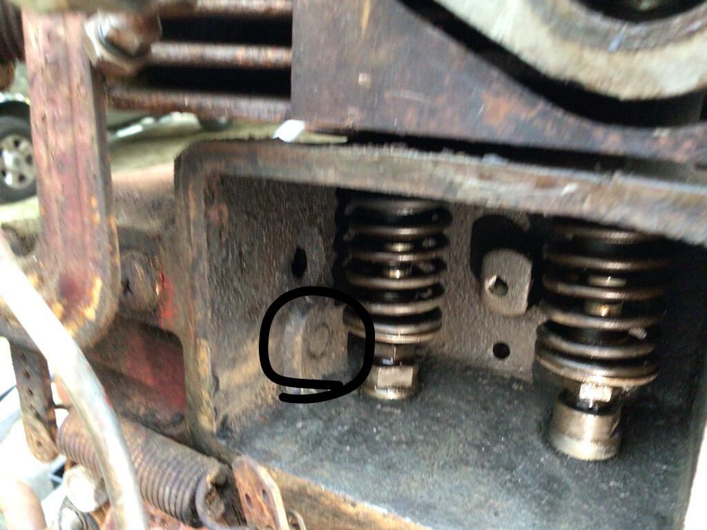

Rattlecan 68 #26 Posted June 4, 2024 Richmondred01, where is that in relation to the photos above? Have you seen this before or know what could cause it, what I need to look for? I sent you a text a couple hours ago wanting to ask you about this same thing. I am thinking that from when I met you before a few times you are one and the same person. Picked up rear attachment bracket belt and rock shaft from you a week or two ago. Thanks again all. 1 Share this post Link to post Share on other sites
richmondred01 2,383 #27 Posted June 4, 2024 7 minutes ago, Rattlecan said: Richmondred01, where is that in relation to the photos above? Have you seen this before or know what could cause it, what I need to look for? I sent you a text a couple hours ago wanting to ask you about this same thing. I am thinking that from when I met you before a few times you are one and the same person. Picked up rear attachment bracket belt and rock shaft from you a week or two ago. Thanks again all. 1 Share this post Link to post Share on other sites
richmondred01 2,383 #28 Posted June 4, 2024 (edited) The governor gear rides on this stud. call me if you have any questions Edited June 4, 2024 by richmondred01 1 Share this post Link to post Share on other sites
