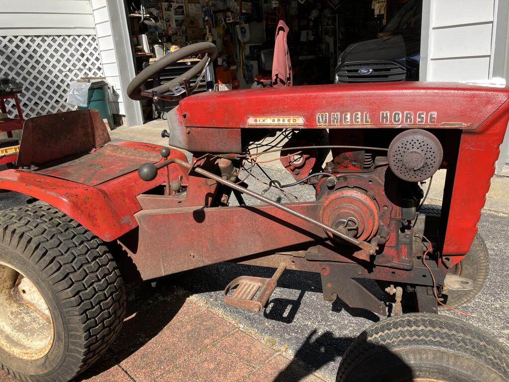

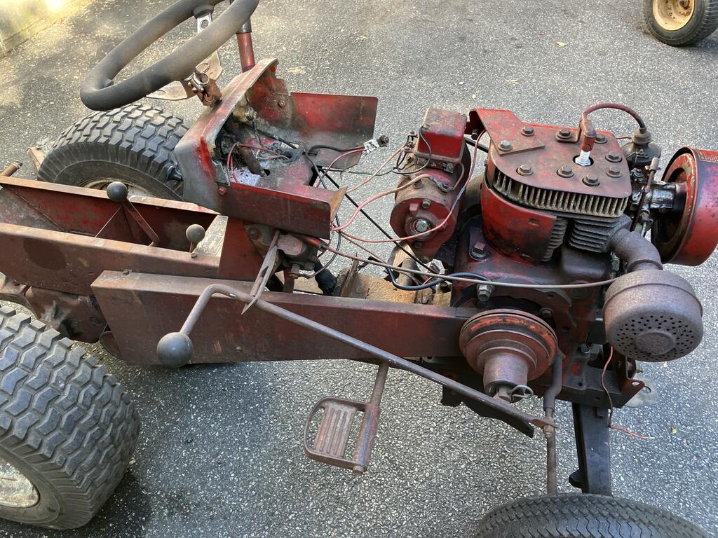

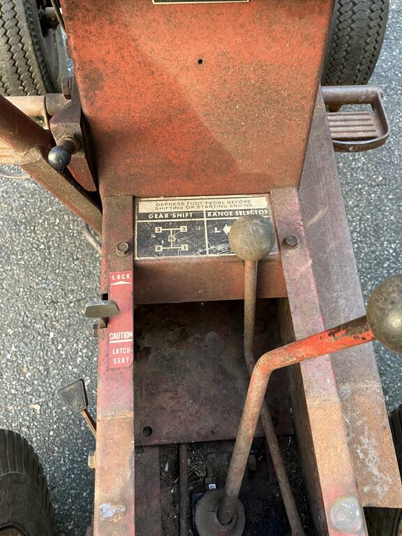

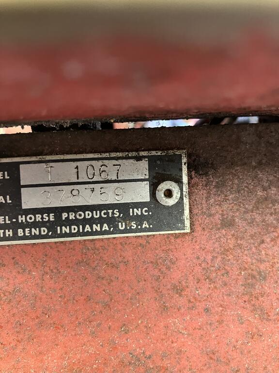

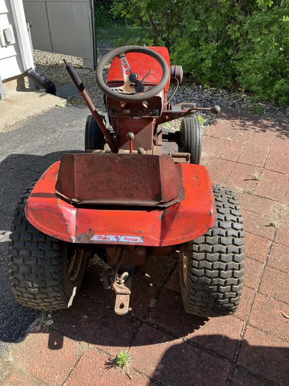

Retired Wrencher 6,989 #1 Posted June 1, 2024 I pick this one up from @Darb1964 about three weeks ago. It is ruff but That’s what makes it good when you have parts. So I have two in the works now a 1057 and this 1067. I like to keep busy with these fine tractors. Looks to be some one sprayed the hood and over the decals some what. I have some GOOF Of it worked well to get some of the paint off without ruining the decals. I hope you enjoy the picks. 7 10 Share this post Link to post Share on other sites
ebinmaine 80,755 #2 Posted June 2, 2024 Great worker Gary! 10 HP. 6 speed. Limited Slip Differential. Niiiiice. I'll be looking forward to seeing what you do with it. 3 Share this post Link to post Share on other sites
Handy Don 17,484 #3 Posted June 2, 2024 Hello Retired... This is a nice machine. One thing that caught my eye is the, to me, unusual mid hitch bracket. Do you have any more info about it? 2 Share this post Link to post Share on other sites

Darb1964 1,174 #5 Posted June 2, 2024 13 minutes ago, Handy Don said: Hello Retired... This is a nice machine. One thing that caught my eye is the, to me, unusual mid hitch bracket. Do you have any more info about it? The gentleman who bought that tractor new bought attachments that I was unable to find and probably were used up. I knew the gentleman my entire life and did not know he owned that tractor until after he passed and his family's sold his estate. One of the attachments was a power take off for running things like a hay elevator. I thought that Might be how it was attached. 2 Share this post Link to post Share on other sites

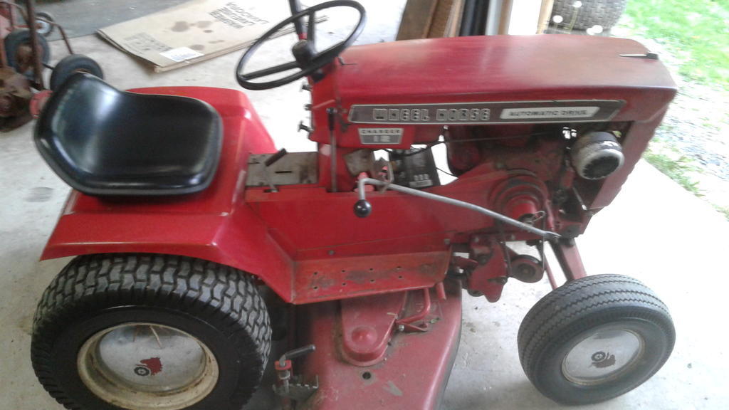

wallfish 20,618 #8 Posted June 2, 2024 (edited) 10 hours ago, Handy Don said: Hello Retired... This is a nice machine. One thing that caught my eye is the, to me, unusual mid hitch bracket. Do you have any more info about it? Shouldn't there be pulleys on that? The original type of mule drive for the deck? Like this ? Edited June 2, 2024 by wallfish 3 Share this post Link to post Share on other sites

rjg854 13,370 #11 Posted June 2, 2024 That is the bracket that holds the pulley for the mule drive. I have that same bracket on my Raider, but I lack the pulley also. My raider has been converted over to the newer style mule drive. 3 Share this post Link to post Share on other sites

squonk 48,137 #14 Posted June 2, 2024 21 minutes ago, ebinmaine said: @Maz91 was asking me about that conversion. How did you do yours? You need a regular mid tach o matic and frt mule drive adapter. 1 Share this post Link to post Share on other sites
Lee1977 7,782 #15 Posted June 2, 2024 11 hours ago, Handy Don said: Hello Retired... This is a nice machine. One thing that caught my eye is the, to me, unusual mid hitch bracket. Do you have any more info about it? I took one off my Raider 12 and mailed it to Trina for a tractor they were working on. Put a later model mid hitch on. 2 Share this post Link to post Share on other sites

Retired Wrencher 6,989 #18 Posted June 3, 2024 22 hours ago, wallfish said: Shouldn't there be pulleys on that? The original type of mule drive for the deck? Like this ? You are right John. It did not come with it. It will never have a deck on it as long as I own it. 1 Share this post Link to post Share on other sites

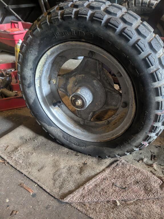

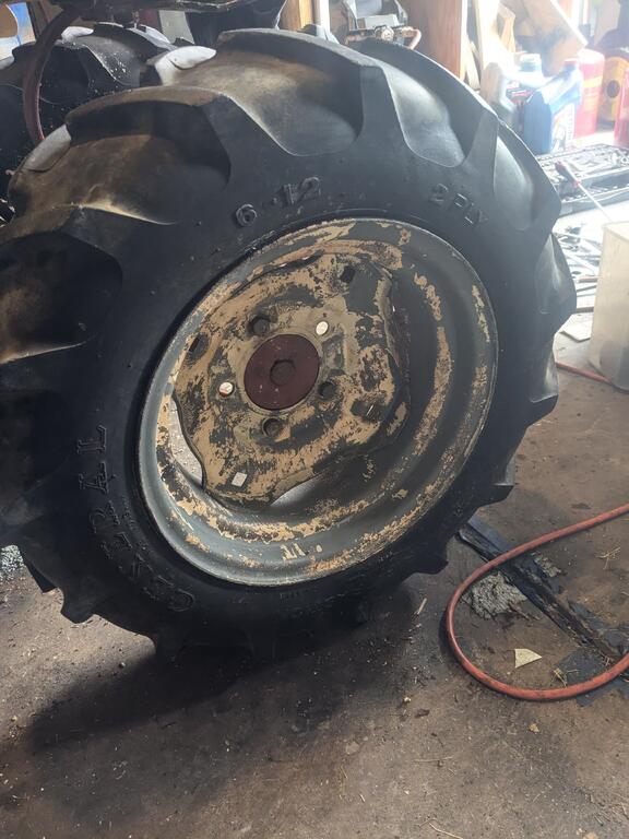

Treepep 1,151 #20 Posted June 26, 2024 On 6/2/2024 at 7:12 AM, wallfish said: Citrus paint remover works well too for getting the spay paint off. It's weak compared to the solvent strippers so it will remove the spray paint but not the original paint if you don't leave it on there very long. Citristrip Works great to remove the oxidation from old tires well. Never left it very long. Works wonderful on paint 1 Share this post Link to post Share on other sites
ebinmaine 80,755 #21 Posted June 26, 2024 24 minutes ago, Treepep said: Works great to remove the oxidation from old tires well. There's one I hadn't heard of. Share this post Link to post Share on other sites
Treepep 1,151 #22 Posted June 26, 2024 One application of citristrip. Lunch, garden hose. I'll leave longer and use the electric power washer to clean so I don't destroy stuff with the gasser washer 1 Share this post Link to post Share on other sites

Retired Wrencher 6,989 #24 Posted June 27, 2024 @Treepep thanks for the info. Do you use the power washer of just garden hose to remove paint. Share this post Link to post Share on other sites
Treepep 1,151 #25 Posted June 27, 2024 46 minutes ago, Retired Wrencher said: @Treepep thanks for the info. Do you use the power washer of just garden hose to remove paint. Just the garden hose with a fan tip for liquid fert application. works great. I will soak all and blast with the electric washer later when I decide what the heck I am doing. Share this post Link to post Share on other sites
