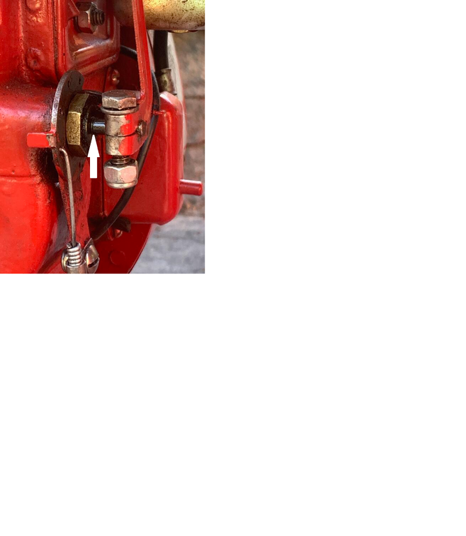

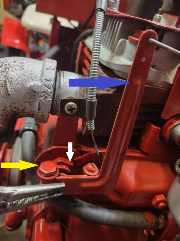

Achto 32,102 #6 Posted June 1, 2024 1 hour ago, jsp_333 said: If I tighten it down the bolt, the speed control disc doesn't rotate so I've got it loose enough to allow the disc to move. Is this the correct set up? The bolt by the white arrow should have a collar machined on the back of it. This allows the throttle plate to spin on it when it is tight. I have gotten the plate cocked a little not allowing free movement when the bolt is tight To adjust the governor, loosen the bolt by the yellow arrow, clip a small Vise grip on to the governor shaft and turn it counter clock wise. I leave the Vise grip hang to hold the shaft in this position. Move the governor arm "blue arrow" to hold the carburetor wide open. Tighten the bolt by the yellow arrow, remove Vise grip and the governor should be set. 3 1 Share this post Link to post Share on other sites
wallfish 20,225 #7 Posted June 1, 2024 1 hour ago, jsp_333 said: Thanks Achto, glad you mentioned the lock bolt (aka bushing nut) That one has always baffled me. If I tighten it down the bolt, the speed control disc doesn't rotate so I've got it loose enough to allow the disc to move. Is this the correct set up? The disk should still rotate with that brass nut locked down. The inside hole of the disk should ride on the shoulder of the brass nut. The throttle cable bracket is what gets pinched in between the brass nut and the block The lock nut Dan was referring to is the bolt and nut on the governor arm, not the brass nut. High rpm is set by the position the throttle cable conduit is locked down at. Share this post Link to post Share on other sites
WHX?? 57,455 #8 Posted June 1, 2024 14 minutes ago, Achto said: clip a small Vise grip on to the governor shaft and turn it counter clock wise. I leave the Vise grip hang to hold the shaft in this position. The vice grips weigh just enough to hold the gov shaft/arm against the fly weights when making this adjustment. If the throttle cable moved in the clamp that might have throw you off too. 1 Share this post Link to post Share on other sites

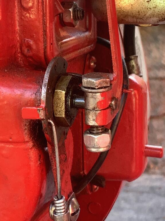

jsp_333 293 #10 Posted June 1, 2024 As always thanks to the group for the detailed and specific instructions. Photos with arrows take time and are greatly appreciated. Pictured is my set up. Don't know if it's visable but the "shoulder" of the bushing nut is facing the governor arm instead of the engine. Which would explain my speed control disk issues. I'll get the governor arm off and switch it around. I've pulled out the cross shaft for the photo - should it be all the way in or out or does it move with engine speed/ load? 1 Share this post Link to post Share on other sites
Handy Don 16,961 #11 Posted June 1, 2024 4 minutes ago, jsp_333 said: the "shoulder" of the bushing nut is facing the governor arm instead of the engine. Isn’t it amazing that a subtle and easy-to-make oops can really mess up the way something operates? Thanks for the extra picture! Share this post Link to post Share on other sites
jsp_333 293 #12 Posted June 1, 2024 Apparently my set-up is "good" No need to turn the bushing nut around. There is a shoulder on both sides. Speed control disc rotating as it should. I'm still going drop so oil between the two. Issue now is governor arm will not take the engine to idle. But Have to go to work for a few hours. 1 Share this post Link to post Share on other sites
wallfish 20,225 #13 Posted June 1, 2024 The governor arm needs to be set as described above in Atcho's post. 1 Share this post Link to post Share on other sites
Achto 32,102 #14 Posted June 1, 2024 2 hours ago, jsp_333 said: I've pulled out the cross shaft for the photo - should it be all the way in or out or does it move with engine speed/ load? There is a groove in the shaft that should have a snap ring on it. this keeps the shaft from sliding in & out. The groove is shown with the arrow. 2 Share this post Link to post Share on other sites

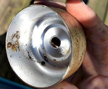

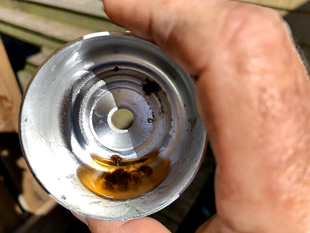

jsp_333 293 #20 Posted June 3, 2024 Pictures kinda tell the story. Carb bowl with crud in it and I consider myself pretty careful about using decent gas ($13.00 gal.) with stabilizer but lesson learned. She turned over and ran effortlessly. I drained the tank and ran the carb dry and put the rj away waiting for the snow. There's plenty of smart people here - any idea what that gelatinous ooze is in the far left of first photo. Share this post Link to post Share on other sites
wallfish 20,225 #21 Posted June 3, 2024 I don't know how that stuff grows in there. Glad you got her going Share this post Link to post Share on other sites
