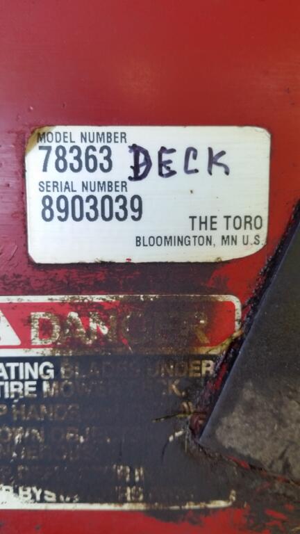

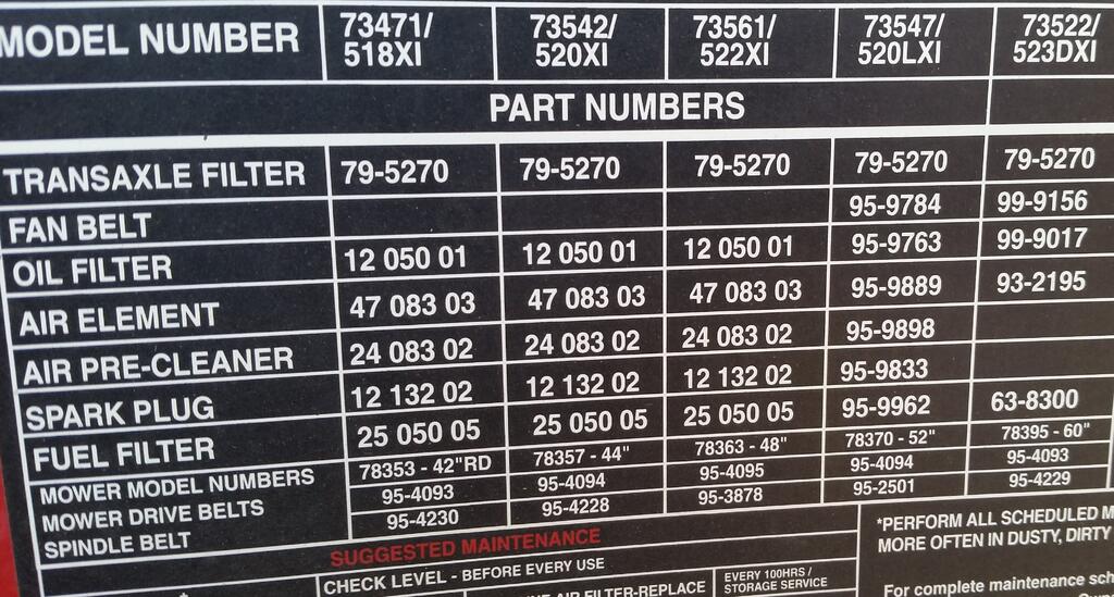

Xearl 132 #1 Posted May 30, 2024 (edited) I have a 523DXI toro with a 48 inch deck and am trying to find the DRIVE belt length a width . I have part no. 95-4093 and 105-1491 ? Edited May 30, 2024 by Xearl omission Share this post Link to post Share on other sites
gwest_ca-(File Mod) 12,349 #2 Posted May 30, 2024 48" SD deck Drive belt 95-4095 (HB x 97.54" or 5/8" x 97.54") - Used with adjustment knob on the front of the idler assembly Spindle belt 95-3878 (HA x 102.44" or 1/2" x 102.44") 48" SD deck Drive belt 105-1490 (HB x 98.45" or 5/8" x 98.45") - Used with adjustment knob on the bottom of the idler assembly Spindle belt 95-3878 (HA x 102.44" or 1/2" x 102.44") 95-4093 and 105-1491 are for the 78395 60" deck Would like to check the info above. What is your deck model and serial number? 1 Share this post Link to post Share on other sites
Xearl 132 #4 Posted May 30, 2024 I have a 523DXI with a 48inch deck. I need drive belt . Share this post Link to post Share on other sites
Xearl 132 #6 Posted May 31, 2024 (edited) 4093. diesel belt 95-4093 Edited May 31, 2024 by Xearl omission Share this post Link to post Share on other sites
