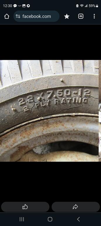

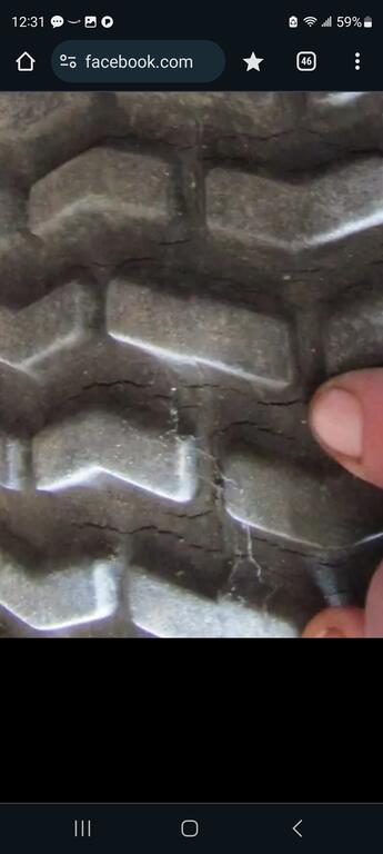

cmort 10 #11 Posted May 30, 2024 Wow, so many great replies. Thanks everybody. I think it makes sense to try to revive the old one first (with my son) as long as I can get tires for a reasonable price. My mom's place is an hour away so I won't be able to get to it right away. I will have someone check the back spacing of the original rims. Here is the set of tires I found listed for 100. They're a little bit cracked. What do you guys think? I couldn't find anything that would cost much under 300 when I first looked online, and at that point a used tractor might make more sense. Share this post Link to post Share on other sites
ebinmaine 79,513 #12 Posted May 30, 2024 5 minutes ago, cmort said: back spacing of the original rims. Should be around 1 3/8 to 1 1/2 inches backspacing. 5 minutes ago, cmort said: Here is the set of tires I found listed for 100. They're a little bit cracked. What do you guys think? Not sure if you're trying to stay with that particular size but you can definitely go up one. A 23 x 8.50 x 12 tire should fit that tractor just fine. That might open up your shopping range quite a bit. 1 Share this post Link to post Share on other sites
oliver2-44 11,611 #13 Posted May 30, 2024 To give you even a little more shopping range I run a 23x 9.5 x 12 on a 312-8 which is the same basic tractor 2 Share this post Link to post Share on other sites
wallfish 20,158 #14 Posted May 30, 2024 3 hours ago, cmort said: Here is the set of tires I found listed for 100. They're a little bit cracked. What do you guys think? I couldn't find anything that would cost much under 300 when I first looked online, and at that point a used tractor might make more sense. You could get brand new tires for a little over $50 each? And as mentioned 23 x 8.5 or 9.5 or 10.5 x 12 will fit on those rims https://www.walmart.com/search?q=23x8+5+12+tractor+tire Put tubes in the original tires maybe Or find them used like this https://albany.craigslist.org/grd/d/clifton-park-lawn-tractor-rims-and/7750219540.html 3 1 Share this post Link to post Share on other sites

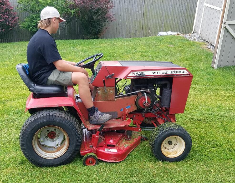

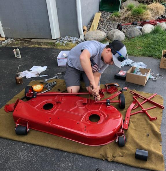

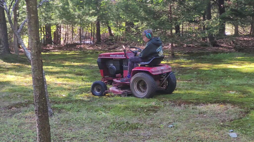

cmort 10 #17 Posted March 10, 2025 In light of the help I got from this forum, I thought I owed this thread an update, just in case anyone is interested. I actually wrote up a lengthy update in the fall but somehow lost it as I tried to post it, so I'm sorry for the delay. The old wheel horse lives! It was remarkably easy to fire it up again. The tires were another story. It was incredibly difficult getting the old tires off and the new ones mounted. I ended up only replacing the two flat ones, and I destroyed one of the rims in the process (the tire can't seal fully and leaks out slowly). I think I will never do that again. I also found another problem with the attachment of the mower deck that will take a trip to a welding shop to fix, but for now the tractor runs and mows. My son was thrilled to get to drive it and mow a little. Thanks again to the forum! 6 Share this post Link to post Share on other sites
