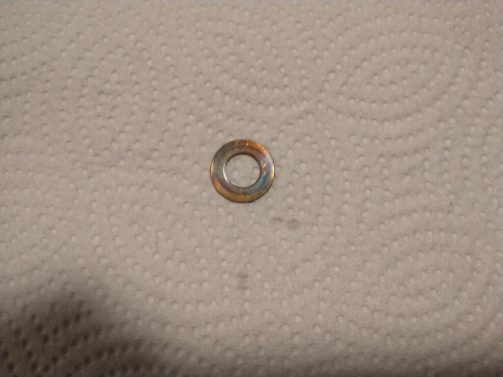

Chrishar 1,054 #1 Posted May 26, 2024 Have a Kohler k161 what kind for shim goes between the governor and the engine block I'm looking for one Share this post Link to post Share on other sites
squonk 48,207 #2 Posted May 26, 2024 (edited) Measure the od of the shaft it rides on . I believe the thickness is about.006" Edited May 26, 2024 by squonk Share this post Link to post Share on other sites
Chrishar 1,054 #3 Posted May 26, 2024 Is that the shim thickness Share this post Link to post Share on other sites
squonk 48,207 #4 Posted May 26, 2024 I may have a governor shim off of a bigger engine. I don't think there is any way to know the exact thickness without somebody having one I a drawer or finding a NOS one. Share this post Link to post Share on other sites
squonk 48,207 #5 Posted May 27, 2024 This is a shim from the gov. of a K321. I can't imagine a 161 shim is much different. Made of brass. OD is .75" ID is .40" Thickness is .03" Share this post Link to post Share on other sites
