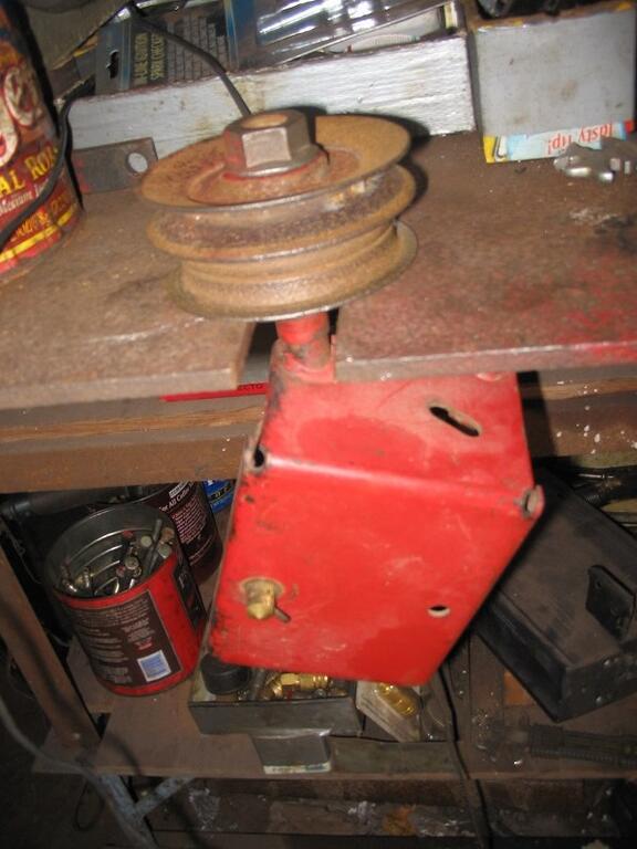

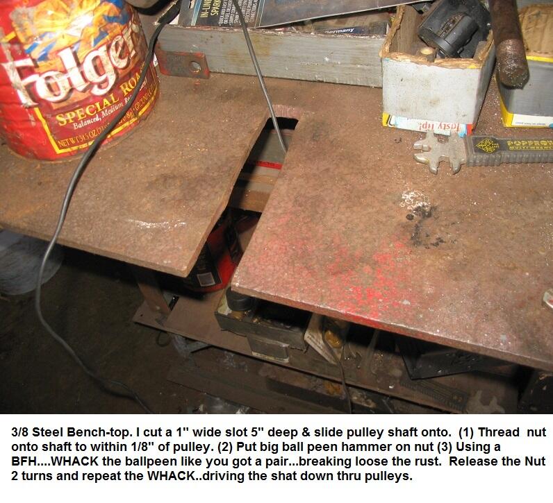

daveoman1966 3,884 #3 Posted May 26, 2024 I would not advocate heat to remove the pulleys....like to make lots worse. Here is what I do for the stuck pulleys. NOTE---be certain to thread the big retaining nut on the shaft. This hasn't failed me yet... 2 1 Share this post Link to post Share on other sites
ranger 1,862 #4 Posted May 26, 2024 1 hour ago, daveoman1966 said: I would not advocate heat to remove the pulleys....like to make lots worse. Here is what I do for the stuck pulleys. NOTE---be certain to thread the big retaining nut on the shaft. This hasn't failed me yet... Great set up. “PLEASE DO NOT” hit a hardened steel hammer with another hardened steel hammer! You run the very real risk of a trip to the emergency room, and could easily lose an eye! Use a piece of thick mild steel in place of the ball peen hammer, or hit the hammer with a big copper mallet. In any case, “ALWAYS“ wear a full face grinding type face screen, flying metal splinters are NO JOKE!!! 3 Share this post Link to post Share on other sites

tunahead72 2,658 #7 Posted May 26, 2024 @Gary S Minnesota I used a kinder, gentler variation of @daveoman1966's method once to successfully remove the pulleys from my mule drive. The key in his setup is supporting the pulleys well, I just used some wood blocks I had laying around. I removed the nut, and then sprayed liberal amounts of PBlaster on the threaded end of the shaft, several times during the course of one particular day. The next morning, all I had to do was gently tap the end of the shaft with a rubber mallet, one time, and the whole assembly slid apart. 1 Share this post Link to post Share on other sites
Pullstart 71,145 #8 Posted May 26, 2024 Whack the ballpeen like you got a pair. - Daveoman1966 Share this post Link to post Share on other sites
adsm08 5,058 #9 Posted May 27, 2024 On 5/26/2024 at 3:35 AM, ranger said: Great set up. “PLEASE DO NOT” hit a hardened steel hammer with another hardened steel hammer! You run the very real risk of a trip to the emergency room, and could easily lose an eye! Use a piece of thick mild steel in place of the ball peen hammer, or hit the hammer with a big copper mallet. In any case, “ALWAYS“ wear a full face grinding type face screen, flying metal splinters are NO JOKE!!! The king pin from a differential is a good drift. They are long enough to keep a good grip on, and aren't hardened, so they mushroom instead of shatter. Eye protection still highly recommended. 1 Share this post Link to post Share on other sites
