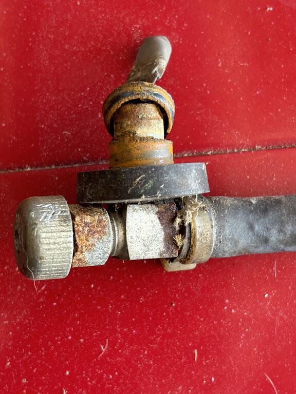

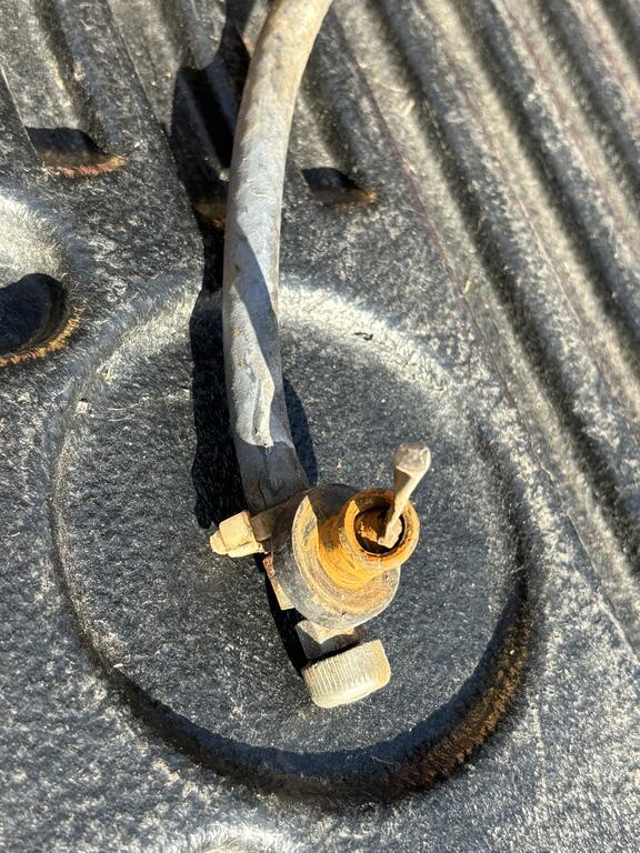

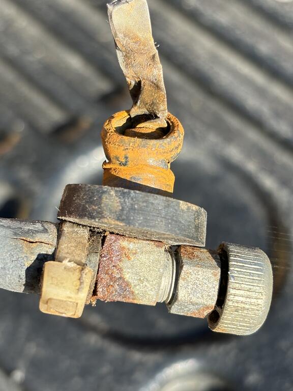

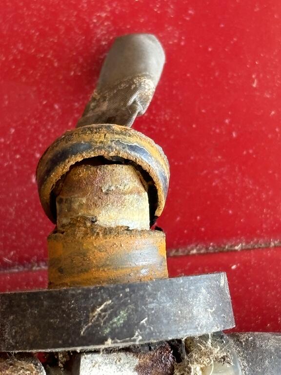

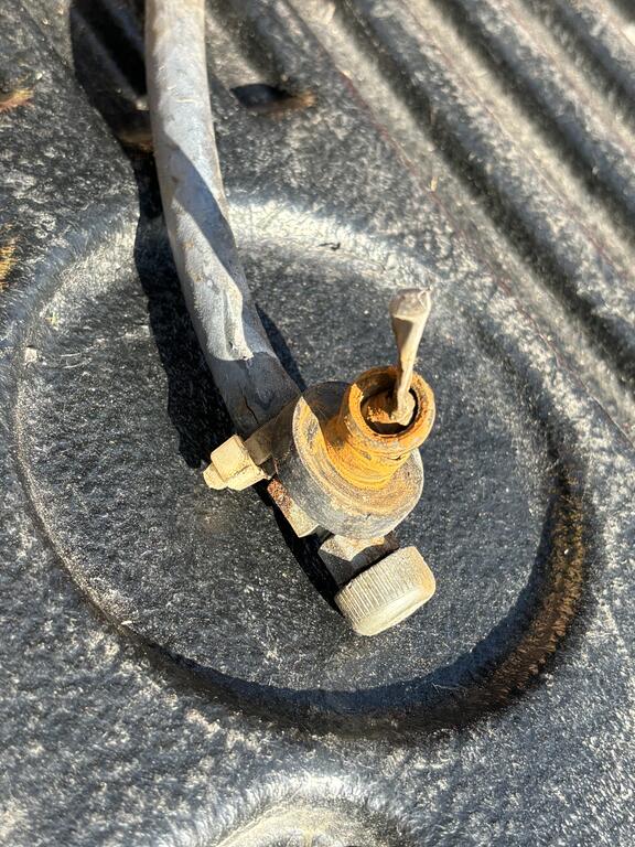

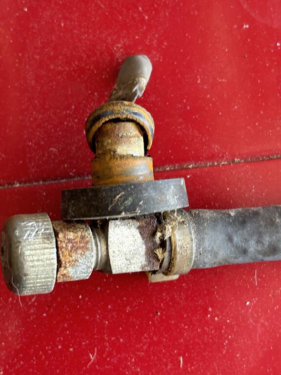

Lane Ranger 12,071 #1 Posted May 22, 2024 In the Wheel Horse late 1980 models and later Toro models with the rear gas tank under the seatpan these gas shutoff valves with built in screen were used. Very seldom do you really think about how this can be an obstruction to gas flow, the life of the unit, debris in the tank or failure of the screen to prevent carb debris, etc. These photos are of one I took out after years of use. These valves and grommets are readily available from various suppliers and I usually have one or two just in case ( we have five Models with this tank). But I am now going to check out each tank for internal looks at these for possible replacement! 8 2 1 Share this post Link to post Share on other sites

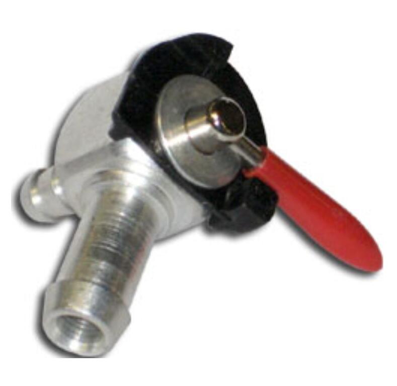

ebinmaine 80,088 #4 Posted May 22, 2024 We've seen at least a couple of that type in the slightly older models too. The B & C series with the fuel tank under the hood had/has them. One of the reasons I like the Aircraft Spruce valve is that I have a personal preference for the 90⁰ lever on/off. 8 2 Share this post Link to post Share on other sites

Retired Wrencher 6,903 #7 Posted May 23, 2024 Lane and Mike I just did that on a c81. I use an inline filter then Brigs 150 micron to the carb. Cheap insurance. The only thing I do not like is the fuel shut off knobs they seem to be cheap hard to turn and lot play in the knob meaning loose.. Other than that they work fine. 1 Share this post Link to post Share on other sites
ebinmaine 80,088 #8 Posted May 23, 2024 40 minutes ago, Retired Wrencher said: thing I do not like is the fuel shut off knobs they seem to be cheap hard to turn and lot play in the knob meaning loose That was why I changed over to the name brand and started using a 90° lever instead of the knob. Share this post Link to post Share on other sites
