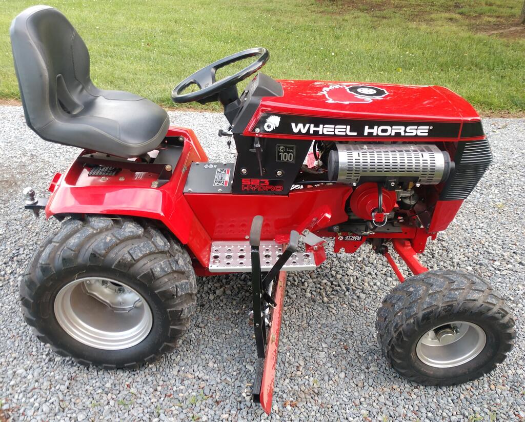

satinblack 0 #1 Posted May 21, 2024 (edited) Dealer I had said to use 30 weight in the engine and in the hydraulic Trans on my 20h rear.?? Edited May 22, 2024 by satinblack Hp Share this post Link to post Share on other sites
ebinmaine 80,278 #2 Posted May 21, 2024 What model? Share this post Link to post Share on other sites
kpinnc 18,884 #3 Posted May 21, 2024 (edited) On any "classic" Eaton hydro (as in the pic), that is a safe assumption. Go with Rotella 10W-30 or similar. On an older machine with a Sundstrand, it's more complicated. Those hydros originally came with ATF in the transmission. Later Wheel Horse said motor oil was ok, provided you get all of the ATF out first. Personally, I still run ATF in any Sundstrand. Edited May 21, 2024 by kpinnc 1 Share this post Link to post Share on other sites
squonk 47,887 #4 Posted May 21, 2024 Sunstrands changed to motor oil around 73. I run Mobil 1 10W40 in my 76 C-160. I used 10W30 in the 2 Eaton 1100's I had. 1 Share this post Link to post Share on other sites
