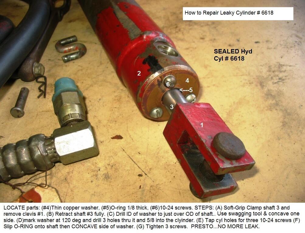

daveoman1966
The C-160 Auto is near 50 yrs old. (I have two of them.)   You see any drips on the deck or the floor. If so, you can do this to restore.  Otherwise, you'll need to replace it or cut it open to rebuild it.  It could also be the leaking int he control valve that is mounted to the side of the tractor. Do you see any leaks around this?...or the hose connetions. ??

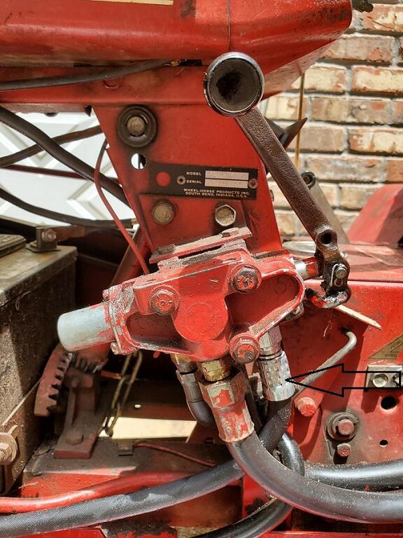

kpinnc
I believe this is normal. Even if you replaced every o-ring in the valve and cylinder, and all hydraulic lines, you'd probably still have seepage in the pump. This is a low pressure low volume system. Nowhere close to a standard 3000 PSI hydraulic system.
So long as you don't have external leaks, I don't think it's anything to worry about.

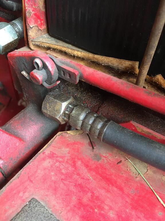

Thanks all. It could be fitting A/O cylinder. shoul I decide to service it where would I find parts?

pfrederi
It should be an ORB SAE#5 fitting.  If the O ring it self is bad you can replace that. If it still leaks the swivel in the fitting is bad you will new a new hose.  Wheel horse parts and More in the vendor section has hoses...

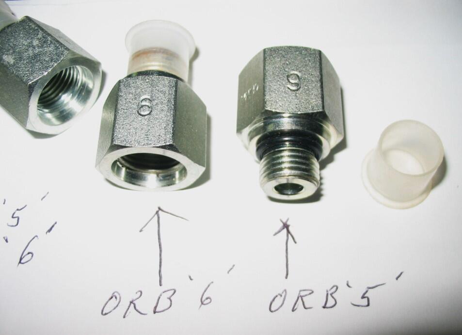

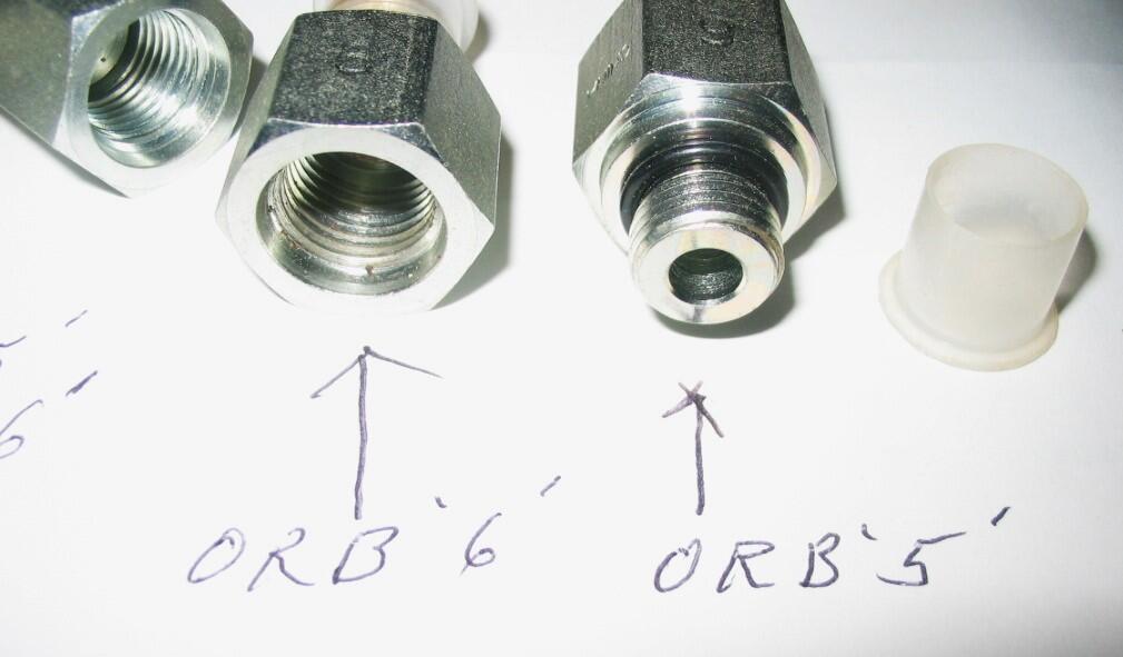

daveoman1966
I have FOUR  adapters to reduce ORB 6 Female hyd hose to ORB 5 male.  You can then use the more common ORB 6 hoses to adapt to these older ORB 5 valves, cylinders, etc.  These are NEW.  The adapter has ORB 6 female and ORB 5 male.
$10 each... Pair of the for $18....  All 4 for $32.  Add $5 to ship them in USA.  Pay via Paypal
