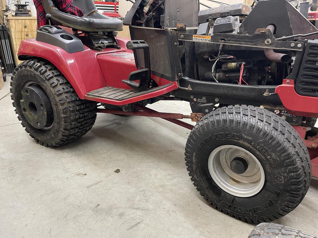

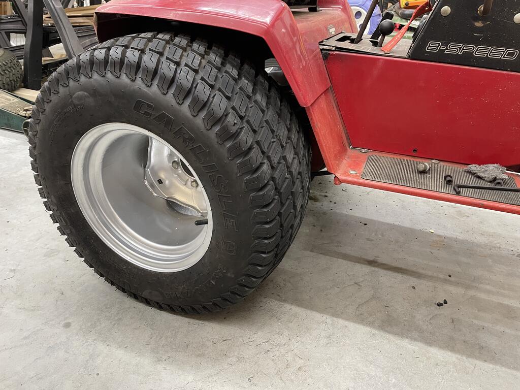

Fordiesel69 272 #8 Posted May 25, 2024 Could it be possible that the older 416 dash 8 with the Kohler magnum 16 single cyl not the twin would have the correct rims. I have one that looks like it might but I'm struggling to measure the rims being the tires are on it. They are a wider stance than all of my other 300 and 400 series. Share this post Link to post Share on other sites
