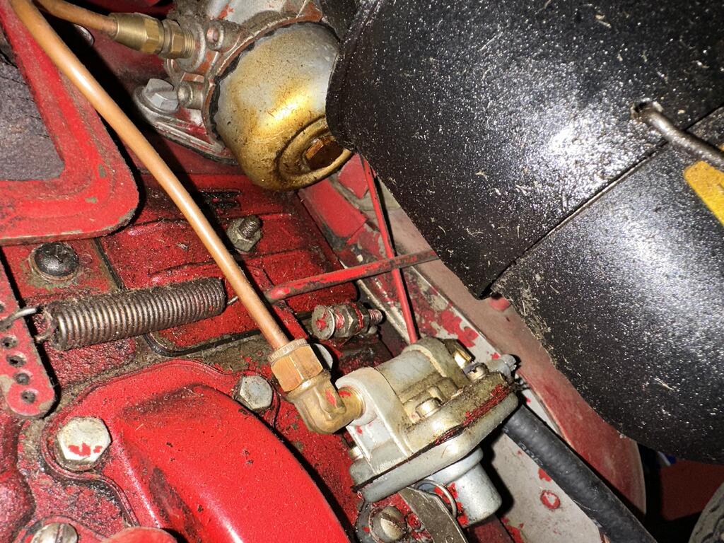

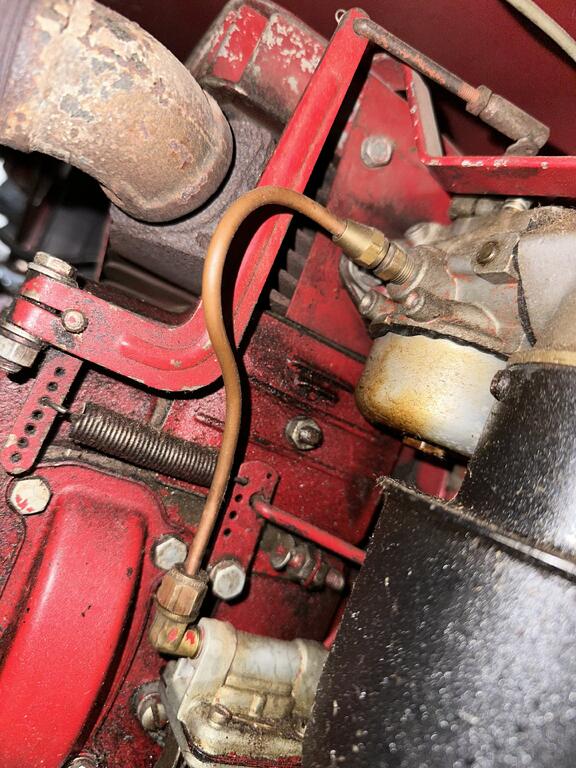

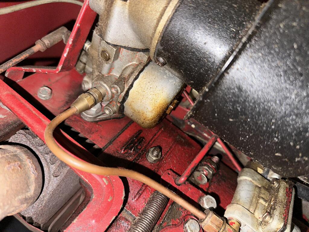

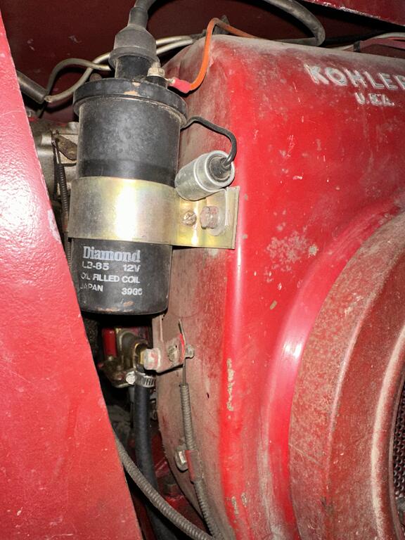

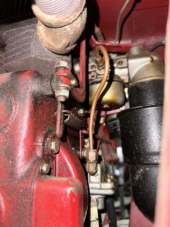

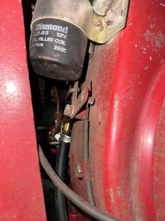

aaronthomas57 27 #1 Posted May 19, 2024 I recently purchased a 1054 that has been sitting for about 10 years. I can not get the front end of the engine back together. I'm dumb, and didn't take a picture of the complete setup before disassembly. I've rebuilt plenty of cars, but this is my first tractor, and I'm completely stumped. Any pictures or diagrams would be great. Thanks for any help. Share this post Link to post Share on other sites
Pullstart 69,171 #2 Posted May 19, 2024 what do you mean the front end? Carb, fuel pump, etc? Share this post Link to post Share on other sites

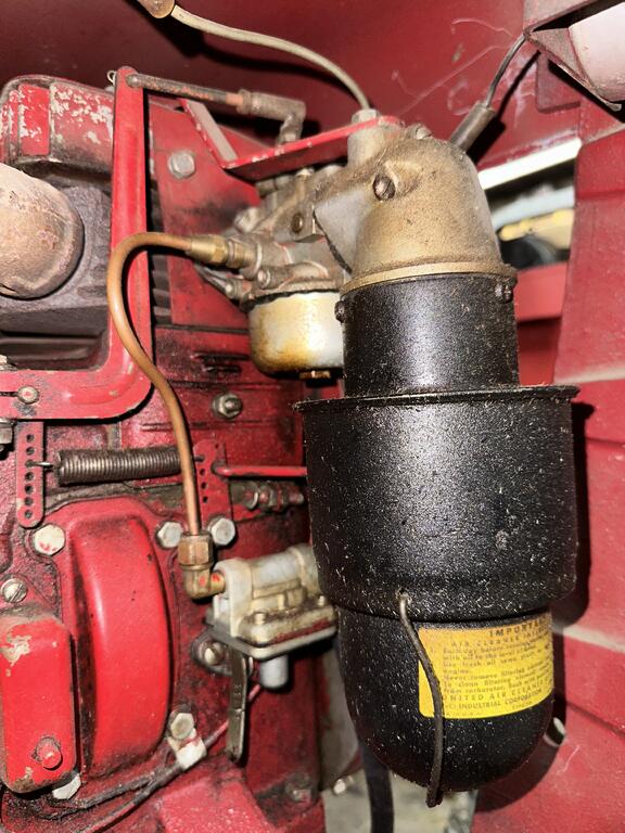

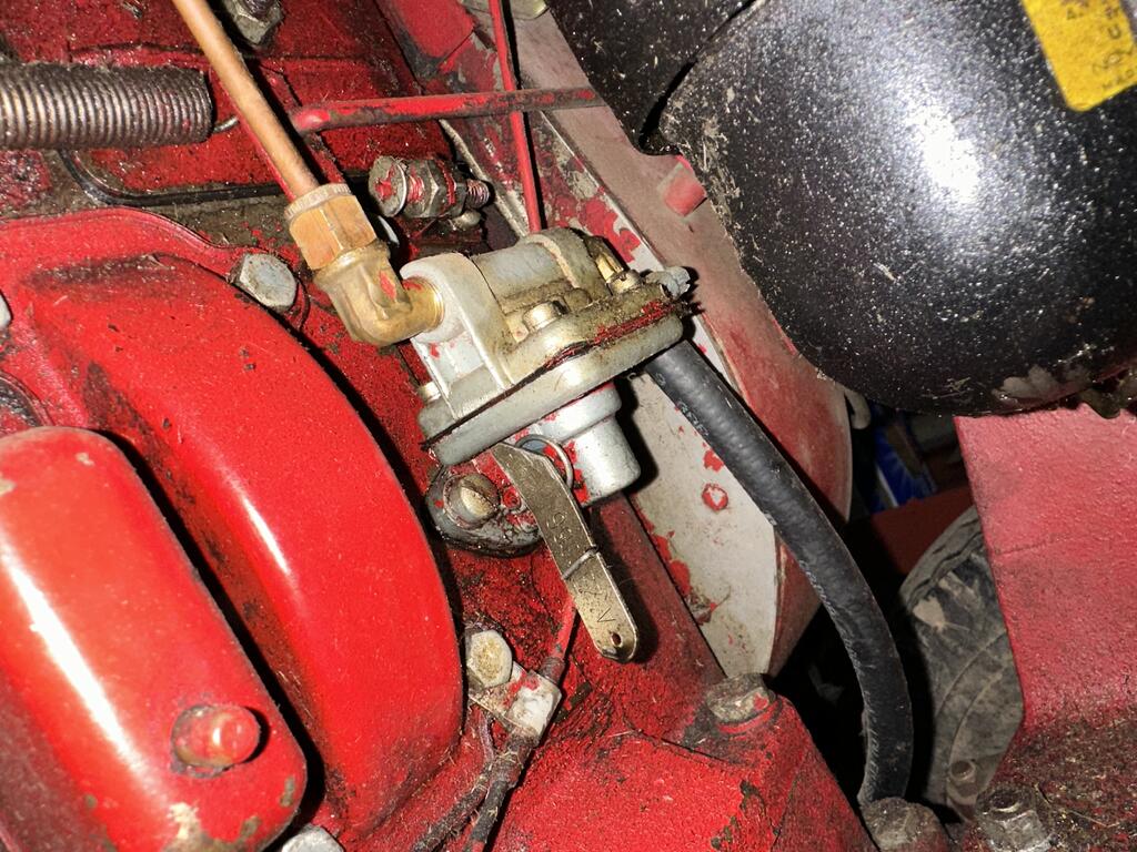

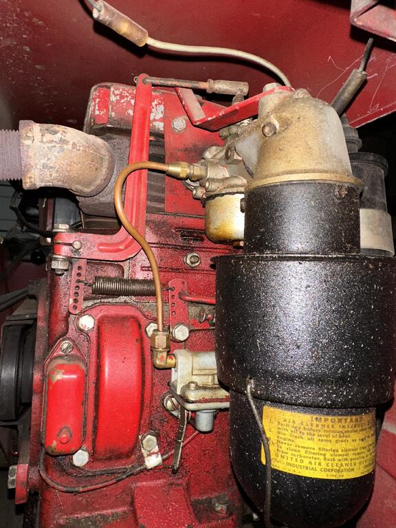

Pullstart 69,171 #3 Posted May 19, 2024 This is a 953, which should be the same thing, assuming that I think this is the front end. I grabbed lots of pictures hoping something might show you what you need. 5 Share this post Link to post Share on other sites

aaronthomas57 27 #7 Posted May 19, 2024 (edited) @Pullstart You are a god amongst men. Thank you so much! That's exactly what I needed. I've got piss poor memory and could not remember half the orientation of the hardware. I should've been more clear in my original post. Sorry about that guys. I was basically referring to the the accessories related to the outside of the engine behind the front face. Towed this bad boy home with my Delica last weekend and got too excited to tear into it. Thanks again everyone! Edited May 19, 2024 by aaronthomas57 4 Share this post Link to post Share on other sites
