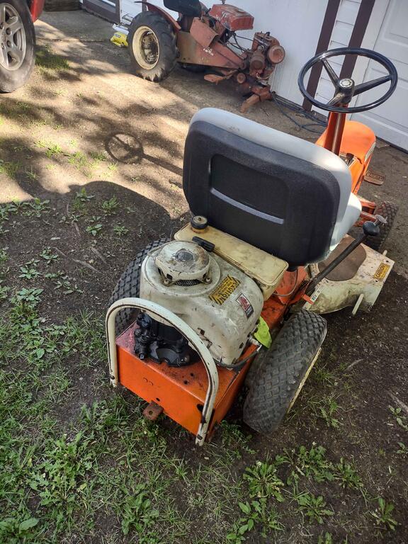

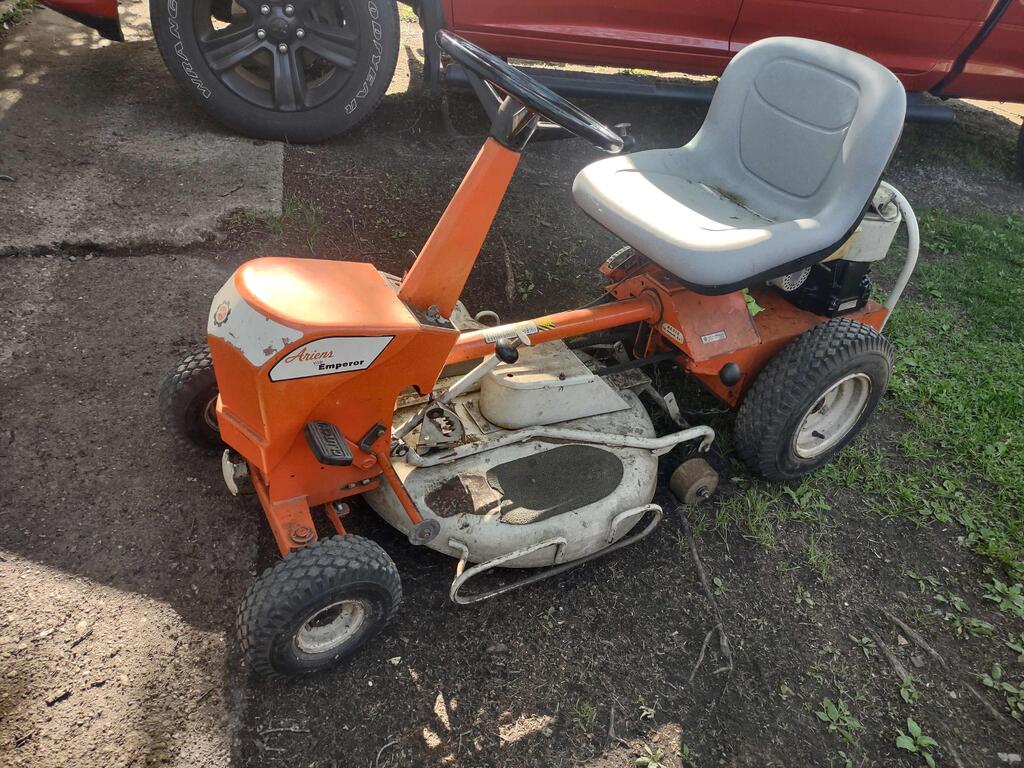

Achto 32,093 #1 Posted May 18, 2024 Can't say "No" if your not given the opportunity. What happens when you say I'm not going to buy any more tractors??? For some odd reason things still keep showing up at your door. Today I found this little gem in my yard when I got home from work. Even though it has a Techy, it's still pretty cool looking. NOW, what the heck am I going to do with it??? 4 4 8 Share this post Link to post Share on other sites

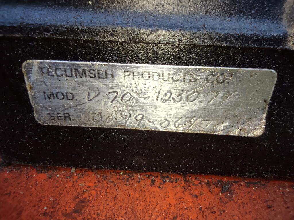

Achto 32,093 #6 Posted May 18, 2024 It is a pretty nice looking survivor, will most likely get it running "even though Techy's are my nemesis" and pass it on to someone who will give it some love. 4 1 Share this post Link to post Share on other sites
ebinmaine 79,632 #7 Posted May 18, 2024 I'll always have an appreciation for the older tube frame Ariens like that. The first machine of any kind I drove solo was a 60s vintage with a tiller steer. If I recall correctly.. I was the ripe old age of 6. 2 2 Share this post Link to post Share on other sites

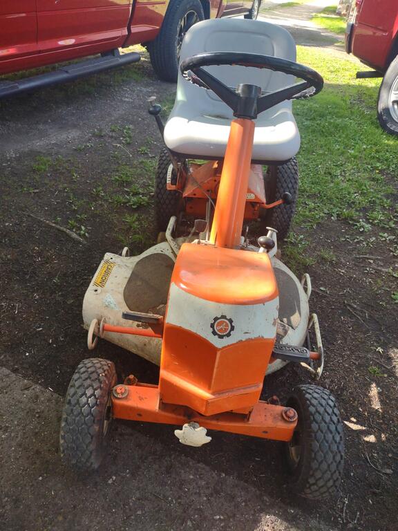

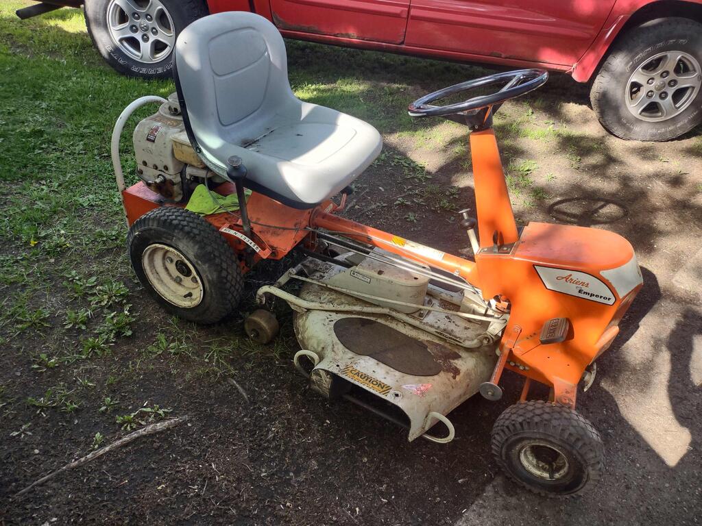

Achto 32,093 #15 Posted May 20, 2024 I had an opportunity to play with this mower a little bit today. Had no spark so I pulled the flywheel & cleaned the points. Still no spark. Pulled the flywheel AGAIN ( what a dumb design ) & cleaned the points. This time I used a multi-meter to ensure that they had good continuity to ground when closed. FINALLY obtained spark. . Cleaned the carb. Fixed the recoil so that it would retract the rope all the way in. Pulled the rope several times, flooded it a few times and then found the correct choke & throttle settings to get it running. It runs pretty good for a Techy, drives well, would even mow if I could figure out how to adjust the deck belt. Transmission has some weird aspects. When in neutral you can not push the mower, push the clutch in and you can easily push it where ever you want. With the engine running you can put it in neutral, let the clutch out and the tractor goes no where as it should. Now back to my search for a service manual for a model #3970 so that I can figure out how to adjust the belts. 3 3 Share this post Link to post Share on other sites
rjg854 13,178 #16 Posted May 20, 2024 Best of luck hunting down a manual. Sounds like your making headway on that mower. 1 Share this post Link to post Share on other sites
squonk 47,361 #17 Posted May 20, 2024 Friction disc trans. Maybe the clutch disengages the disc? 1 Share this post Link to post Share on other sites
Achto 32,093 #18 Posted May 21, 2024 (edited) Finally found manuals for this thing. So to adjust the belt for the deck - it's as easy as turning the white Insta-Hitch knob located on the front of the mower. Edited May 21, 2024 by Achto 2 5 Share this post Link to post Share on other sites
