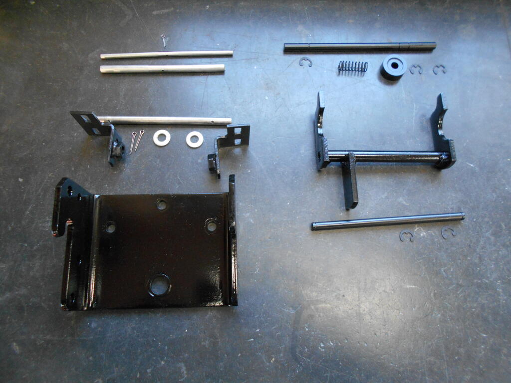

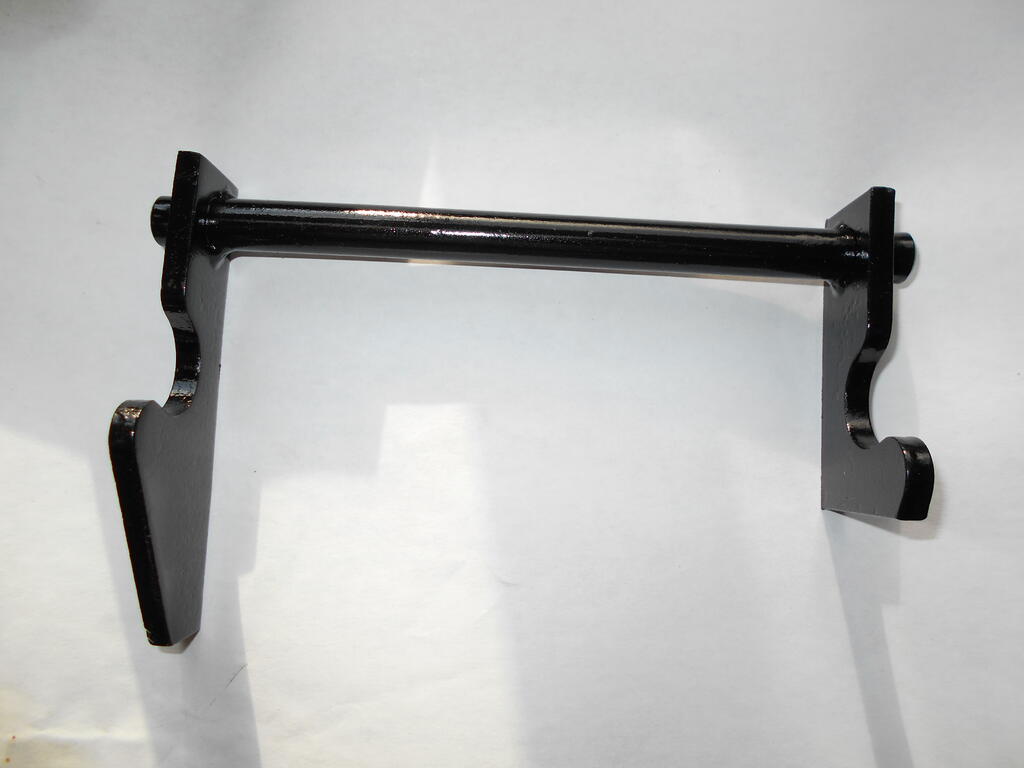

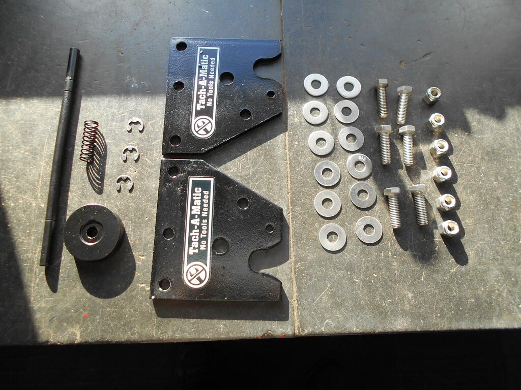

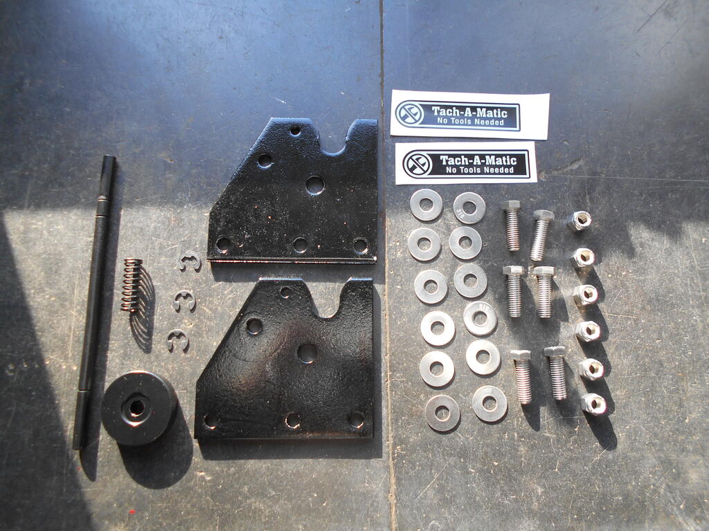

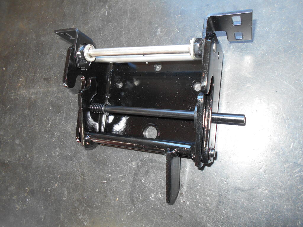

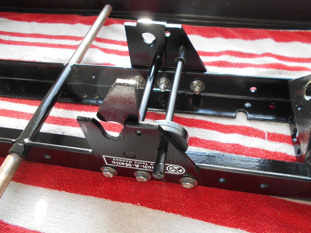

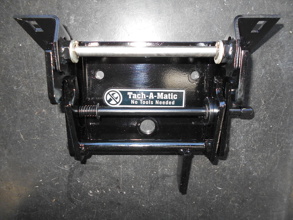

cleat 9,066 #207 Posted November 13, 2024 Assembled the front Tach and hood pivot assembly All parts laid out ready to assemble. Installed the latch lock assembly. Greased the latch pin then installed the front Tach latch Installed the hood stop pin. This is a different design that I came up with that uses a 1/4" rod inside 3/8 tubing with a cotter pin in the center to hold everything in place. The factory design has the hood pivots hit the cotter pins when tilted open. Installed the hood pivot brackets and pin assembly. The pivot brackets were badly worn so nuts were welded on then drilled out to provide a nice tight hinge action. Front Tach lock shaft grip installed. Front Tach decal installed. 3 5 Share this post Link to post Share on other sites
kpinnc 18,769 #208 Posted November 13, 2024 4 hours ago, cleat said: Assembled the front Tach and hood pivot assembly I mean this the best possible way, and I am not pushing sunshine here: You could create a “proper restoration” thread with your restores. Your work is awesome! the front hitch on my last resto worked fine and it got painted in one pass along with the frame. Yours will function “as new”, as it should be! 1 1 Share this post Link to post Share on other sites

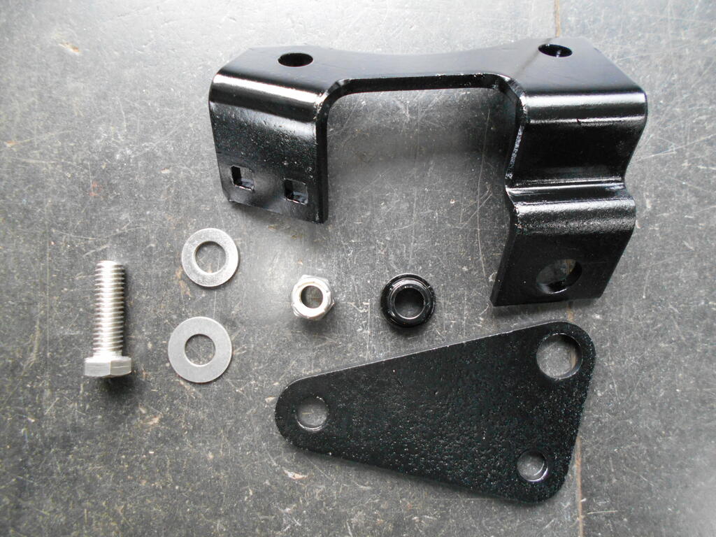

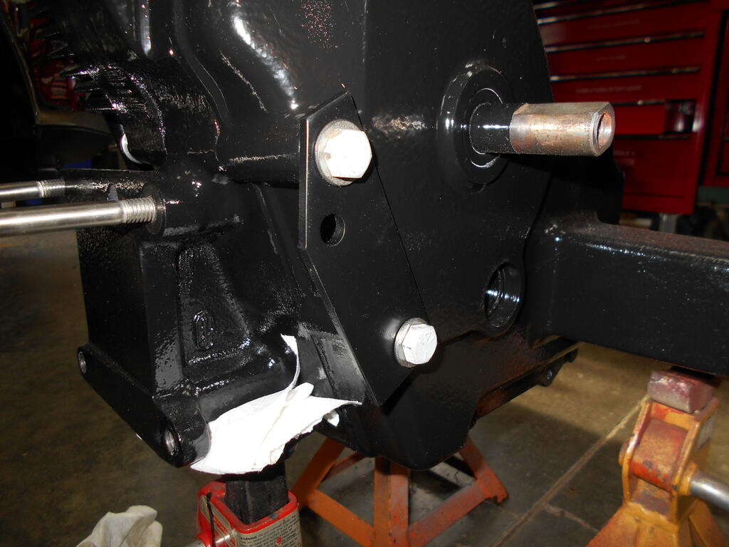

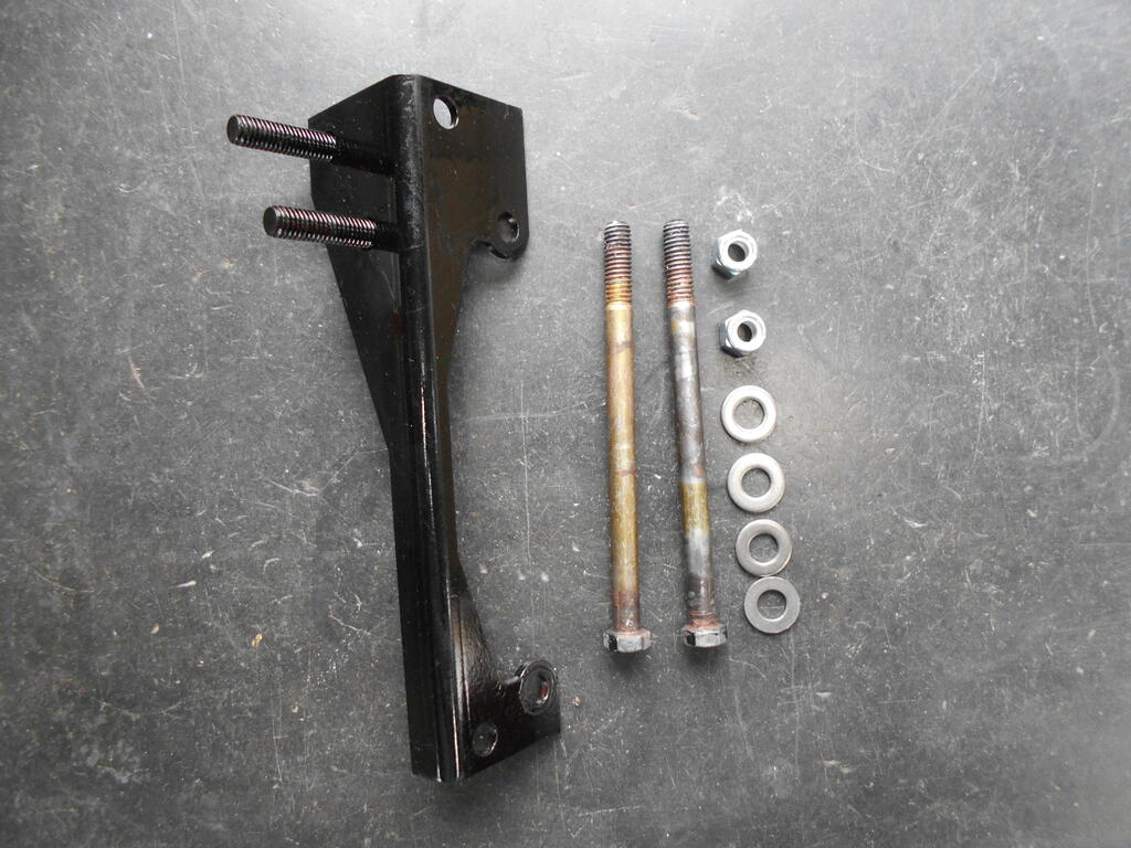

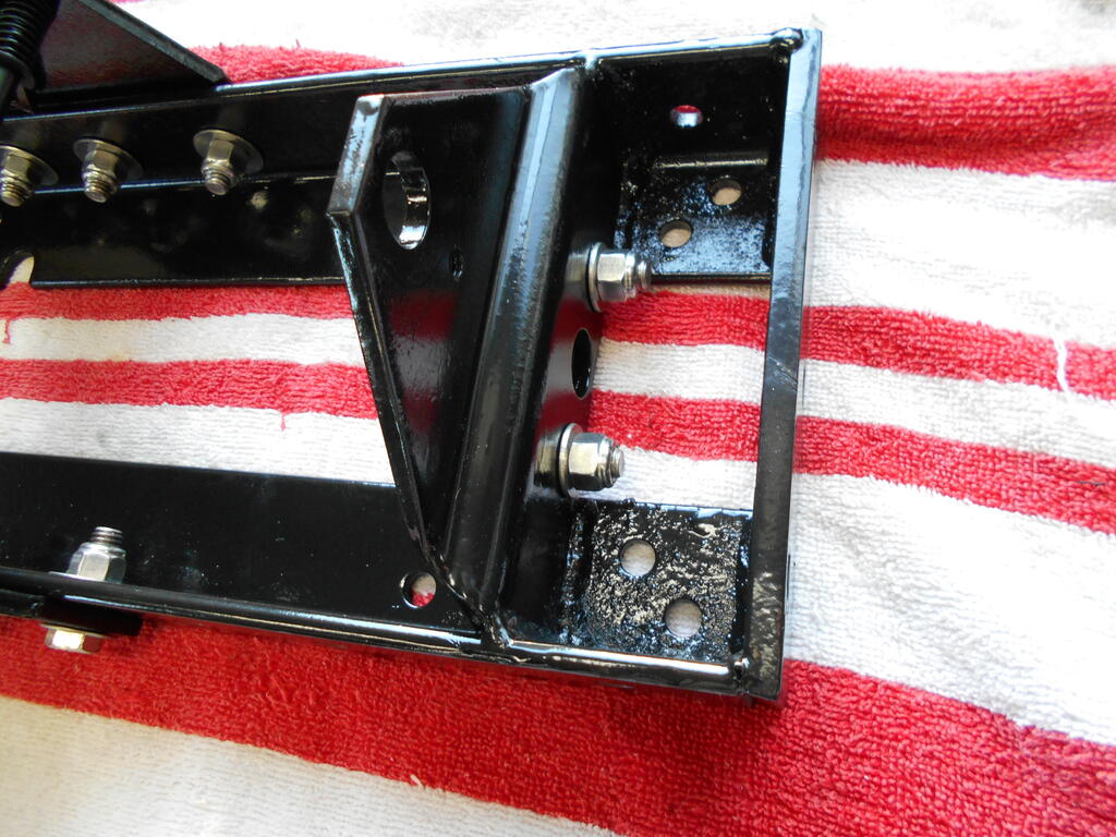

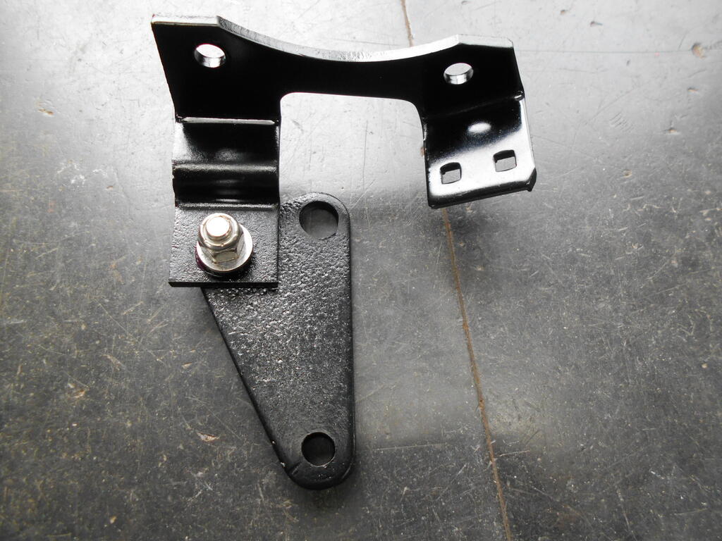

cleat 9,066 #210 Posted November 14, 2024 Brake bracket ready to install. Brake bracket installed. 1 3 Share this post Link to post Share on other sites

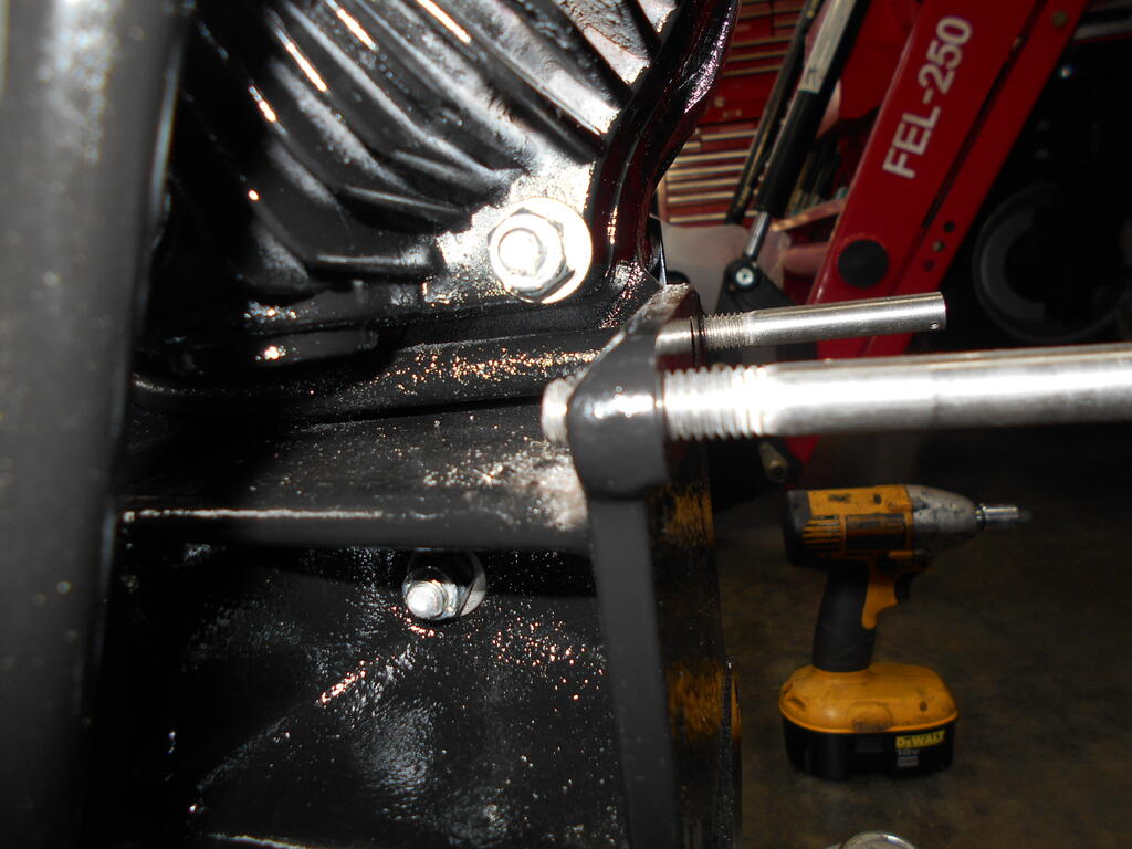

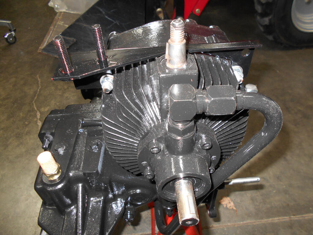

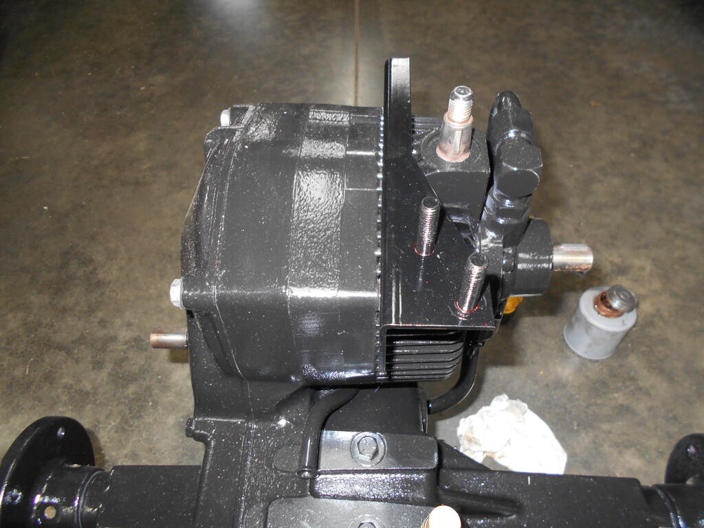

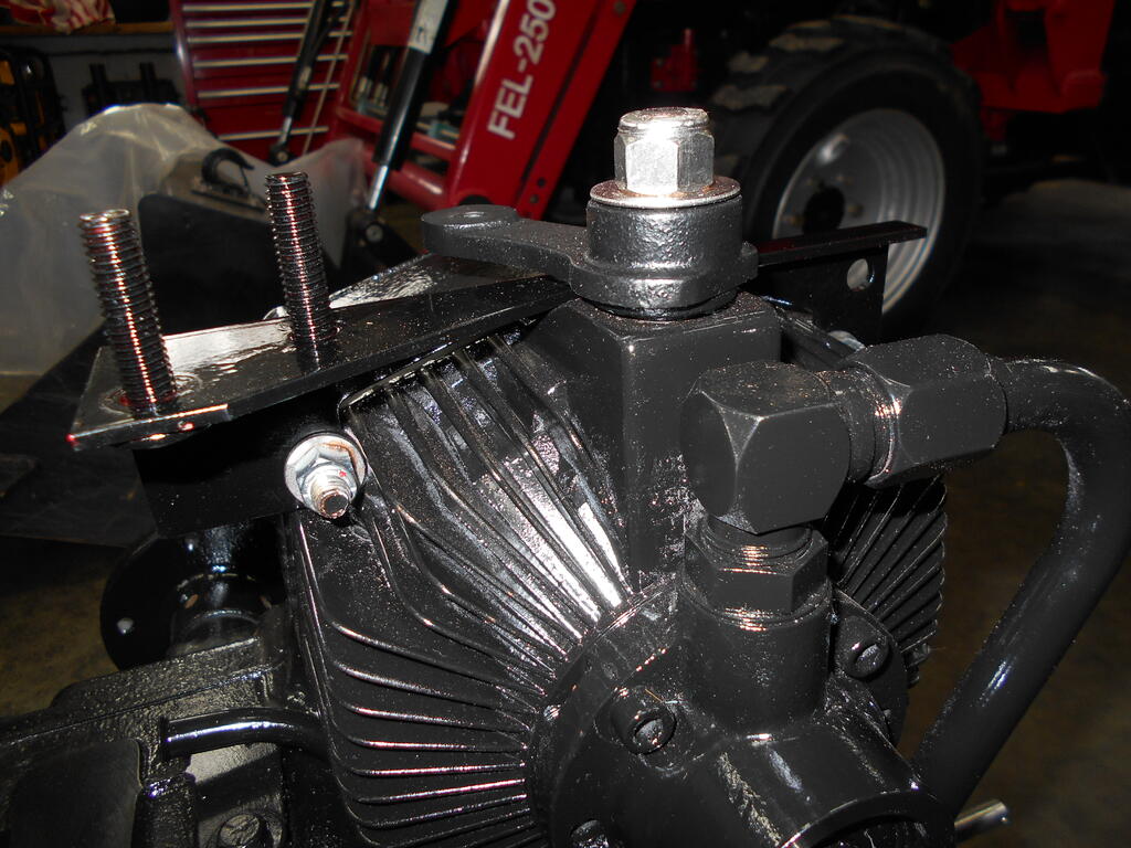

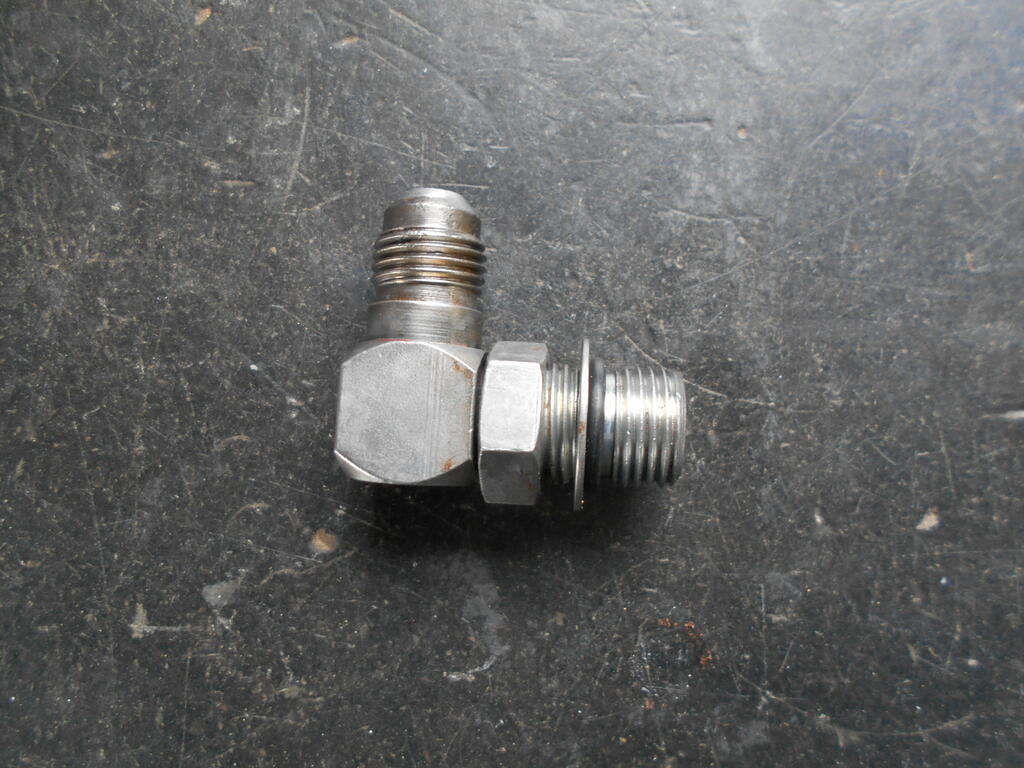

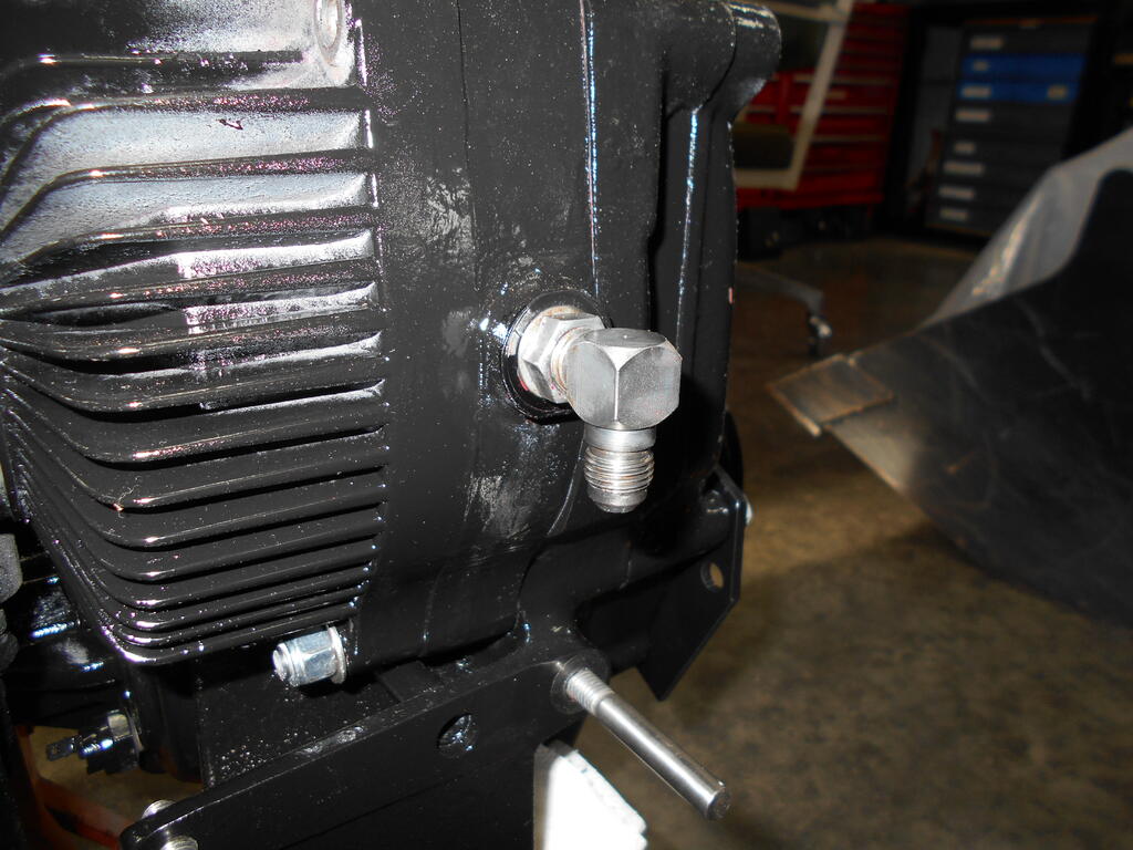

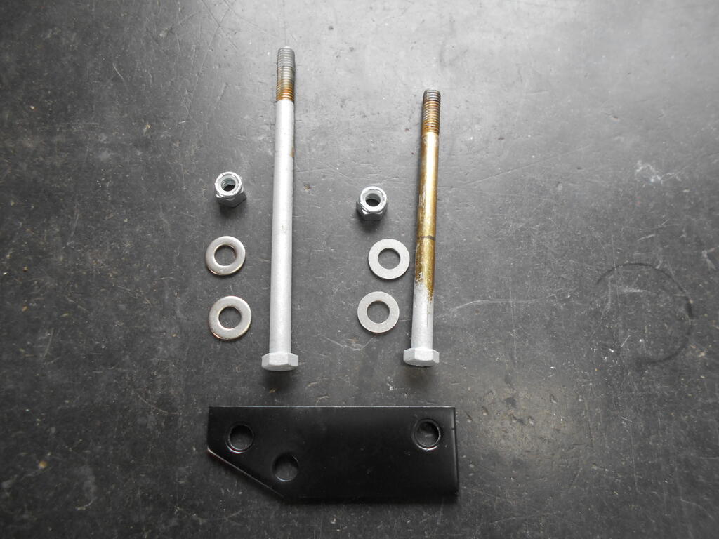

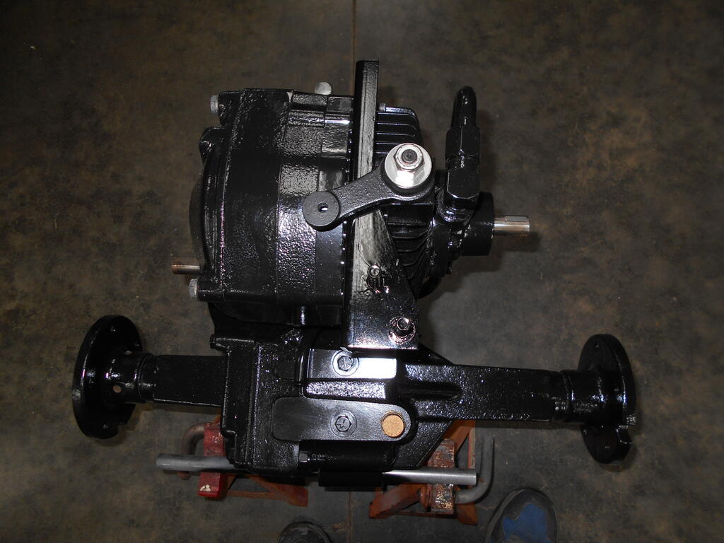

cleat 9,066 #211 Posted November 14, 2024 Hydraulic fitting ready to be installed with new O ring. Hydraulic fitting installed into rear end and lightly snugged. 4 Share this post Link to post Share on other sites
cleat 9,066 #212 Posted November 14, 2024 Motion control plate ready to install. Motion control plate installed. 4 Share this post Link to post Share on other sites

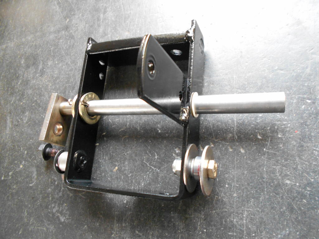

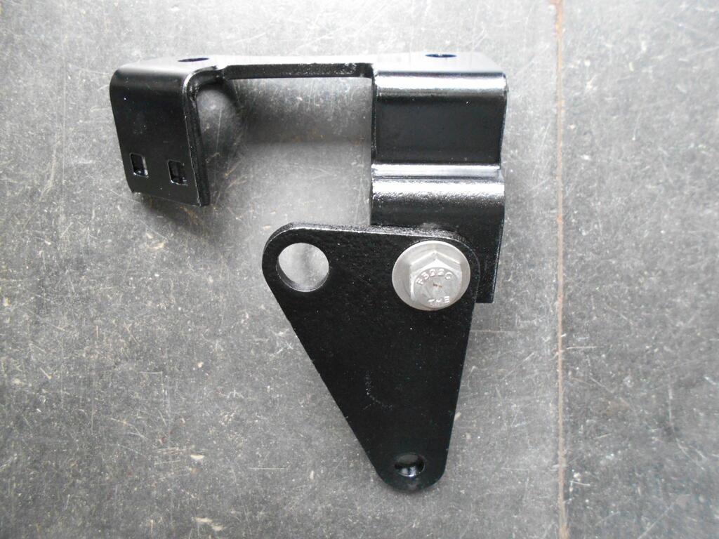

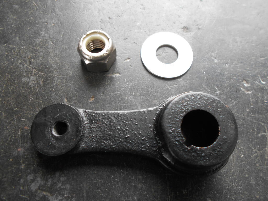

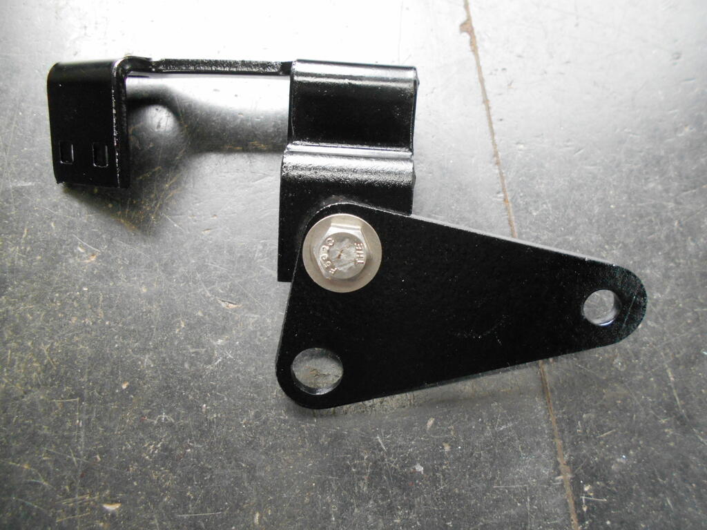

cleat 9,066 #213 Posted November 14, 2024 Cam follower arm ready to install. Cam follower arm installed. 2 4 Share this post Link to post Share on other sites

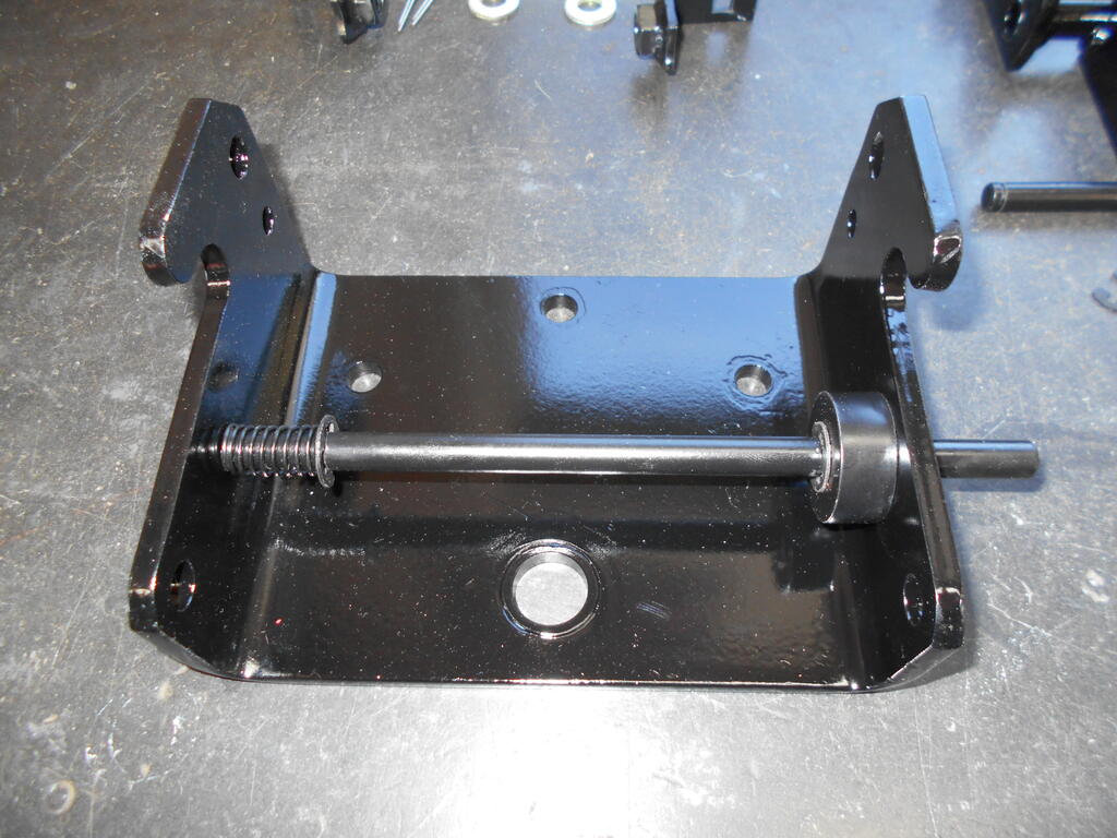

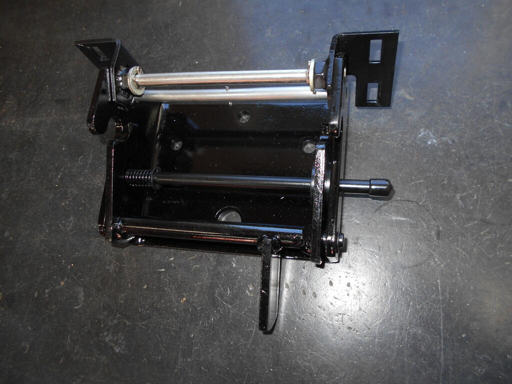

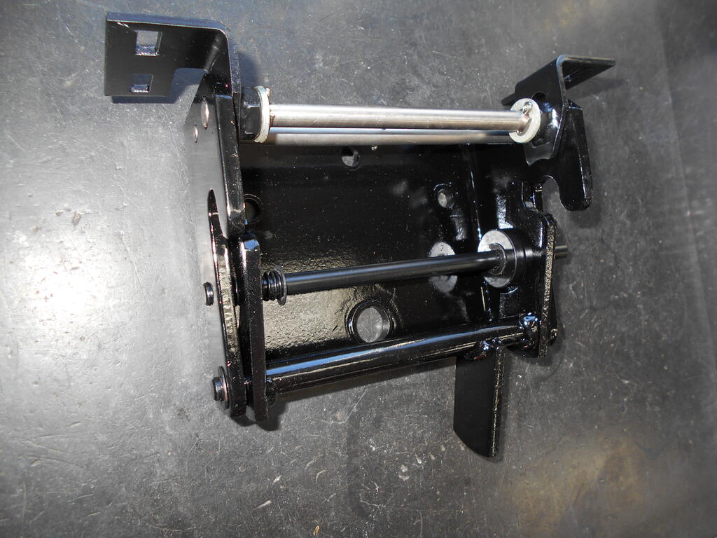

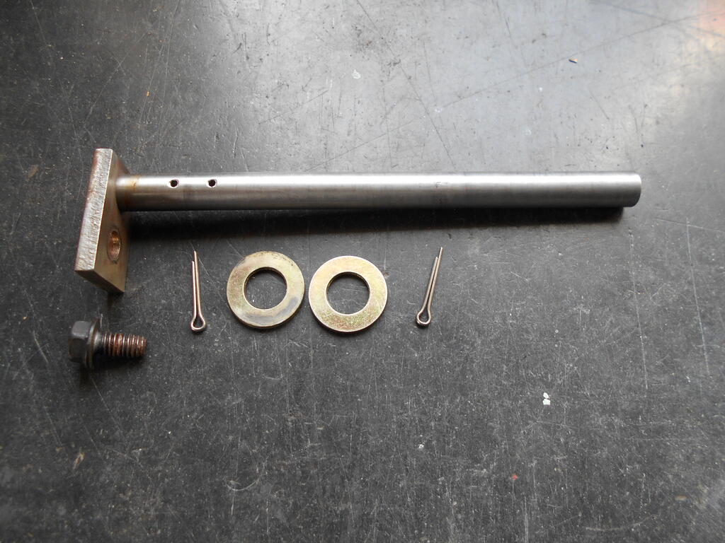

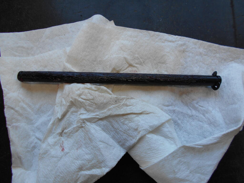

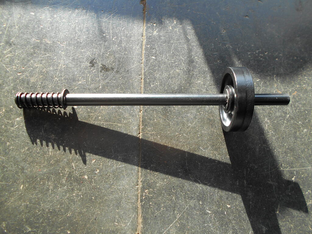

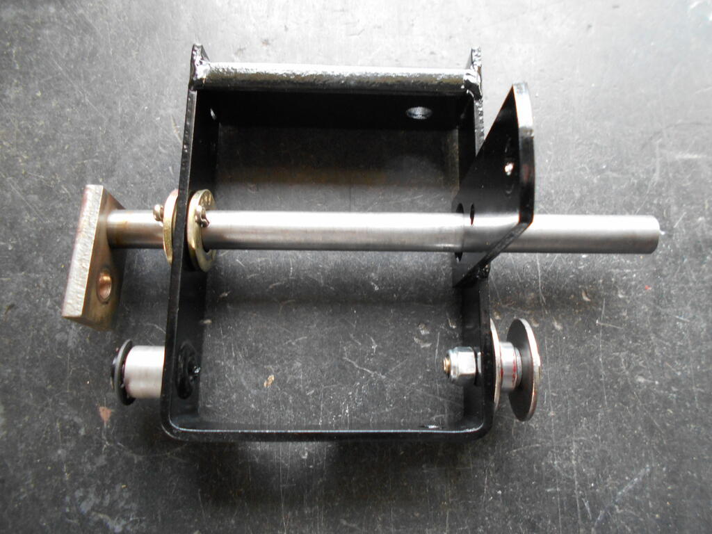

cleat 9,066 #215 Posted November 15, 2024 Motion cam ready to assemble along with foot control bearing. Motion cam assembled and cam bearing greased. Motion cam pivot rod made of stainless steel, 2 stainless steel cotter pins, and 2 hardened steel washers along with OEM mounting bolt. Complete motion cam assembly showing how rod is installed. 3 Share this post Link to post Share on other sites

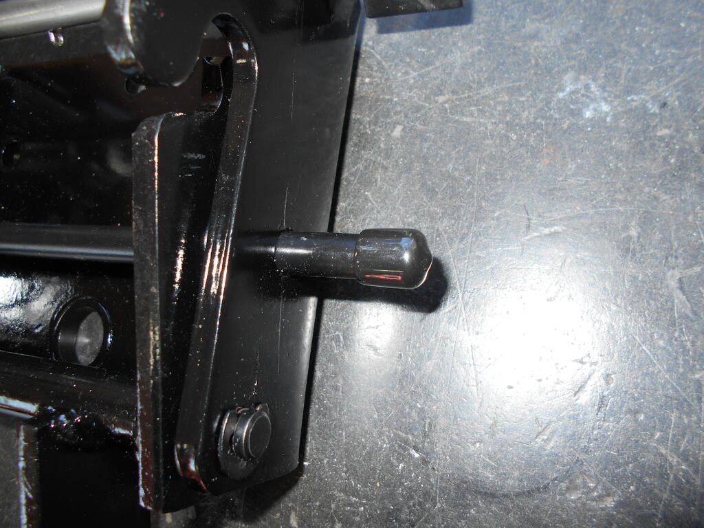

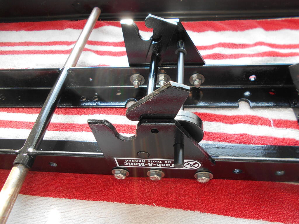

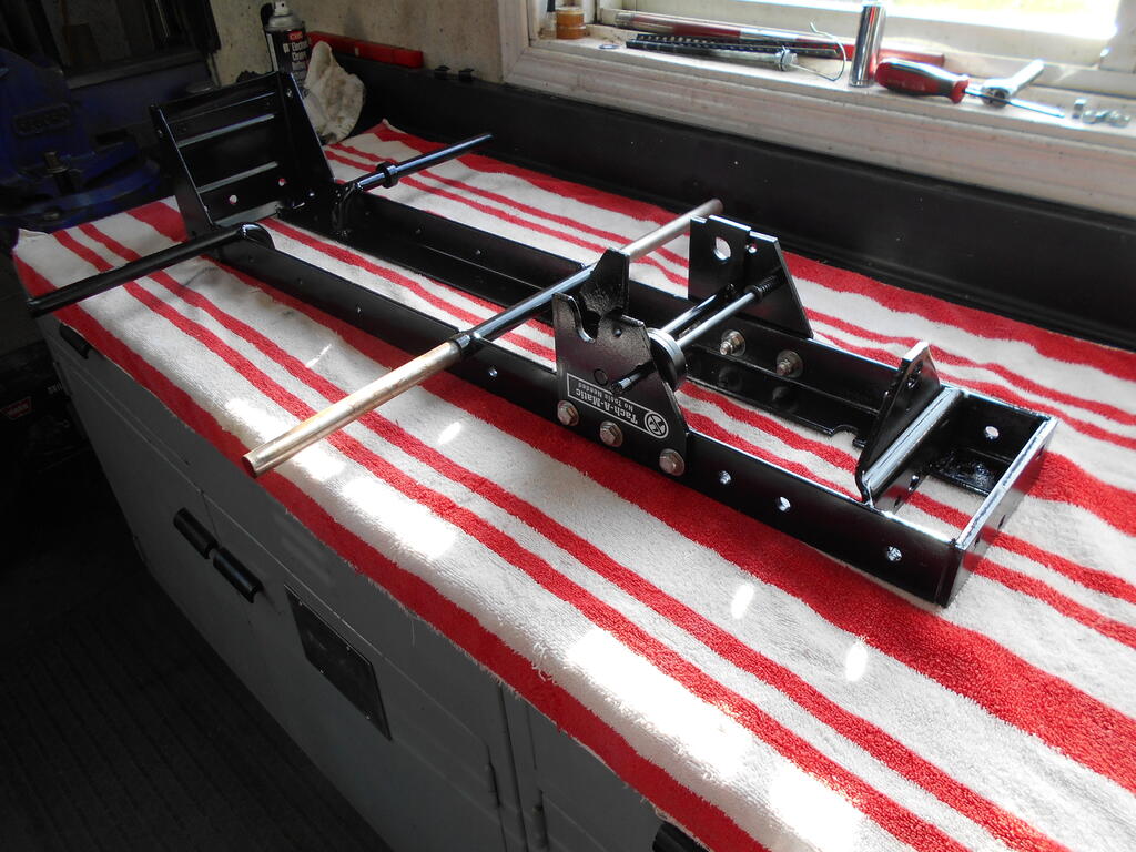

cleat 9,066 #216 Posted November 19, 2024 Mid Tach ready to install. Mid Tach decals installed. Mid Tach lock assembly ready to install. Mid Tach installed. Mid tach grip installed. Overview of frame and Tach assembly. 1 3 Share this post Link to post Share on other sites

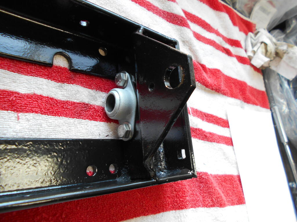

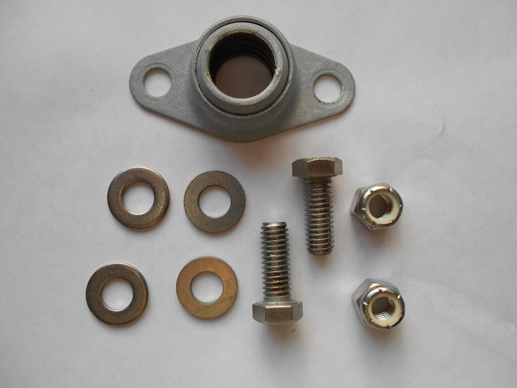

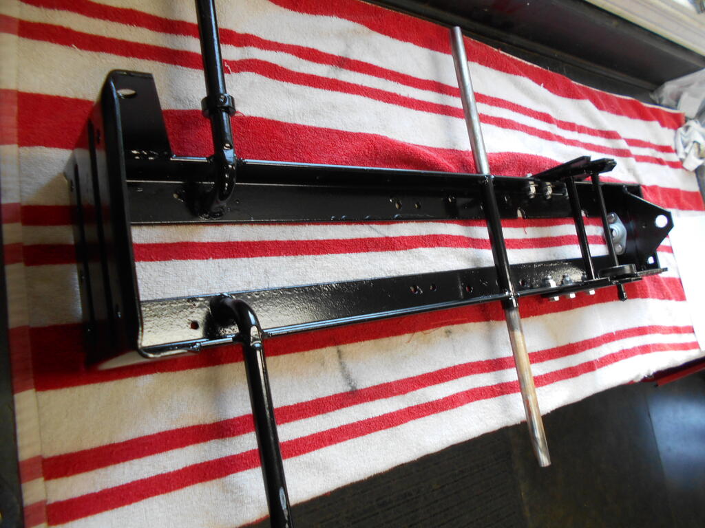

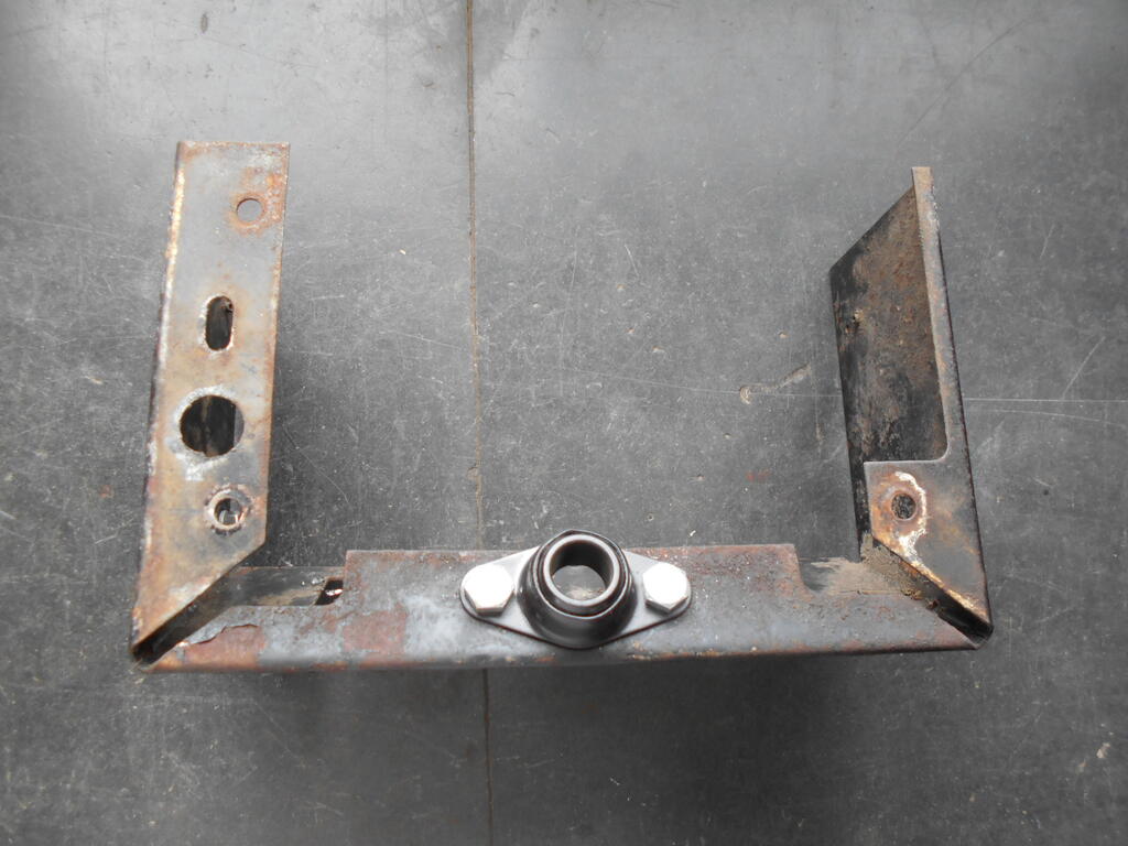

cleat 9,066 #217 Posted November 19, 2024 Lower steering shaft flanged bearing ready to install. Lower steering shaft flanged bearing installed. Frame overview showing mid Tach and Lower steering shaft flanged bearing. 1 6 Share this post Link to post Share on other sites

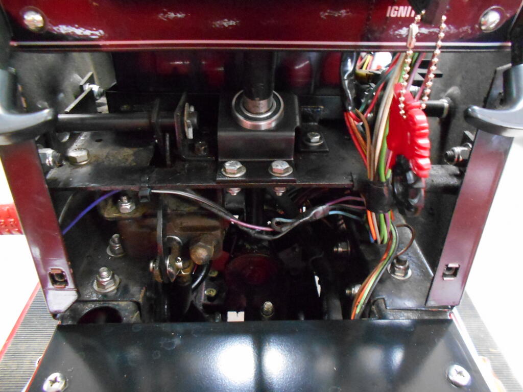

ebinmaine 79,769 #219 Posted November 20, 2024 4 hours ago, cleat said: flanged bearing Do you install other bearings around other shafts like the steering upper or whatever? Extras that Wheelhorse wouldn't have had originally? 1 Share this post Link to post Share on other sites

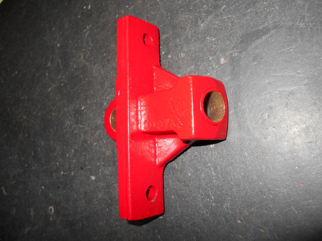

cleat 9,066 #220 Posted November 20, 2024 12 hours ago, ebinmaine said: Do you install other bearings around other shafts like the steering upper or whatever? Extras that Wheelhorse wouldn't have had originally? Yes, anywhere there is play in the steering I try and add a bearing or bushing to tighten it up. For the 300 and 400 series the easiest fix is to install a flanged bearing normally used on the lower shaft to support the upper shaft. For the early 500 series I use a front wheel bearing in the original bracket after drilling it out to 1-3/8" to fit the bearing. For the later 500 series I drill out the dash to 1-3/8 where the original bushing would normally be and install a front wheel bearing. The steering support block gets drilled and new brass bushings installed top and bottom to get rid of any play. Brake and clutch pedals just get new bushings as required. 1 4 Share this post Link to post Share on other sites

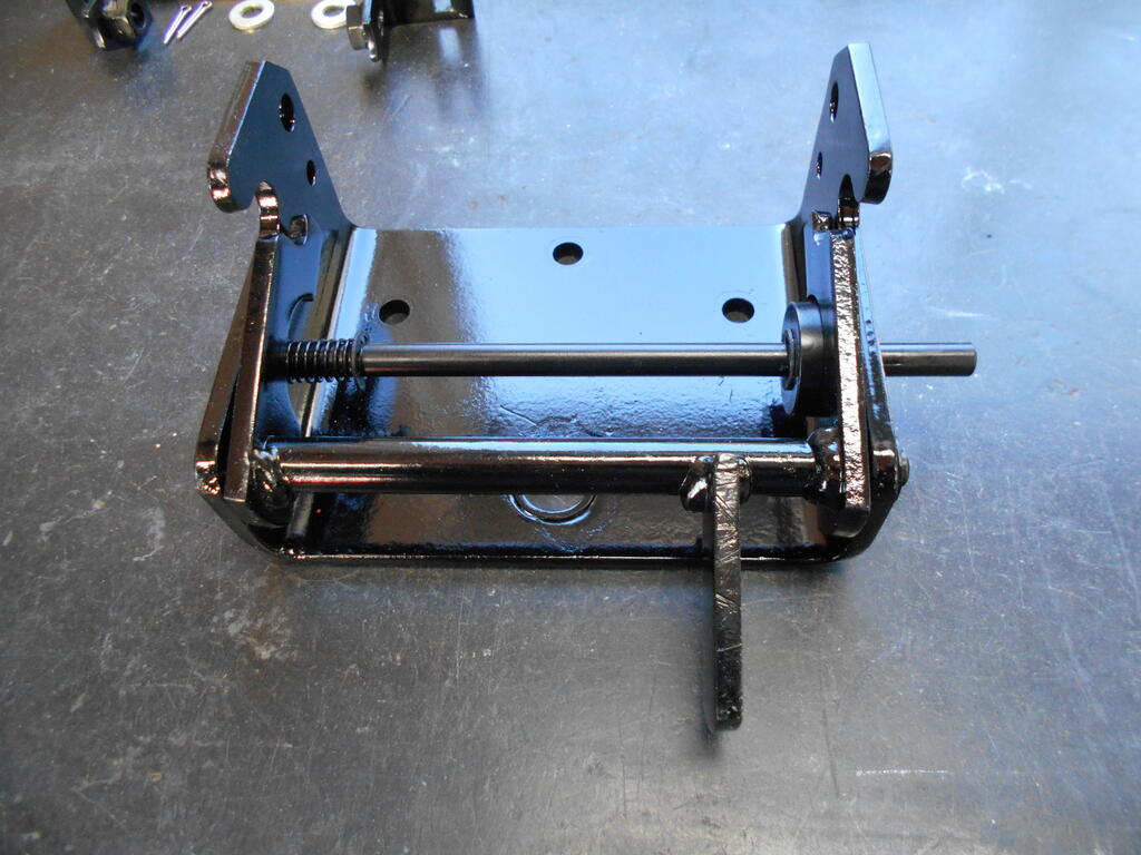

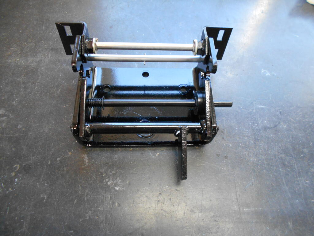

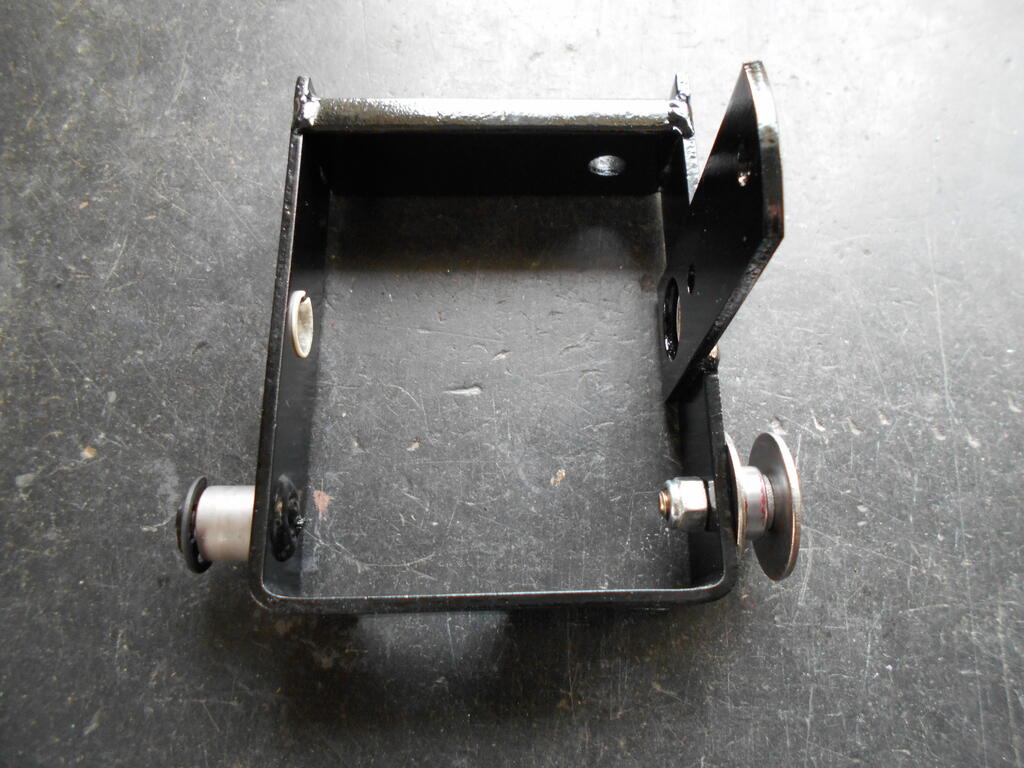

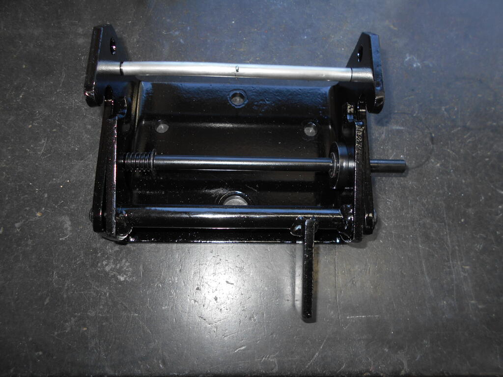

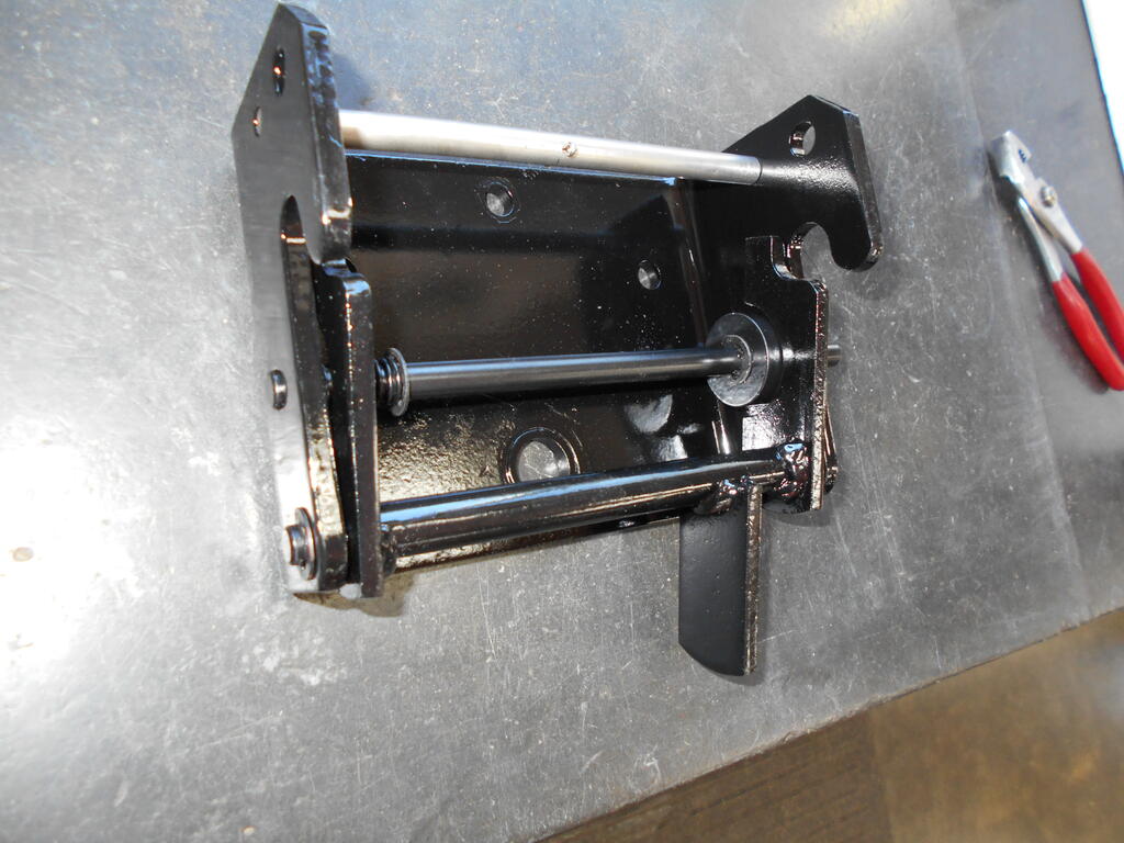

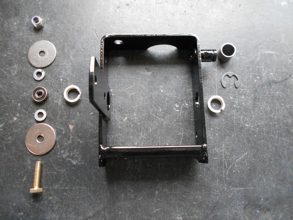

cleat 9,066 #223 Posted November 21, 2024 PTO pivot plate ready to assemble. PTO pivot plate assembled. 4 1 Share this post Link to post Share on other sites

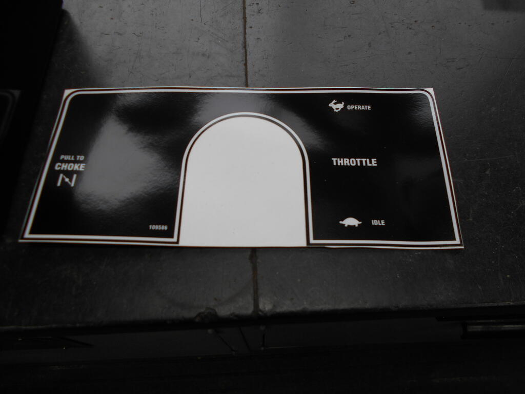

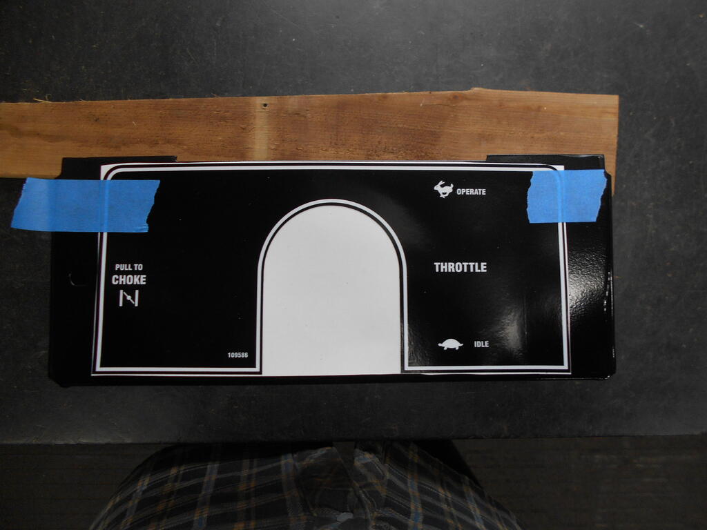

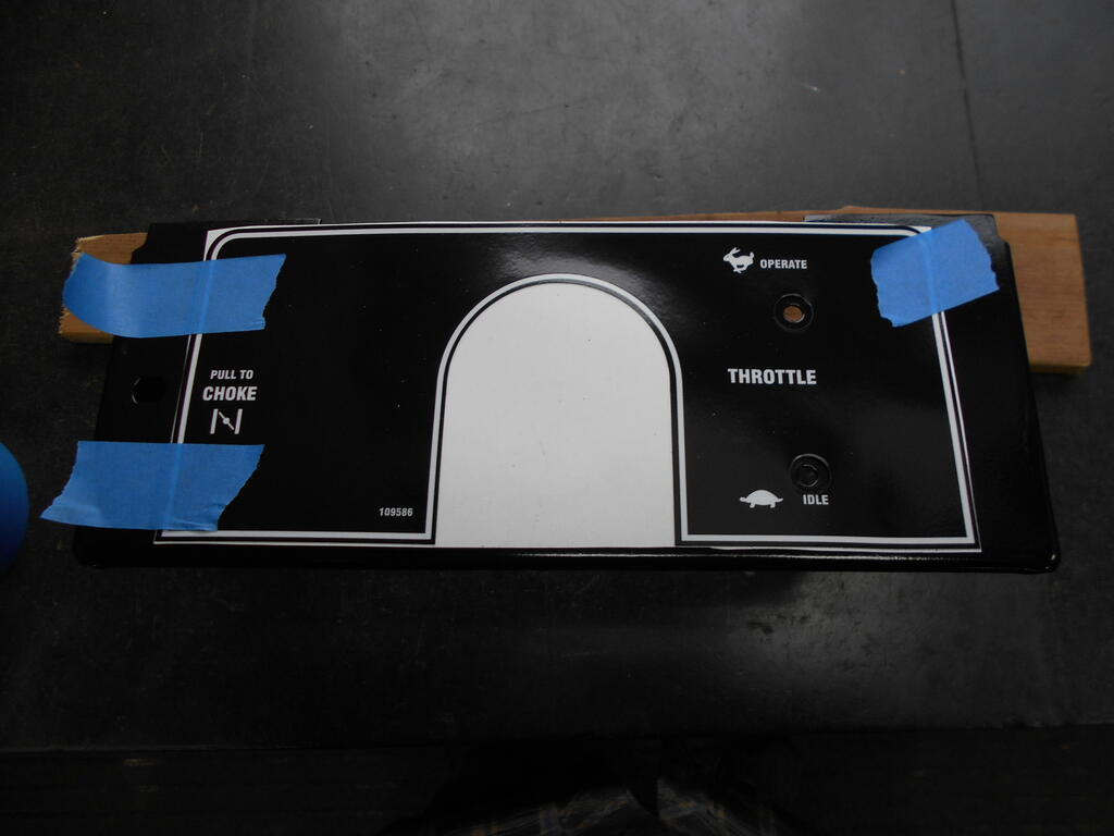

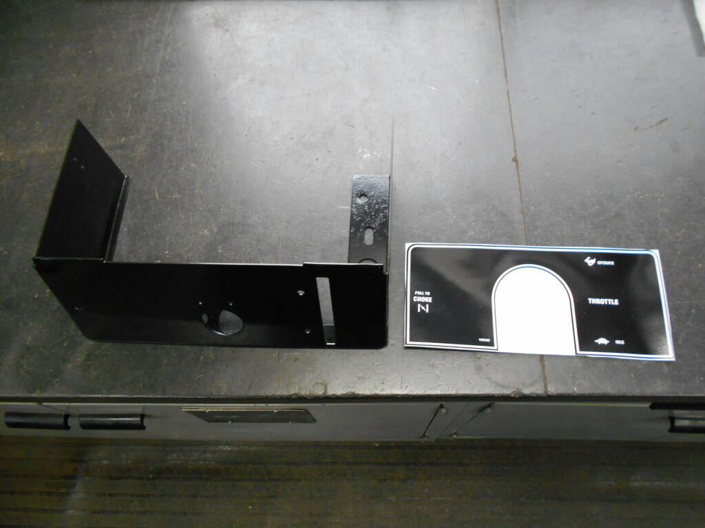

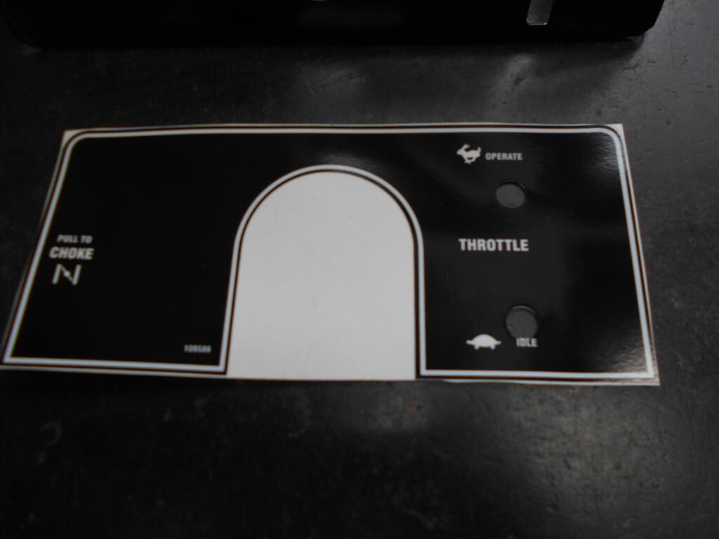

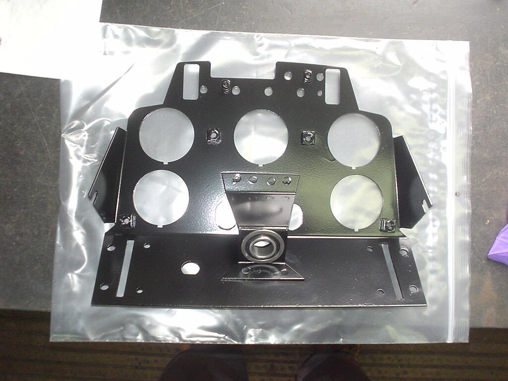

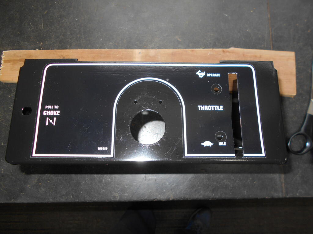

cleat 9,066 #225 Posted November 22, 2024 Console and decal ready. Console decal taped on to mark where holes need to be punched. Decal marked where holes are to be punched. Decal holes punched. Decal taped on ready to be applied. Decal applied and slot for throttle cut out. 2 Share this post Link to post Share on other sites
