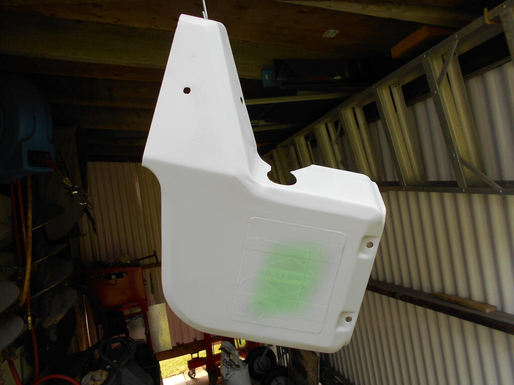

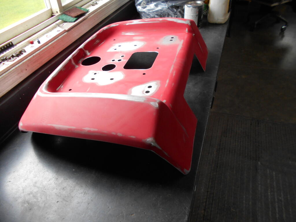

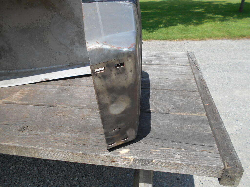

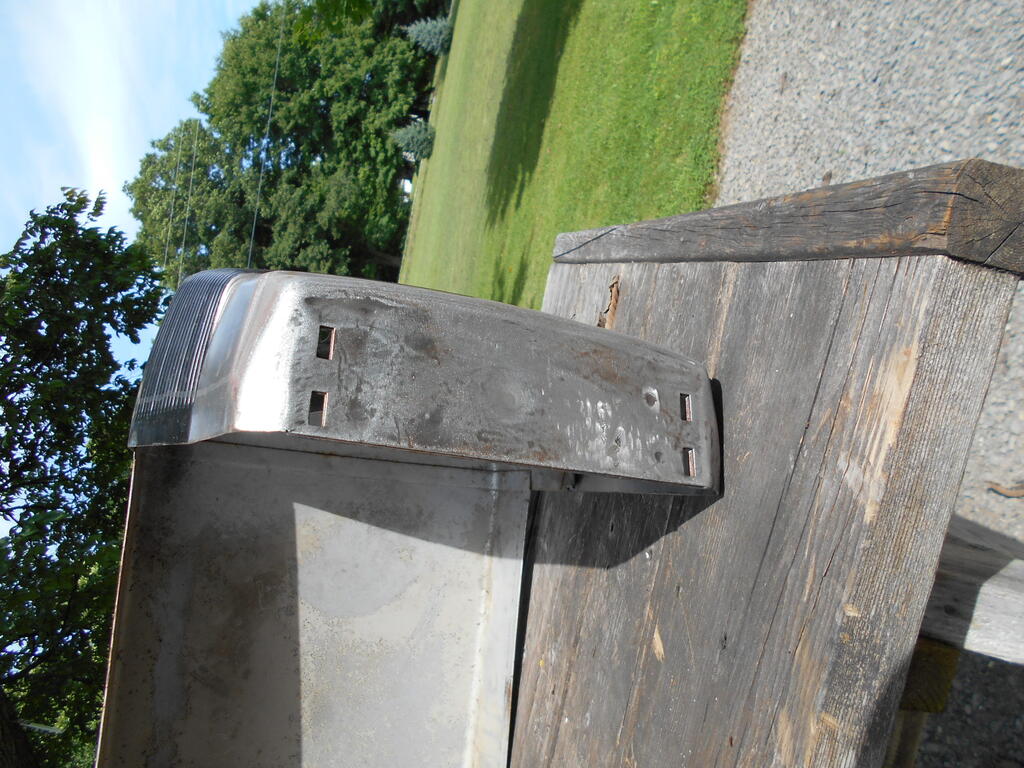

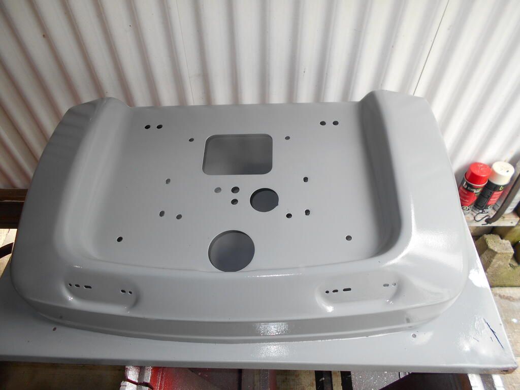

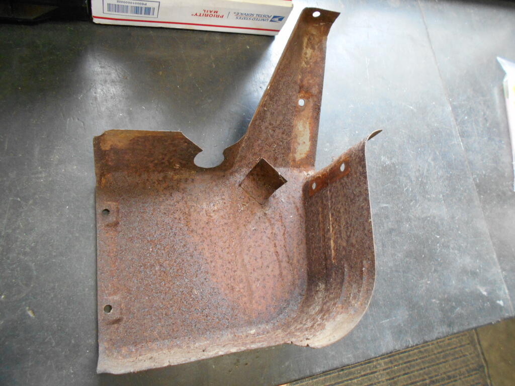

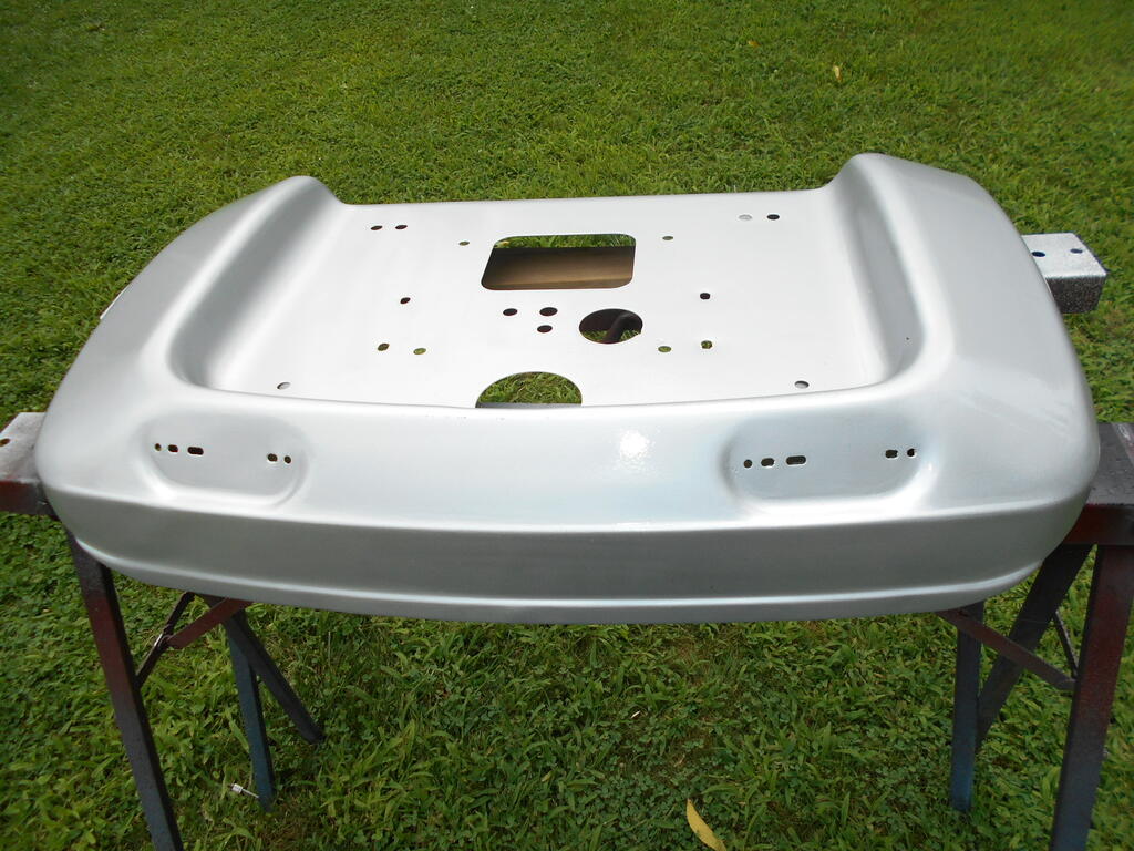

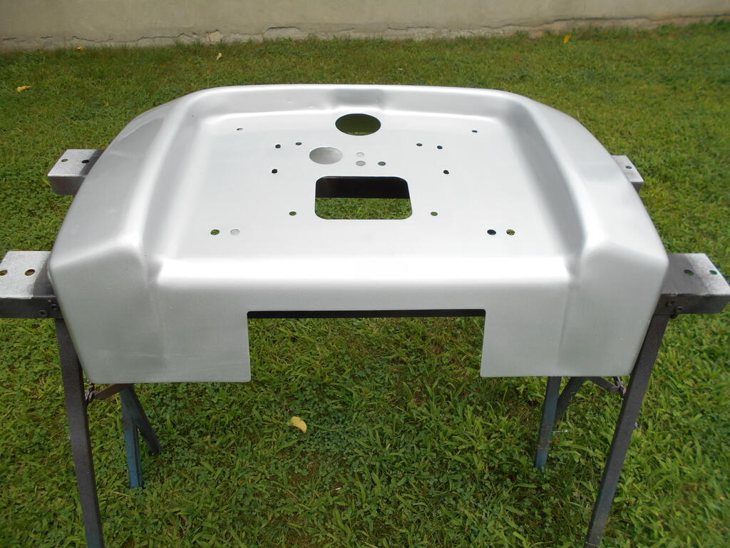

cleat 9,266 #155 Posted July 24, 2024 Rear fender stripped of decals and sanded. This is a spare later model fender as the Work Horse fender had no access for the hydro cam adjustments and this one is in better shape. I will give it one more sanding before prime and paint. It just started to rain so I had to stop (I sand and paint outside to keep the shop clean as possible). 6 3 Share this post Link to post Share on other sites

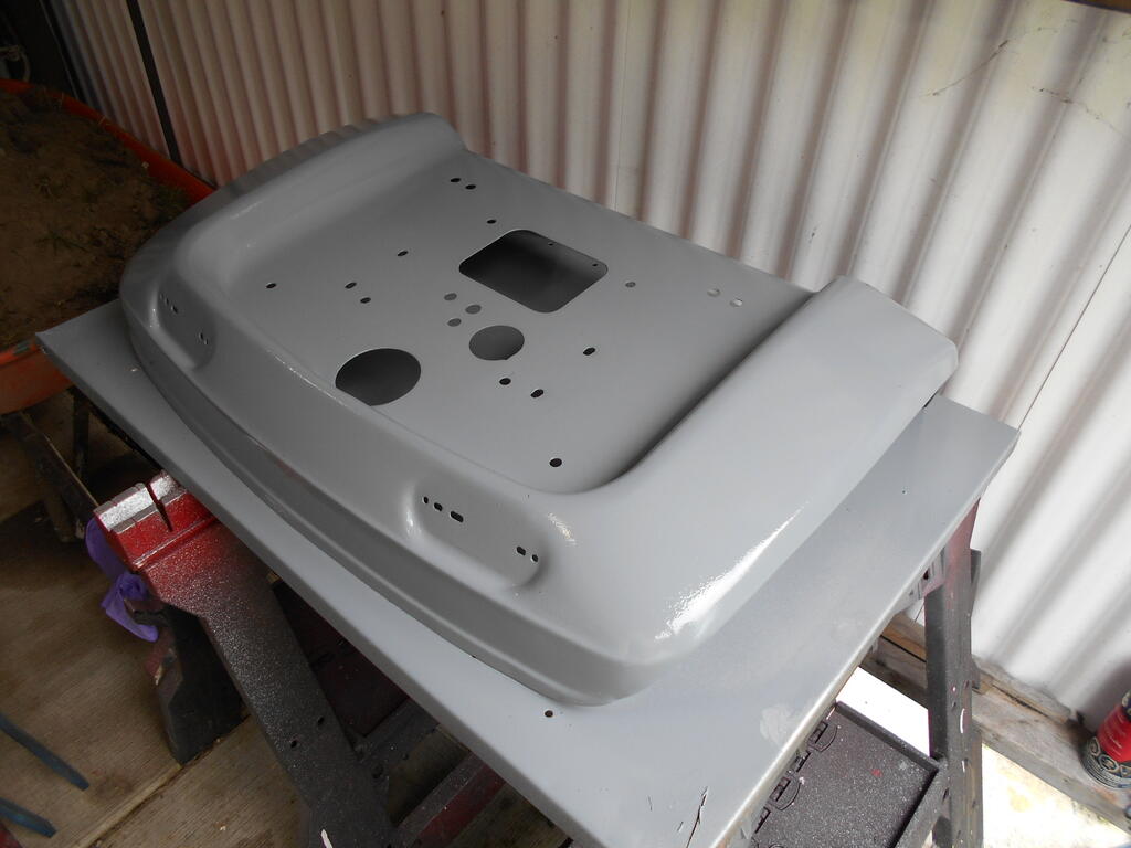

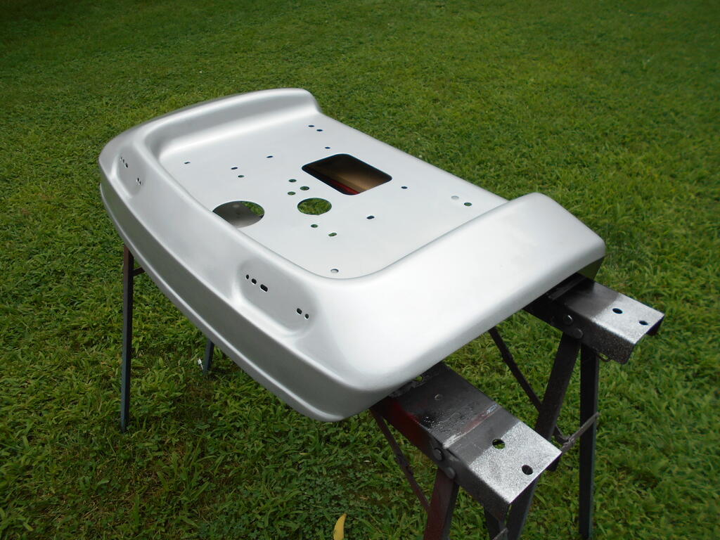

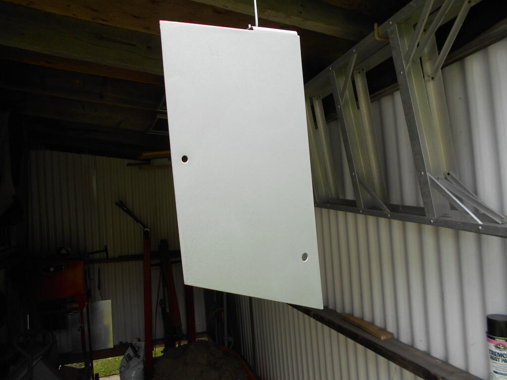

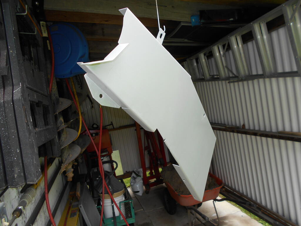

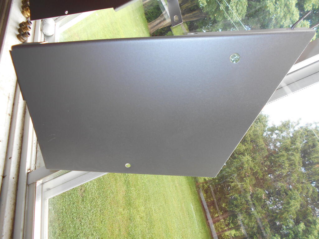

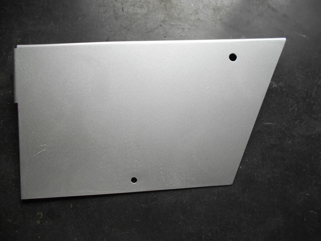

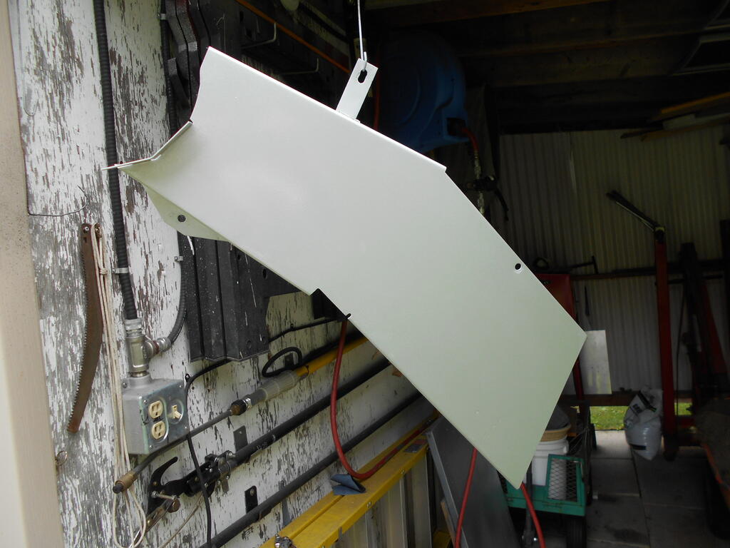

cleat 9,266 #156 Posted July 31, 2024 Fender primed top and bottom. Left side cover painted. Right side cover painted. It is very hot and humid here right now and rains a lot so I am getting this done when I can. 5 2 Share this post Link to post Share on other sites

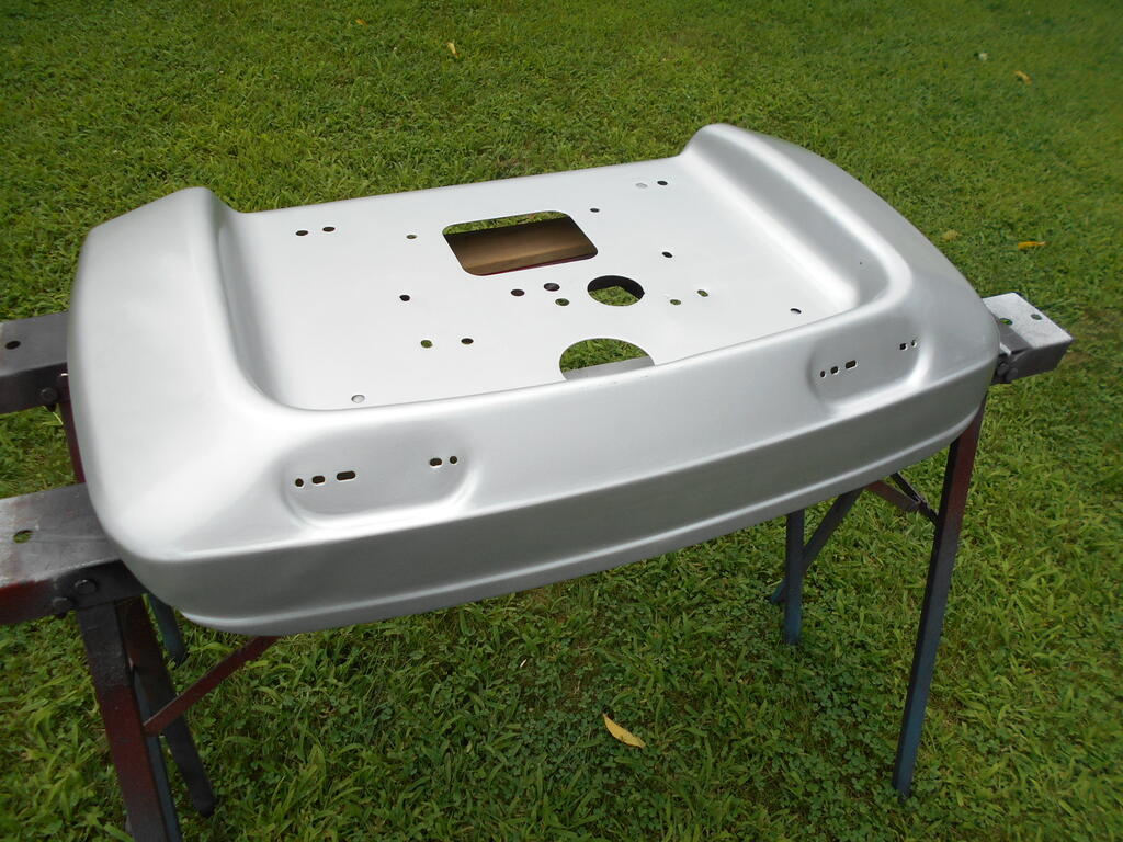

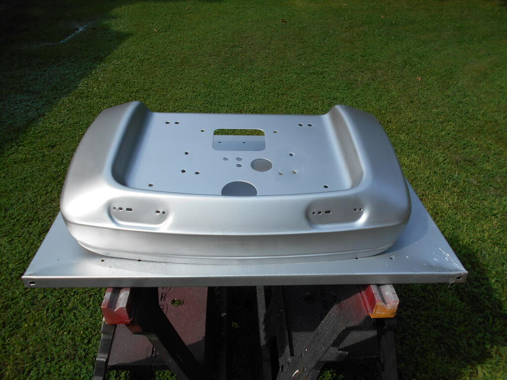

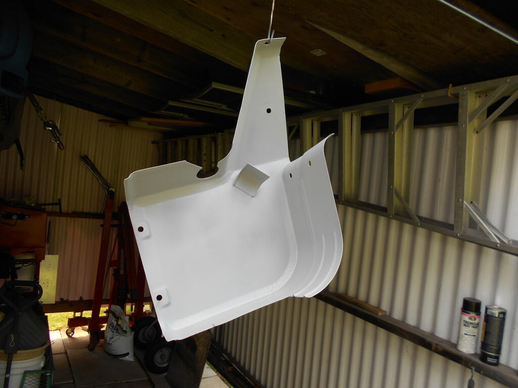

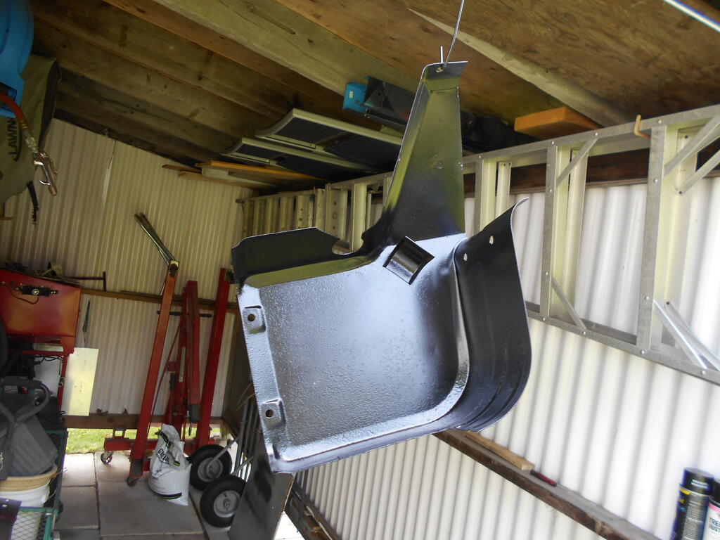

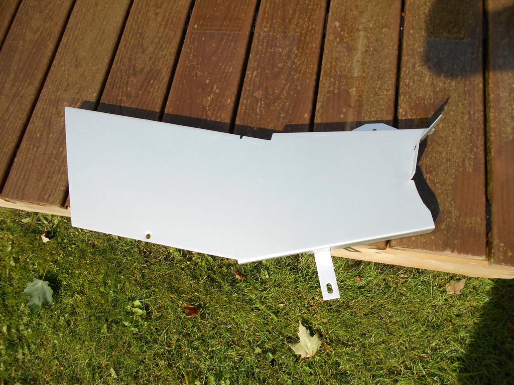

cleat 9,266 #158 Posted August 3, 2024 Fender painted. 4 6 Share this post Link to post Share on other sites
kpinnc 18,915 #159 Posted August 4, 2024 13 hours ago, cleat said: Fender painted. That is beautiful! I like the color choice on this project! 3 Share this post Link to post Share on other sites
cleat 9,266 #160 Posted August 4, 2024 7 hours ago, kpinnc said: That is beautiful! I like the color choice on this project! The basic Tremclad silver aluminum sprayed on gives me the colour I was looking for. When you spray clear over it, you get a pretty good shine too. So far only the foot rests have been cleared as I want the paint to be well dried before applying it. 2 Share this post Link to post Share on other sites

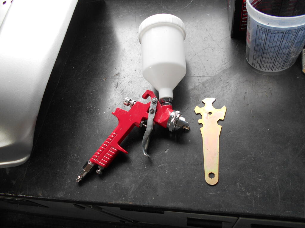

cleat 9,266 #161 Posted August 4, 2024 (edited) I bought this relatively cheap spray gun and used it to paint the side covers and rear fender. It is a learning curve as I have never used one of these before. I normally use rattle cans. Wow, does this thing ever get the job done fast. Once the hood gets welded up I will paint it as well. Hard to find Varsol as it has been recalled in Canada at least. I tried some low odour mineral spirits and that simply did not work well. Finally found real nice and stinky Varsol and that works well for thinning and cleanup. Edited August 4, 2024 by cleat 3 Share this post Link to post Share on other sites
ebinmaine 80,426 #162 Posted August 4, 2024 Just now, cleat said: spray gun The Paint Department AKA BBT Trina has been mulling over getting one for several years. Biggest reason we haven't is purely convenience. Spray can paint doesn't have anywhere near the durability of auto grade but the cans are easy to pick up and put down and use whenever she wants or needs. No clean up. 1 Share this post Link to post Share on other sites

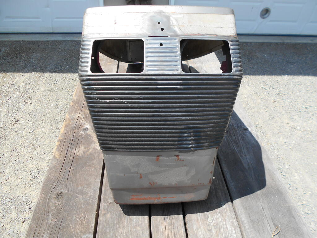

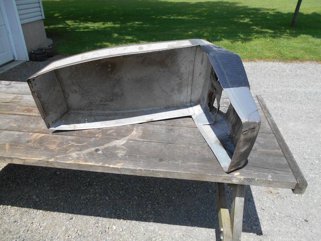

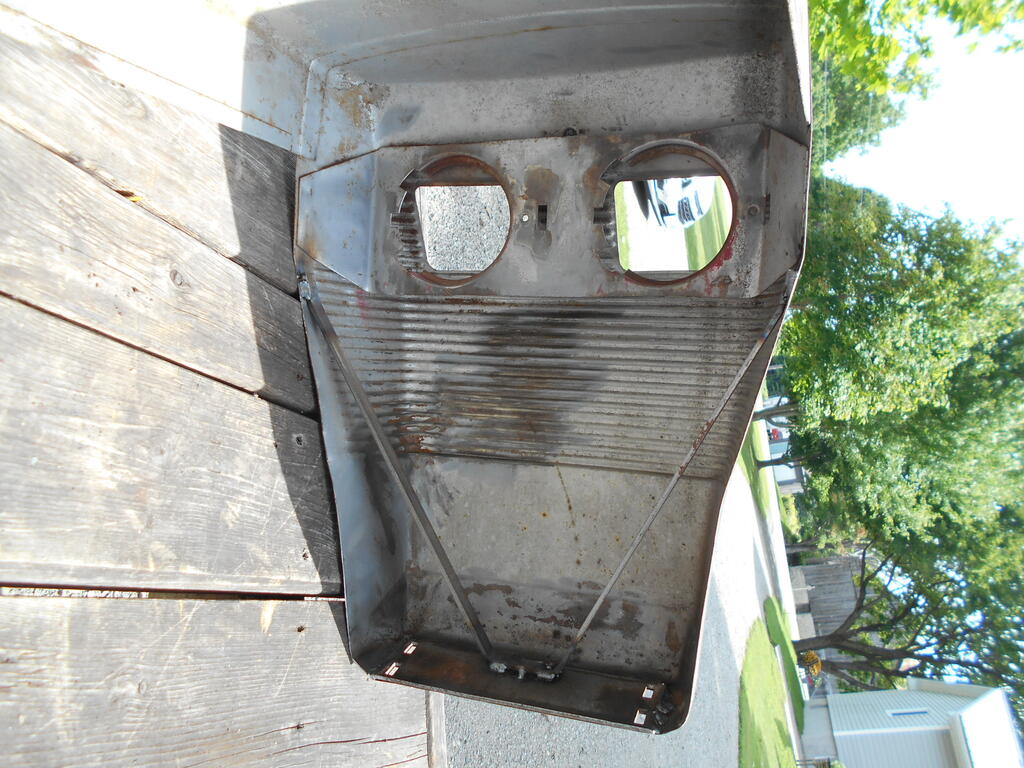

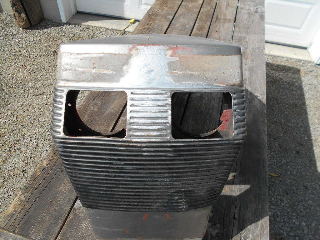

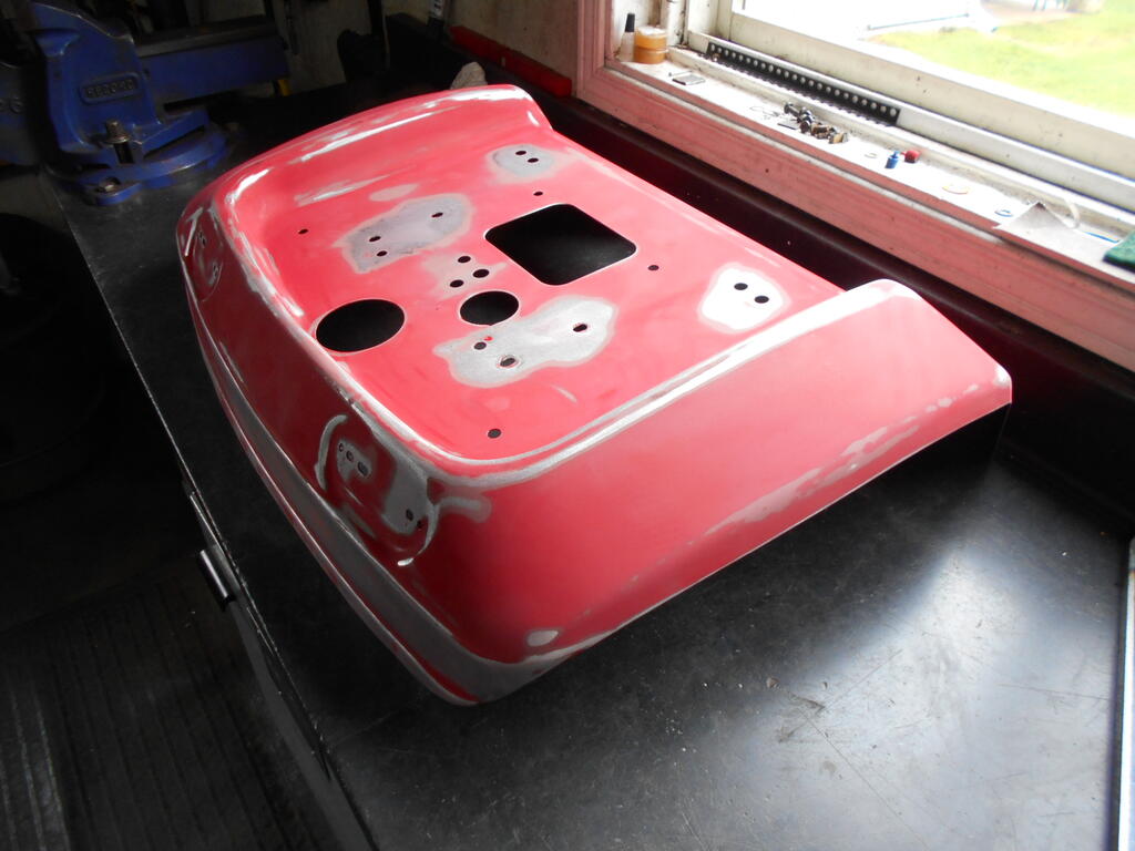

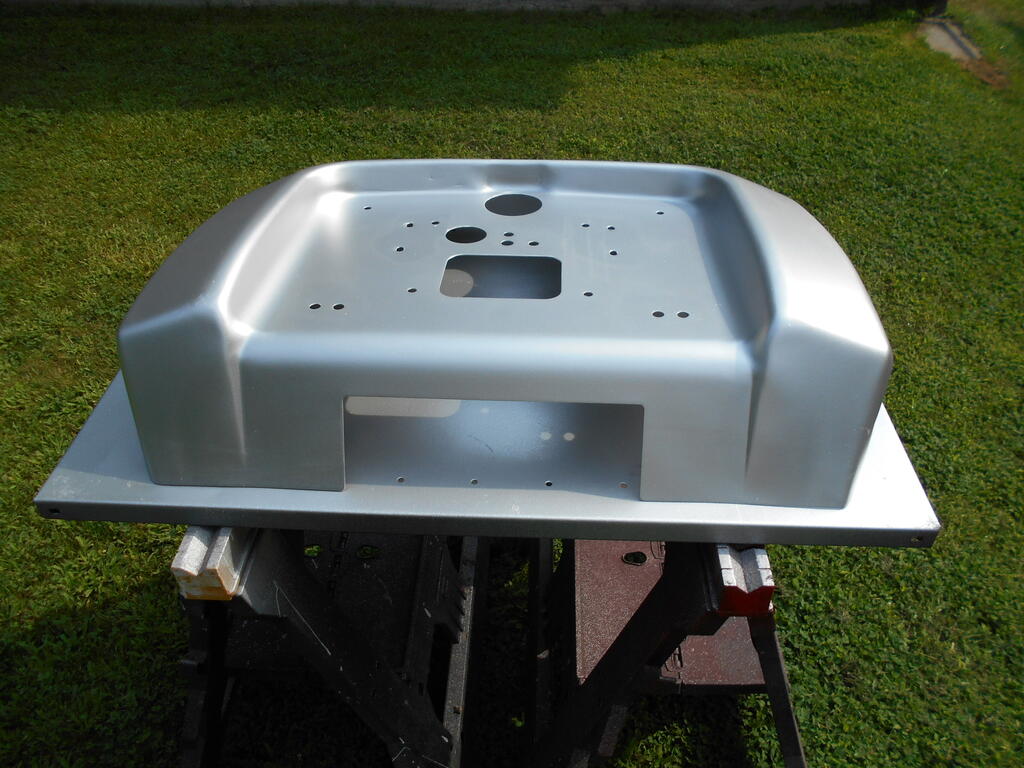

cleat 9,266 #166 Posted August 8, 2024 Hood had several holes drilled in the front and was cracked on the bottom. Holes have been welded in and mostly ground flat and sanded. Bottom has been welded up. This early hood did not come with the brace. Brace made up and welded in. Still lots more sanding and prep left to do before painting but this is a start. 4 4 Share this post Link to post Share on other sites

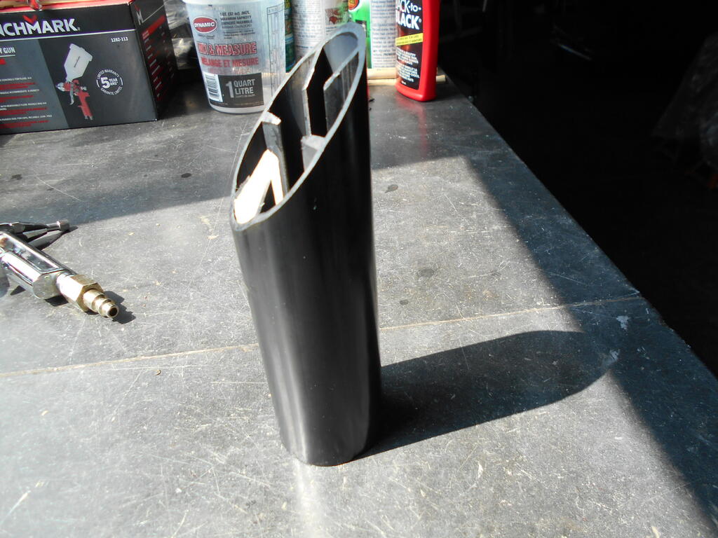

cleat 9,266 #170 Posted August 14, 2024 (edited) Upper steering shaft bead blasted and painted. Steering tube cleaned up and polished. Thanks to ebinmaine for these parts. It will be great to have the proper steering wheel on this tractor that this shaft and tube will facilitate. Edited August 14, 2024 by cleat 3 1 Share this post Link to post Share on other sites

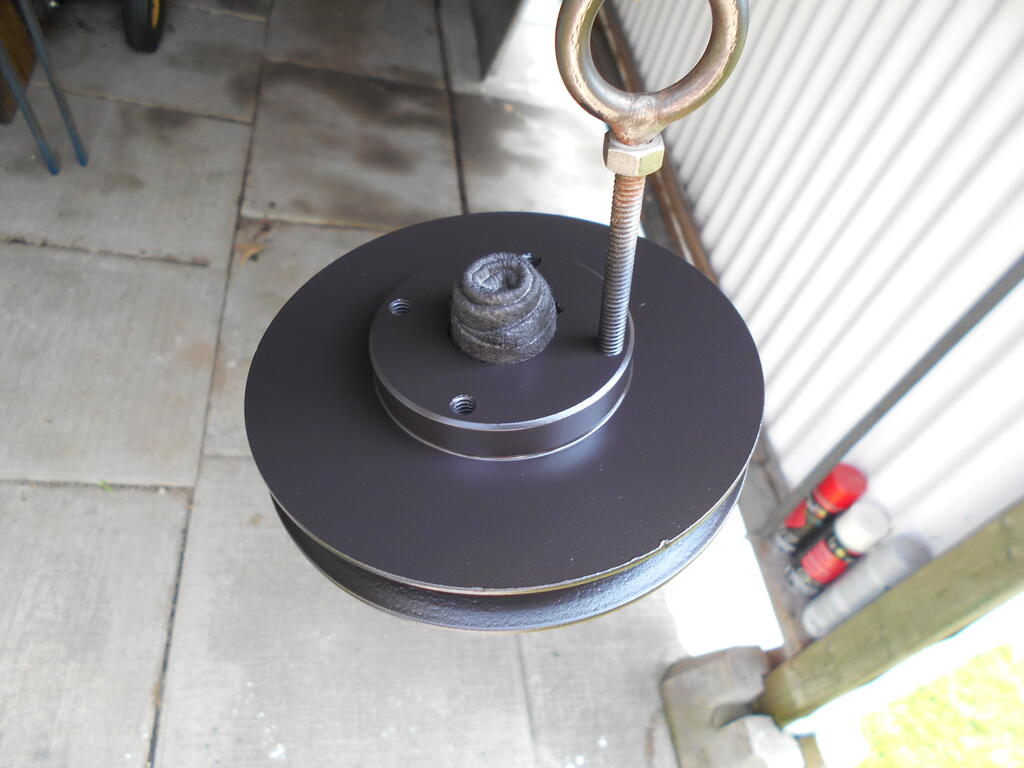

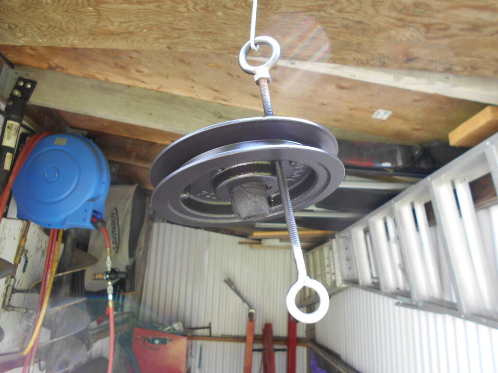

cleat 9,266 #171 Posted August 14, 2024 Engine pulley for the hydro conversion bead blasted and painted. Thanks to c-series don for this pulley. Finding the larger hydro pulley with the 1" bore required for the Briggs engine is difficult but Don came through. 7 1 Share this post Link to post Share on other sites

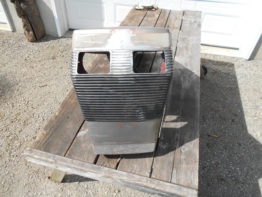

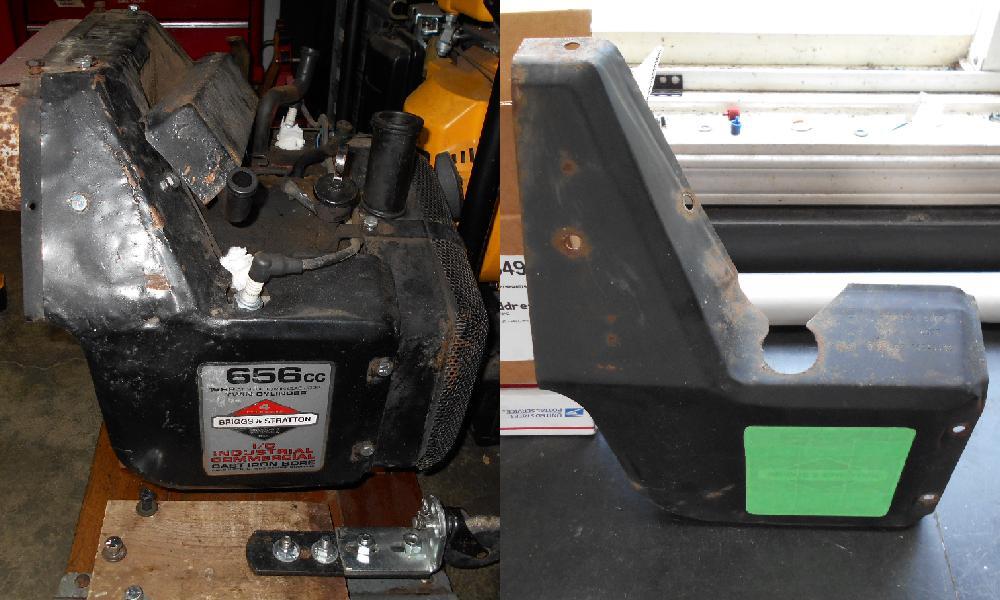

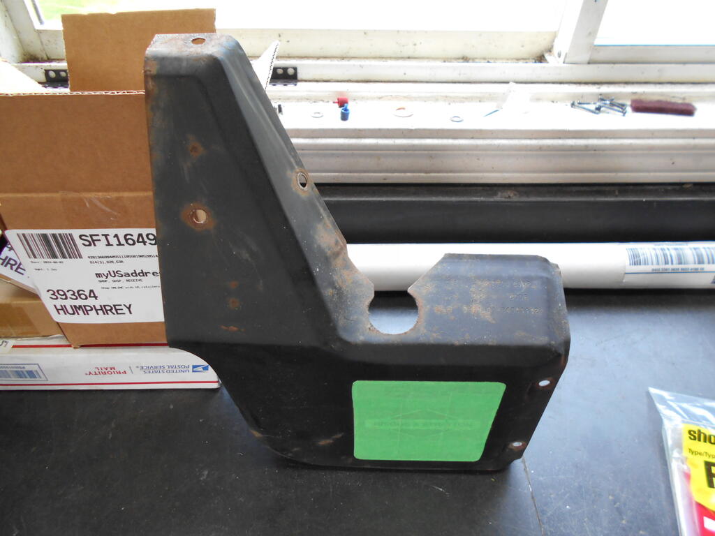

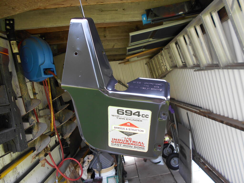

cleat 9,266 #172 Posted August 15, 2024 Front engine air cover was badly bent on this tractor when I got it. c-series don sent me this nice straight one. Here is the difference. Here is the cover as I received it. Great shape just needs some bead blasting and sanding. Cover cleaned up and primed. Don even sent me this cool decal. 3 4 2 Share this post Link to post Share on other sites
cleat 9,266 #173 Posted August 15, 2024 Cover now has 2 coats of semi gloss black. I left the decal on even though it is for an 18HP and my engine is 16HP because I think it looks better than no decal. I can't find a source for new decals. 1 3 Share this post Link to post Share on other sites

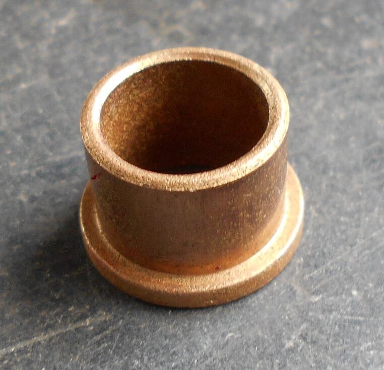

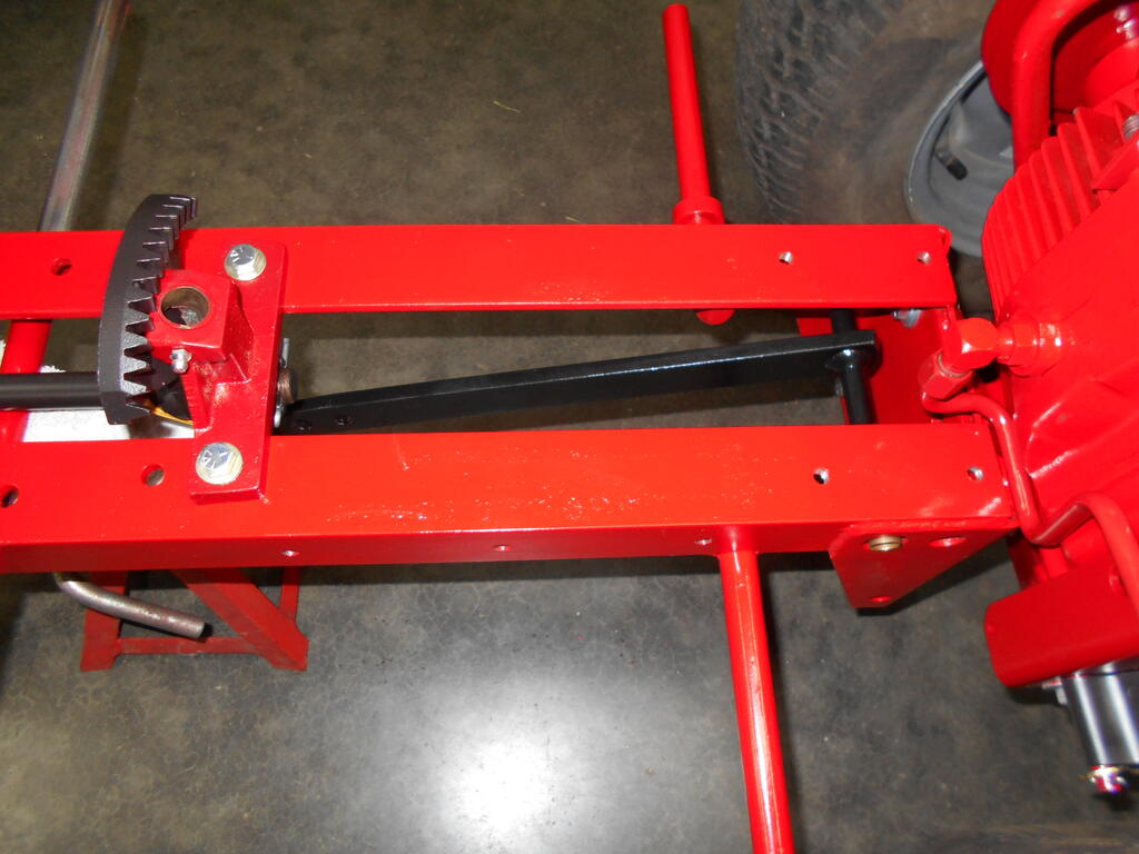

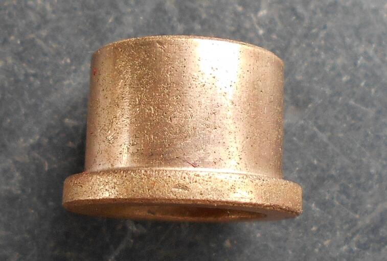

Lee1977 7,750 #175 Posted August 15, 2024 On 7/16/2024 at 11:09 AM, cleat said: Well, part of your issue is the lift arm does not go there it goes where you see it in this picture. The bushing OD is 5/8" ID is .5" Length from under flande to end of bushing is 3/8", OD of flange is 3/4" Not sure witch frame you have there most deck lift rod are 1/2" with a 1/2" ID and 5/8" OD bushing. I guess they up graded the rod on later 520 to 5/8" rod for the 60" deck. oF Share this post Link to post Share on other sites
