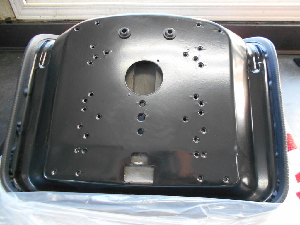

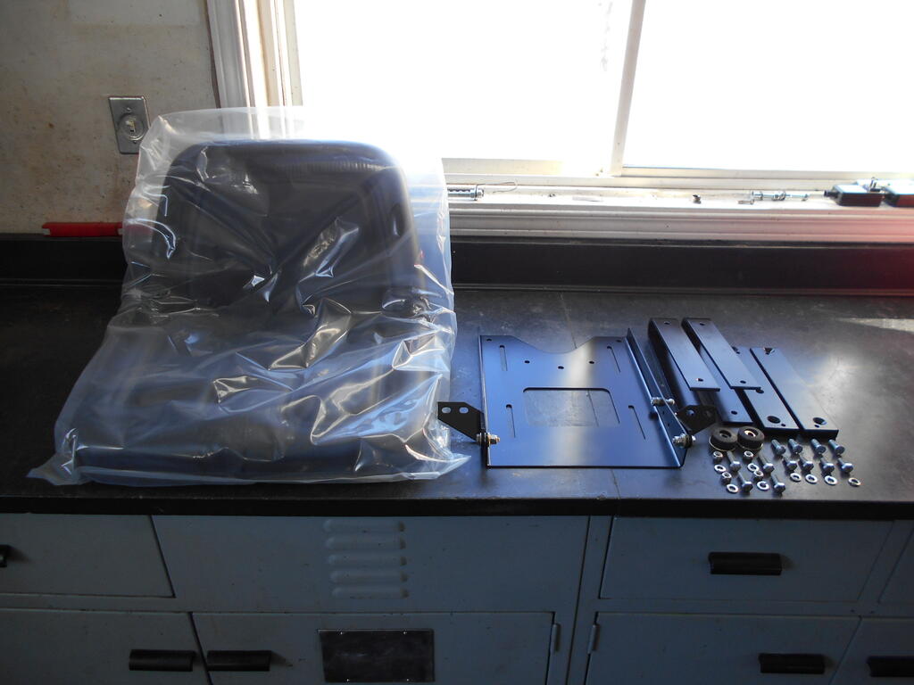

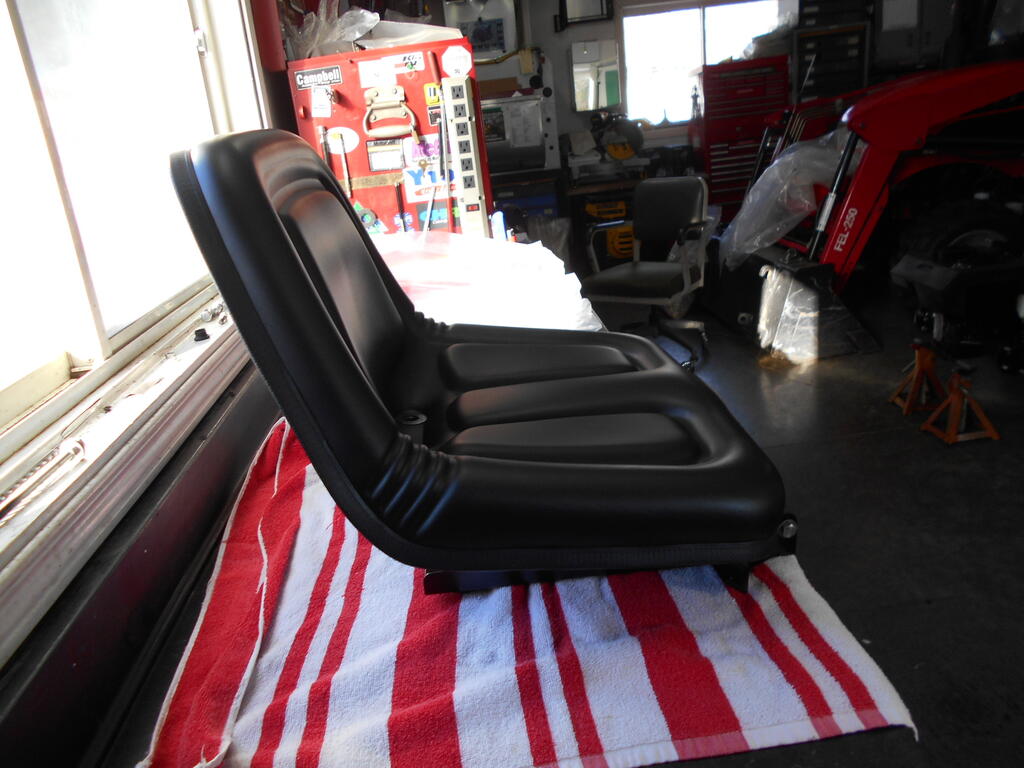

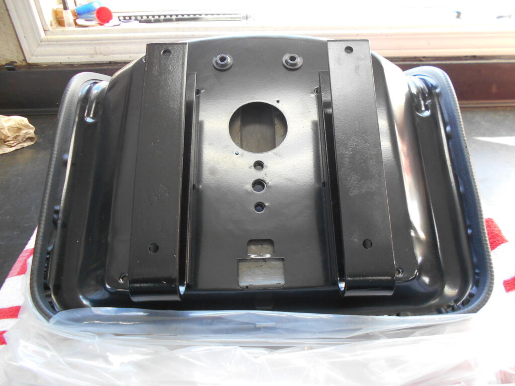

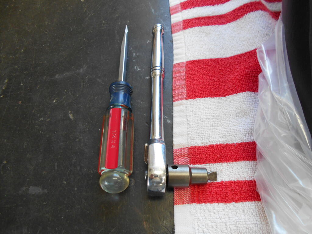

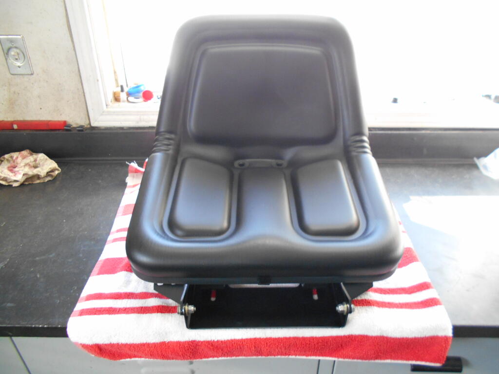

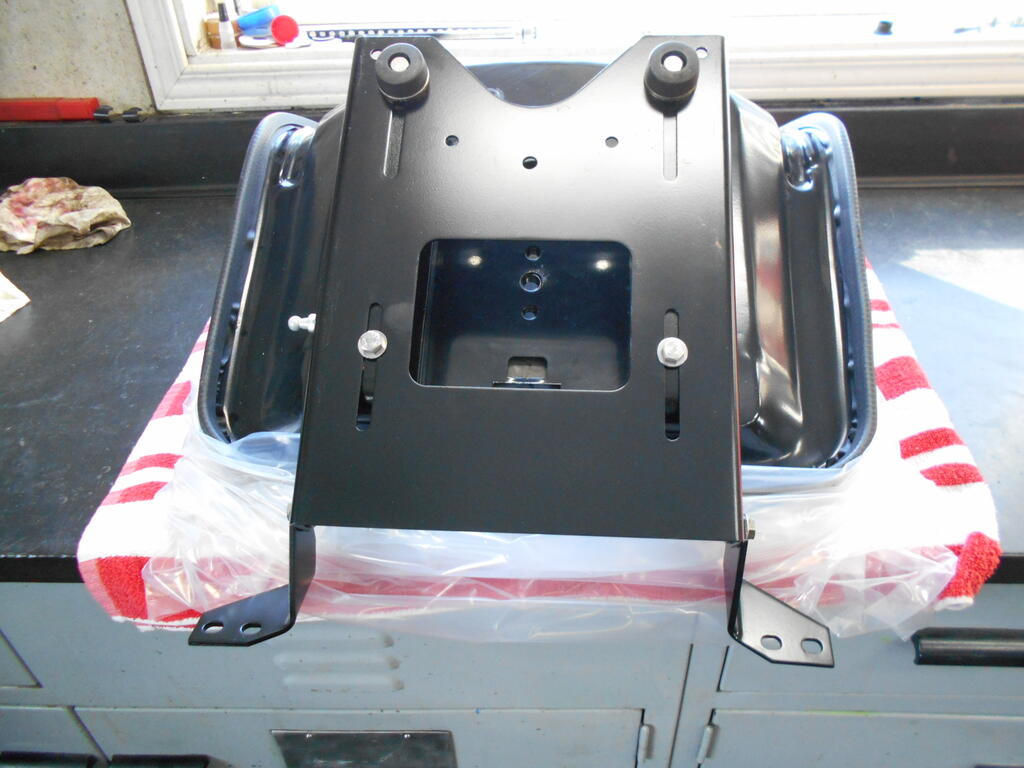

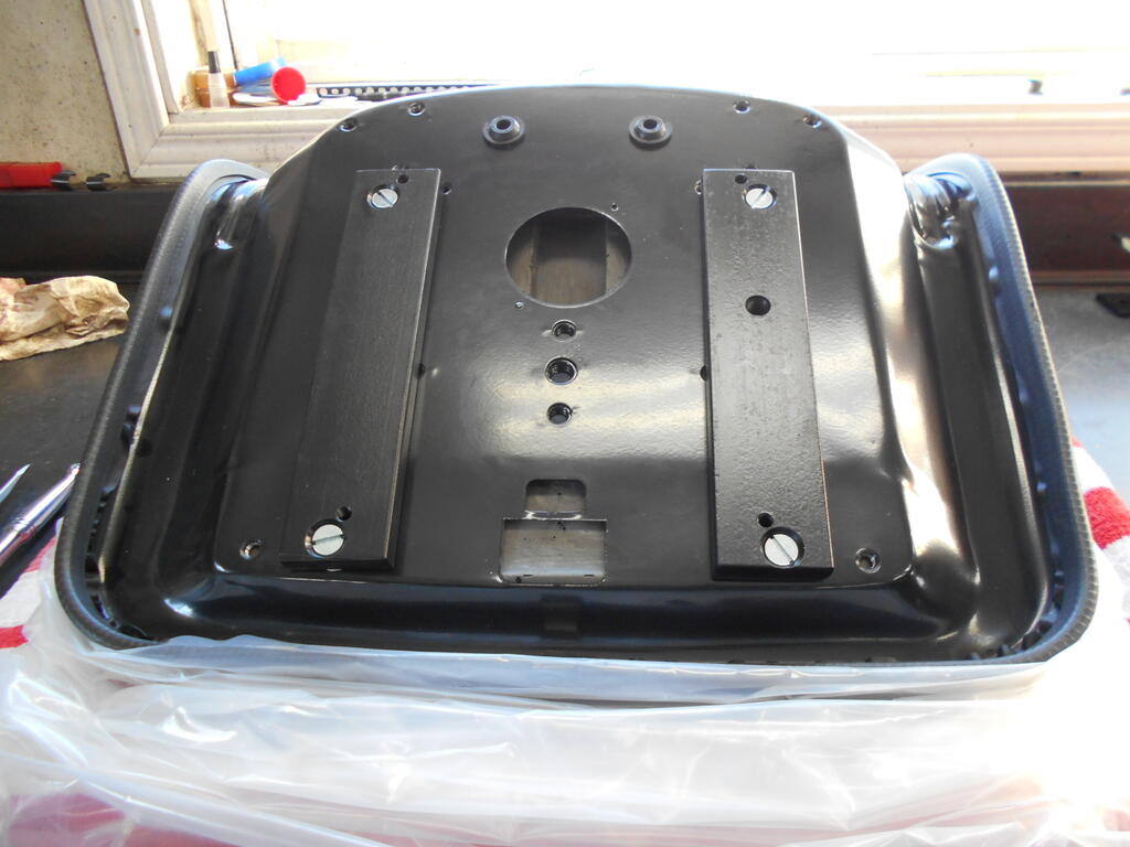

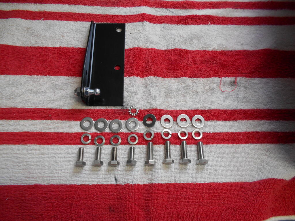

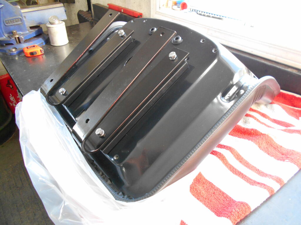

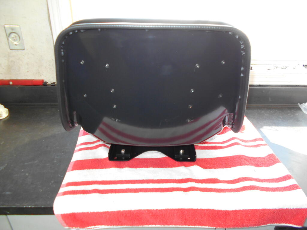

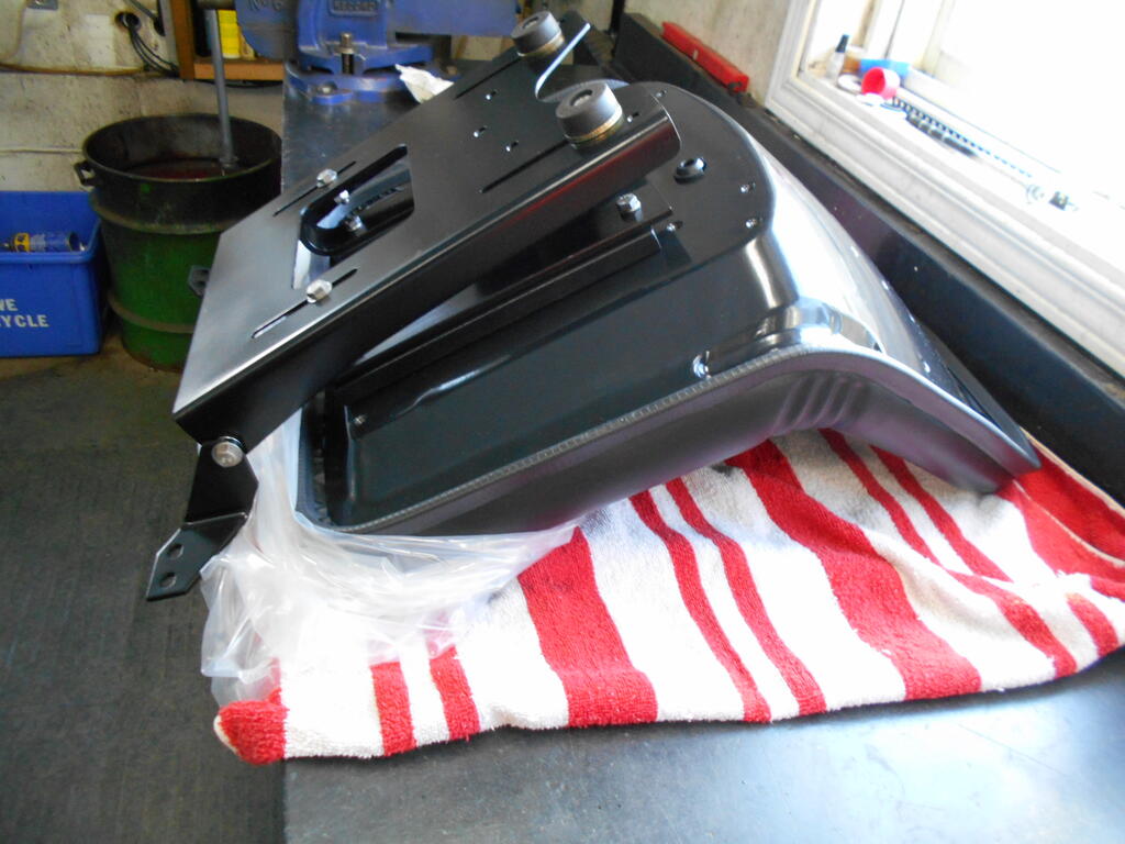

cleat 9,389 #381 Posted January 2, 2025 This is the seat I am using. I have this same seat on most of my machines. Seat assembly ready to put together. This is the bottom of the seat as removed from box. Adapter plates bolted to seat. I used these screwdrivers to ensure bolts are very tight. Springs loosely bolted to adapter plates. They are installed short side down as per manual. Pivot plate assembly bolted to seat springs. It is at the back of the slots for maximum leg room. All bolts then tightened. Seat assembly complete. 2 4 Share this post Link to post Share on other sites

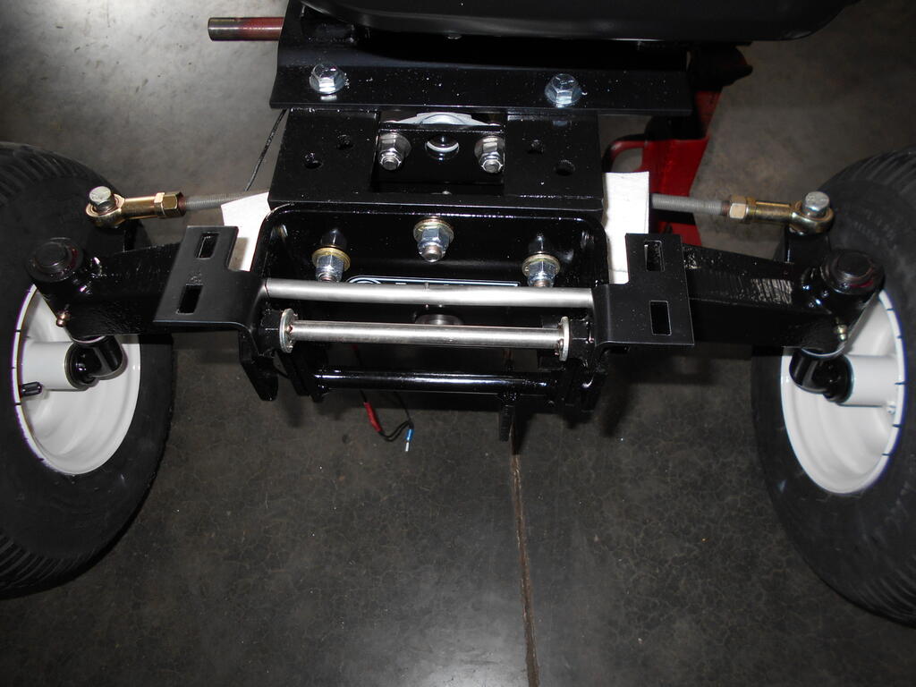

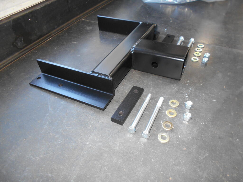

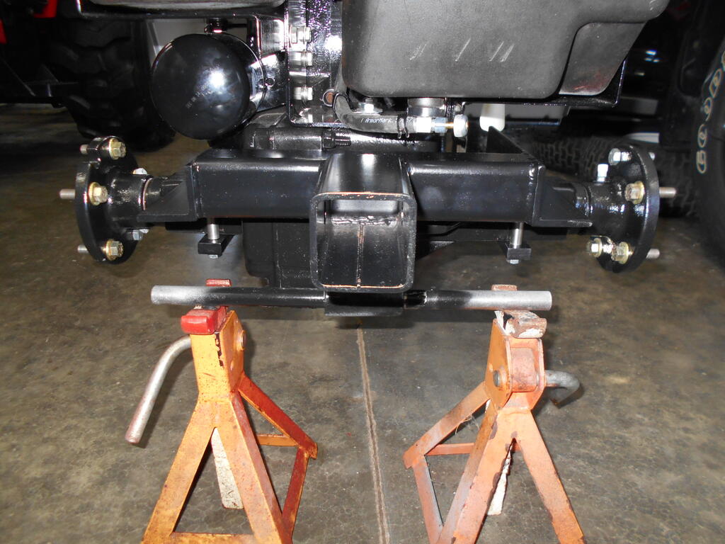

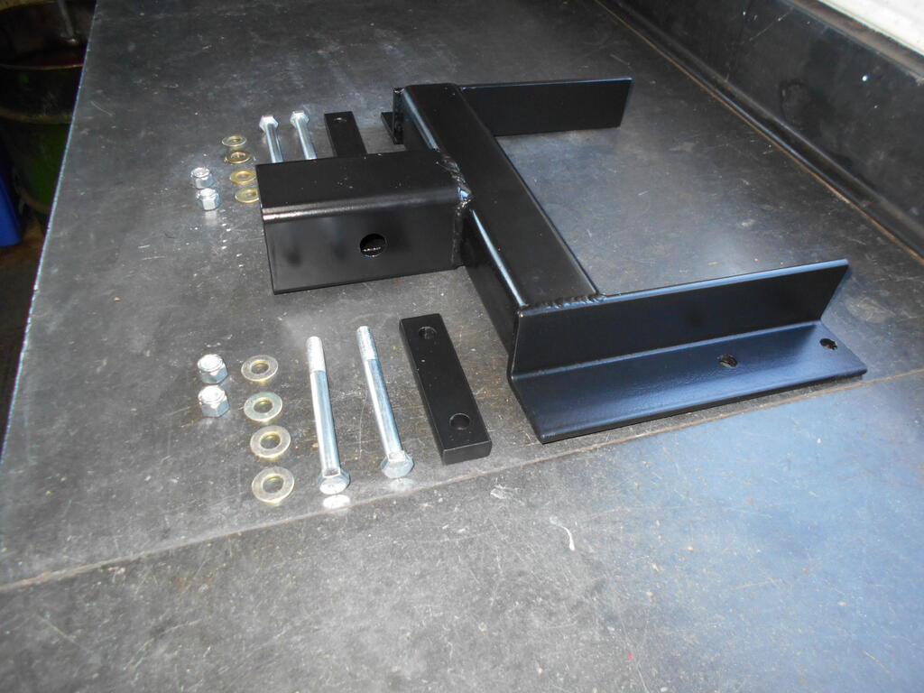

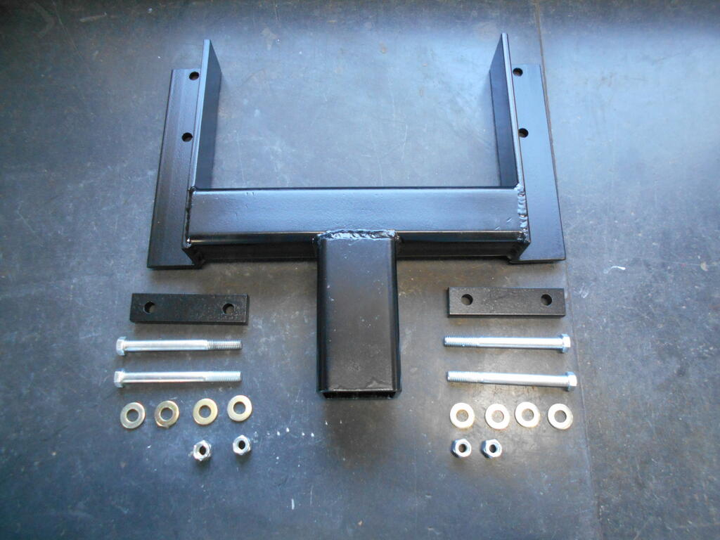

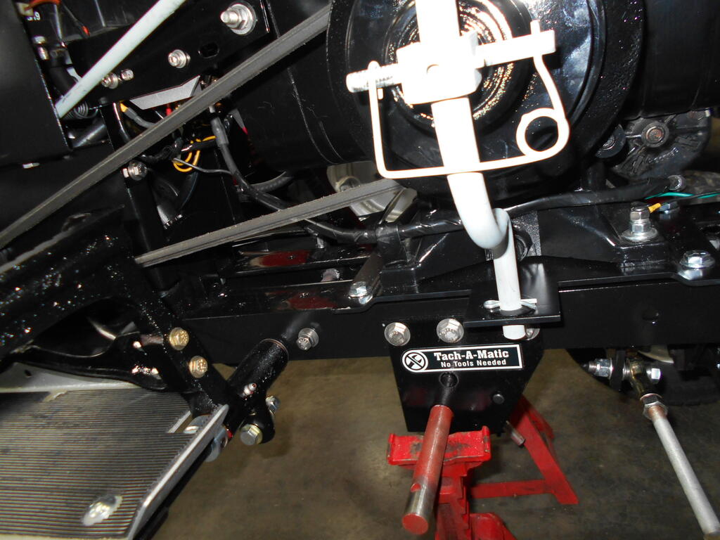

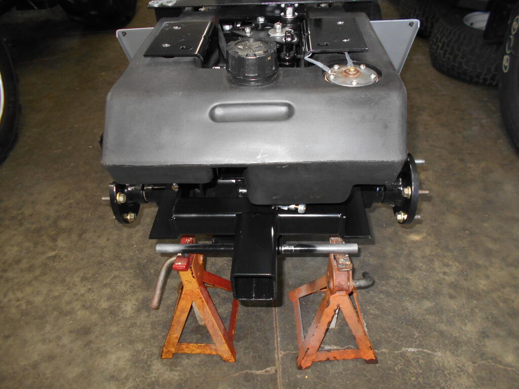

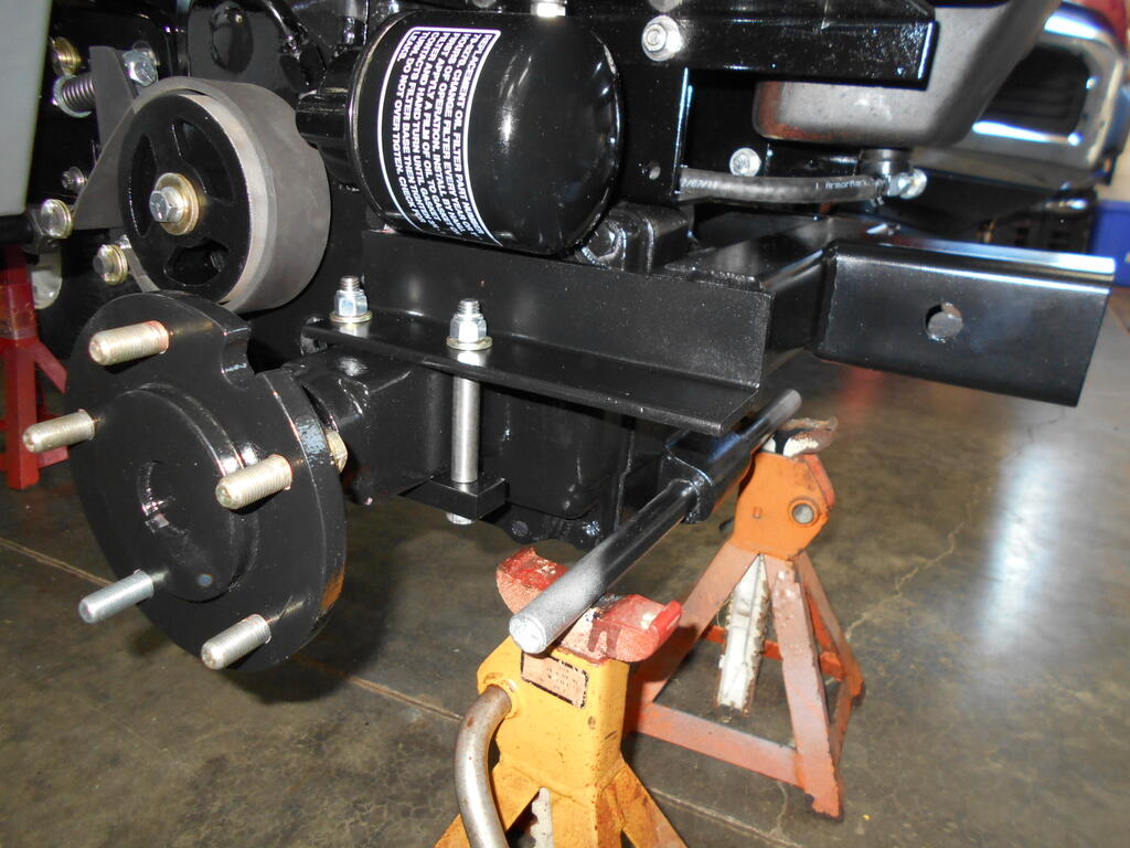

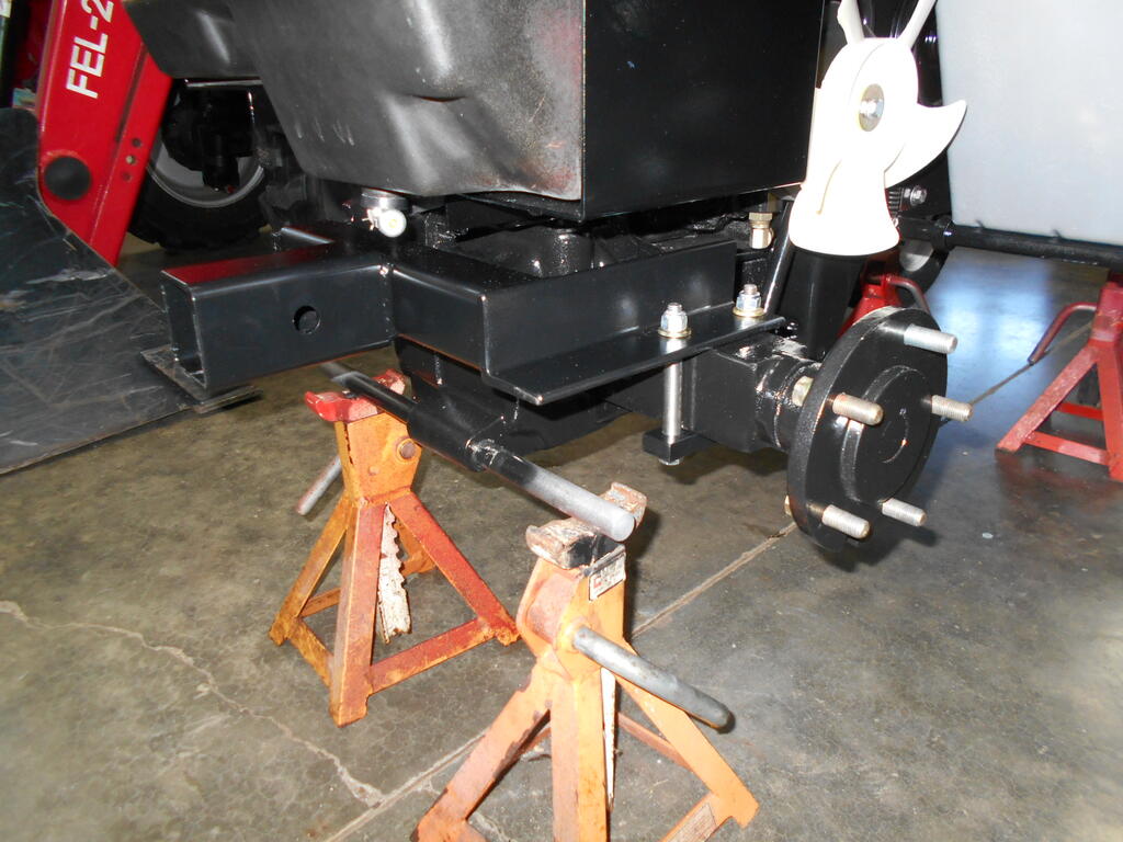

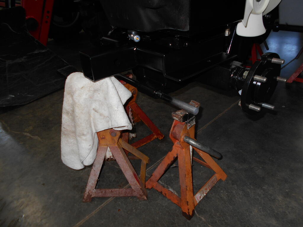

cleat 9,389 #388 Posted January 3, 2025 Receiver hitch ready to install. I made this up a few years ago out of 2" angle and tubing with a 2" receiver tube welded on. Note how the 2" angle on the left side has around 1/4" taken off the top for oil filter clearance. Receiver hitch just sitting on rear axle and held level with a jack stand. This will make installation much easier. Receiver hitch installed. 2 4 Share this post Link to post Share on other sites

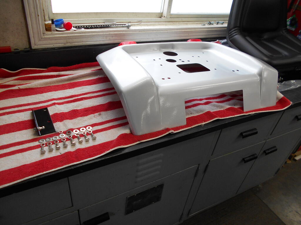

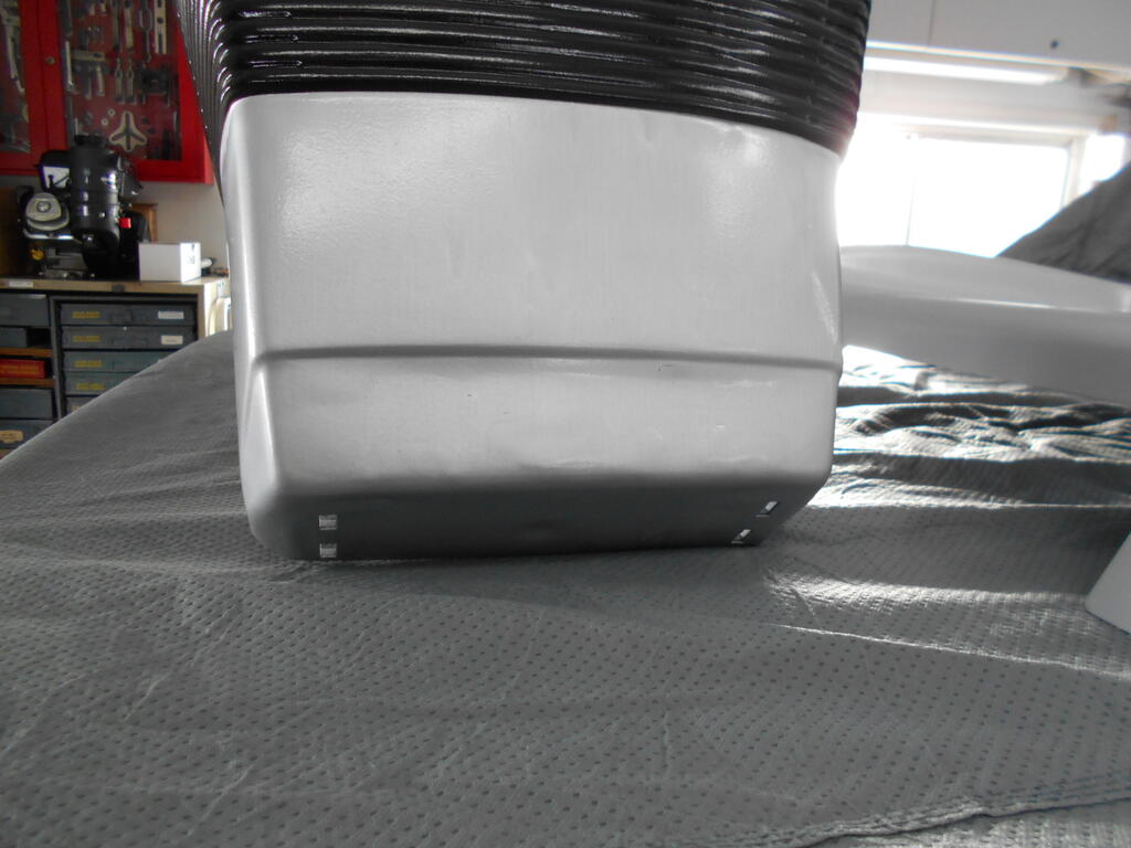

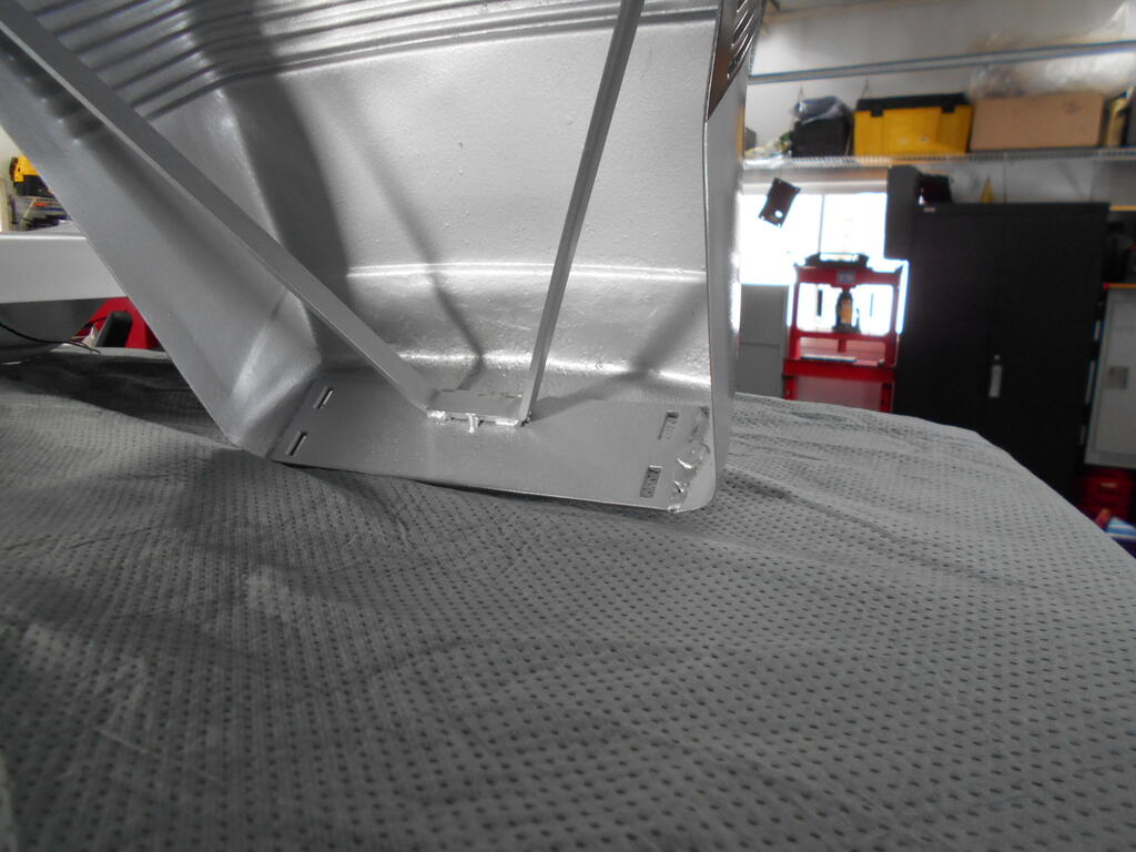

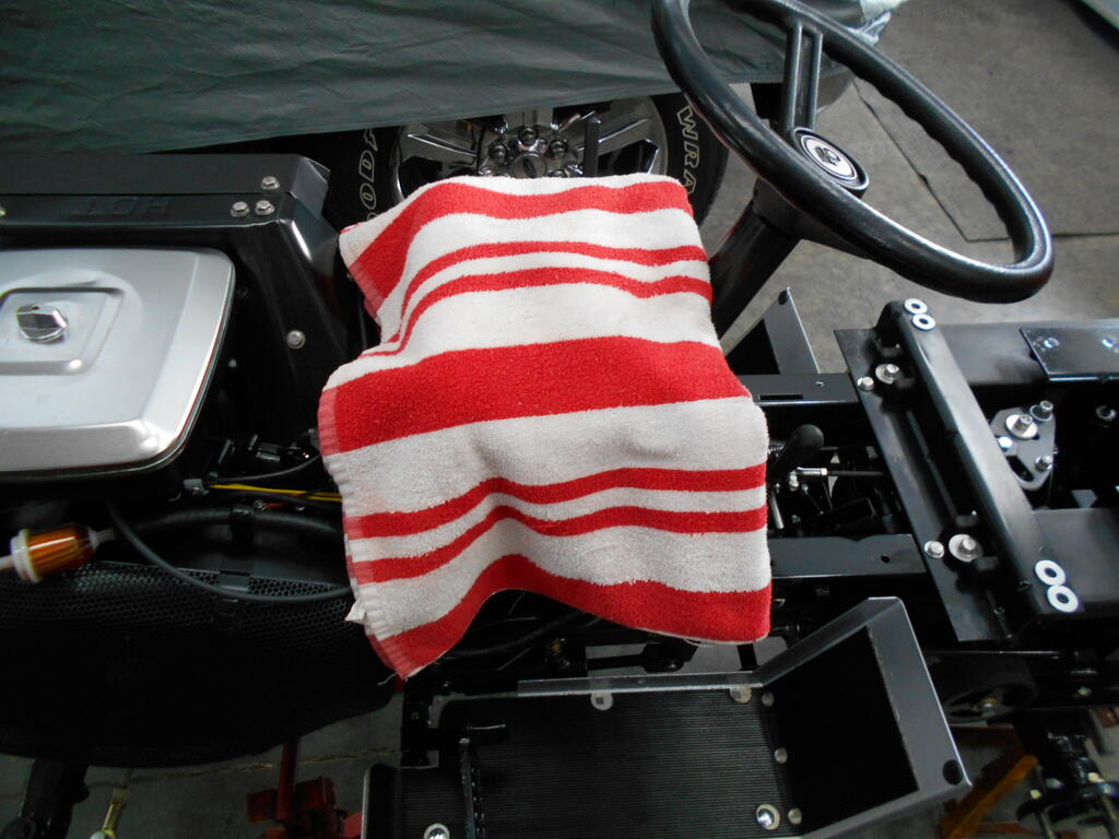

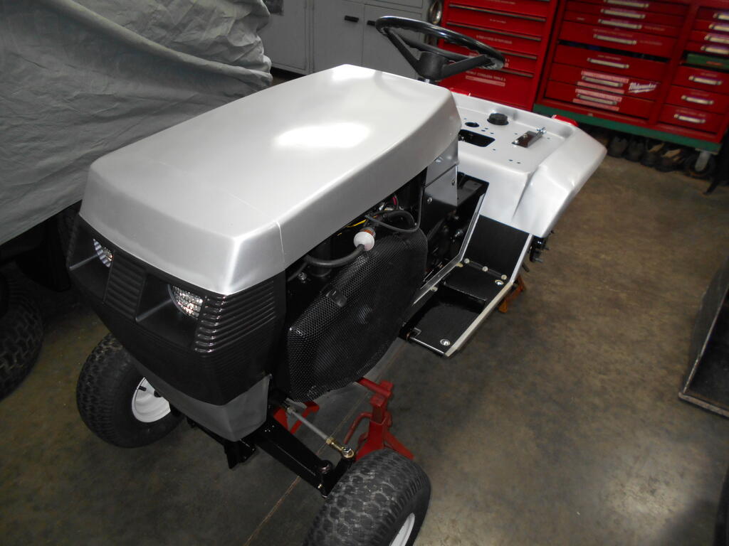

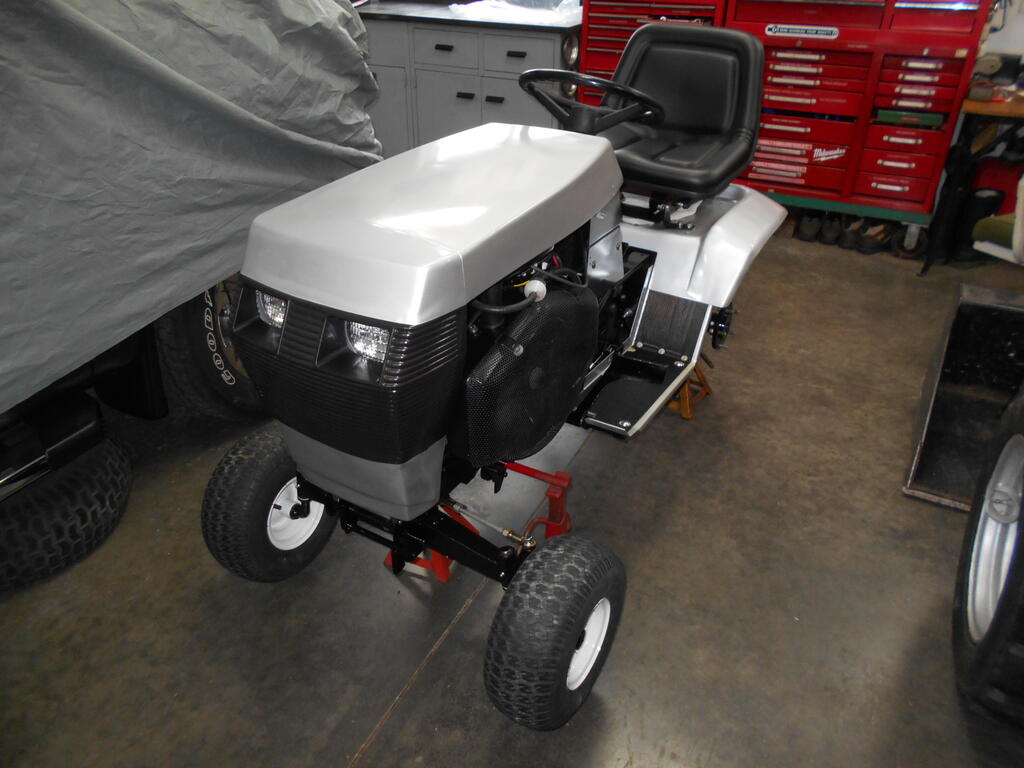

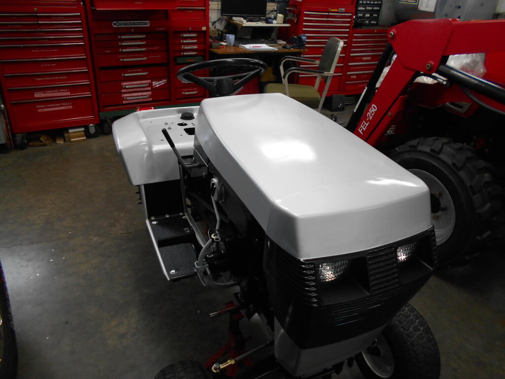

cleat 9,389 #392 Posted January 4, 2025 Hood ready to install. Hood mounting hardware ready to install. Towel placed on console for protection. Hood hinge ready to sit hood on. Hood bolted on and aligned. 4 3 Share this post Link to post Share on other sites

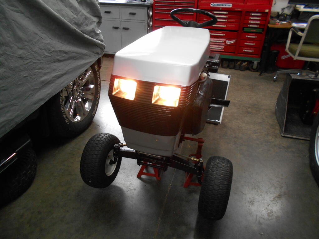

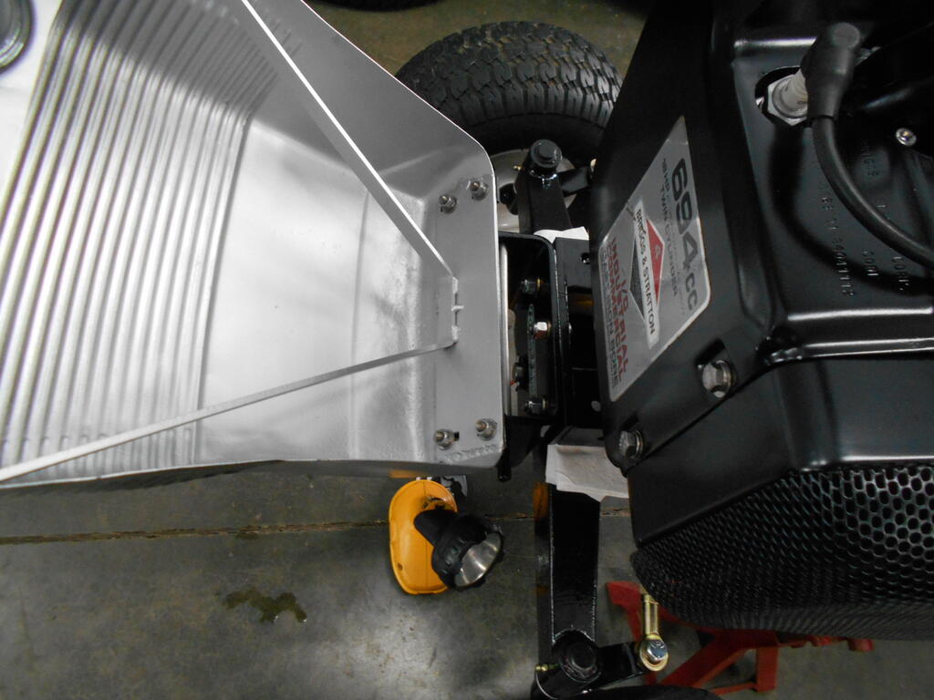

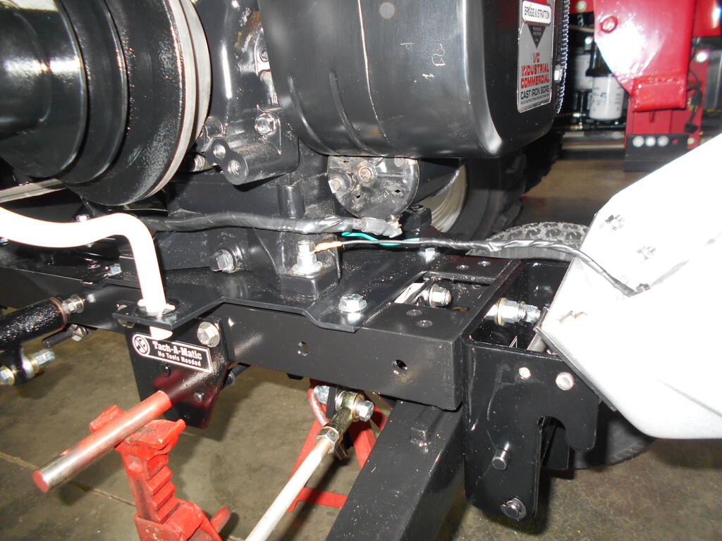

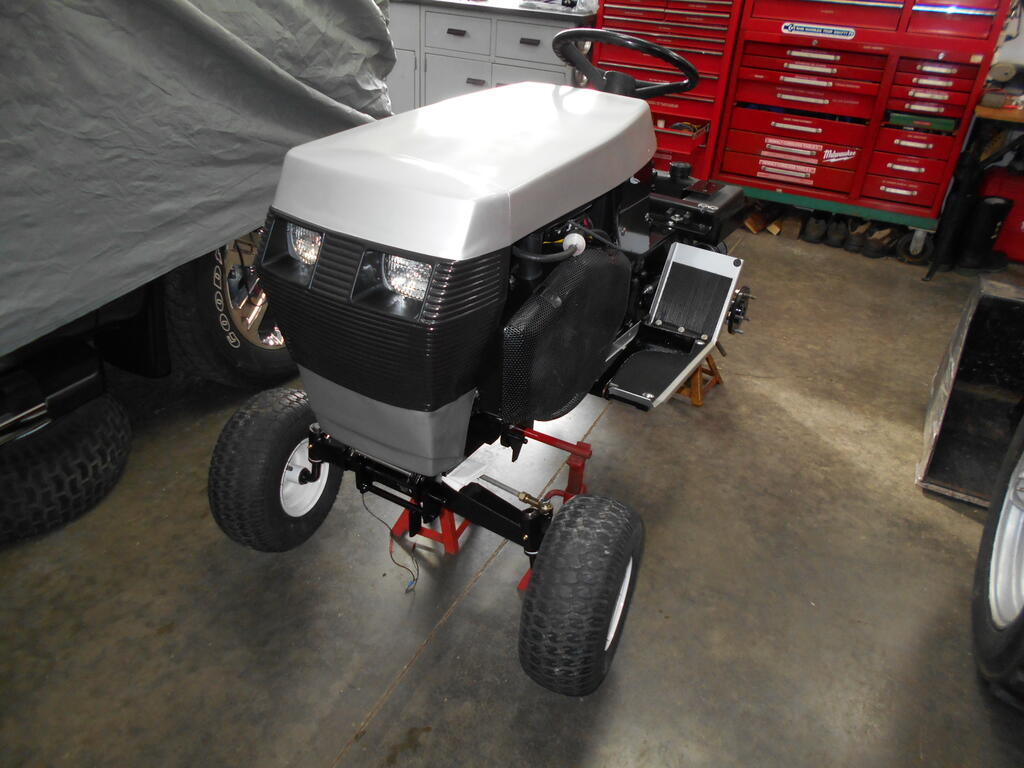

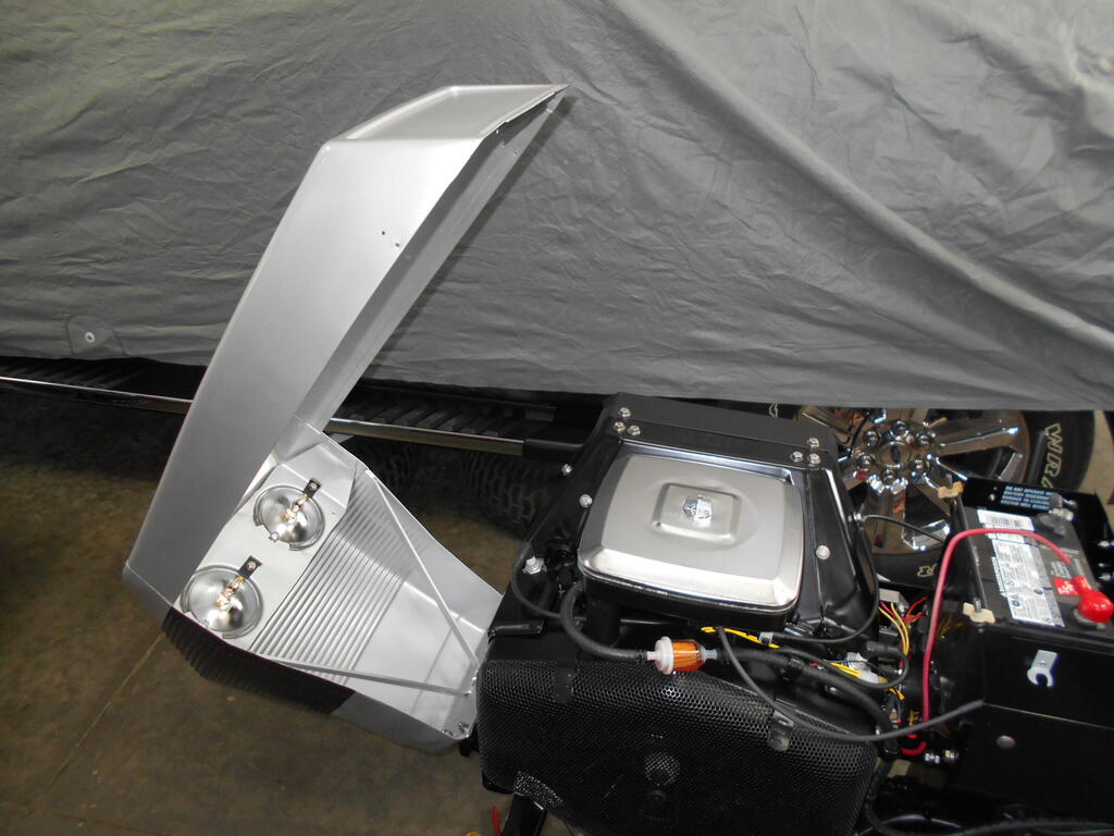

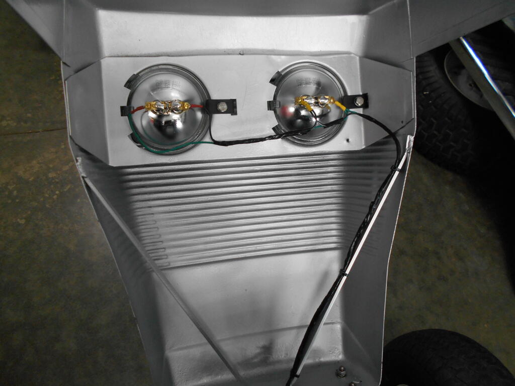

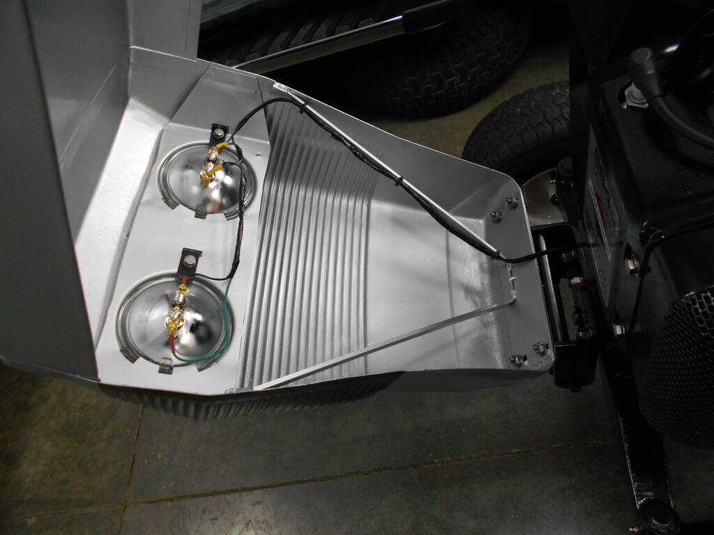

cleat 9,389 #393 Posted January 4, 2025 Headlight wiring harness made up and installed. I ran the headlight wire with the heavy wire to the starter as that puts it roughly where it needs to be. Headlights are grounded to an engine mounting bolt. Headlights on, engine off. 4 4 Share this post Link to post Share on other sites

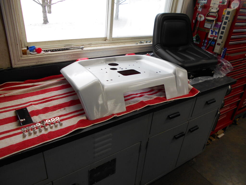

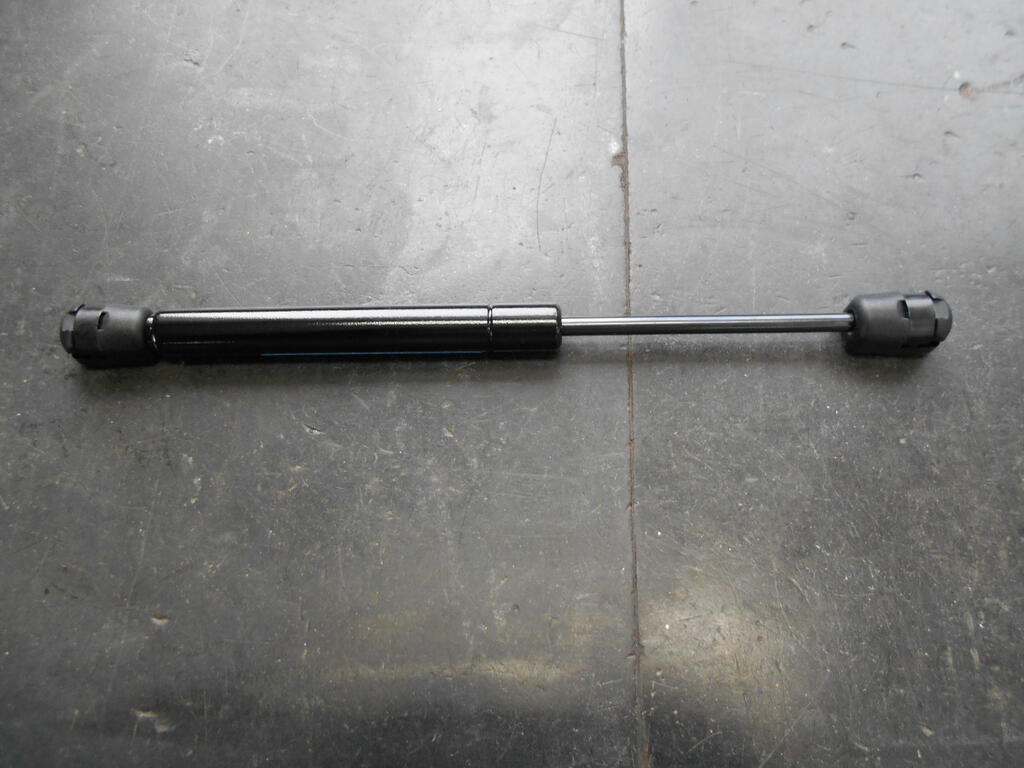

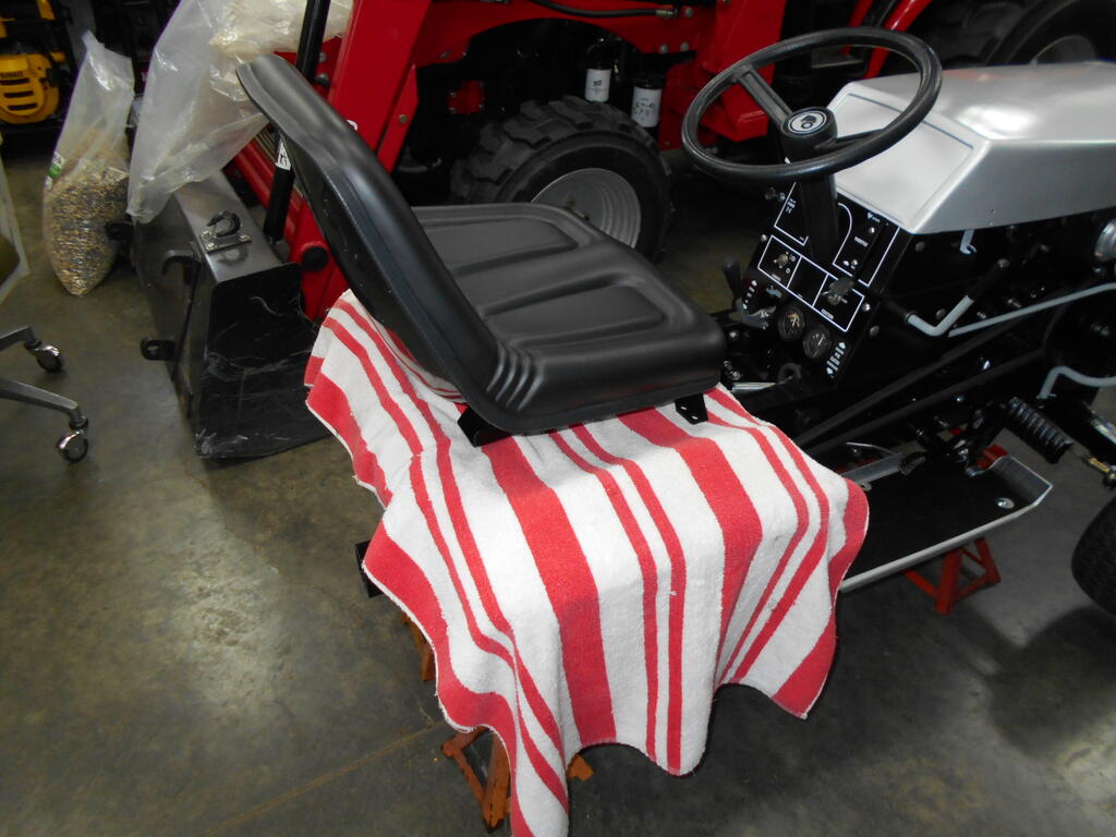

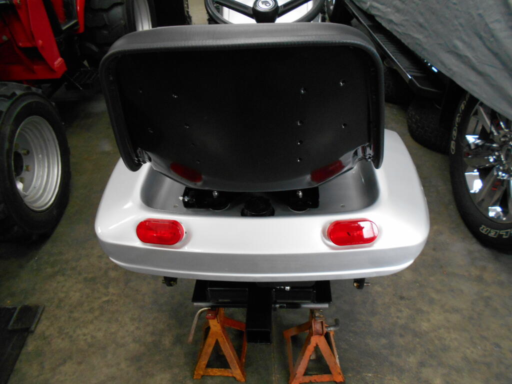

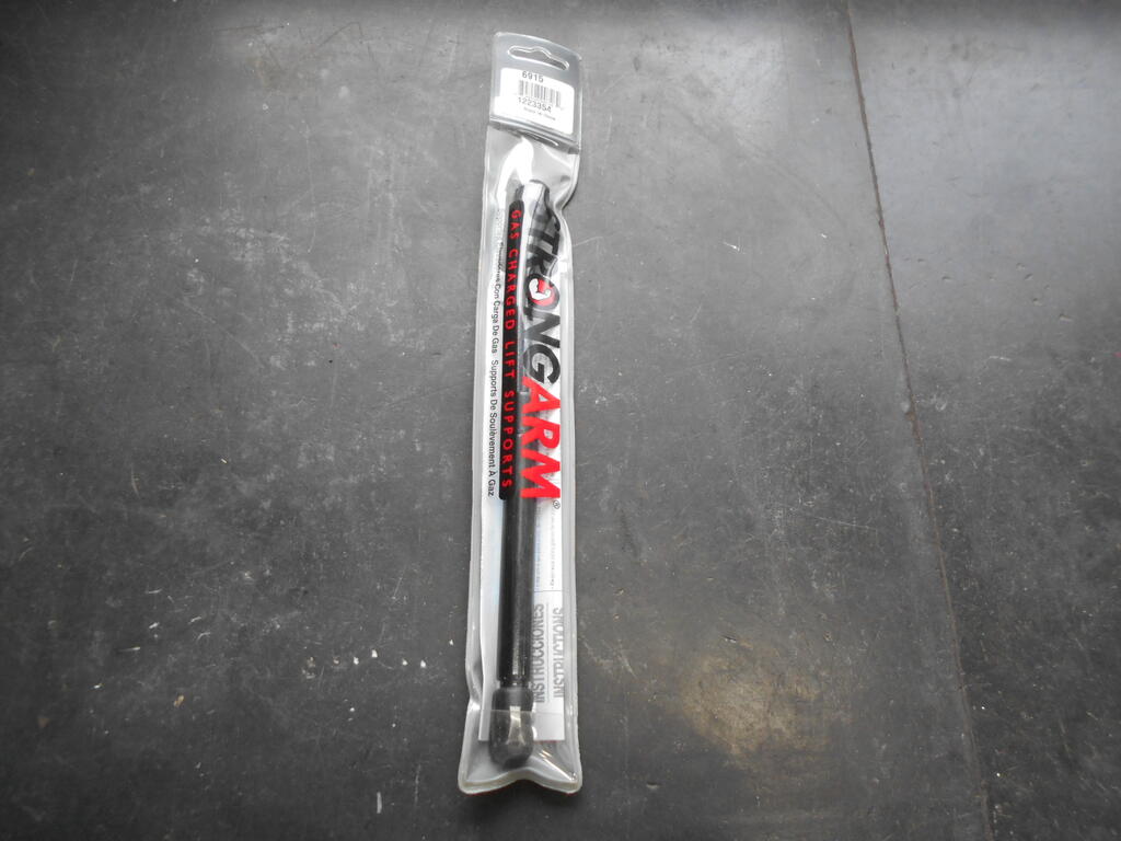

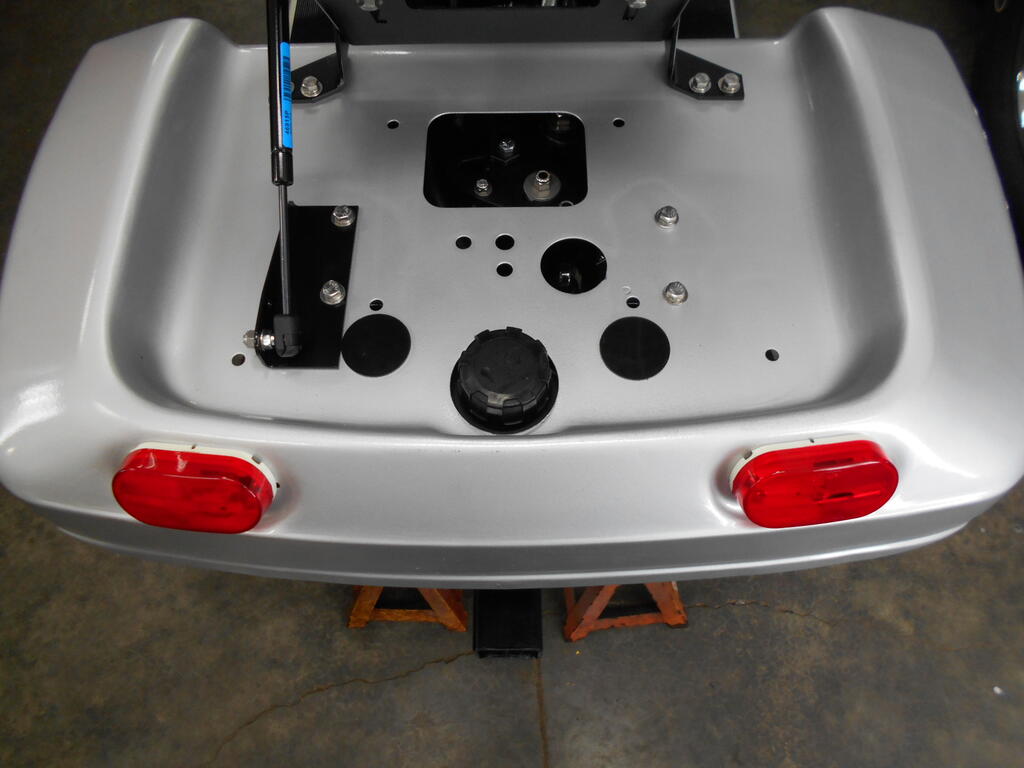

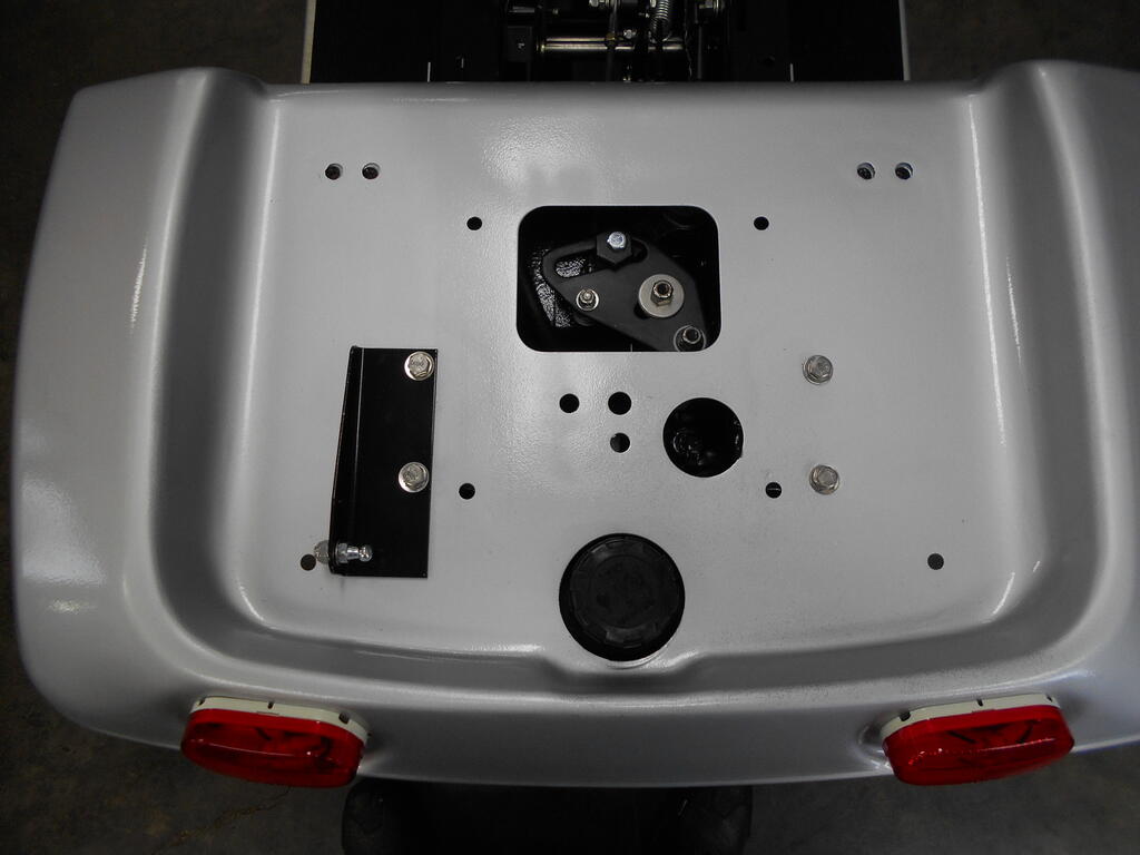

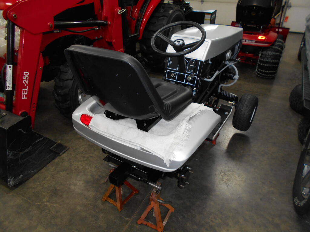

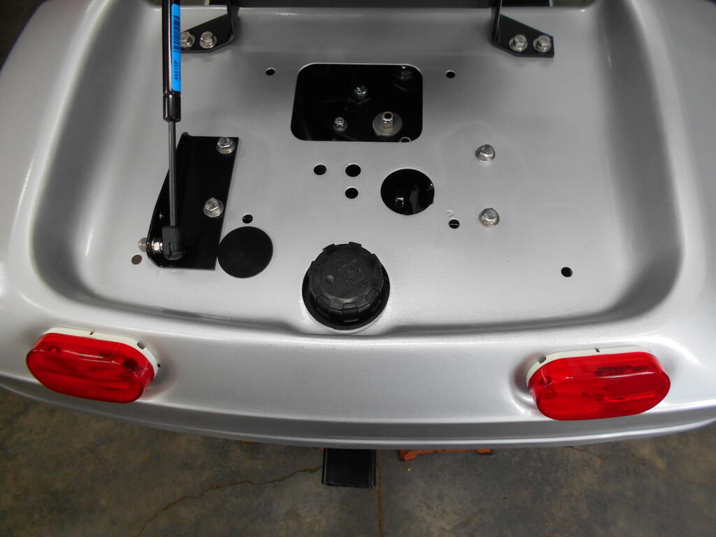

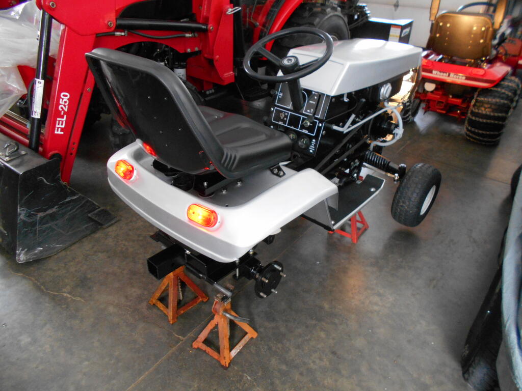

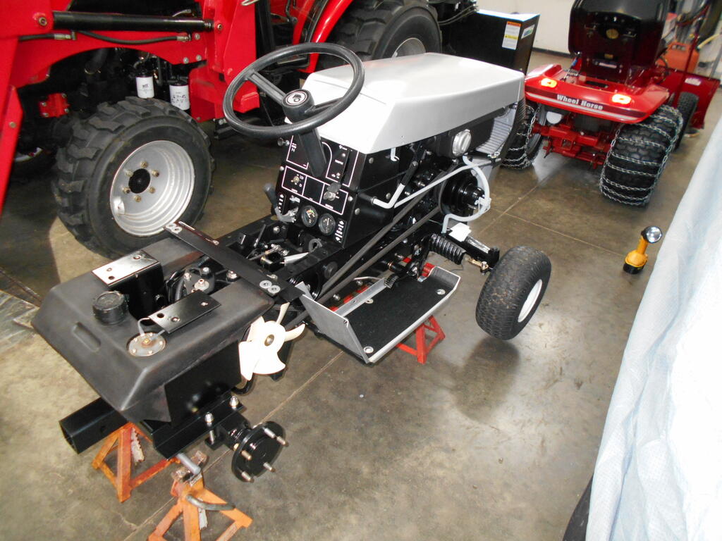

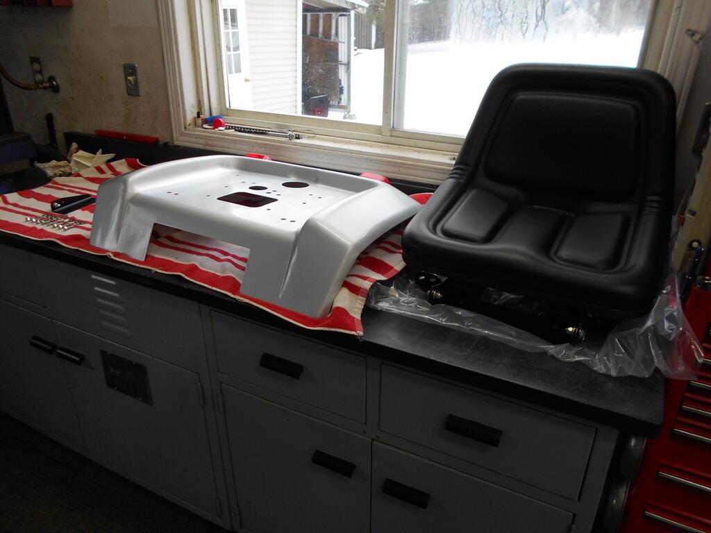

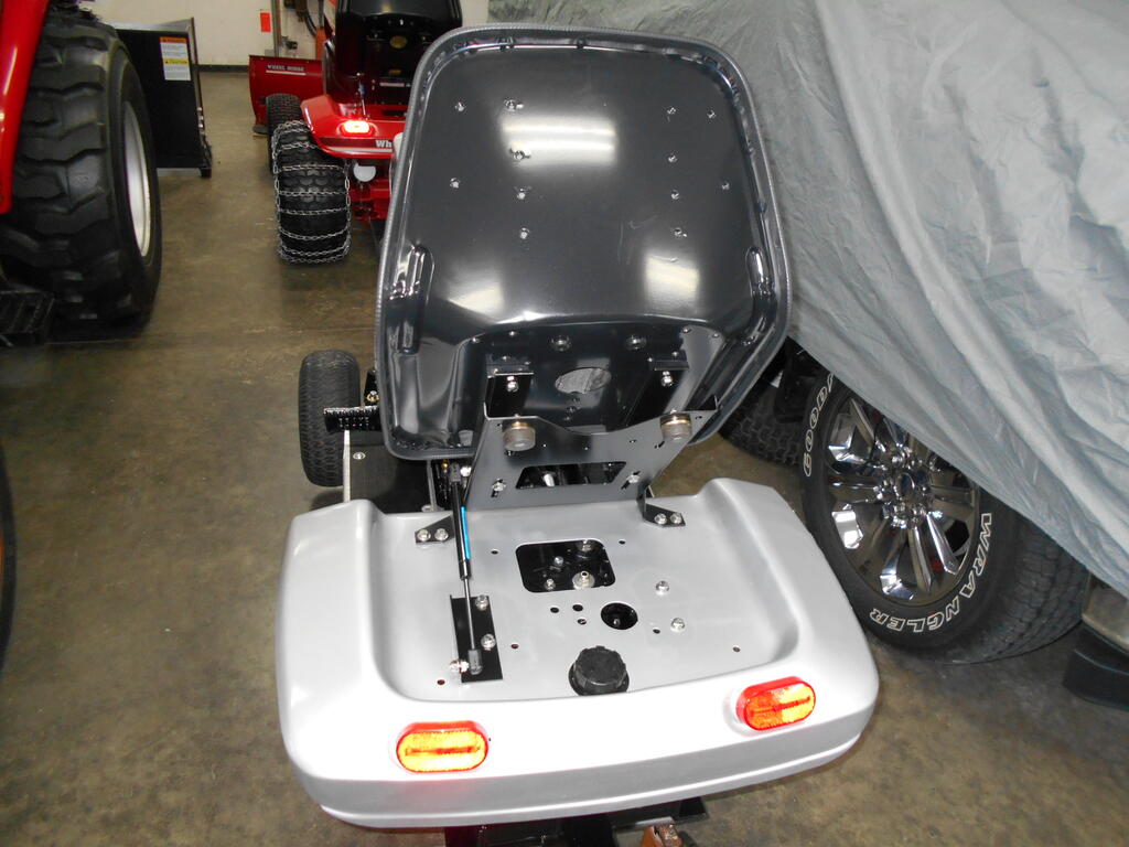

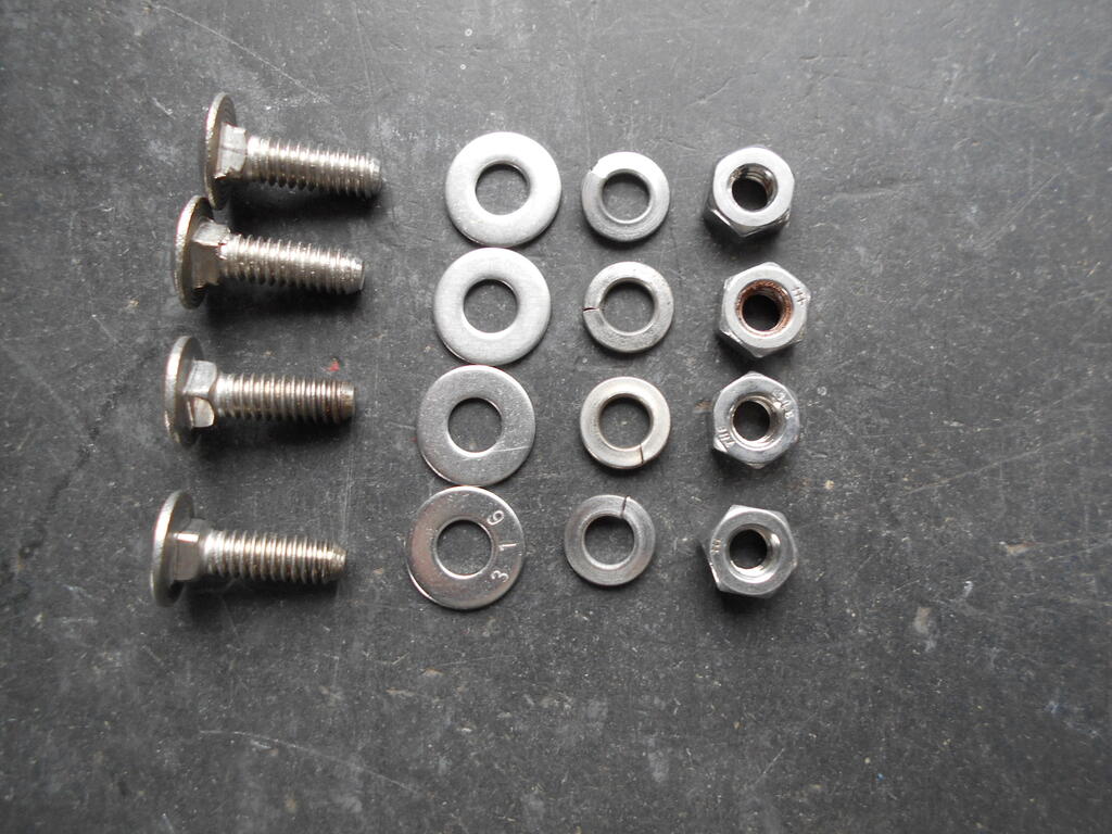

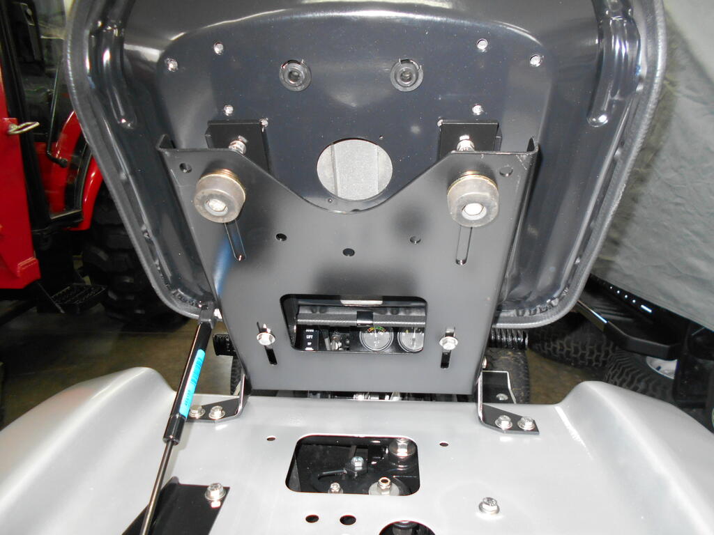

cleat 9,389 #399 Posted January 5, 2025 Rear fender and seat assembly ready to install. Rear fender and seat hardware ready to install. Rear fender installed. Seat just sitting on fender with towel for protection. Seat bolted on. Gas lift used to hold seat up. Gas lift ready to install. Gas lift installed. 1 1 Share this post Link to post Share on other sites

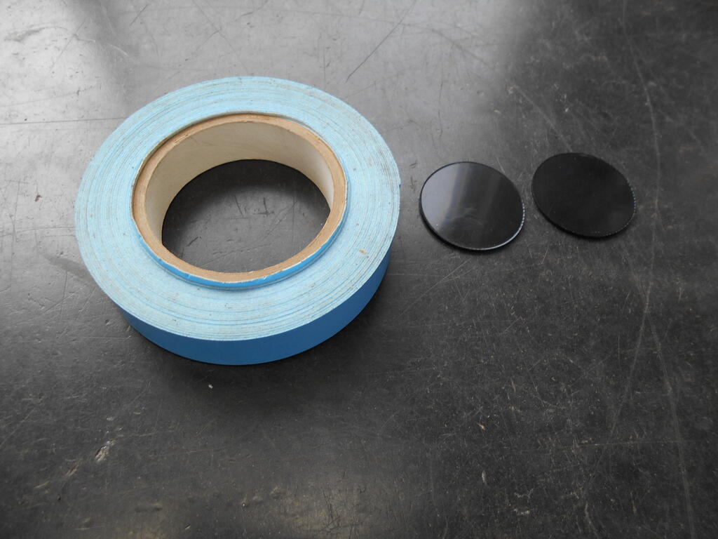

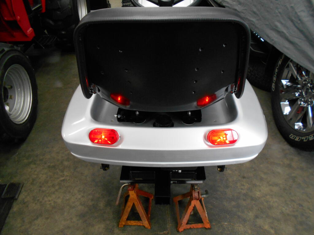

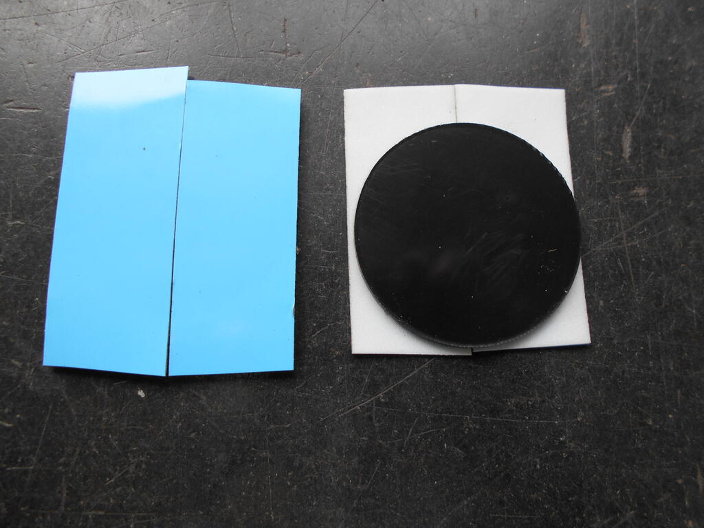

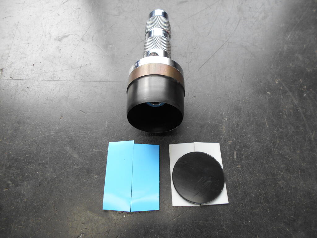

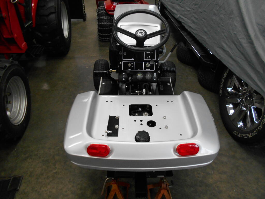

cleat 9,389 #400 Posted January 5, 2025 Fender protectors and double sided tape used to attach them. These are hard plastic discs that came stuck on valve gasket surface to protect them at a job a few years ago. These protectors are exactly 2" so I used a hole punch to trim off excess tape. One protector installed. Both protectors installed. Rubber bumpers under seat pivot plate. Seat now fully installed. Tail lights on. 1 2 Share this post Link to post Share on other sites
