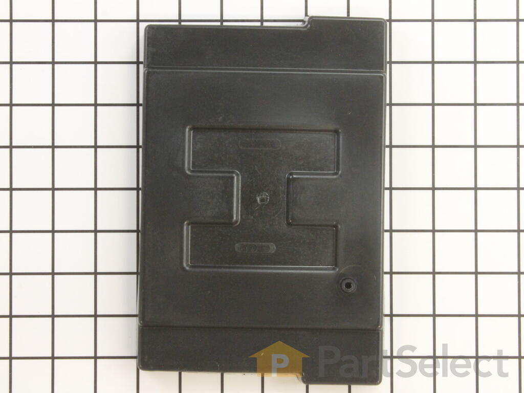

ANTPER 215 #1 Posted May 14, 2024 Can anyone suggest where I can find a replacement battery tray for example on a 312? TIA Anthony Share this post Link to post Share on other sites
lynnmor 9,042 #2 Posted May 14, 2024 Google "Toro 106948" and see if that is what. shopping.webp s-l960.webp 1 Share this post Link to post Share on other sites
