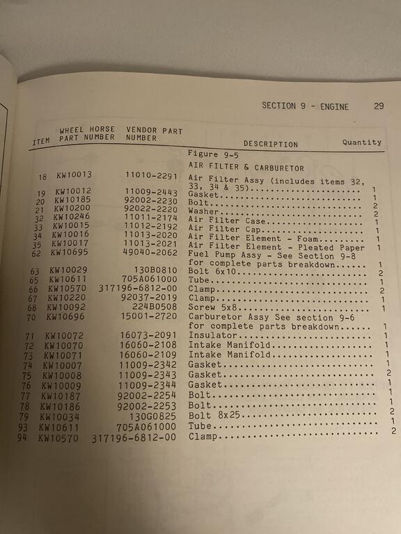

PWL216 1,134 #7 Posted May 14, 2024 3 hours ago, ebinmaine said: @PWL216. Paul you got any other sources? I know youve had some 200 series rigs? @ebinmaine Unfortunately no. I have two 257-H’s but haven’t had to do any carb work yet. @cJ_3D I have the Parts & Service Manual for the 257/252-H and it shows the 252-H using carb 5001-2720. The 5001-2720 is readily available. I did a quick search to see what the differences are and couldn’t find anything. See #70 below… 1 1 Share this post Link to post Share on other sites
cJ_3D 9 #8 Posted May 14, 2024 29 minutes ago, PWL216 said: @ebinmaine Unfortunately no. I have two 257-H’s but haven’t had to do any carb work yet. @cJ_3D I have the Parts & Service Manual for the 257/252-H and it shows the 252-H using carb 5001-2720. The 5001-2720 is readily available. I did a quick search to see what the differences are and couldn’t find anything. See #70 below… @PWL216 Paul you're my hero buddy! Thank you so much! I'm ordering one right away! I need to get me a copy of that. Handy little book! 2 Share this post Link to post Share on other sites
