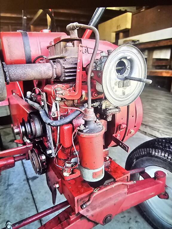

CodyLU568 2 #1 Posted May 11, 2024 Bought a 1967 wheelhorse 857 and I do not know if it's battery ignition or magneto ignition, how can I tell? Kohler k181 Share this post Link to post Share on other sites
ebinmaine 80,281 #2 Posted May 11, 2024 If it's original factory, that's a Battery ignition. If you post some pics we could tell for sure. Share this post Link to post Share on other sites
kpinnc 18,884 #4 Posted May 11, 2024 (edited) The coil (spark plug wire connects to) and breaker (connected to coil "-" terminal) on the front of the engine is a giveaway. You have battery ignition. Edited May 11, 2024 by kpinnc 2 Share this post Link to post Share on other sites
CodyLU568 2 #5 Posted May 11, 2024 2 minutes ago, kpinnc said: The coil and breakers on the front of the engine is a giveaway. You have battery ignition. Thank you! Trying to learn as much as I can about it. I'm a first time owner of a wheelhorse for about 2 weeks now 1 Share this post Link to post Share on other sites

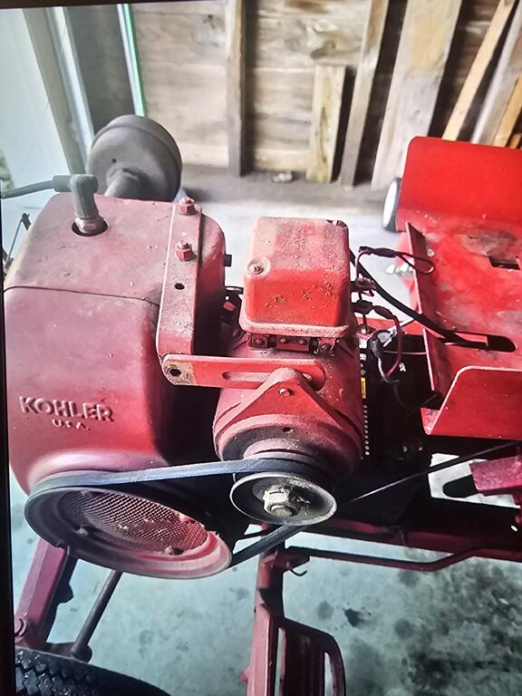

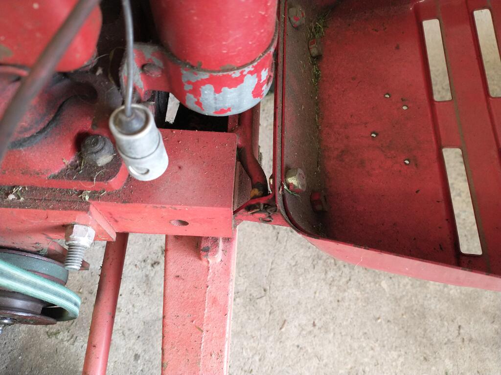

Ed Kennell 46,985 #11 Posted May 11, 2024 Just wonder what this bar is for ? Share this post Link to post Share on other sites
squonk 47,887 #12 Posted May 11, 2024 (edited) Hood hinge Edited May 11, 2024 by squonk 1 Share this post Link to post Share on other sites
Ed Kennell 46,985 #13 Posted May 11, 2024 Not the hood hinge Mike, the flat bar bolted to the block at the blue arrow. Share this post Link to post Share on other sites
CodyLU568 2 #14 Posted May 11, 2024 3 hours ago, Ed Kennell said: Just wonder what this bar is for ? That bar was just holding the fuel line and another wire, it looked to be home made. I have the engine at the machine shop now, would slowly like to get this thing restored and as close to orginal as possible 1 Share this post Link to post Share on other sites

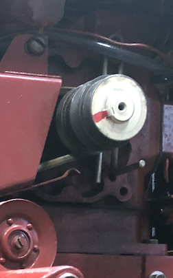

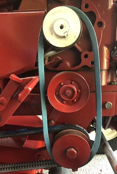

Handy Don 17,316 #16 Posted May 11, 2024 4 hours ago, Ed Kennell said: Just wonder what this bar is for ? On at least a couple of K181’s I’ve see with the side PTO, there was a bent rod bolted there as a belt stop for when the PTO was disengaged. I’ve not found an original so I made one This image shows the belt without the belt stop with the mower deck installed. This image shows the belt stop installed but without the mower deck installed (sorry, the tractor isn’t here so I can’t get a better shot right now). Share this post Link to post Share on other sites
Ed Kennell 46,985 #17 Posted May 11, 2024 7 minutes ago, squonk said: It's hell to get old! Your just a beginner. In 30 years, you'll be a happy old guy. 2 1 Share this post Link to post Share on other sites
Ed Kennell 46,985 #18 Posted May 11, 2024 12 minutes ago, Handy Don said: This image shows the belt stop installed I can see that bent rod working as a belt stop Don, but that flat bar doesn't extend out where it would touch the belt. Unless there was a horizontal rod threaded into the flat bar at some time. Share this post Link to post Share on other sites
Handy Don 17,316 #19 Posted May 12, 2024 3 hours ago, Ed Kennell said: I can see that bent rod working as a belt stop Don, but that flat bar doesn't extend out where it would touch the belt. Unless there was a horizontal rod threaded into the flat bar at some time. Yep, I agree. Still a mystery. Share this post Link to post Share on other sites
