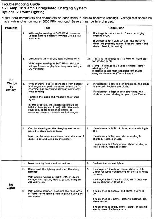

Sparky-(Admin) 24,769 #15 Posted June 9, 2024 More questions: This Magnum 14 has the weaker 3a charging system. I’m used to metering out the stronger 15a charging systems. What should I see at the battery when running? Engine off it was 12.5/12.6….running at full RPM’s it was 12.9v. Is that correct? Doesn’t seem like it is but I’m not familiar with this type charging system. Share this post Link to post Share on other sites

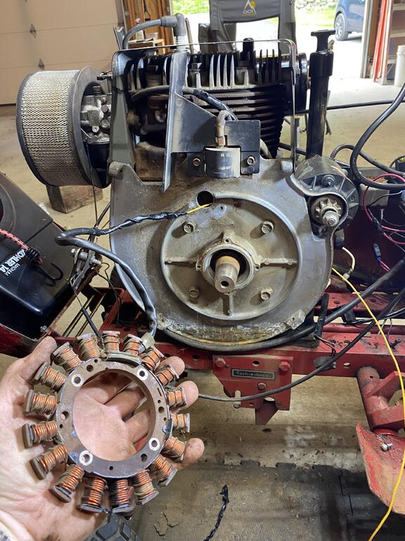

Sparky-(Admin) 24,769 #16 Posted June 9, 2024 And here’s what’s coming outa the motor….idle speed and full speed. Share this post Link to post Share on other sites
squonk 45,804 #17 Posted June 9, 2024 Never worked on one but that's probably all she wrote! Share this post Link to post Share on other sites
Sparky-(Admin) 24,769 #19 Posted June 9, 2024 23 minutes ago, pfrederi said: Great info!! Thanks!! Share this post Link to post Share on other sites

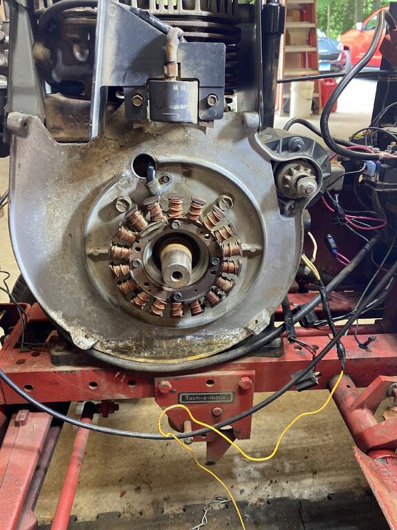

Sparky-(Admin) 24,769 #20 Posted June 29, 2024 At the WHS last weekend I found a guy with a Magnun 14 with a hole in the block…but it had the better charging system than mine…so I bought the stator, regulator, flywheel and other associated parts to convert this one to the better HD charging system. Apparently the weaker charging system comes with one less flywheel magnet 2 Share this post Link to post Share on other sites
Sparky-(Admin) 24,769 #21 Posted June 29, 2024 Good grief!! Getting the wires out of the raceway was tough…and getting the new ones in is even tougher! Any tips? Share this post Link to post Share on other sites
squonk 45,804 #22 Posted June 29, 2024 12 minutes ago, Sparky said: Good grief!! Getting the wires out of the raceway was tough…and getting the new ones in is even tougher! Any tips? Call an electrician!!! Spray a little silicone on the harness. 1 Share this post Link to post Share on other sites
Sparky-(Admin) 24,769 #23 Posted June 29, 2024 So I had to streamline the tape joint, pull like my life depended on it….and what really got it in were some choice “descriptive words” 1 Share this post Link to post Share on other sites
Sparky-(Admin) 24,769 #24 Posted June 29, 2024 Ok, it seems I have been successful!! 12.x not running and 14.x running 4 1 Share this post Link to post Share on other sites
