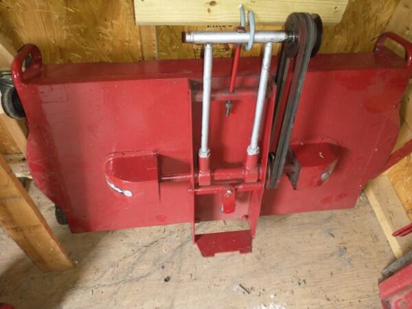

Keaton 466 #1 Posted May 8, 2024 first how do i take the deck off a 701 i tred for a bit earlier but had to go. and are thoes decks compaiable with all round hoods, it is on a 701 currently. but how do i take it offf and is it compadiable with all round hoods? Share this post Link to post Share on other sites
gwest_ca-(File Mod) 12,557 #2 Posted May 8, 2024 Would a manual help? Share this post Link to post Share on other sites
ri702bill 13,396 #3 Posted May 8, 2024 (edited) Keaton - the 701 Early style "Suitcase Deck" uses a 3 point mount. Unbolt the lift rod, remove the RH forward bracket. slide the deck sideways to get out of the LH bracket. Slide the deck out sideways under the tractor. Later years had a revised front mount - the early Tach-a-matic. MUCH easier. (I am not a huge fan of that style deck - the open construction had no torus curves part to improve grass lift. And the remove-the-wheel and reposition it to change deck height was a PITA) I actually have one like yours, used ir once. The later 1960's curved RM series cut better and are easier to use... Edited May 8, 2024 by ri702bill 3 Share this post Link to post Share on other sites
Keaton 466 #4 Posted May 8, 2024 i think ill just take the brackets off, and what models will this deck fit? thanks for the help and advice Share this post Link to post Share on other sites
squonk 48,429 #5 Posted May 8, 2024 48 minutes ago, Keaton said: i think ill just take the brackets off, and what models will this deck fit? thanks for the help and advice Early pre tach a matic hitch was called the quick hitch. no unbolting needed. I use this early 63 square deck on my 67 867 1 1 Share this post Link to post Share on other sites
