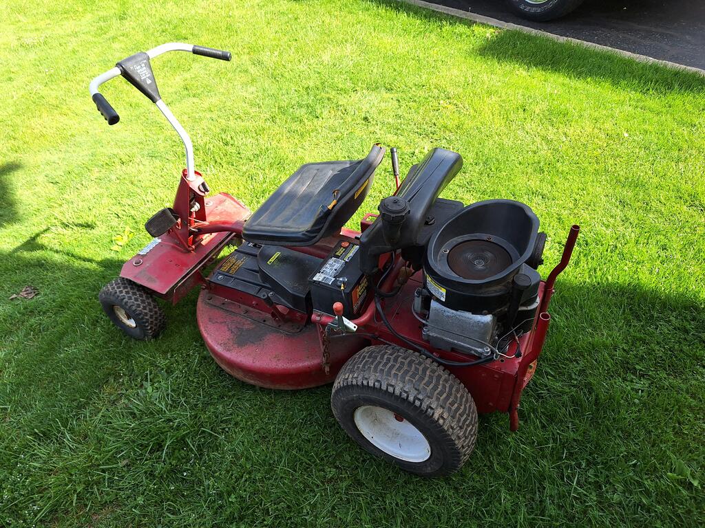

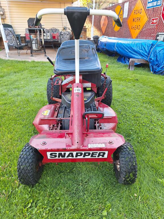

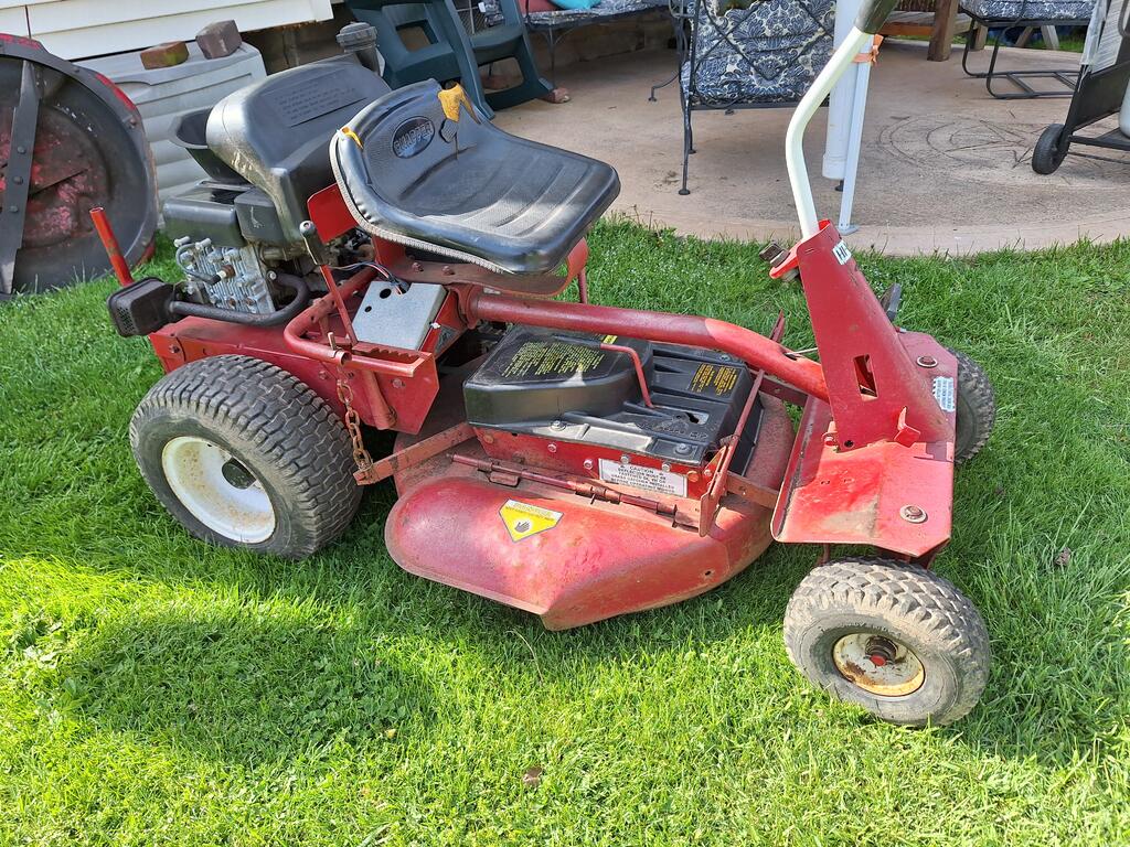

D_Mac 9,339 #1 Posted May 8, 2024 So this ended up in the back of my truck today. Price was right. Runs and drives but when you try to engage the blade it shakes like hell. When I got it home it looks like one of the wings on one side of the blade is missing. Going to get a new blade for it. It's engine had been replaced at some point. Also going to need a battery and a tube for one of the rear tires. Lol other then all that it seems ok. Look at it closer tomorrow. 7 1 Share this post Link to post Share on other sites
Pullstart 71,563 #2 Posted May 8, 2024 The replacement engine is complete with a hood shroud, aka water funnel! 4 Share this post Link to post Share on other sites
D_Mac 9,339 #3 Posted May 8, 2024 Yeah I'll be taking that off. Share this post Link to post Share on other sites
ri702bill 13,396 #4 Posted May 8, 2024 "Run, Forrest!!!" Share this post Link to post Share on other sites

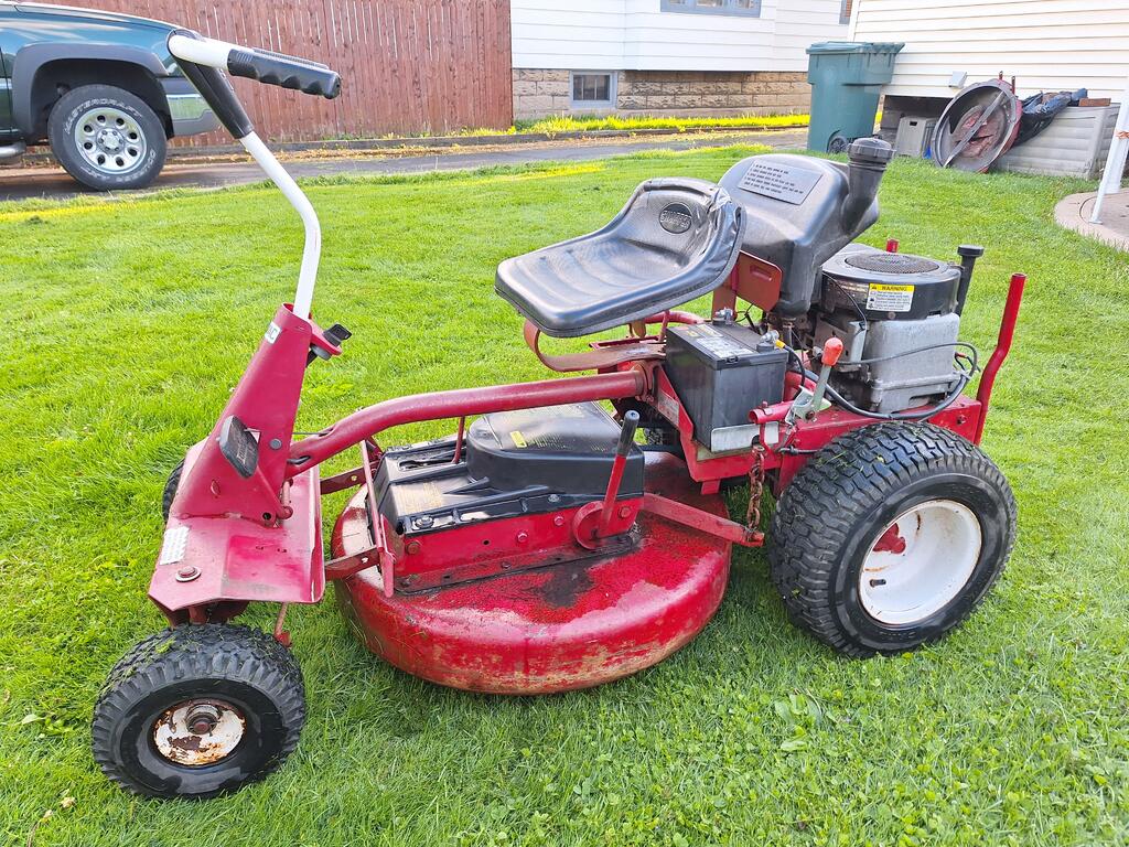

pfrederi 21,342 #5 Posted May 8, 2024 Those front tires look to have the same tread pattern as some Lawn rangers. What size are they??? The LR size and pattern are no longer made. Share this post Link to post Share on other sites
D_Mac 9,339 #6 Posted May 8, 2024 14 minutes ago, pfrederi said: Those front tires look to have the same tread pattern as some Lawn rangers. What size are they??? The LR size and pattern are no longer made. I'll check later. I just unloaded it off the truck and parked it. I'll look it all over later Share this post Link to post Share on other sites
Handy Don 17,735 #7 Posted May 8, 2024 The big single blade on the Snapper RERs is heavy, especially with the Hi-Vac wings bolted on. I strongly recommend a good quality blade balancing tool to get end-to-end as well as front to back balance instead of simply hanging it on a nail. I learned this reluctantly (sigh) at the cost of a spindle bearing. Also, it’s a good idea to confirm that the blade belt is in good condition--cracks or badly worn parts of the belt sidewall can cause vibration that feels like a balance problem. 1 Share this post Link to post Share on other sites
D_Mac 9,339 #8 Posted May 8, 2024 Yes the vibration is real bad. You can't even fully engage the blade because of it. You have to back off. I'll update when I look it over. That's my problem, I buy first, look it over later. But I got it cheap enough. 3 Share this post Link to post Share on other sites
D_Mac 9,339 #9 Posted May 9, 2024 (edited) Well I removed the wings on the blade. One side had about 90% of it missing. Took them off of both sides and I am now able to engage the deck. I also removed that thing over the debris screen. Most likely it will need a new blade but I won't be keeping it. Operates as it should now. Run Forrest Run ! Oh yeah.. front tire size is 4.10/3.50 - 4 Edited May 9, 2024 by D_Mac 3 Share this post Link to post Share on other sites

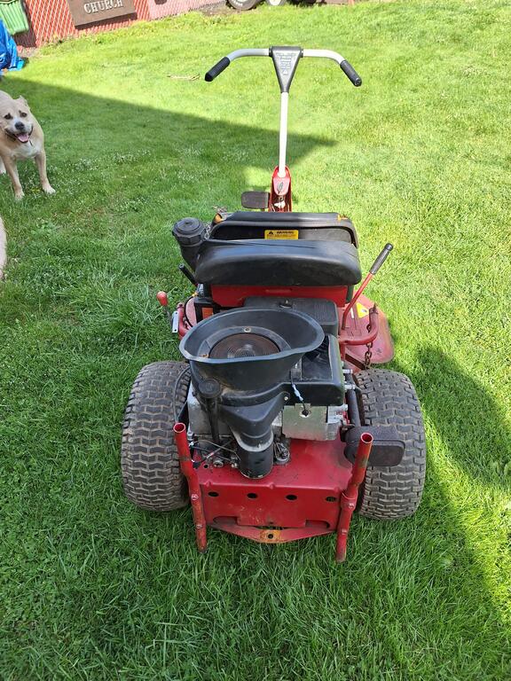

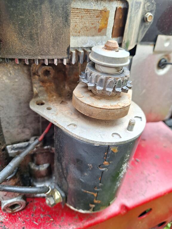

D_Mac 9,339 #10 Posted May 11, 2024 Sooo I had I buyer for the Gump Mobile. I went out to fire it up to make sure everything was OK. I turned the key and it made a horrible screeching noise. Well the engine wasn't turning, starter making all the noise. So I took the cover off and yup.... gear is sheared smooth. Why on earth would the make the starter gear out of plastic??? Soooo ordered a new PLASTIC gear for it. Not exactly sure on how to get it off but will take a closer look when I have the gear in hand. Grrrrrrr. 3 Share this post Link to post Share on other sites
953 nut 70,661 #11 Posted May 11, 2024 14 hours ago, D_Mac said: Why on earth would the make the starter gear out of plastic??? So they can sell lots of overpriced replacement parts. 3 1 Share this post Link to post Share on other sites
Horse Newbie 7,405 #12 Posted May 11, 2024 I like those lawn mower style ape-hangers… looks like an orangutan could use it… 1 1 Share this post Link to post Share on other sites
D_Mac 9,339 #13 Posted May 19, 2024 So the new starter gear is installed. Easy enough job. Being plastic is why you can buy them in a 2 pack. 1 Share this post Link to post Share on other sites
