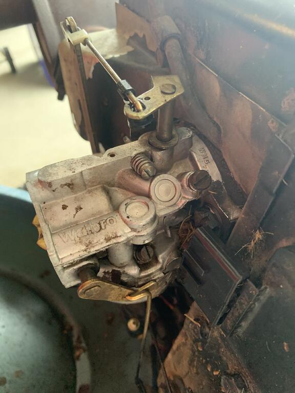

Painter314H 4 #1 Posted May 7, 2024 Hello all. I'm looking for a replacement carb for my 1993 314-H (severe shaft wear/wobble). Not having any luck. I've searched around using my motor tag information which a Kohler Magnum 14 HP, Serial number M14S, Spec number 601559, Serial Number 2304700043. I've been told that the OEM number for the Walbro carb is 47 853 29-S. I cant seem to find a direct replacement, or it has been discontinued. Any help would be much appreciated. Thank you. Share this post Link to post Share on other sites

Painter314H 4 #6 Posted May 8, 2024 Thank you All. Correct my throttle shaft bore is worn out badly, about twice the size of the shaft. Looking at the size 30 carb on isavetractors, I noticed the link arm on top of the shaft has a ball stud, however mine just has a hole. Would I just remove the ball stud then? 1 Share this post Link to post Share on other sites

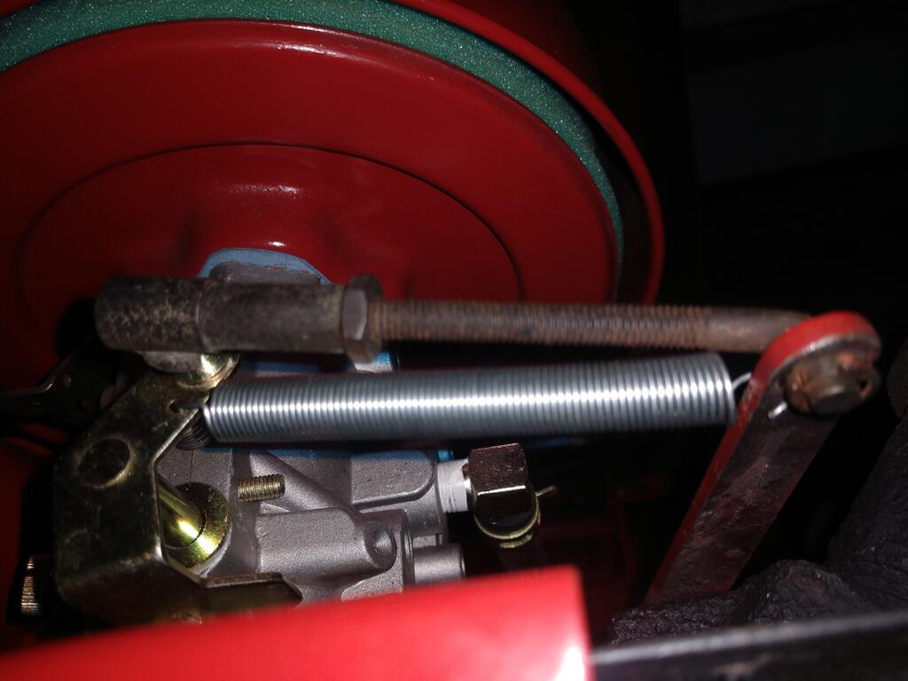

kpinnc 18,886 #8 Posted May 8, 2024 16 minutes ago, Painter314H said: Would I just remove the ball stud then? Yes, or get the link that works with one. Also add a small spring between the governor and throttle shaft. It takes up the slop and makes for much better throttle response. You'll notice the holes are already in both parts. Just add a small spring from your local hardware. 1 1 Share this post Link to post Share on other sites

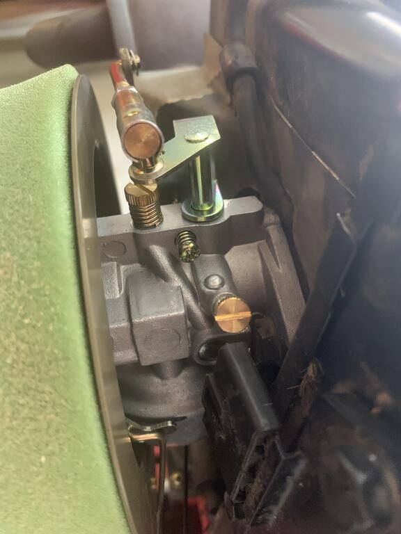

Painter314H 4 #9 Posted May 8, 2024 Thank you all for your help. I ordered the Kohler #30 carb and also the adjustable linkage arm and mounting gasket from isavetractors. I’ll see how it all works out in a couple of days once received and installed. Share this post Link to post Share on other sites

Painter314H 4 #15 Posted May 11, 2024 New carb, gaskets, and fuel line on. Runs nice and smooth. Just need to grab a spring next time I’m in town. Thanks to all for the help. 2 Share this post Link to post Share on other sites
Painter314H 4 #16 Posted May 11, 2024 I think i can rebuild the old carb. Bottom hole tight. Top hole egg shaped and throttle shaft worn. Share this post Link to post Share on other sites
