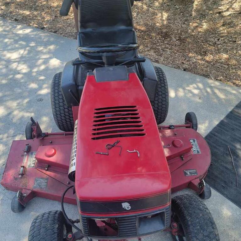

DukeRooster 2 #1 Posted May 5, 2024 (edited) Ok so I have a 520 H Onan 20 hp 275 hours, with a 38 inch deck. I just Bought a nice 60 inch Deck from a local guy. The Mule drive belt on the 60 inch deck broke so i swaped the mule and belt from the origional 38 inch deck as a quick fix and it seems to work fine with the 60 inch deck. The only thing ive noticed is some blade speed reduction in thicker grass but overall i think its working propperly. Ive read the mule drives are differnt. Am i missing something? Also this is the 1st time ive used a mower on my 520H the PTO belt goes on the rear groove of the pto pulley not the front groove correct? I guess my real question is all factors above will any of this effect the blade power or speed in tall grass. Ive manage to mow about 10 hrs and 4 acres twice since i installed the 60 inch deck with the mule from the smaller deck. Overall beautiful cut but seems to slip and blade speed reduction thicker areas. Edited May 5, 2024 by DukeRooster Share this post Link to post Share on other sites

lynnmor 9,081 #4 Posted May 5, 2024 24 minutes ago, Wayne0 said: First off, to Red Square. My two tractors, a 1987 Work Horse and 1992 520H have the same mule. The belt to the mule/deck goes in the OUTSIDE groove on the pulley. Inside is bigger and will give you slower belt speed. Just the opposite, the belt goes on the larger pulley for a faster blade speed. The correct mule drive has spring loaded pulleys to compensate for the change in location as the deck height is adjusted. Running a fixed location mule drive may lead to the belt being too loose or too tight. 3 1 Share this post Link to post Share on other sites

Rick3478 478 #6 Posted May 5, 2024 The standard mule will fit with the 60" deck, but belt angles may be less than optimum, and you may be shortening the life of the belt. The usual mule used on the 60" deck has the outer idler offset a bit to feed the larger deck pulley more direct. Mowers usually drive from the large inner PTO sheave for maximum blade speed. Share this post Link to post Share on other sites
Ed Kennell 47,952 #7 Posted May 5, 2024 Inner pulley on the PTO for faster blade speed. The mule drive has no effect on the blade RPM. The correct mule drive for the 60"deck has spring loaded constant tension pulleys. 1 Share this post Link to post Share on other sites
Ed Kennell 47,952 #8 Posted May 5, 2024 (edited) 2 hours ago, Wayne0 said: Inside is bigger and will give you slower belt speed. Sorry Wayne, but just the opposite is true. larger driving pulley (PTO) increases belt speed and smaller driven pulley (deck) increases blade RPM. Edited May 5, 2024 by Ed Kennell Share this post Link to post Share on other sites
Ed Kennell 47,952 #9 Posted May 5, 2024 to the Duke 3 hours ago, DukeRooster said: seems to slip and blade speed reduction thicker areas. I don't have the special spring loaded mule drive required for your 60" deck, but you could place an ad in our wanted section, or call Lincoln at Ato Z tractor to purchase a used one. In the mean time, remove the deck belt guards and clean the spindle belt tensioning pulley, spring, and slide bar. It could be only the two outside blades are slowing in the thick grass. Also check the tension on the PTO belt. You should only see about 1/2" deflection with slight pressure midway between the PTO and mule drive. Do replace it with the correct mule drive ASAP. 1 Share this post Link to post Share on other sites

kpinnc 19,107 #11 Posted May 6, 2024 I've used a "standard" mule drive with the 60 deck and never had issues. That being said, the offset spring loaded mule drive does clear the swept axle and pulley better. So if you use a brand new drive belt for the deck with the standard mule drive, the pulleys run close enough to the axle to make contact when the axle pivots. 1 Share this post Link to post Share on other sites
Ed Kennell 47,952 #12 Posted May 6, 2024 5 hours ago, kpinnc said: So if you use a brand new drive belt for the deck with the standard mule drive, the pulleys run close enough to the axle Would a 1" longer belt move the mule forward enough to increase the clearance? Share this post Link to post Share on other sites

kpinnc 19,107 #16 Posted May 6, 2024 4 hours ago, Ed Kennell said: Would a 1" longer belt move the mule forward enough to increase the clearance? That seems reasonable. I only mentioned a "new" belt since they haven't stretched any. The issue that I'd be concerned with would be is you have enough adjustment for a "1-inch oversized" belt once it has stretched. 1 Share this post Link to post Share on other sites
