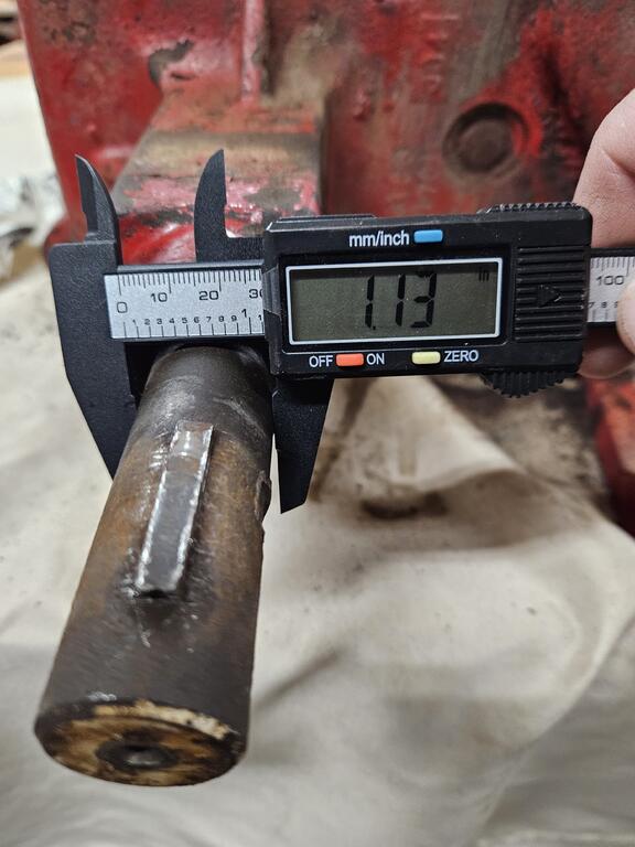

KW88 39 #1 Posted May 5, 2024 I have an 88 312-8 with 1-1/8" axles. I need to replace them and the seals. Anyone know the part #s and where to get them? Share this post Link to post Share on other sites
squonk 47,887 #2 Posted May 5, 2024 Try A-Z tractor for the axles. https://www.a-ztractor.com/ You will have to split the transmission and remove the differential to replace the axles. you also will probably need inner and outer axle bearings. You can get them here: https://wheelhorsepartsandmore.com/product-category/manual-transmissions/ 2 Share this post Link to post Share on other sites

stevasaurus 23,802 #5 Posted May 6, 2024 Try to measure the total length of both axles while in the trans...try using a framming square. Then divide that by 2 and that length will be close enough to know what axles to get. This is assuming your trans is not a Limited Slip trans. Those axles are different lengths. The seals for 1 1/8" axles is SKF 11050. 1 Share this post Link to post Share on other sites
KW88 39 #6 Posted May 6, 2024 5 hours ago, stevasaurus said: Try to measure the total length of both axles while in the trans...try using a framming square. Then divide that by 2 and that length will be close enough to know what axles to get. This is assuming your trans is not a Limited Slip trans. Those axles are different lengths. The seals for 1 1/8" axles is SKF 11050. Looks like 23-1/2". Any way to get a part # ? Share this post Link to post Share on other sites

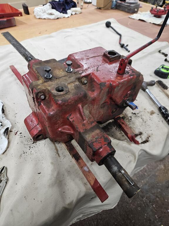

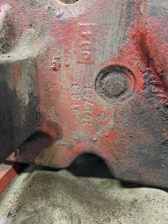

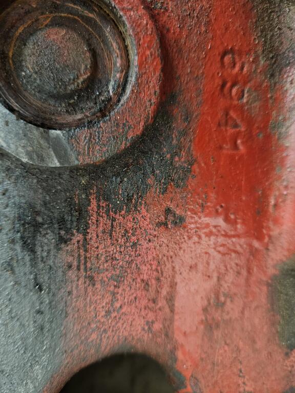

KW88 39 #7 Posted May 7, 2024 Found these marks in casting. Can this identify any type of model transaxle? Share this post Link to post Share on other sites

stevasaurus 23,802 #11 Posted May 7, 2024 Take those bolts out of the top of the trans and shine a light down one of those bolt holes. Look down the dip stick hole and see if you can see the bolts holding the differential together. If it looks like 5 you have a Limited Slip transmission. If it is 4 bolts, you have an 8 pinion differential and the axles are the same length. The axles can butt together in the differential and have up to 1/8" slack of play. Your 23 1/2" would break down to 11 3/4" axles which is Part # 102764 in a #5091 transmission (if this is an 8 pinion differential). If this is a limited slip trans, the axles are 1. 12" Part # 7202 and 2. 11 1/4" Part # 7273. This adds up to approx. 23 1/4" Sense you are looking to change out axles, I would open it up and go from there. You can probably get parts in a couple of days from one of our vendors. Hope that helps. 2 Share this post Link to post Share on other sites
