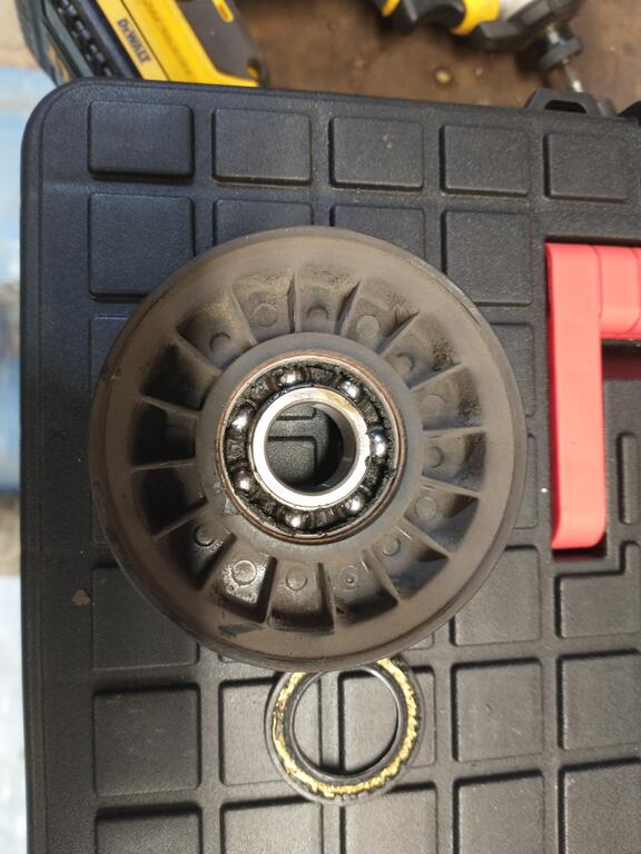

squonk 45,608 #1 Posted May 4, 2024 May is truck maintenance month with the big trip to PA in June. I knew I had a rear axle seal starting to leak on my 2013 GMC so I had it in the shop for the state inspection and got the seals done. I have been seeing posts on FB of burned up belt idler and tension pulleys. Plastic pulleys all melted. I remember from my Napa days of Ford Taurus' being towed off the Thruway with blown idlers. I decided to check mine. The metal idler pulley was fine but the plastic tensioner pulley rattled like a cold Detroit Diesel. So I installed a new Napa Gates tensioner with a metal pulley and a new belt. Popped the seal out of the old pulley and lets just say the grease had left the building! 6 3 Share this post Link to post Share on other sites

ebinmaine 77,538 #7 Posted May 4, 2024 1 hour ago, squonk said: Gonna have some stuff of Randy's as well. May have to utilize the glove box and center console! Got an engine for the BBT too! Nice catch on that pulley Mike! Share this post Link to post Share on other sites

Beap52 2,061 #12 Posted May 5, 2024 Good catch on the tensioner. The fellow who was responsible for engineering early 90's GM pickups rear differential brackets must have went fishing instead of attending class. The U bolts pass through a cup that catches and holds road debris including dirt and salt resulting in the U bolts rusting and potentially breaking allowing the rear axle to be left behind. I discovered this on a '94 Chevrolet pickup and the '92 GMC that I am currently driving needed the U bolts replaced. I saw an early 90's pickup in a ditch with the rear axle kittywampus. No doubt he wasn't aware of rusted U bolts. 1 Share this post Link to post Share on other sites
