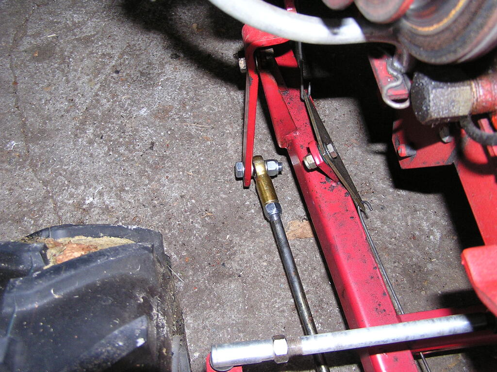

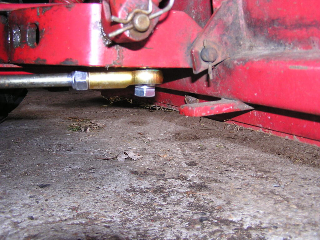

ri702bill 12,698 #4 Posted May 4, 2024 (edited) As Eric said, Heim Joints are the way to go. The rod is 1/2" diameter, about 36" long. No need to bend it if you use the spherical joints. Used with hexbolts, Nylock nuts and washers as spacers to prevent binding. Edited May 4, 2024 by ri702bill 4 1 1 Share this post Link to post Share on other sites

ebinmaine 80,088 #6 Posted May 4, 2024 @ri702bill Good pics! 6 minutes ago, Racinbob said: Here ya go. Front Blade Lift Links - Misc. Items - RedSquare Wheel Horse Forum I didn't really think about the tranny difference Eric. I've always like the longer rod for a solid connection (downforce) but that's been on manuals. I was thinking about using the blade on my latest acquisition since it's a hydro. I need to rethink that. It's fine as long you're prepared to adjust the lift when needed. Depending on driveway surface that could be next to never, or constant. Ours is pretty rough so I wouldn't consider a solid link viable on a hydro lift. On a smooth concrete drive it would likely be helpful. In my particular case the 60" blade with the super heavy duty cutting edge is so heavy I don't need down pressure. 3 Share this post Link to post Share on other sites
