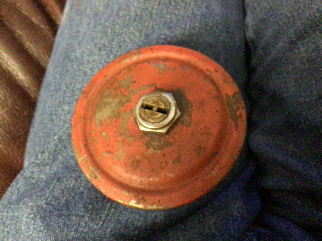

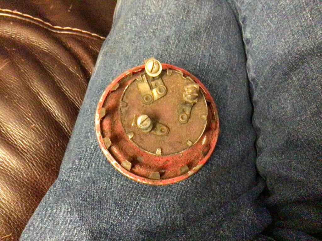

Rattlecan 68 #1 Posted May 4, 2024 I got this in a grab bag of wheel horse parts. Does anyone know what it is? I am assuming it is some kind of switch. What is the giant flange for? Curiosity is killing me. Thanks again. Share this post Link to post Share on other sites
8ntruck 9,174 #2 Posted May 4, 2024 Ignition switch that uses one of the old split keys? 1 Share this post Link to post Share on other sites
oliver2-44 11,656 #3 Posted May 4, 2024 That flange /switch is probable from a 1961 suburban 551 1 Share this post Link to post Share on other sites
Rattlecan 68 #4 Posted May 4, 2024 I looked at some photos of that model and I believe you are correct. I would never have figured that out. Thanks again guys. 1 Share this post Link to post Share on other sites
ri702bill 12,694 #5 Posted May 4, 2024 Yup - looks like a 3 terminal early 1960's keyswitch in a 2" tank or dash hole plug. OR- someone mounted an ignition switch in the hole for the ON-OFF switch of a 552 tank dash plug.... Share this post Link to post Share on other sites

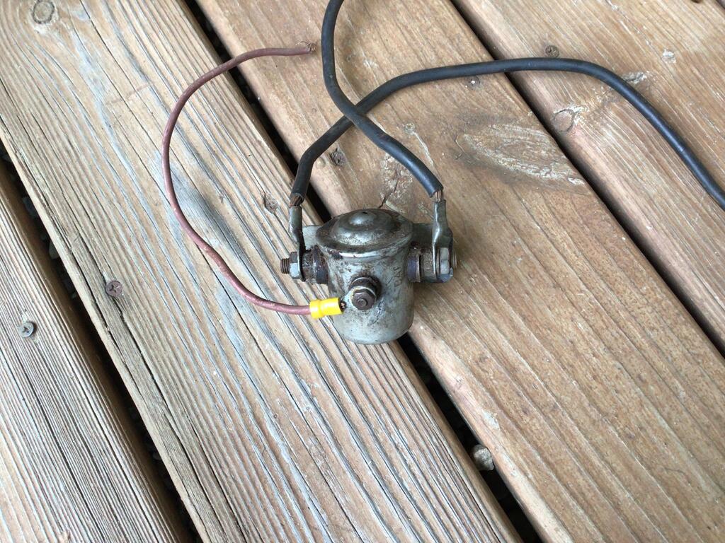

Rattlecan 68 #7 Posted May 4, 2024 As usual you guys have tons of info. I think I also have the old solenoid that goes with it in the box of Stuff, but no key. I do not know how to tell if it’s any good or if it’s trash can material. Share this post Link to post Share on other sites
gwest_ca-(File Mod) 12,416 #8 Posted May 4, 2024 Connect BAT terminal to battery + Ground the small terminal to battery - and the solenoid should close. Share this post Link to post Share on other sites
