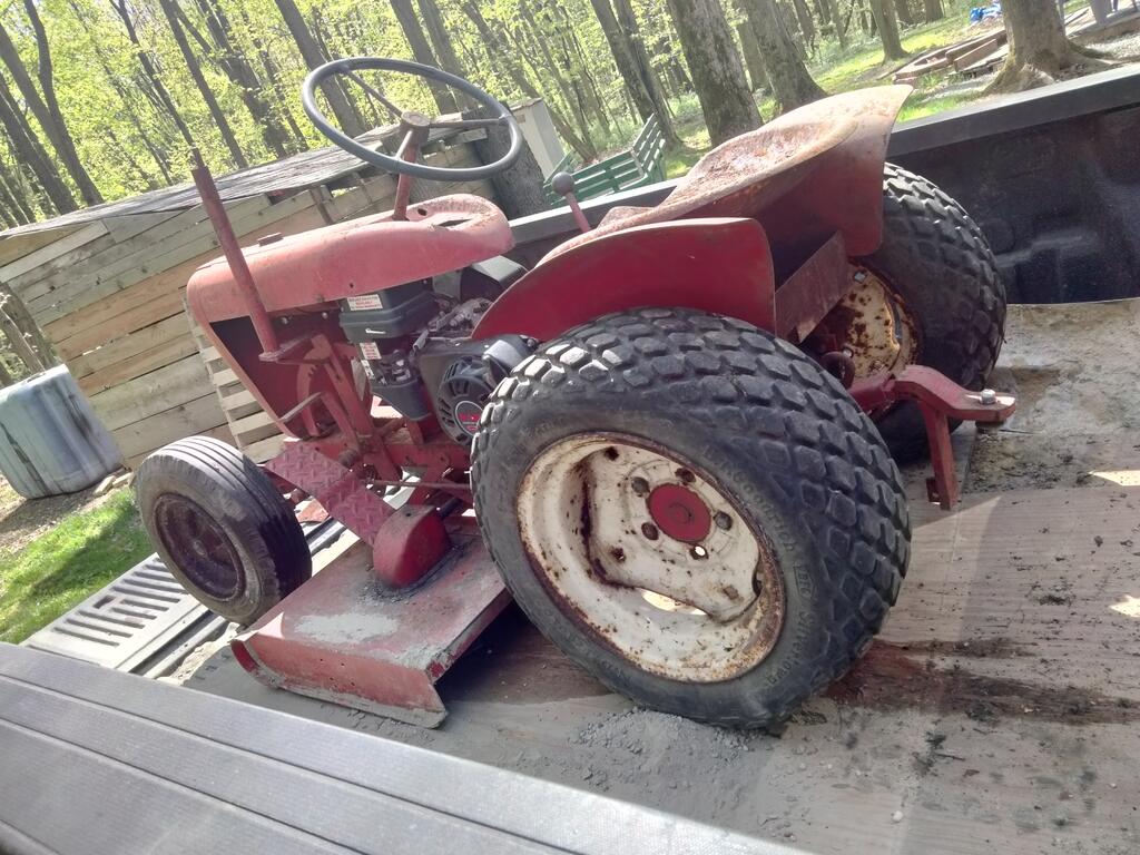

Cjwv1975 117 #1 Posted May 3, 2024 Looking at this tractor any ideas on model. I 1 1 Share this post Link to post Share on other sites
Moonshine*Connoisseur 498 #2 Posted May 3, 2024 Suburban 400 or Suburban 550 my guess. 2 Share this post Link to post Share on other sites
Cjwv1975 117 #3 Posted May 3, 2024 Thats kind of what I was thinking. Looks good except for engine 1 Share this post Link to post Share on other sites
wallfish 20,744 #4 Posted May 3, 2024 Definitely a 1960 Suburban. 400 and 550 are the same tractor except for the engine and 550 has the electric start stuff Share this post Link to post Share on other sites
Pullstart 71,563 #5 Posted May 3, 2024 Those rear tires alone probably make it worth buying… 1 Share this post Link to post Share on other sites
953 nut 70,661 #6 Posted May 3, 2024 The rear tires on that Suburban are an option that very few people selected so they are quite scarce. You have the correct foot rests and the exhaust pipe cover too, Share this post Link to post Share on other sites
Cjwv1975 117 #7 Posted May 3, 2024 Think 600 with predator engine or 500 without is worth it Share this post Link to post Share on other sites
wallfish 20,744 #8 Posted May 3, 2024 If it has the belt guard it is. Probably so even without it too. But I don't know the availability of those down in WV but would guess they're more rare down there compared to some other areas. Ditch the preditor engine anyway and find a Kohler K91. It'll look much better IMO It's also missing the throttle/choke controls and the the cover for them which was the model serial # tag. Those parts would have been located in that square hole below the steering wheel. Front rims are probably rotted because they were filled with calcium from the factory which eats them. Gas tank is still there but hopefully good. Rust can be cleaned out by filling it with vinegar. If the rust goes all the way through the vinegar will eat it and leak out. 2 Share this post Link to post Share on other sites

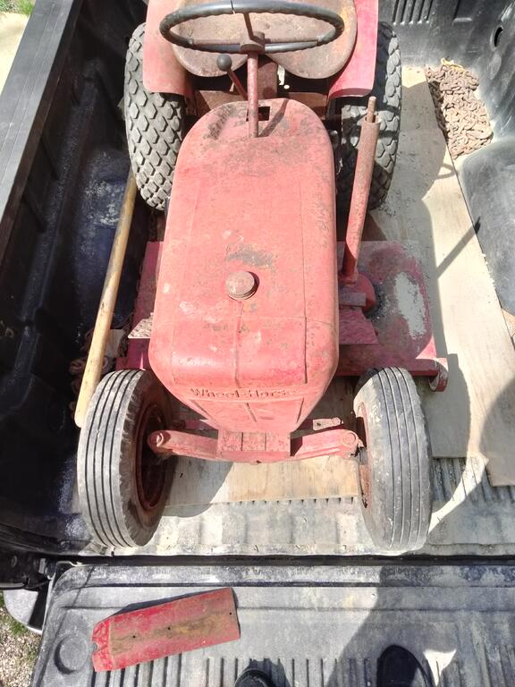

Cjwv1975 117 #9 Posted May 6, 2024 Decided to buy this WH. 500 without engine. It has a drive belt but its not the back one. Gentleman is even meeting me half way for pickup. Think It'll fit in bed of shortbed Tacoma. Know theyre small but that small 2 Share this post Link to post Share on other sites
wallfish 20,744 #10 Posted May 6, 2024 (edited) Yes, it will fit, they fit horizontal through the side door into my Chev cargo van Share some pics when you get it and ask away for any questions. We'll help you with getting it squared away. What are your plans for it? Run it like it is but mechanical fixes, full blown restore? Edited May 6, 2024 by wallfish 1 Share this post Link to post Share on other sites
Cjwv1975 117 #11 Posted May 7, 2024 2 hours ago, wallfish said: Yes, it will fit, they fit horizontal through the side door into my Chev cargo van Share some pics when you get it and ask away for any questions. We'll help you with getting it squared away. What are your plans for it? Run it like it is but mechanical fixes, full blown restore? Definitely going to paint it but I'll use it so not going overboard with cosmetic looks. Guy says deck was rebuilt but never used after rebuild. I am going to use it to mow so hopefully I can get that working. He said something about pulley not being there to run mower deck. Plan on trying to find k91 for it and trying to find thottle/choke assembly for it and rear belt plate. 1 Share this post Link to post Share on other sites
Pullstart 71,563 #12 Posted May 7, 2024 9 hours ago, Cjwv1975 said: Definitely going to paint it but I'll use it so not going overboard with cosmetic looks. Guy says deck was rebuilt but never used after rebuild. I am going to use it to mow so hopefully I can get that working. He said something about pulley not being there to run mower deck. Plan on trying to find k91 for it and trying to find thottle/choke assembly for it and rear belt plate. To each their own, but I don’t think it needs any paint, it’s perfect the way it is Maybe a wet sand and clear coat of your choice, or some boiled linseed oil. 1 Share this post Link to post Share on other sites
Pullstart 71,563 #13 Posted May 7, 2024 12 hours ago, Cjwv1975 said: Think It'll fit in bed of shortbed Tacoma. Know theyre small but that small It should… 2 Share this post Link to post Share on other sites

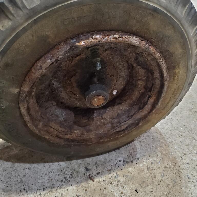

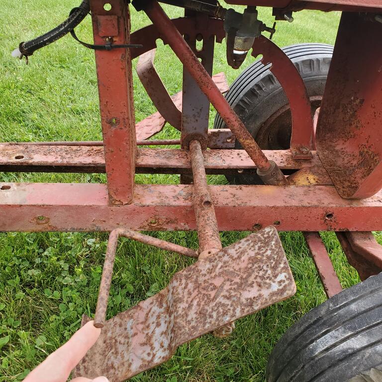

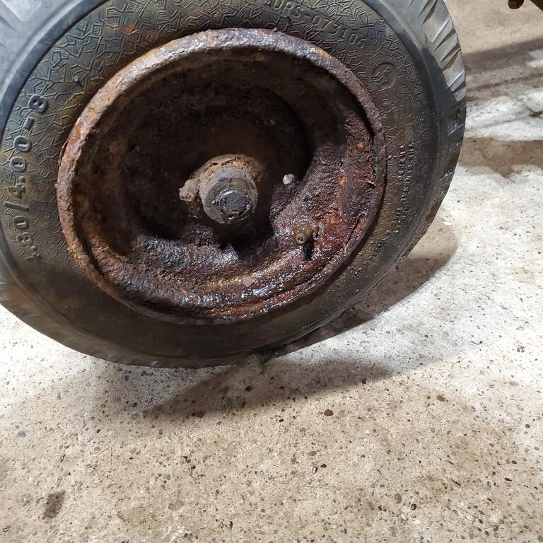

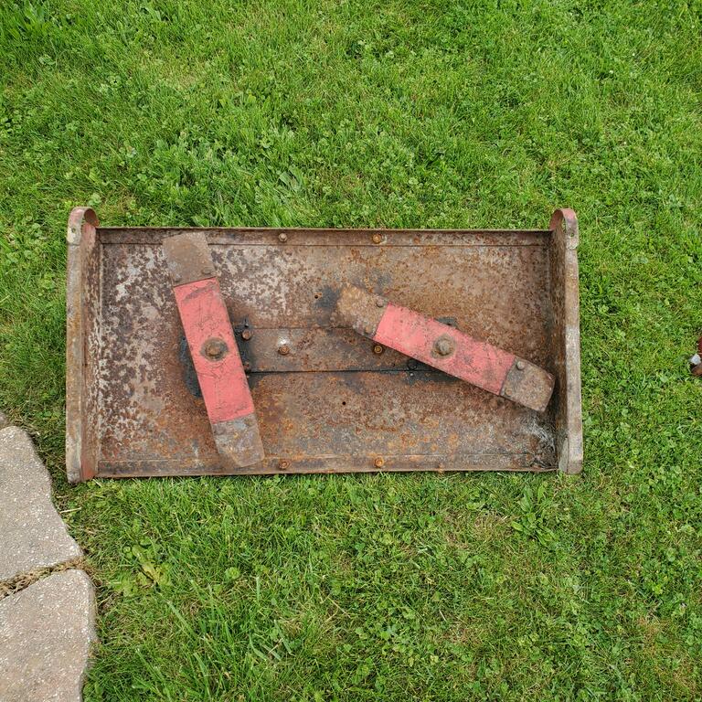

Cjwv1975 117 #16 Posted May 10, 2024 Here it is. Metal is in good shape with no real dents. Front rims are gone. Rear should be okay with sandblasting. It shifts good. Gas tank looks really good inside. Missing a pulley and the foot bracket for mower is broke. Just need to find k91 and look for a rear belt guard. Need to make something for throttle/cable setup. And it doesnt steer think a linkage is missing underneath 1 Share this post Link to post Share on other sites
oliver2-44 11,847 #17 Posted May 11, 2024 9 hours ago, Cjwv1975 said: Front rims are gone. Those front rims are only used on the RJ and Suburban. The inner bearing hum is longer than on other WH front rims. Show us some pictures of the rims. Some can be saved with welding or fiberglass Share this post Link to post Share on other sites
Cjwv1975 117 #18 Posted May 11, 2024 36 minutes ago, oliver2-44 said: Those front rims are only used on the RJ and Suburban. The inner bearing hum is longer than on other WH front rims. Show us some pictures of the rims. Some can be saved with welding or fiberglass Inside of rims alittle better than outside Share this post Link to post Share on other sites
oliver2-44 11,847 #19 Posted May 12, 2024 @Cjwv1975 If you have your own San blaster it’s work a shot to see what under the scale. That 2nd one looks salable. But it just depends what the inside looks like. Share this post Link to post Share on other sites
Cjwv1975 117 #20 Posted May 12, 2024 40 minutes ago, oliver2-44 said: @Cjwv1975 If you have your own San blaster it’s work a shot to see what under the scale. That 2nd one looks salable. But it just depends what the inside looks like. I dont have a sandblaster but maybe Ill get one now lol. Thanks. Share this post Link to post Share on other sites
