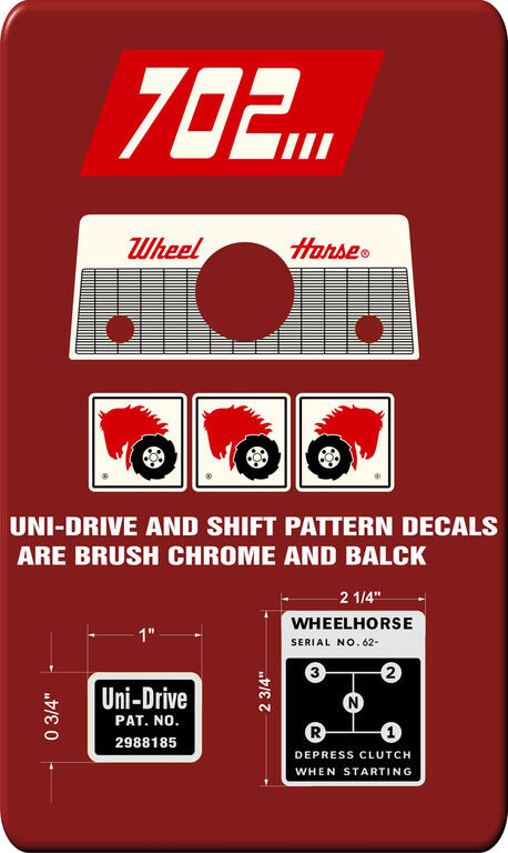

rmaynard 16,862 #3 Posted May 3, 2024 This is the set from @Vinylguy redoyourhorse.com. If the base plate is properly prepared, the decal should not come off. Share this post Link to post Share on other sites
carlosking450 161 #4 Posted May 3, 2024 The sticker I bought for the painting was very thin, however the original is like a hard screen-printed plate, it does not come off but when you tighten the screws in the corners or the frame of the amp clock it turns and comes off Share this post Link to post Share on other sites
rmaynard 16,862 #5 Posted May 3, 2024 Put flat washers under the heads of the screws. Share this post Link to post Share on other sites
