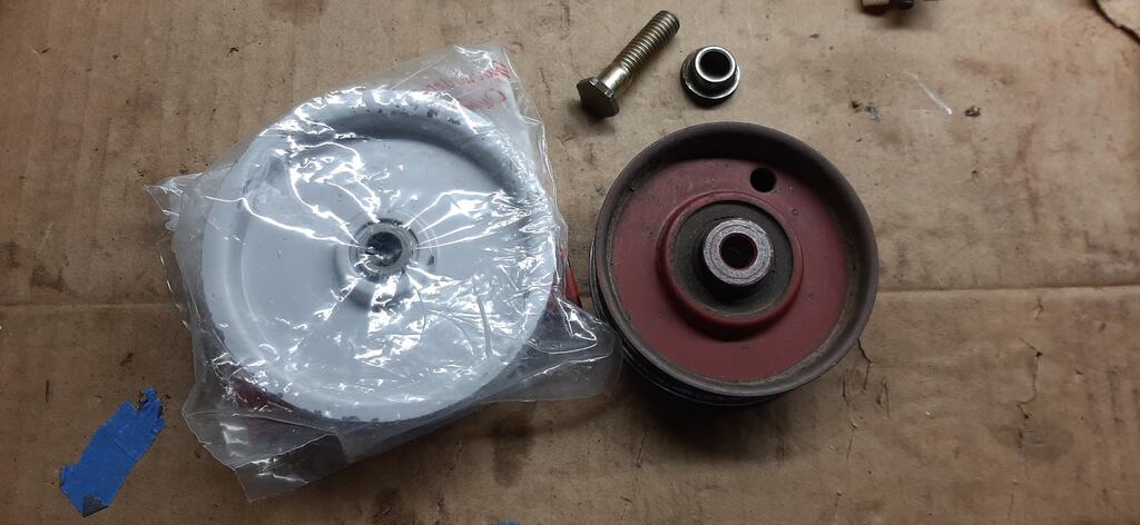

John c 222 #1 Posted April 30, 2024 I'm going through this new 314 I just got, clean it up, change fluids, gas lines, tank grommet etc. I ordered a new idler pulley for the drive belt per the part number given in the parts lookup charts (112426) and the one that arrived is bigger than what's on it now. I looked in all 6 serial number ranges and they all show the same number. Have any of you 314H guys ran into this before ? Share this post Link to post Share on other sites

John c 222 #3 Posted April 30, 2024 nothing besides the new one is larger diameter, no sure if the larger pulley would cause any issue or not Share this post Link to post Share on other sites
John c 222 #4 Posted April 30, 2024 Here's what I'm looking at 3.25 vs 3.75 large idler increased belt tension, increased load on the driver and the driven shafts. Enough to cause undue wear on bearings, bushings, seals etc ? Share this post Link to post Share on other sites

John c 222 #6 Posted April 30, 2024 I used to do that when I had a honda 4518, idler prices from honda where ridiculous, or I'd drill the spot welds and replace the whole bearing and bolt it back together. I'd rather replace the whole thing, my record on picking out bearing seals without boogering something up is less perfect, plus the existing bearing feels a little rough. Despite the rotary number does cross reference to toro 112426, I think they either flubbed the dub, or mis-packaged it, it was still sealed in the rotary package, but it won't fit anyway. I've ordered a stens brand to see what it looks like. Anybody else with a mid 90's 314H ran into this before ? Repack will be a last resort I guess. I'll see what stens looks like, if not a match I see if I can locate a toro brand, or drill it and replace the bearing. Share this post Link to post Share on other sites

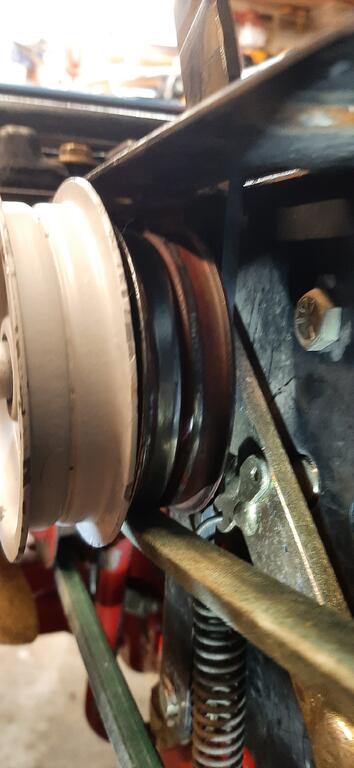

Jeff-C175 7,211 #12 Posted May 27, 2024 (edited) On 5/1/2024 at 7:21 AM, John c said: I got a stens brand yesterday and it's a match to the original. Same issue here John. The one I ordered claiming to be a direct replacement for the 7434 (112426) is too large. Hits the top of the panel when you try to operate the lever. The inner surface the belt rides on is also too large, even if the idler didn't hit the panel, it would be too tight and not release. What Stens part # did you find that fit? Was it the 280-081 ? Edited May 27, 2024 by Jeff-C175 Share this post Link to post Share on other sites

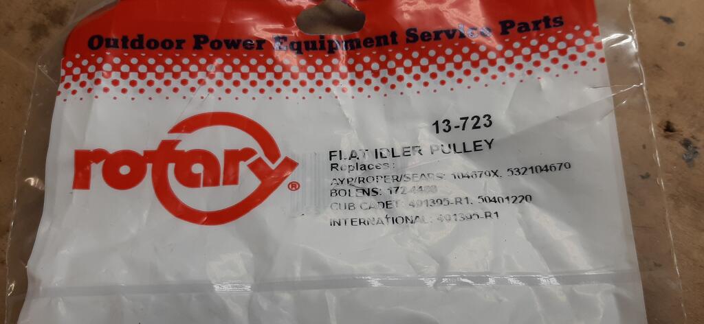

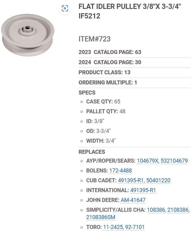

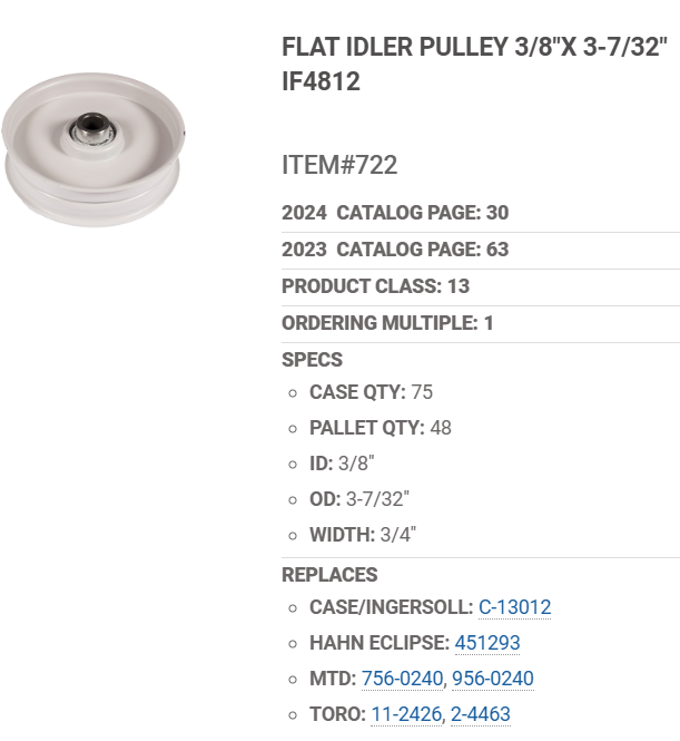

Jeff-C175 7,211 #13 Posted May 28, 2024 (edited) On 4/30/2024 at 10:39 AM, John c said: Despite the rotary number does cross reference to toro 112426, I think they either flubbed the dub, or mis-packaged it, it was still sealed in the rotary package, but it won't fit anyway. Maybe they did goof, but their current look up shows that the 723 does NOT cross to the 112426. Perhaps they fixed it. They show the 723 crossing to the 112425: They now show their part 722 crossing to the 112426, and those dimensions appear correct: Also, the Stens 280-081 appears to be the same as the Rotary 722. Edited May 28, 2024 by Jeff-C175 1 Share this post Link to post Share on other sites
Jeff-C175 7,211 #14 Posted May 29, 2024 (edited) Further, it appears that the STENS 280-586 is a heavier duty than the 280-081, but both will work. The 586 has a much beefier bearing and appears to be heavier metal. It is a bit more costly though, but I think worth the difference. Edited May 29, 2024 by Jeff-C175 Share this post Link to post Share on other sites
