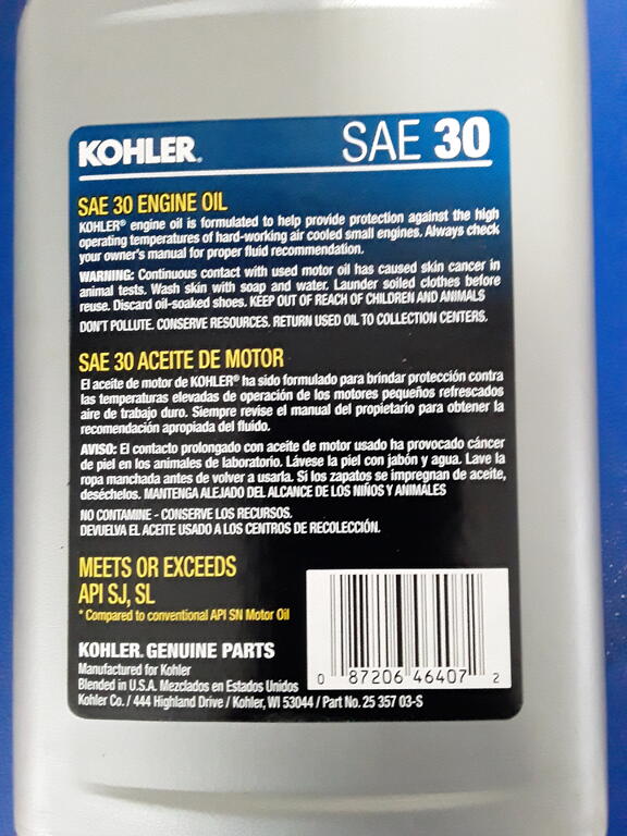

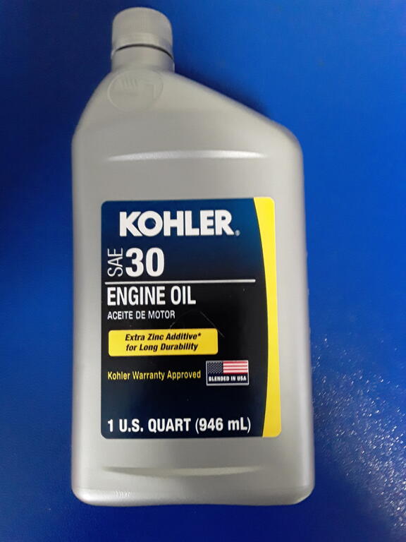

Brockport Bill 2,060 #9 Posted April 28, 2024 Kohler has their own label oil they engineered with zinc additive specifically for their older engines. Share this post Link to post Share on other sites
Wild Bill 633 885 #10 Posted April 28, 2024 10 hours ago, Brockport Bill said: Kohler has their own label oil they engineered with zinc additive specifically for their older engines. Made by Amsoil, 1 Share this post Link to post Share on other sites
