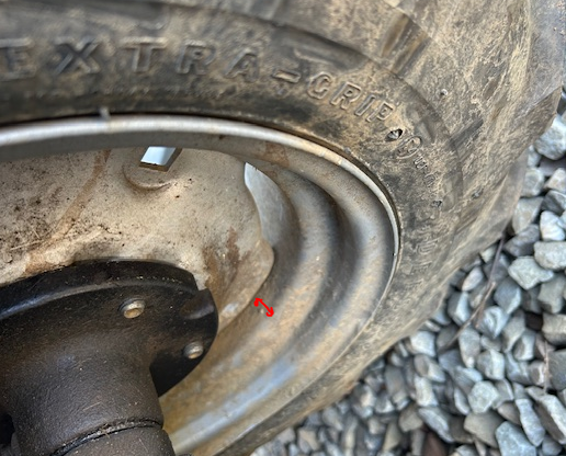

JoeM 9,650 #8 Posted April 27, 2024 If you are handy with a tape measure a few simple checks will help with your quest. First you have to determine what backset is on the current rims on your 520 I have seen two different ones used. Shallow and deep. This rim is shallow. measures about 3/4" where the red mark is. The deeper ones are about an inch more. You can then measure the space between the tire and seat pan supports on both sides. Measure the width of outside of your tires and compare that to the inside measurement of the gauge wheels on the 42. I know on some machines they put the deep rims so smaller decks can clear. A friend of mind had a 418-c with shallow rims and tried to put a 42" rear discharged deck and the gauge wheels rubbed the tires. In the past he swapped the original deeper rims to another machine and did not realize they had a different offset. The deeper rims are plenty-full if you are looking to narrow up the tire size get the 7 inch wide rims it will let the side wall of the tires set right. I figure your 520 has 8 1/2" rims now. 1 Share this post Link to post Share on other sites
Anvil 11 #9 Posted April 27, 2024 Hey Supporter, you are right on target. The wheels currently on my 520 has the roughly 3/4" measurement where you indicated and the wheel contact area of the flange to the back of the rim lip is roughly 1.5". I'm currently reaching out to a guy on Marketplace who is selling 2 rear rims which are stamped 12 x 7 in almost new condition for $50. He hasn't gotten back to me all day. If I stuck with the 23 x 10.5 x 12 tires I think I will still be in trouble. I like the way those big boys look on my machine but if I must downsize I must. Thank you for your assistance and all the rest of the responding members. It's great to have a knowledgeable group to depend on. Thanks again. 2 Share this post Link to post Share on other sites
