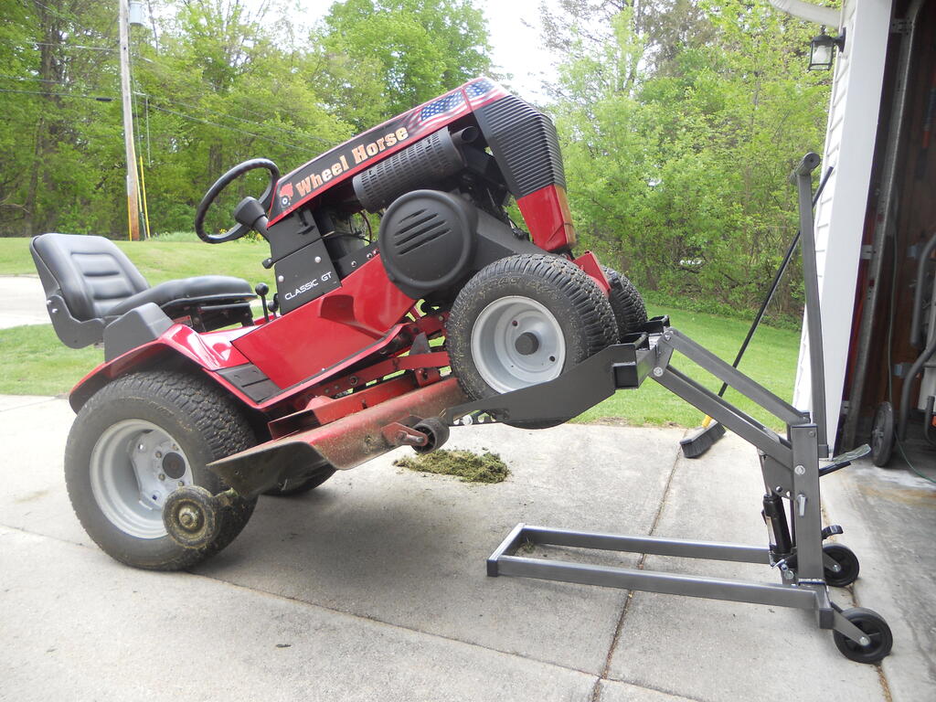

Racinbob 13,290 #5 Posted April 27, 2024 (edited) I purchased this 48" deck new in the 70's. It gets a good cleaning and oiled once a year, when I put it up for winter storage. This was taken about a week ago as I'm getting ready for the summer mowing season. There's no need to put any sort of coating on your deck. Likely it will do more harm than good by trapping moisture as it starts to fail (they all do eventually). All I do is take maybe 5 minutes with a putty knife and scrape the clumps off. No cleaning and no hosing off. Just the clumps that hold the moisture. Even 'dry' grass has moisture so I never skip doing this every time. Quick and easy and by the looks of this 50ish year old deck apparently it works. Edited April 27, 2024 by Racinbob 2 6 Share this post Link to post Share on other sites

Racinbob 13,290 #8 Posted April 27, 2024 8 minutes ago, JoeM said: I have no desire to crawl around scraping grass from under a deck This makes quick work of it. 2 1 Share this post Link to post Share on other sites

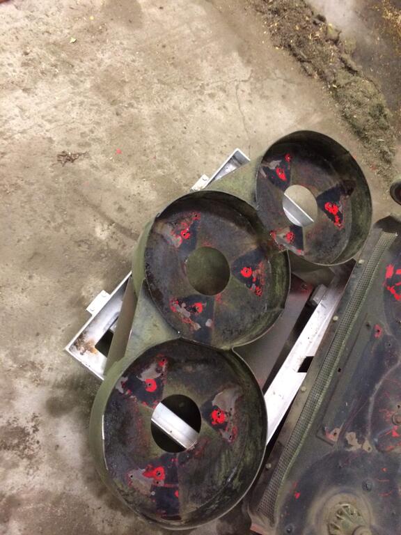

Racinbob 13,290 #13 Posted April 27, 2024 1 hour ago, RED-Z06 said: I wish my problem was moisture, and wet grass. Decks dont rust here, the sand/silica simply erode the steel away. Its not terribly uncommon for new mowers to need a deck shell every 4-5 years. Ive now got (2) 42sd decks that look like swiss cheese. I hear you on that. We lived there 17 years. Our kids lived next door to us. The son in law said his tractor wasn't mowing right. I took these blades and spindles off. He has a junk deere. It did strike me odd that he was having issues but even though I mowed more I didn't have any problems. 1 Share this post Link to post Share on other sites

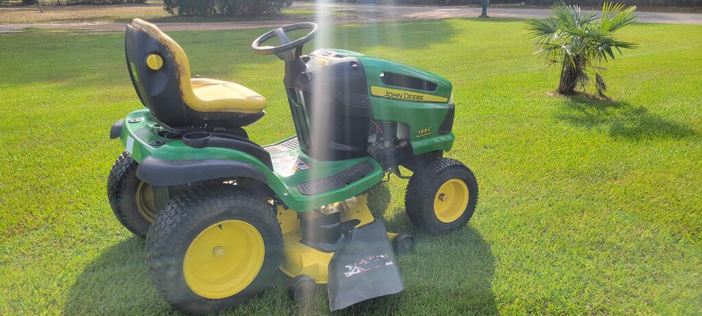

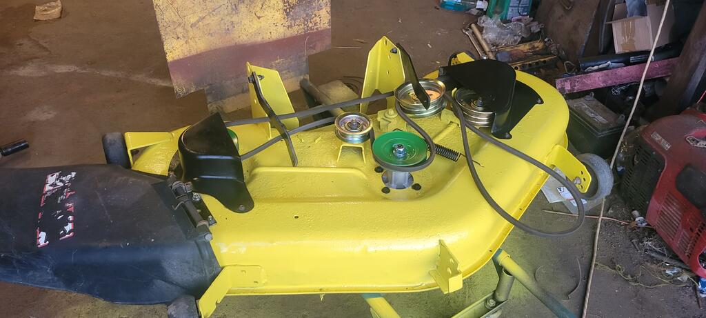

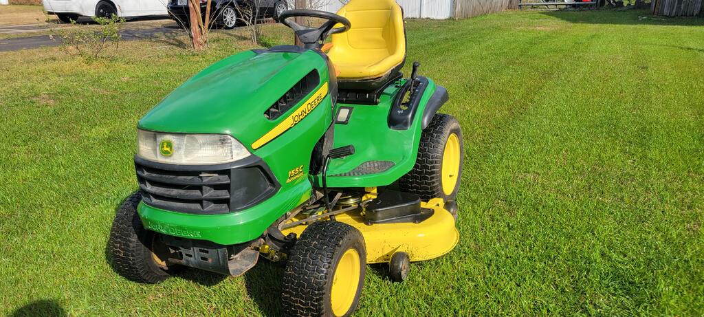

RED-Z06 2,720 #14 Posted April 27, 2024 42 minutes ago, Racinbob said: I hear you on that. We lived there 17 years. Our kids lived next door to us. The son in law said his tractor wasn't mowing right. I took these blades and spindles off. He has a junk deere. It did strike me odd that he was having issues but even though I mowed more I didn't have any problems. I sold a really nice Deere 155C a couple years ago, id fully refurbed the deck to include new idlers, spindles, blades, paint...it mowed like a dream. Guy that bought it said it started mowing bad after a few mowings...the blades were so worn it had a 3" gap between them. This season he scrapped it because the holes in the deck were so large it was throwing clumps up into the drive belt. Share this post Link to post Share on other sites

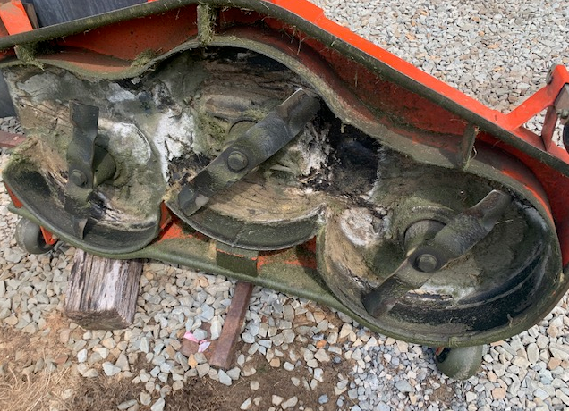

RED-Z06 2,720 #16 Posted April 27, 2024 26 minutes ago, Handy Don said: Egad! I don’t think I’ve ever seen such wear. This must be a nightmare for the lawn service businesses running their mowers 8+ hours a day. I handle the servicing for 14 mowers across 9 commercial outfits, i buy blades in bulk, and they go fast...on average they will swap a set weekly after buying 3 sets new, then bring me the mower and 3 sets to sharpen, if a set is too far gone we swap on a new set. Some guys will bring me 2 or 3 5g buckets full to put together as many good sets as possible and sharpen them all. 2 1 Share this post Link to post Share on other sites
