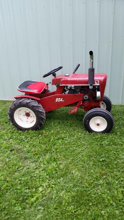

rjg854 12,842 #5 Posted April 27, 2024 This is what he makes, they look like this. 1 Share this post Link to post Share on other sites
