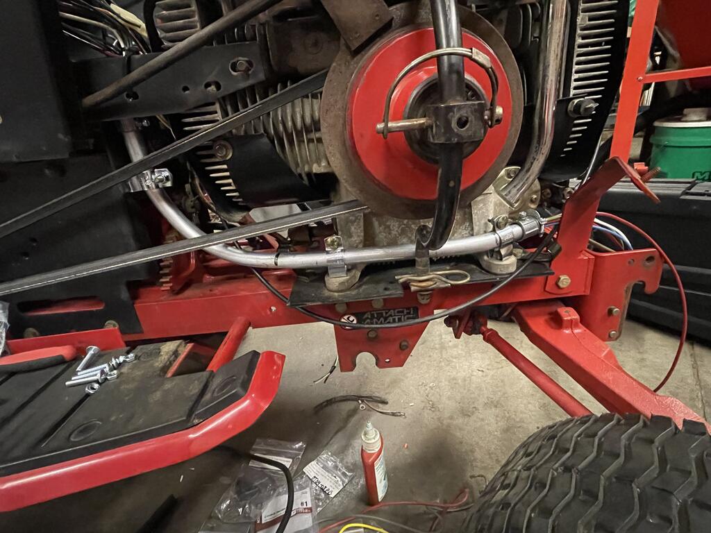

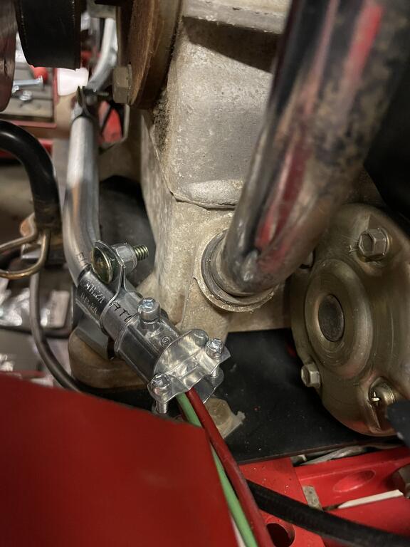

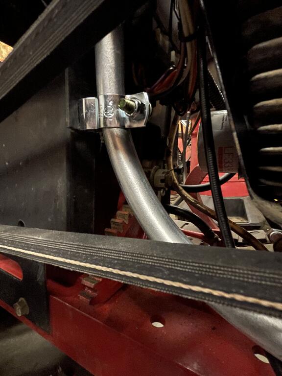

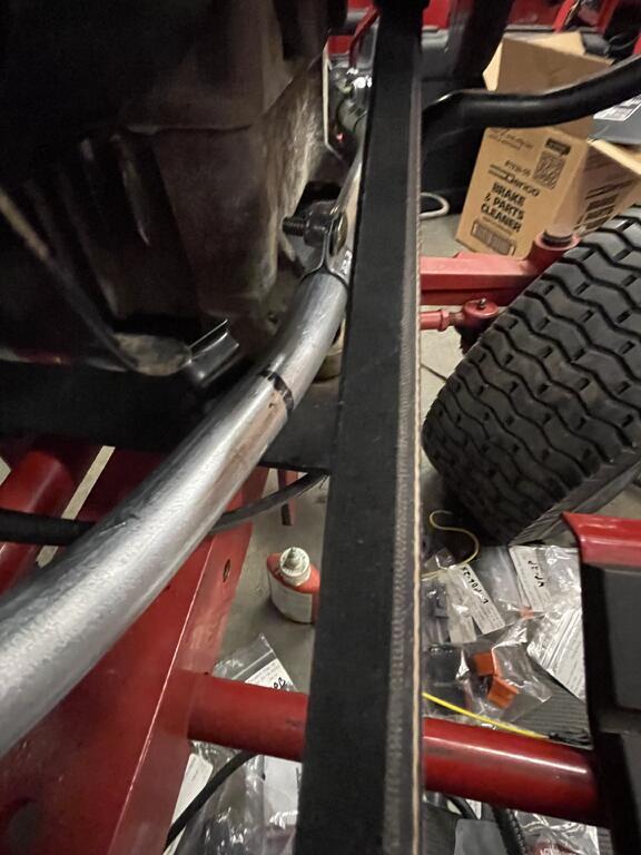

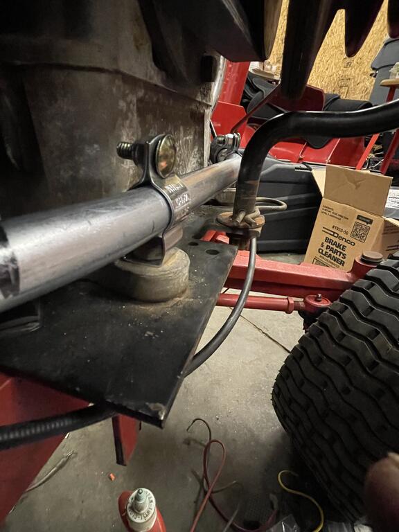

Bow_Extreme 583 #1 Posted April 25, 2024 Well, I decided to try something different. Bent a piece of 1/2” conduit and ran the wires that normally go overtop of the engine, through the conduit. Now it needs powder coat. 4 5 Share this post Link to post Share on other sites

ri702bill 12,699 #3 Posted April 25, 2024 Nice - as long as there are chaffe proof grommets at both ends. That conduit is a direct ground. 1 Share this post Link to post Share on other sites
Bow_Extreme 583 #4 Posted April 25, 2024 1 hour ago, ri702bill said: Nice - as long as there are chaffe proof grommets at both ends. That conduit is a direct ground. Exactly. The upper end is complete with the wiring loom pushed inside the connector and clamped. I have to do the starter end now. 3 Share this post Link to post Share on other sites
